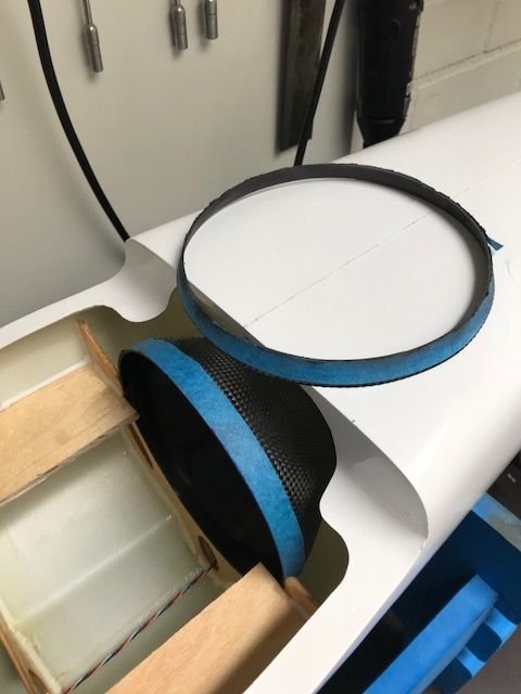

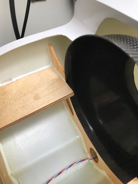

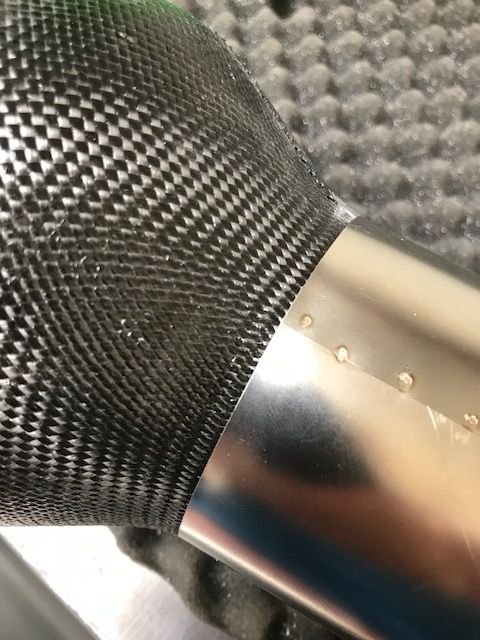

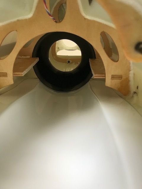

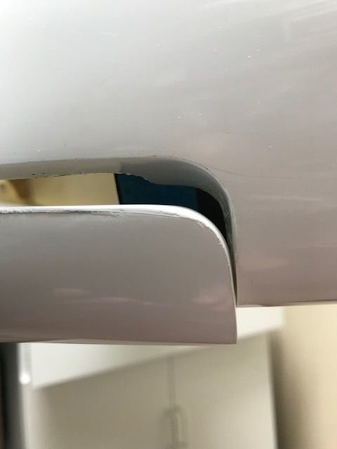

Hi guy's,
Think a need a little help here.
As you see in the pictures, the pipe install is a bit of an ????
As remever correct from my Flash, the pipe sits on the last former, a little sanding needed done to make it fit correct but that was all.
If i do the same now, one end off the bell mouth sticks out underneath the fuselage.
The end off the pipe sticks out the fuselage 3.5 cm....
And a other funny thing, the pipe it self slides over the bell mouth, on the flash the pipe fitted inside the bell mouth?
I'm wondering, did Carf supplied the wrong bell mouth? or is there a lot of cutting and grinding involved here?
Can some one please shine his light on this and give some help please?
Thanks, Ed

Old 05-10-2018, 01:57 AM
  #205
Midas D.
Join Date: Apr 2013
Location: holland, NETHERLANDS
Posts: 459
Gallery
My Gallery
Models
My Models
Ratings
My Feedback

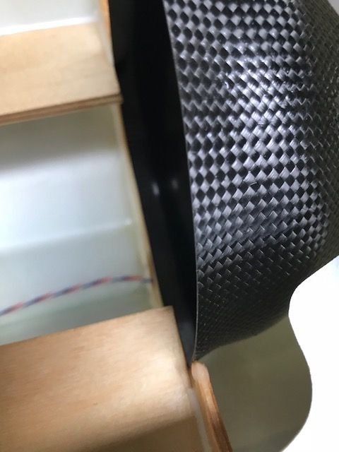

Was thinking of cutting off a complete ring where you see on the picture (where the pen hit's)
There is an "lip" pointing up.
My thoughts are cutting this complete lip off, but then;
- The whole diameter of the bell mouth becomes smaller then the cutout in the end wood former where it sits on...
- So if i then place the bell mouth back on this en former, the thrust angle off the pipe will change
Arrrrgggg what to do??

Old 05-10-2018, 02:03 AM
  #206
Dave Wilshere

The video of CARF's model is with an 80N turbine, so Jetpower flight and others.
I'll find a media device that shows pictures on RCU as since the change some of my computers have a weird page layout and no pictures!
Tail pipe usually just sticks out the back end of the fuselage, CARF don't have a uniform tailpipe design, ever seen an UltraLightning!

Old 05-10-2018, 03:17 AM
  #207
dccatl
Join Date: Dec 2014
Location: Atlanta, GA
Posts: 85
Gallery
My Gallery
Models
My Models
Ratings
My Feedback
Mine sticks out the tail about 5 mm the bell-mouth was mounted flush against the engine mounting rails. Not cutting of pipe, bell-mouth, former or mounting rails.

Old 05-10-2018, 04:13 AM
  #208
Midas D.
Join Date: Apr 2013
Posts: 459
Gallery
My Gallery
Models
My Models
Ratings
My Feedback
Ok, fair enough, so i guess it's cutting time....
No clou how i got to sort this other wise ......
Dccatl,
Your bell mouth looks a lot smaller then mine,
Dave are you sure about this, cause looking at Dccatl picture and looking at mine, even a blinde guy could tell the Bell mouth i got is Much bigger in diameter ... ??
Mine is 14.5 cm in diameter
What i'm i missing here or overseeing in a wrong way??
Ed

Old 05-10-2018, 11:13 PM
  #209
Midas D.
Join Date: Apr 2013
Posts: 459
Gallery
My Gallery
Models
My Models
Ratings
My Feedback
Tatttaaaaa, Fixed
Thanks Andreas for the support on this "brain fart" of mine!
Much apriciated !!!!

So what was the brain fart and what did he tell you to do?

Old 05-12-2018, 10:27 PM
  #211
Midas D.
Join Date: Apr 2013
Posts: 459
Gallery
My Gallery
Models
My Models
Ratings
My Feedback
The fart i suppose was, me thinking there was a wrong bell mouth in my kit, and me kept fiddling in the hope it would fit.....
Guess i should have left it alone for the next day
Apparently Carf uses this bell Mouth for multiple planes, and in one batch off Jokers they forgot to trim it back.
So there was the solution, cut it back about 5mm and now it fits perfectly.
Cheers,
Ed
