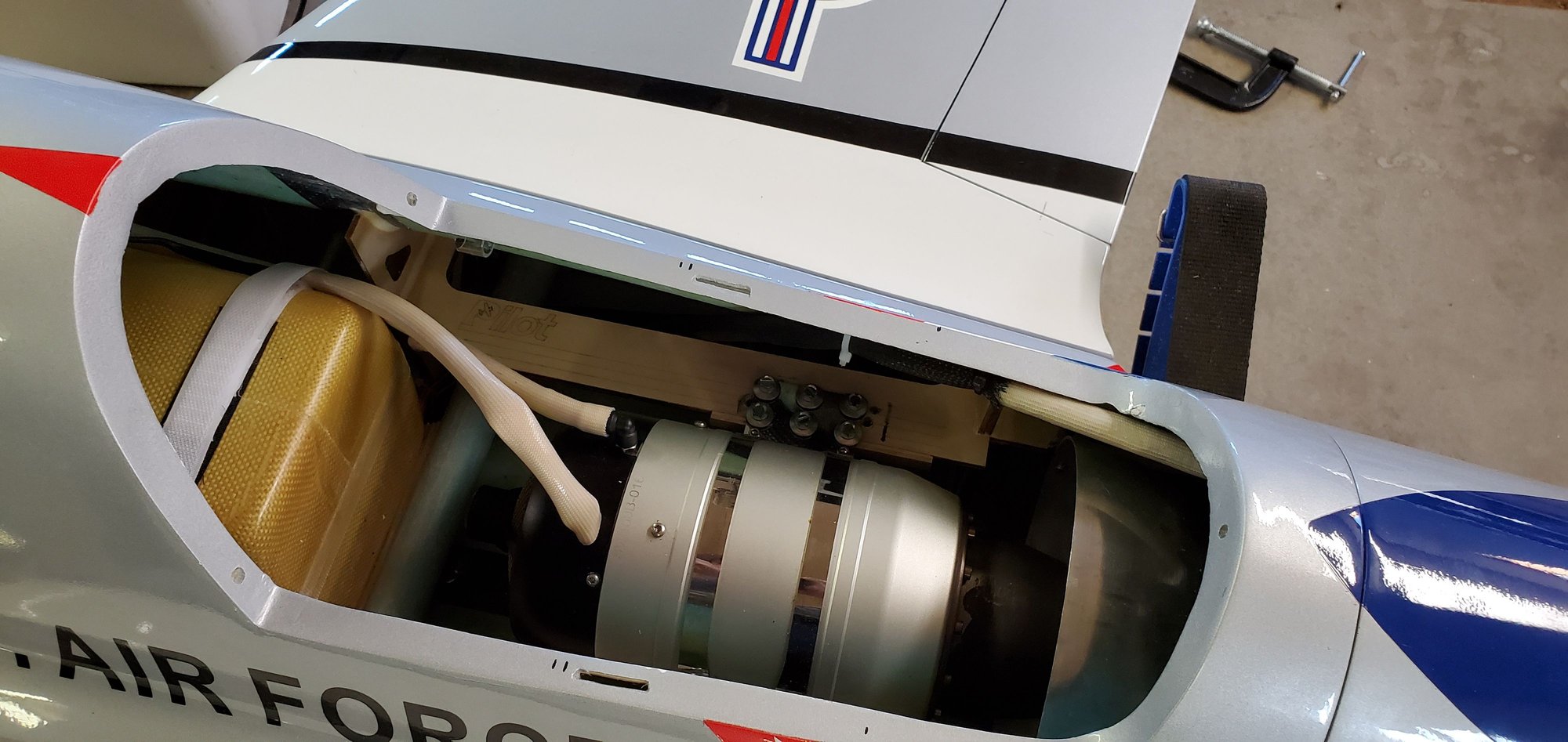

Jet is ready for maiden. Finished out at 29.75lbs. The sw170b has a good bit of residual thrust at idle. It wants to get rolling at idle even with the rpm dropped 1000 below spec rpm.
