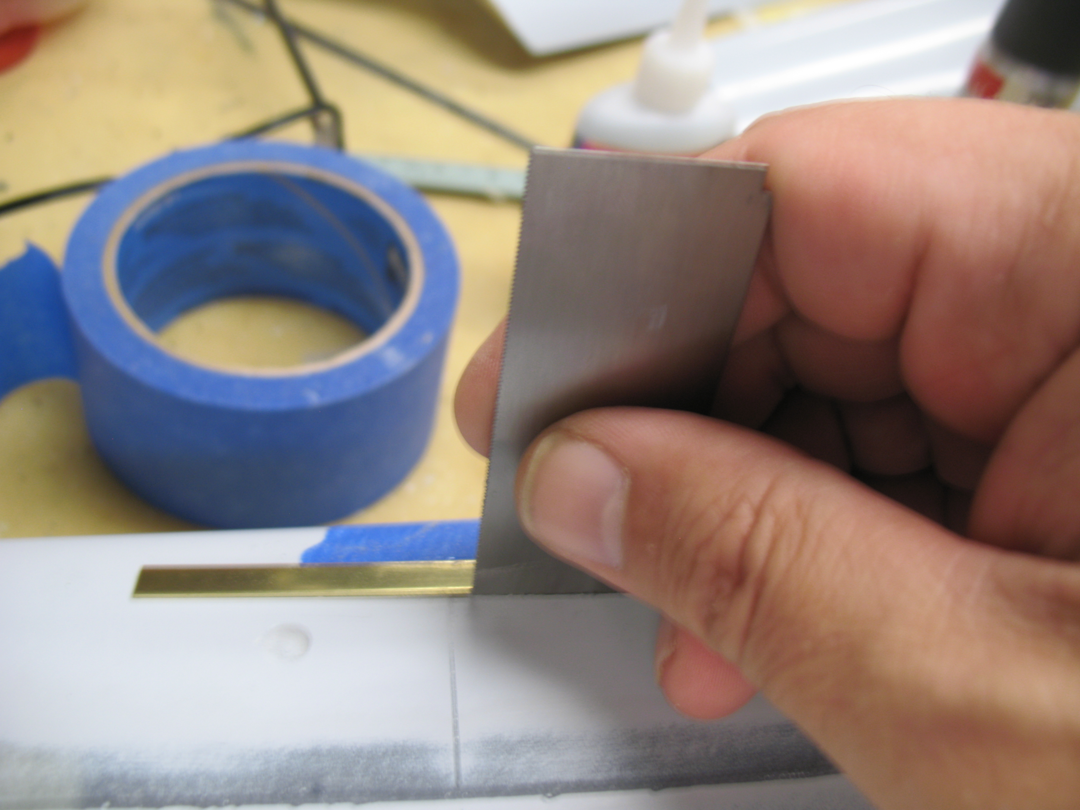

Some more tips on your gear mounting.
Make sure you know what the distance will be from the tire on the ground to whatever reference you want on the outboard retract mount. In other words, you want to make sure the planes sits correctly. Bandits can be tricky to rotate and they can also drag the tails on landing so you don't want to inadvertently change the main gear length. Your mains look a little short to my eye. And make sure that the main wheels track straight when extended before you permanently glue everything in, very important
If you can, go ahead and get 3 inch tires to fit. Also, double up the carbon fiber gear mounts, the stock are too weak for my taste, I know guys that run aluminum, home made mounts that will bend instead of break, I use titanium mounts because that sounds very cool :-)
Sorry you used a dremel to cut those panels out, that is a tough way to do it and you can really make a mess, I use a razor saw, see the picture. You tack glue a brass fence along the cut line and cut with a razor saw
The spanwise tilt of the gear is correct, and get the tires as deep into the wing as possible. They must touch the upper skin to get everything to fit.
I like the older bandit but I prefer the fuel in the super, you can get almost one gallon

I really hi-jacked this thread, sorry. Matt whats your email, can I email questions? I am also happy to post in RCU but its down half the time.
BTW the razor saws I have, are made by EXCEL. Are those junk? They dull out quickly, like after a few inches. I did have better luck with a mini hacksaw like this:
https://www.amazon.com/dp/B00XINFEQQ...a-313102827340
The blade stick outs. I am going to try your method. But the saws I am using, even the hacksaw, dull out. Id need 7 of them per panel!
Id like to chat more about the tires, they have 1/4" clearance from the door opening and the former, so getting another 1/4" bigger tire I may be hitting something since I doubt I can more than 1/8" accurate of the location its supposed to be.
I plan to get this up on its feet, and have a look before I do anything permanent. Mostly tacking things with 5 min, and then will fillet hysol all around.

Just go ahead and post here, I mean look at the other threads.......you are the only one I see actually building something!
Yes I use excel, zona or xacto saws. They dull quickly, especially when going through carbon structures. One trick I use is to use the end of the saw to first penetrate the cut, then switch to a saw blade that I have removed the back from, then saw that way (see the picture).
The corner ends of the saw dull quickly, so just cuts the saws shorter with a cuttoff wheel for a fresh set of teeth.
