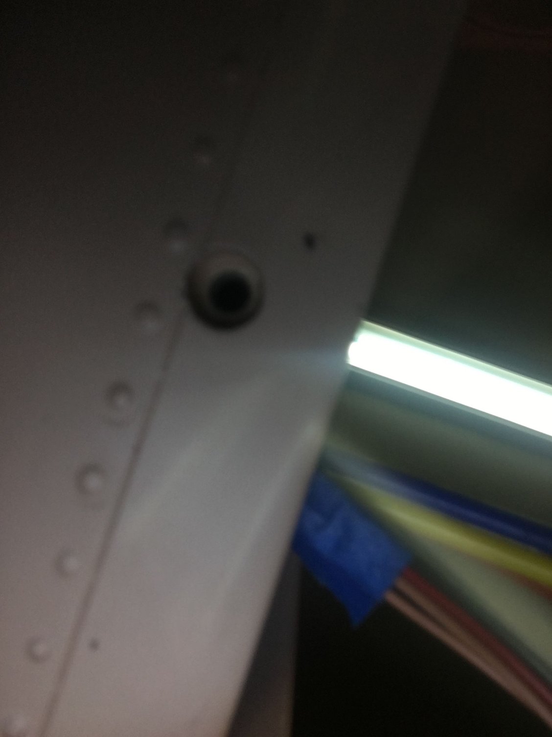

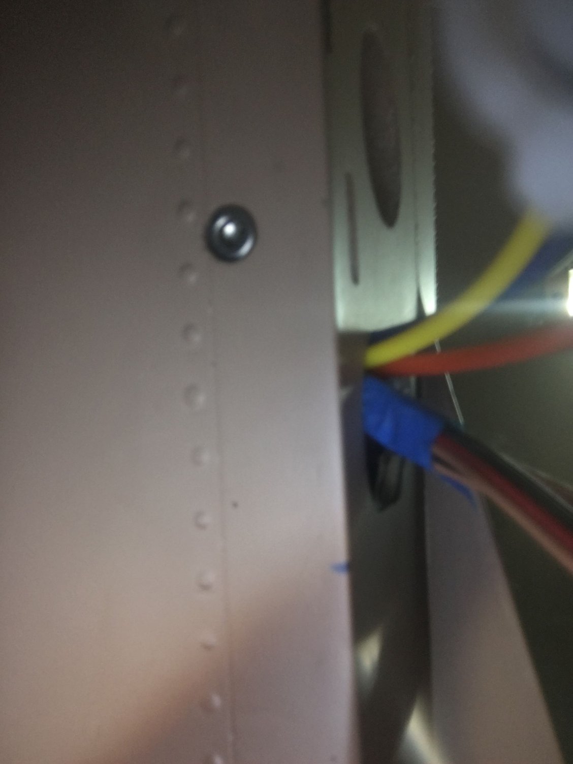

I got her all put together and all systems are looking good. Little did I know that the new king tech G2's only work on LiFe type voltages, so I have to redo my power install on the turbines, but other than that, she just needs balancing and some engine runs and she should be ready to maiden soon!
Attachment 2259599
Attachment 2259600
looks great, what lighting kit did you use?

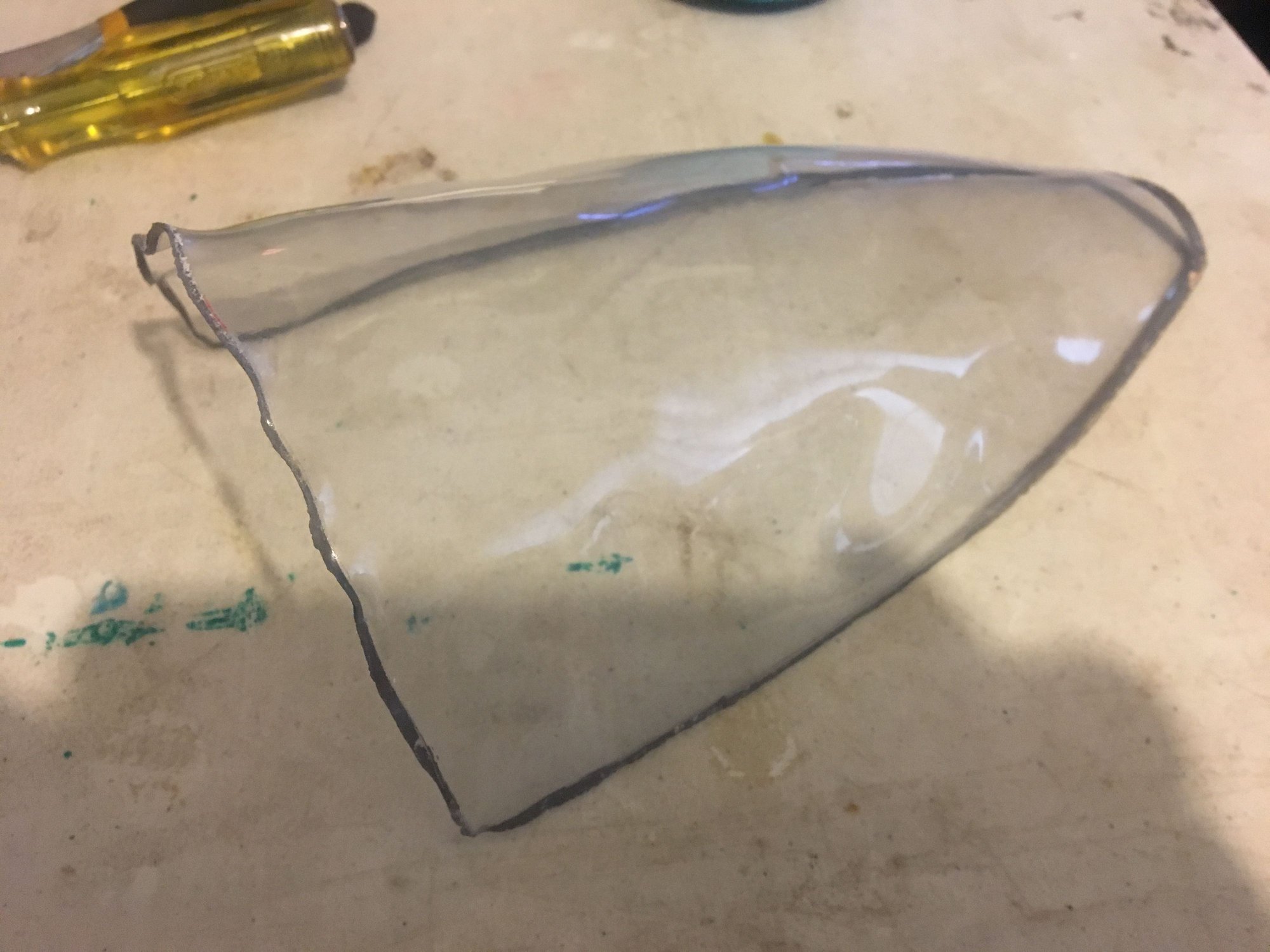

Wow! I would never have thought that a little acetone would hurt the canopy that much. I'll have to make a mental note to not use acetone on canopies! I hope you get a replacement soon.
For lighting, I used unilight. I like their 8 channel controller and I went nuts with lights. I even have some special extra stuff. More on that later.
All that's left is to do some engine runs, clean up the install, install the cockpit and pilot and then balance!
And this is not a small airplane either. It is difficult to manhandle this thing around. I find that I am always putting too much pressure on the engine nacelles, then the slats, the gear doors,etc.... I can't imagine what it would be like moving a Mibo around for assembly!

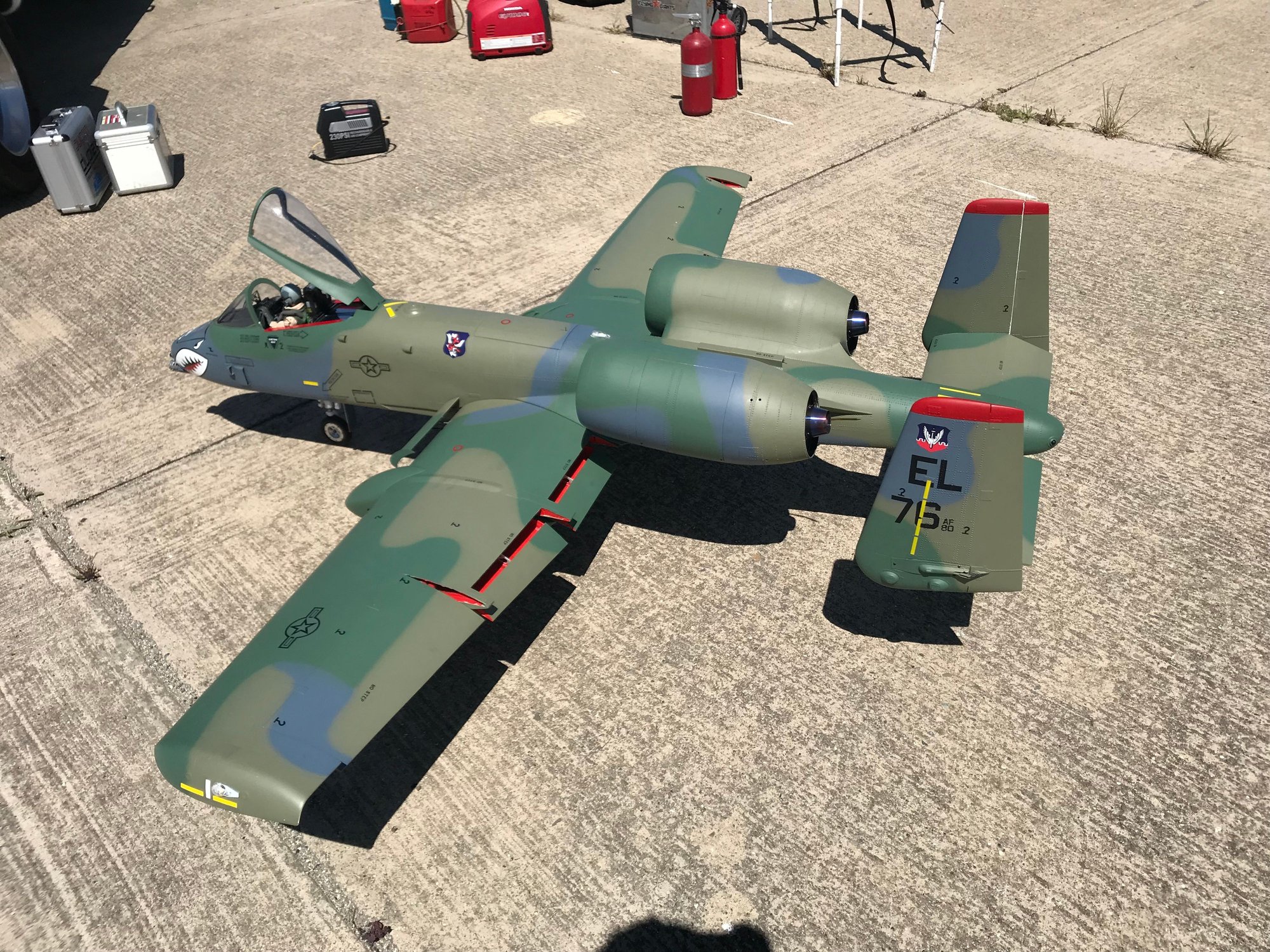

Woohoo!
Successful maiden.
It needed the elevator trim pretty much right at the blisters, thank you Nick.
The rudders have a lot of authority.
This was many firsts for me so I was a bit more meticulous than usual. New radio system (Jeti DS-24), first twin, new servos (savox), sound system (!), new engines (Kingtech G2's) with onboard GSU's, first time with demon cortex pro......
Since I had not had the chance to run the engines full throttle, and then pick up the airplane and move it all around at home, as the engines are too loud, I took the opportunity there. I've learned that you can have occult fuel bubbles that can be flushed out in this fashion. And sure enough, a bubble flamed out the starboard engine! EEK! But that is what ground checks are for. All subsequent full throttle shake downs were unremarkable.
I found that it had smmoooooottthhh take offs. It reminded me of my F-100. Those kind of take offs, make for a much less stressful flight.
My first landing was super smooth and my second landing had a small bounce and I found a crack in one of my landing gear blocks that I added to accept the BVM gear I'm using. I think the screws that I used to hold the gear on are too short. That should be an easy fix. Unfortunately, this grounded me for the rest of the day.
I also found that I need to increase the gear door delay as the air was slowing down the nose gear enough that it would get stuck on the outside of the gear door even after hitting the gear switch on rotation.
All in all, it was a successful maiden. I've got a few more things to iron out (I was ironing things out all day!) and I didn't have a chance to activate the gyro and play with it, so I'm excited about using it!
Check out my sound system! (Make sure you listen towards the end too, to hear and see the gatling gun!)
