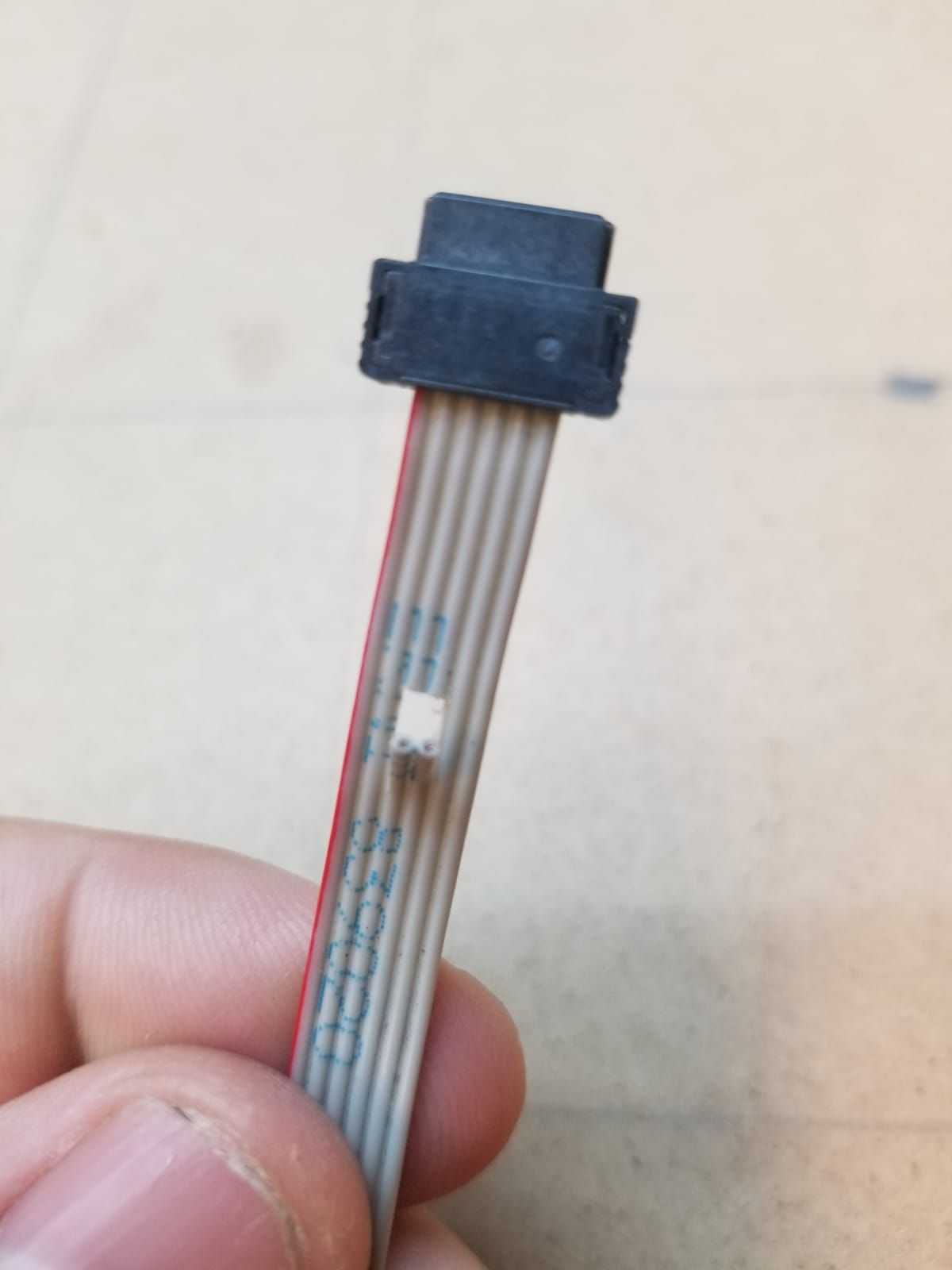

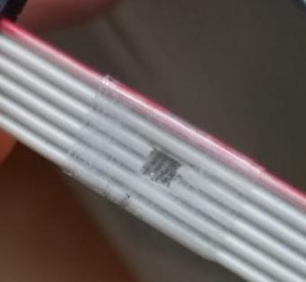

Testing the mod on a JetCat 140RX. Before, I got 'pump disconnected/connected' messages on GSU in full RPM. I did one run after the mod and seems like it's Okay now.
Originally Posted by Carsten Groen View Post
Great George
Regarding the GSU, it is (unfortunately) a well known problem A quick fix (if you are up to it), is to cut the 2 center wires in the gray flatcable that goes from the ECU/IO Board to the CTU. This will fix the problem (the long technical explanation is that the ECU/GSU have low resistance to load on the I2C bus from the ECU to the GSU (which is also coupled to the CTU, but not actively used).
So, basically cut the center two wires.
On the picture below you can hopefully see what I mean, cut the two wires with the green lines on them
You need to be careful splitting the cable, but with a knife or a wirecutter it is pretty easy

Hello! First off, I want to say great job on a very neat device for telemetry!
I'm having an issue on a Jetcat P100RX, Jeti DS-16 i'm setting up. After doing the LearnRC steps, I remove the I/O board and plug the 6-pin connector from the ECU V10 into the CTU. Upon doing so, I lose the ability to control the turbine. No start sequence or telemetry... The blue light comes on by the ECU port.
I can remove the plug and place it back into the I/O board and all works fine. Do I need to do this cable mod, or can I run a second ERNI cable from the 2nd I/O port to the CTU? I called AeroPanda and they referred me here.
Help....
Thanks, and yes, please do the same mod as shown above
