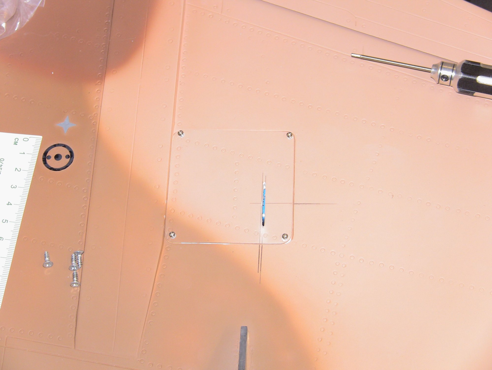

What's that plate you taped over the main tank?
I cover it in the video but SM cut a random hole in the tank in an odd location so I had to seal the hole.

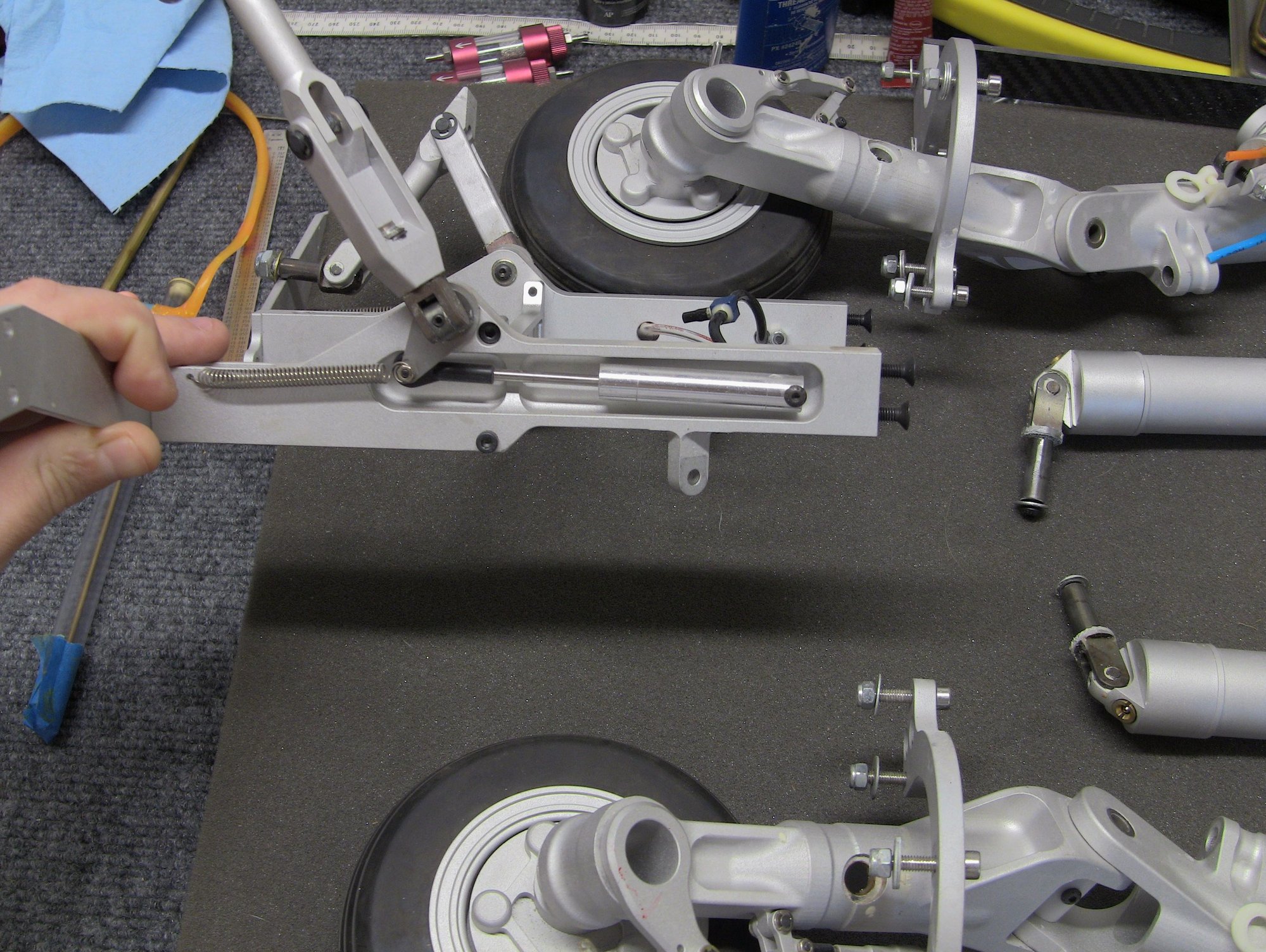

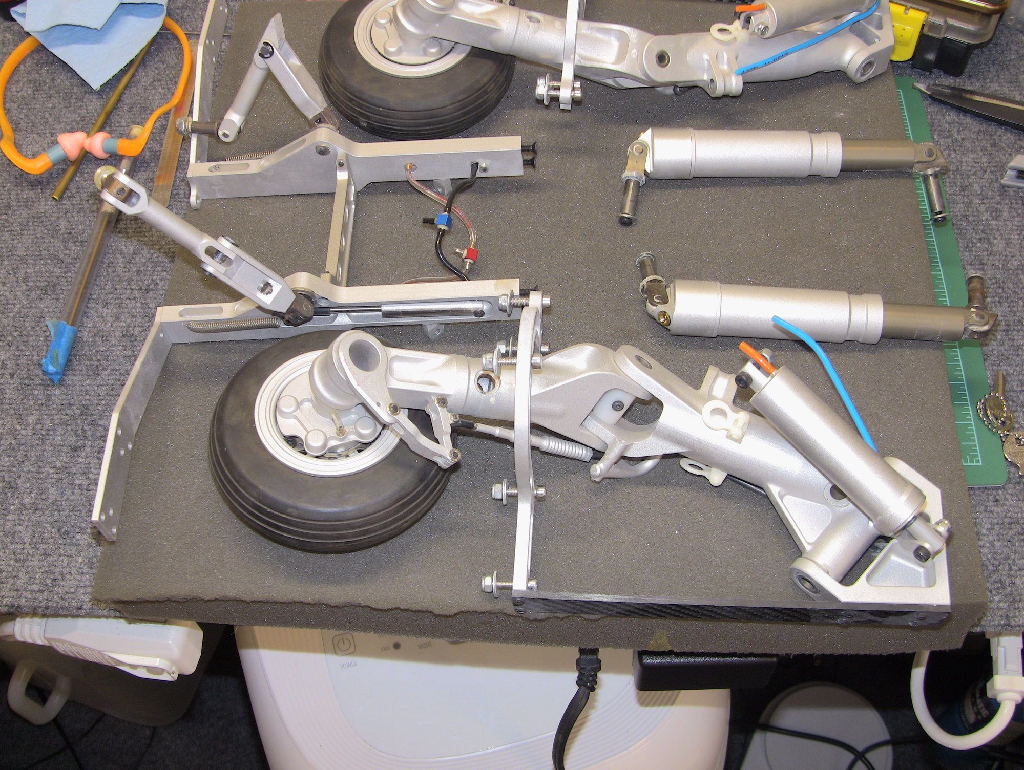

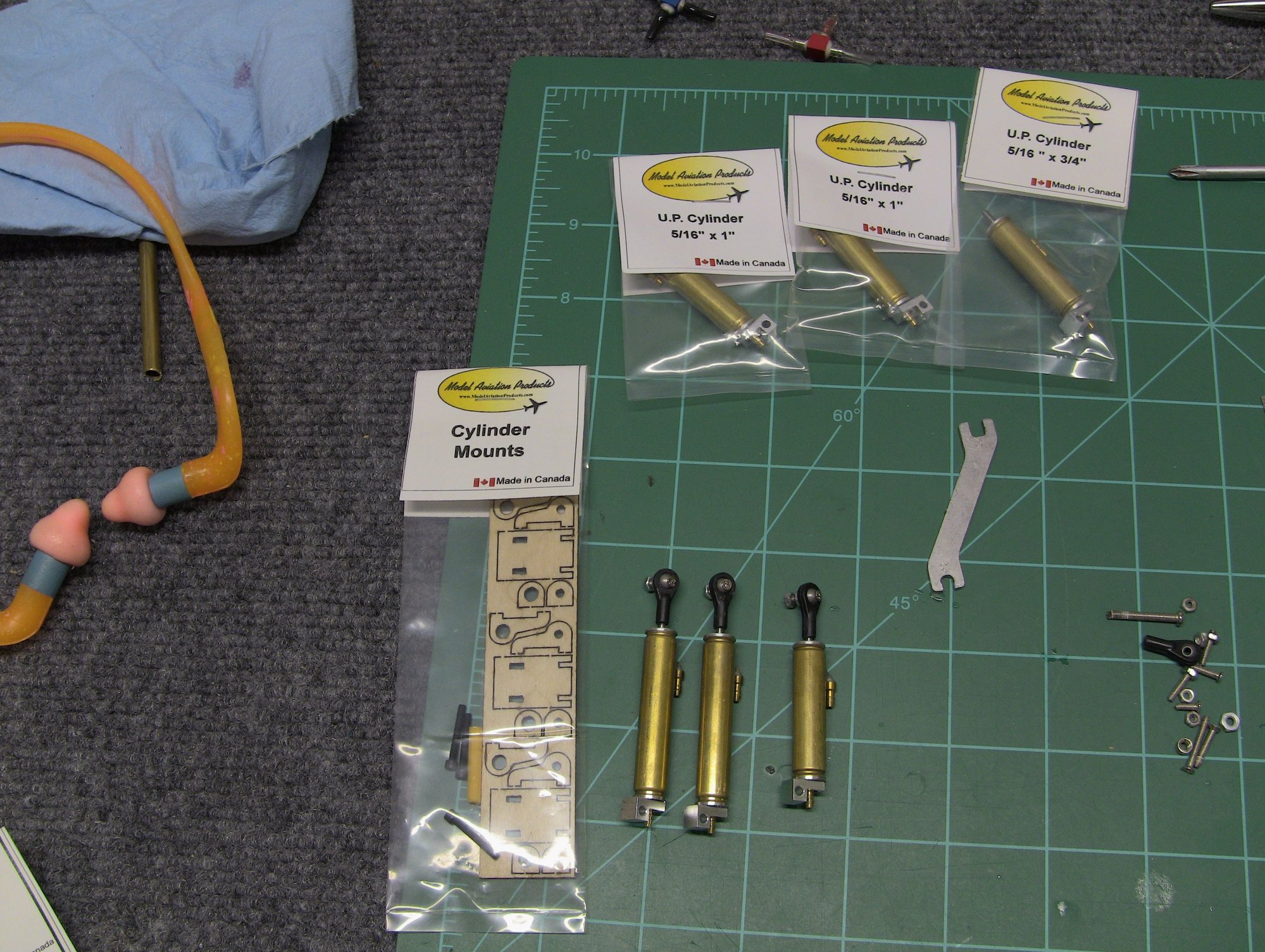

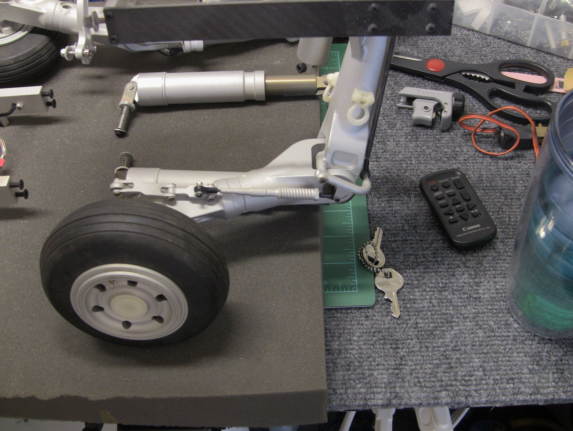

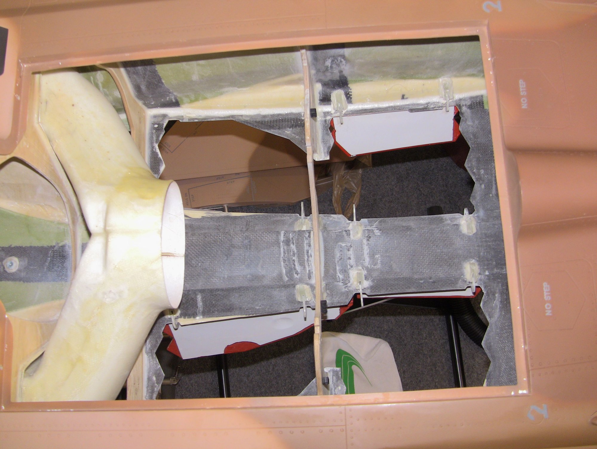

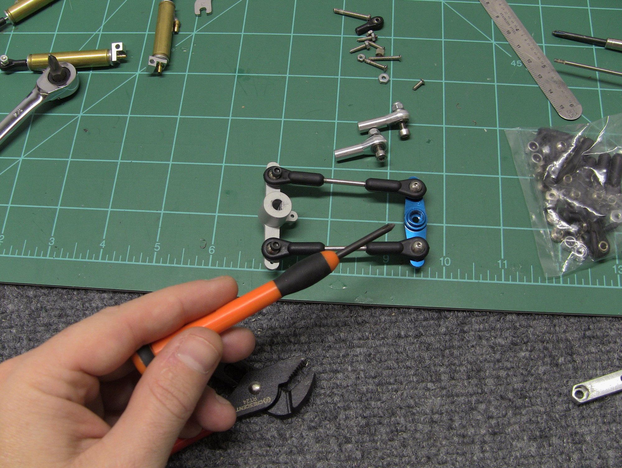

Didnt do much today, I had to take the wife car shopping. I did finish the tanks and need to hurry up and install the main tank so I dont have to look at the patch job, my OCD can't take it lol

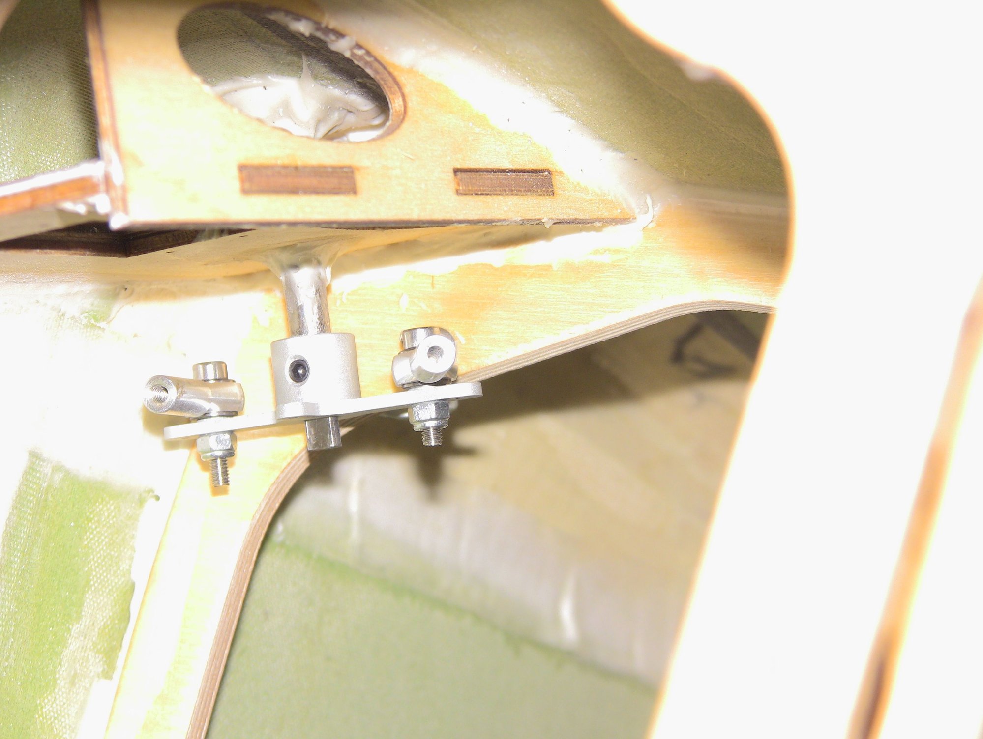

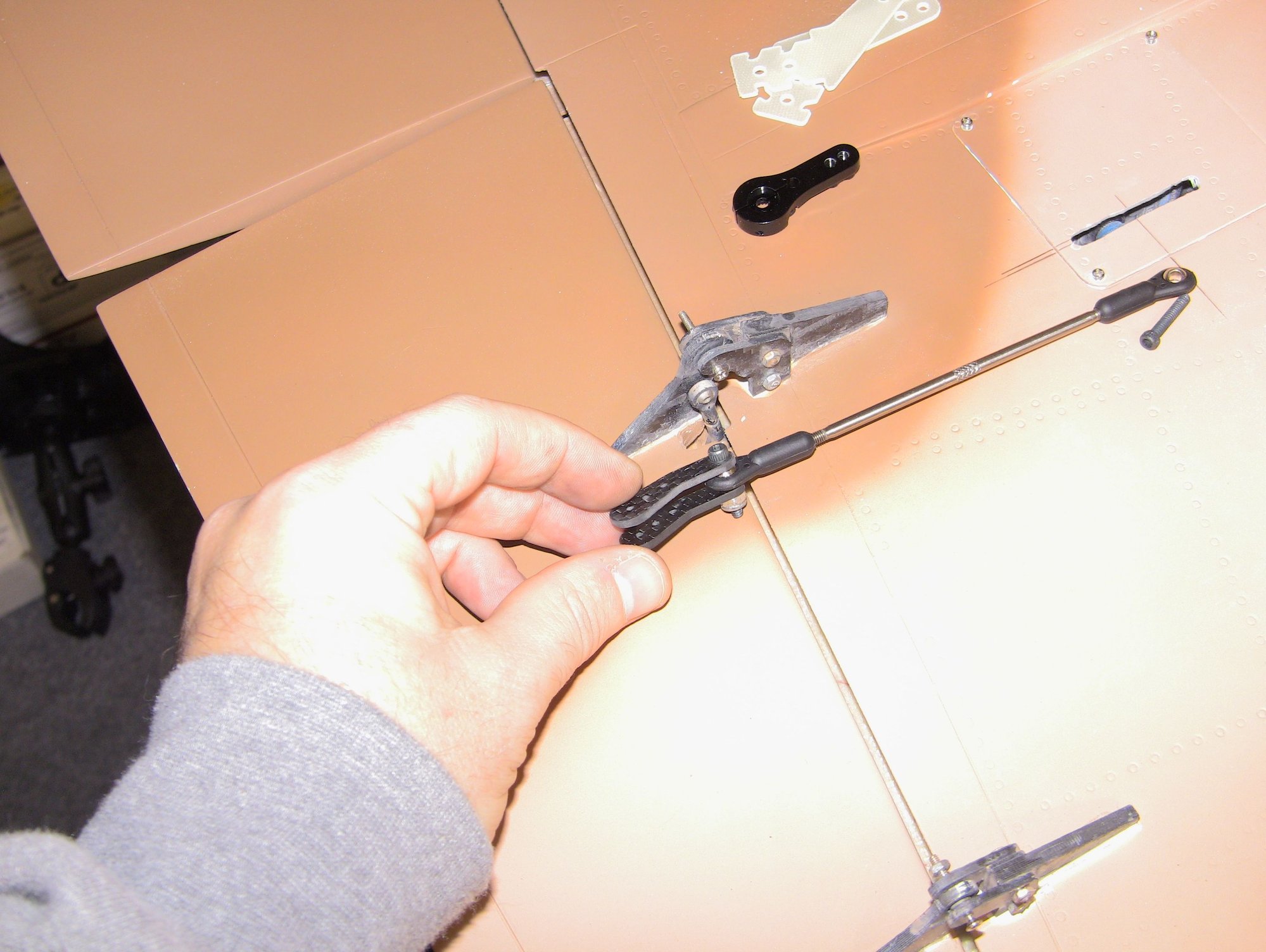

I also fitted the stab servos in the tail, a bit of grinding to get them in and just like the F-14 I will be beefing up the servo screw areas. They use the typical soft ply for this and the rudder mounts so it needs so extra love.
I want to note this stab drive arm needs to be aligned with the shaft of stab both vertically and horizontally. The last picture is all the hardware for the rudders, I'm ditching the brass clevises SM provides for my typical dubro ball ends. Video is uploading as well on youtube, pay no attention to the paint chip in my eyebrow and focus problems lol
Critical area, be sure to align horizontally and vertically
Roll Tide

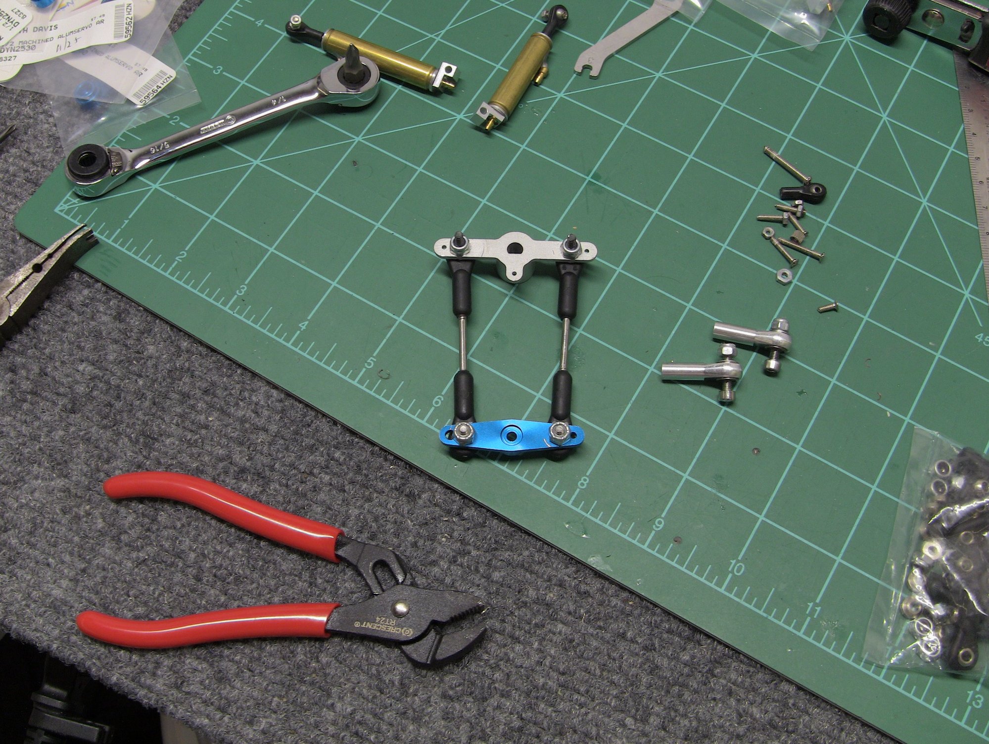

Rudder setup, I will be ditching SMs brass clevises and using my typical dubro ball ends
FenderBean is online now

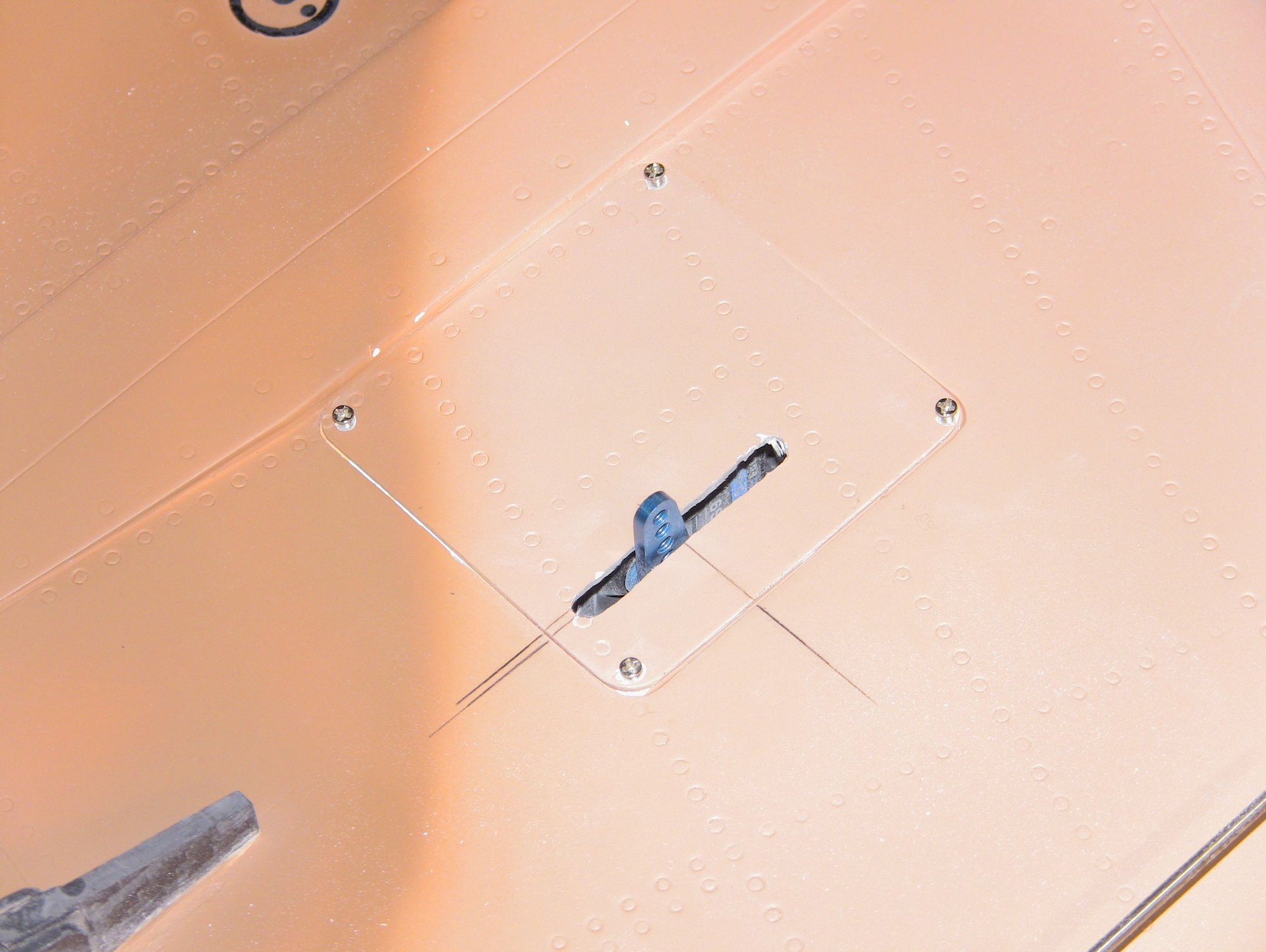

Small update, I spent all afternoon putting in the two stab servos, I glued in some extra wood on the backside of the servo screws and I used longer servo screws as well. I used some carbon fiber servo holders to help give a super strong hold.
I had to add something between the servo and the ply to lift the servo so the arm would clear the outer skin, I initially use some small ply blocks but realized I had more carbon plates and used them instead. Super secure and no worry of the servos screws not holding, I even ran some CA in the holes like always to top it off.
Next I trial fit the stabs to see how much area I needed to trim to allow for max throw up and down(see picture below) I will add the metal insert to the stab tomorrow, I switched gears after the stab servos took so long and removed the landing gear. That was a pain and there is a trick to it, it will not come out hole and some of the bolts/locknuts are rough getting out. I took a couple pictures before I started the process and finished cutting out all the SM's airline. Tomorrow I will work on the rudder servos and possibly changing out the air cylinders on the main doors. I am switching to ultra precision like I did on the F-14, I have tried everything with stock cylinders from SM and they always leak. Save yourself the head ache.

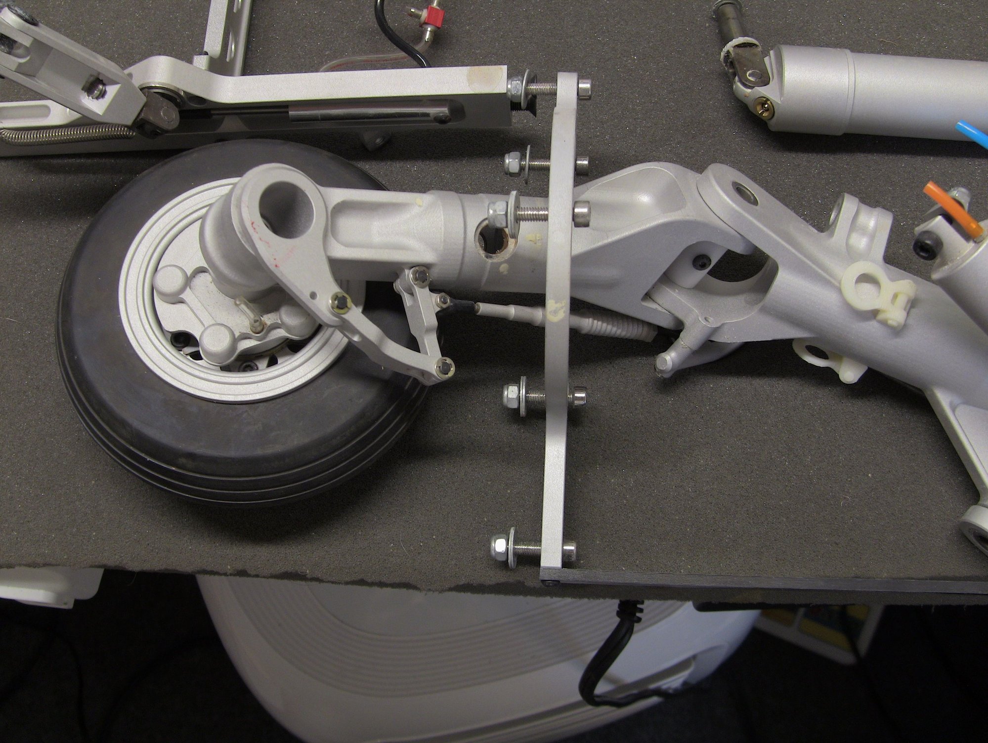

Also I noticed a lot of the screws and bolts on the gear loose so if you don't remove it at least check them all. I have to paint mine so it needed to remove them for the paint.

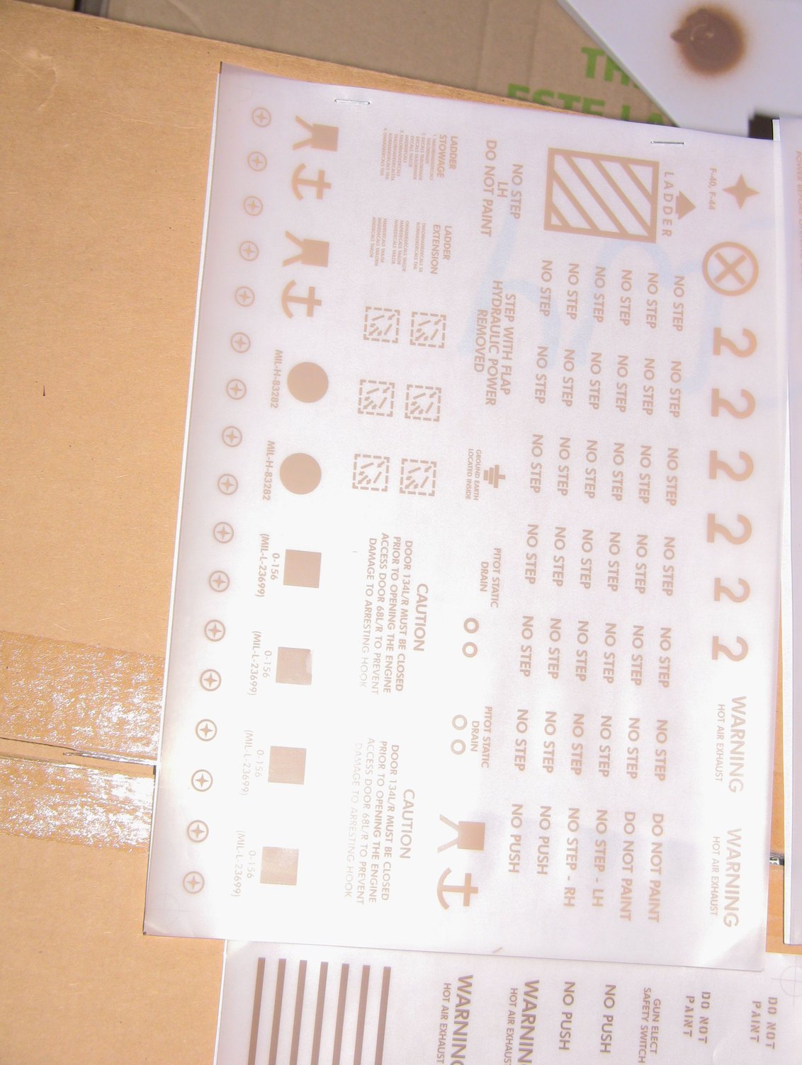

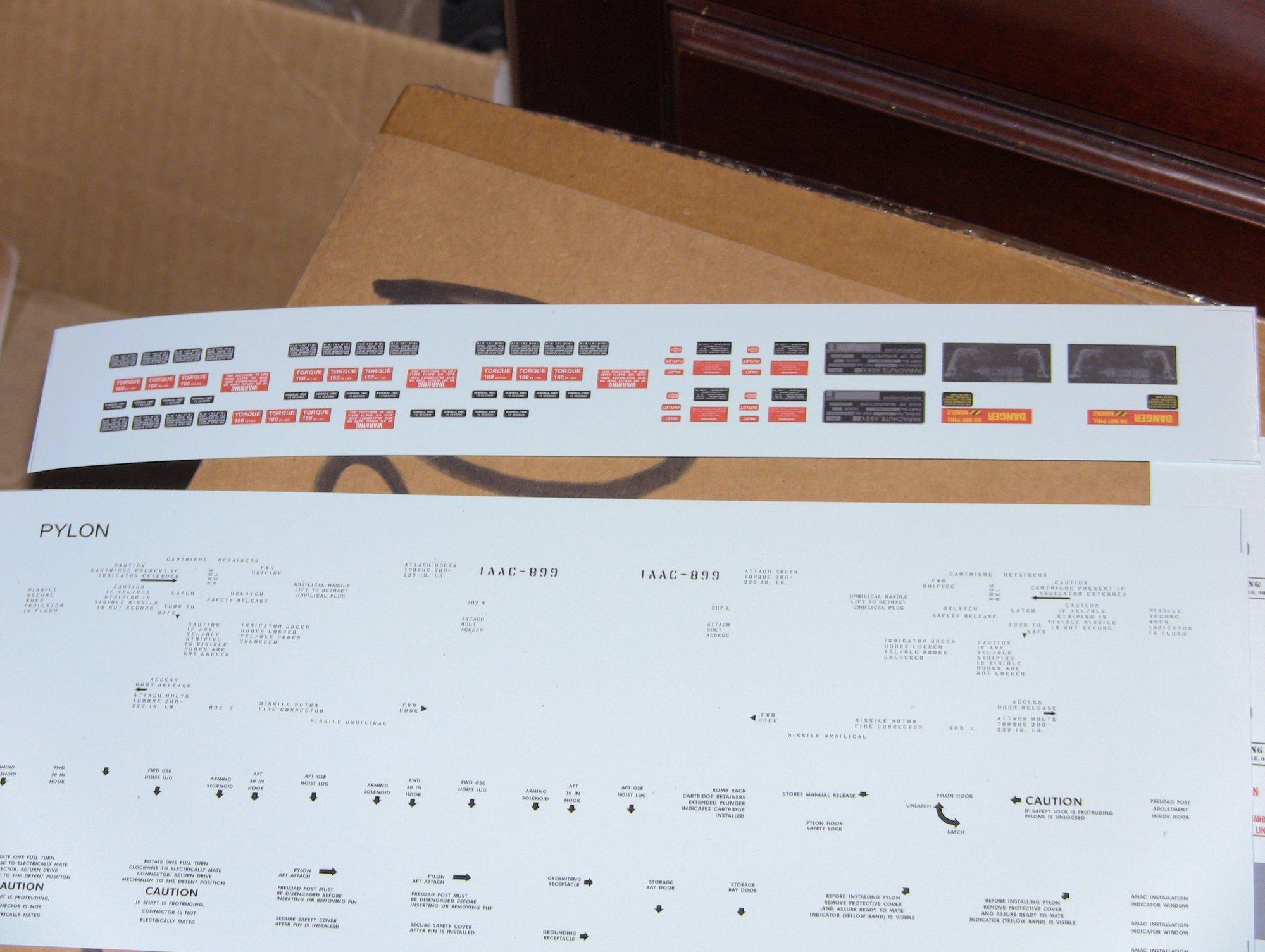

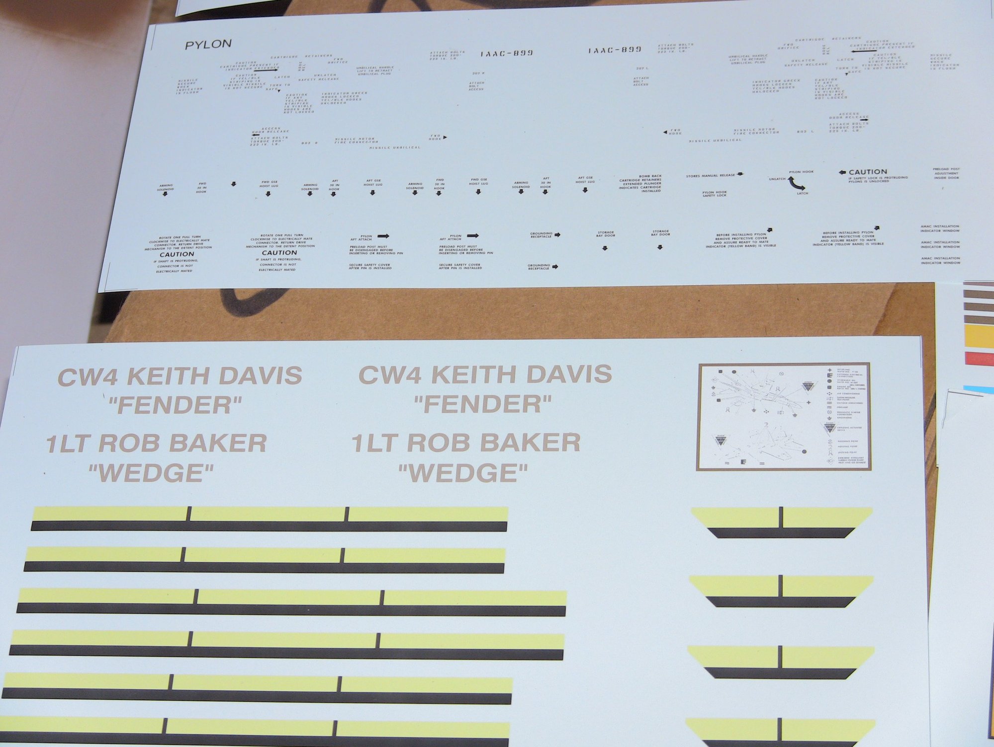

It's my pleasure, enjoying sharing the experience! Just a small update today with another video, Texas went full winter today and its just a bit cold in my trailer to work much. I did start the rudders, im sooooooooooooooooooooooooooooooooooooooooooooooooo oooooooooooooooooo glad the servo box cut outs for the ruder servos were the correct size. Having to custom fit with them in the current location would have been impossible, so win for me! Please take not to the how I put the control arm on the metal shaft, if you reverse this it will not give enough throw because the arms will hit the screws behind it. These screws/locknuts are for the rudder mount brackets. I am going to use the heavy duty futaba arms, they are not metal but I cant break them by hand so they will do, im also using four carbon fiber servo plates to act like washers for the servos screws. I did this on the Stabs as well
Thats about it for today, hands got too cold so I called it, I did want to show you guys the AWESOME decals/paint mask I got from tailor made. Lots of detail, from the gear decals, pylons, tanks, missiles and cockpit to the standard markings. I wasnt expecting SO much, I highly recommend them and will use them from now on!

Not sure why the bottom few turned sideways, top few are water slides and the bottom are rub ons

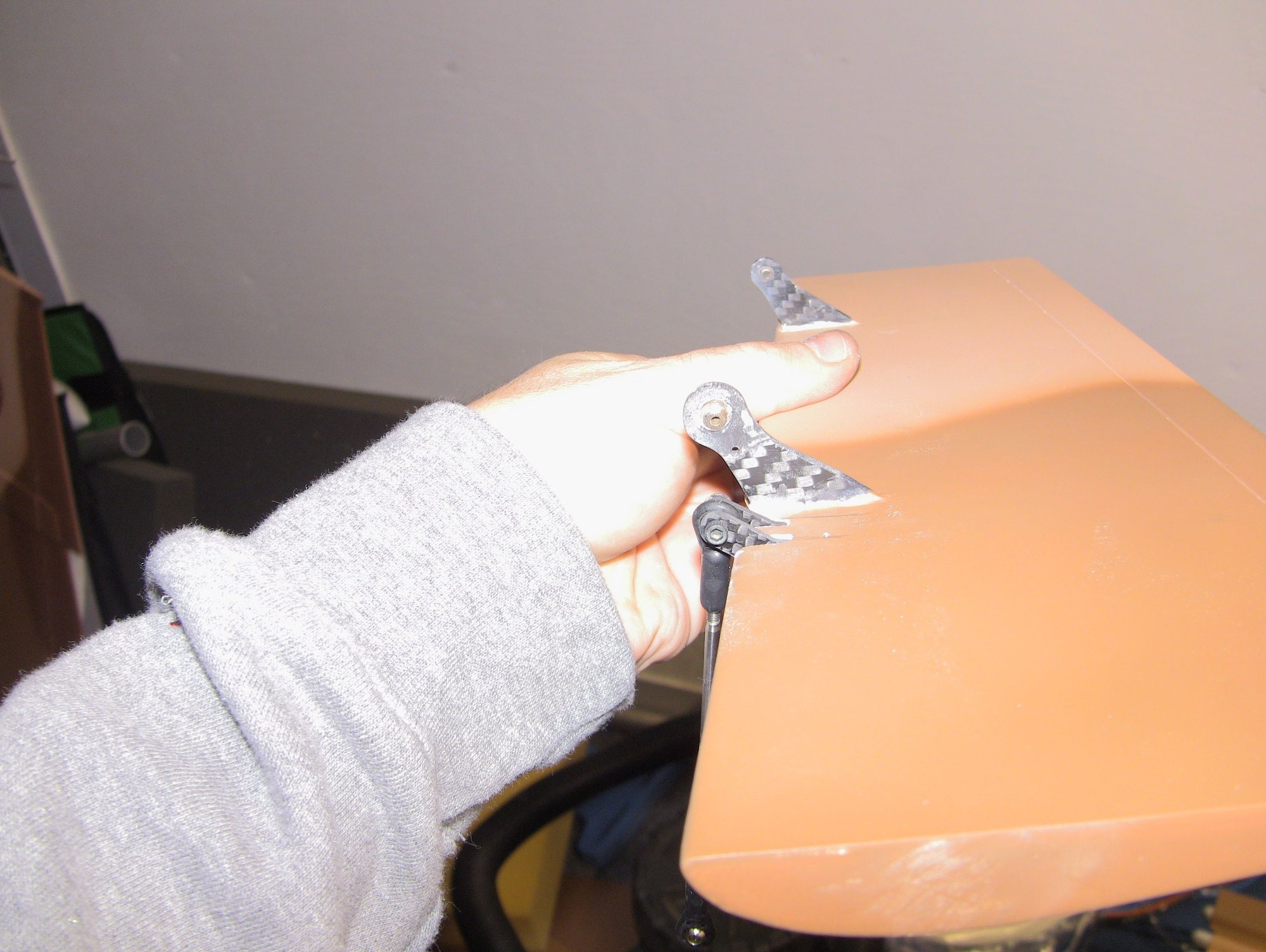

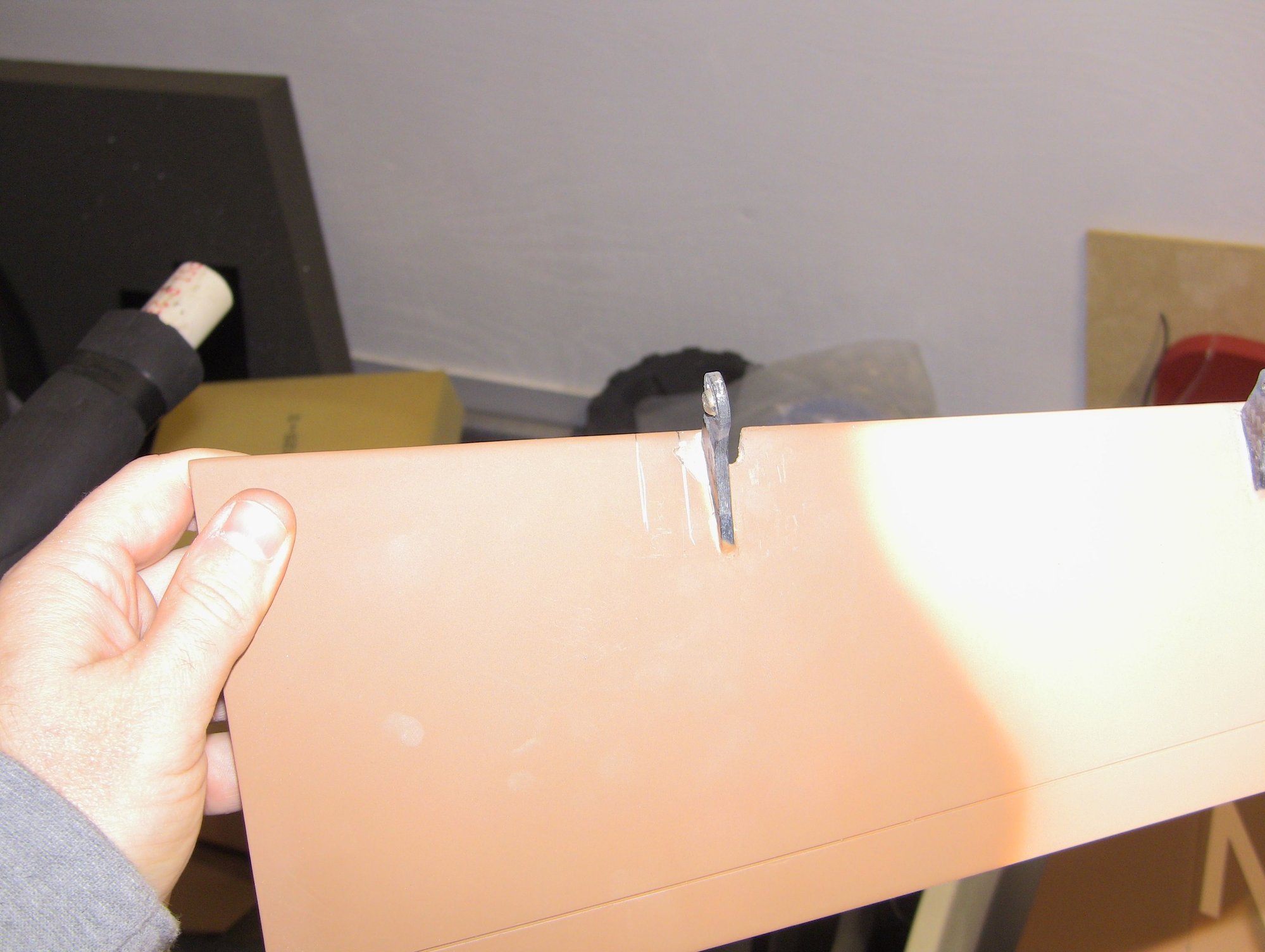

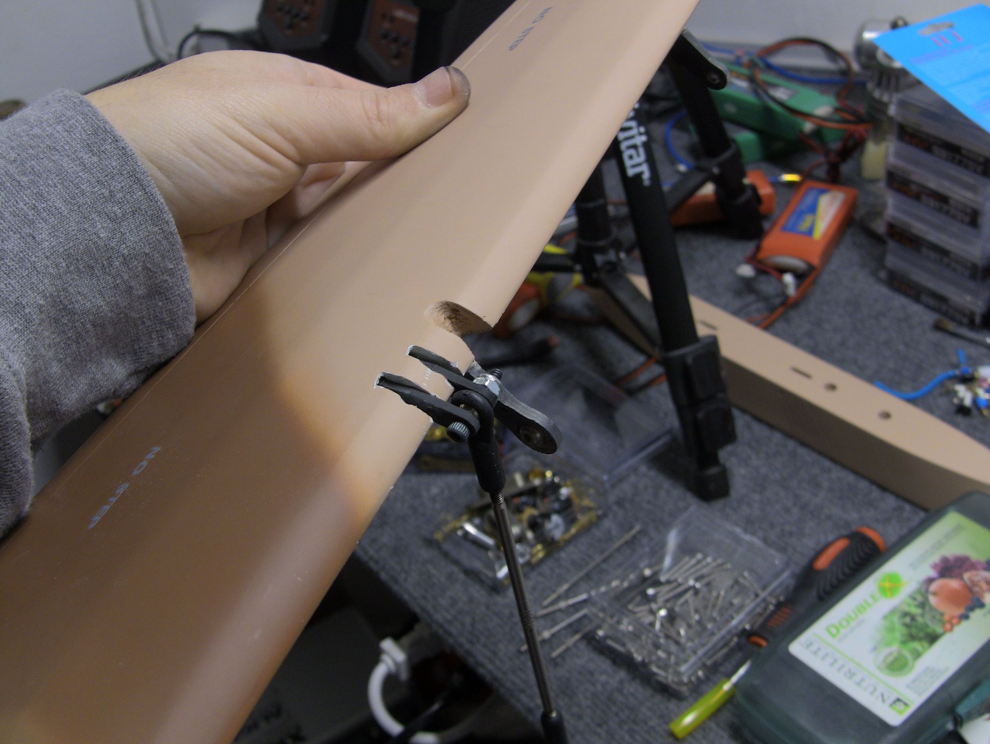

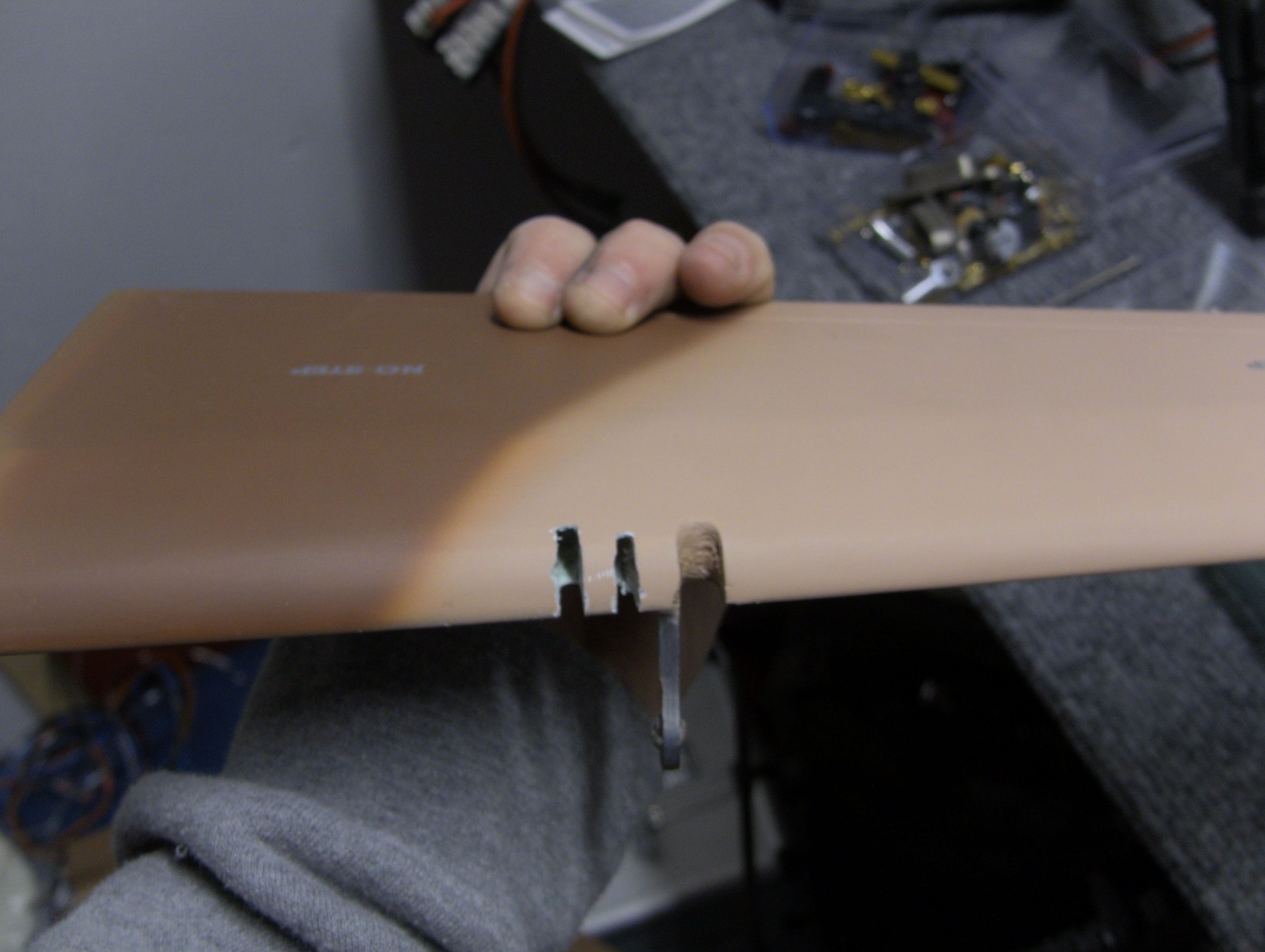

Notice i installed the horn so its just below the center line of the leading edge. (Mod Alert) The prevents have to butcher the trailing edge of the wing for rod clearance. (Mod Alert)
You have to butcher the wing no matter how you do it anyway. I remember I had to Dremel half the rear wing cap to get the linkages to work. Was not a great feeling cutting up a new plane to make work.

How is that brass ball held into the CF horn?
