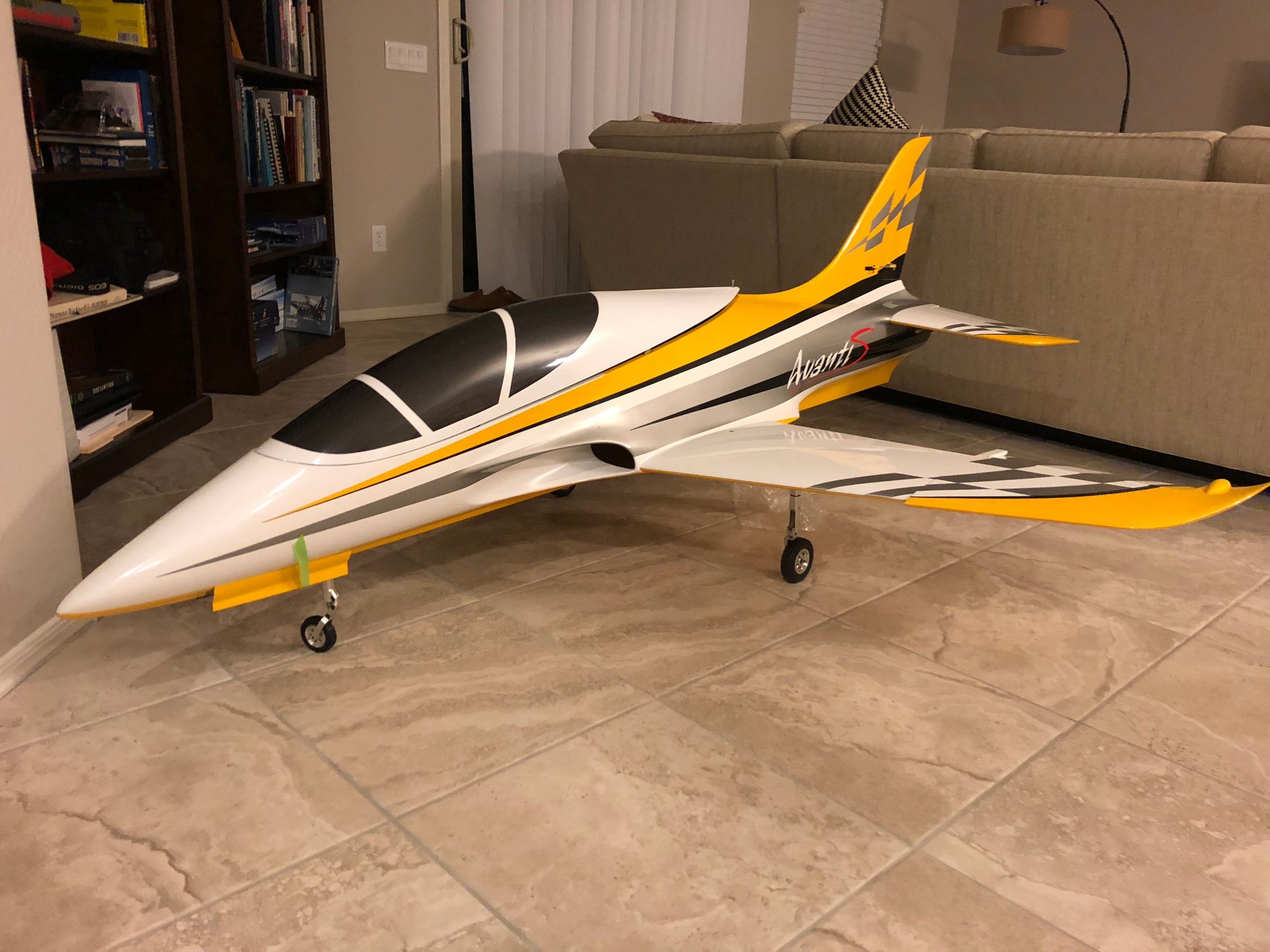

Well this is my third Jet and it will be my first build. Iíve had COMP ARF Eurosport which was magic an then a 2,5 M FB Viper jet.which is big and loaud. The Swiss trainer scheme make it easy to see in the air it give it great presence.
i wanted a smaller plane than the Viper with very good flying characteristics, all composite with European guality. Cekeslovokia make the Jeti radio an the Krill line of models. I ordered an Avanti s Jet and a Jeti DS16 radio. Lots of nice new toys to play with
I will be adding pics at times

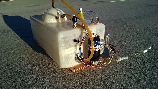

Hello I need a new fuel tank for my Avanti, where can I get a replacement?
Thanks for any advice.
https://www.jettechusa.com/collections/fuel-tanks-1

Hi all, here you can find all possible model tanks for AvantiS:
https://cmjets.com/20-sebart
regard from Spain
Carlos
