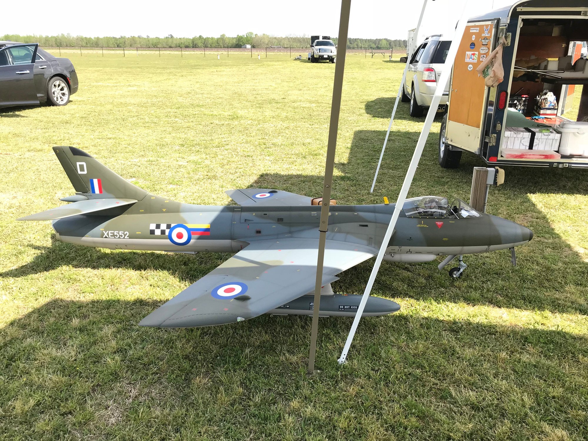

Frank, just finishing one up. How much weight did you have to add in the nose? Bringing it to MS Jets if I get some logistics worked out. Maybe well fly together if you make it there
Thanks!
furloughed ual is offline
Reply With Quote
Old 03-26-2018, 12:00 PM
  #30
Frank Alvarez
Join Date: Mar 2002
Location: Summerville, SC
Posts: 283
Gallery
My Gallery
Models
My Models
Ratings
My Feedback
Hello furloughed!
I've installed a 38 lb thrust turbine and due to its light weight, along with its peripherals, the total weight added right in the most forward (radome-like) area is 4.75 lbs!
I did "not" use their specified C/G of 130 mm beyond the axle center. My starting point was 115 mm, and after four flight on the jet, I've moved it back another 8 mm since. The manufacturers always tend to strive for an extremely conservative forward c/g. And I don't enjoy the resultant pitch-down moments when in an "other" than level flight attitude. I will most likely settle on the 90-100 mm point when time and additional flight work-ups allow.
Feel free to fire off any other inquiries.

The large Hunter kit from Fae-Bao that I built here is 56lbs empty, and 66.4lbs at takeoff.

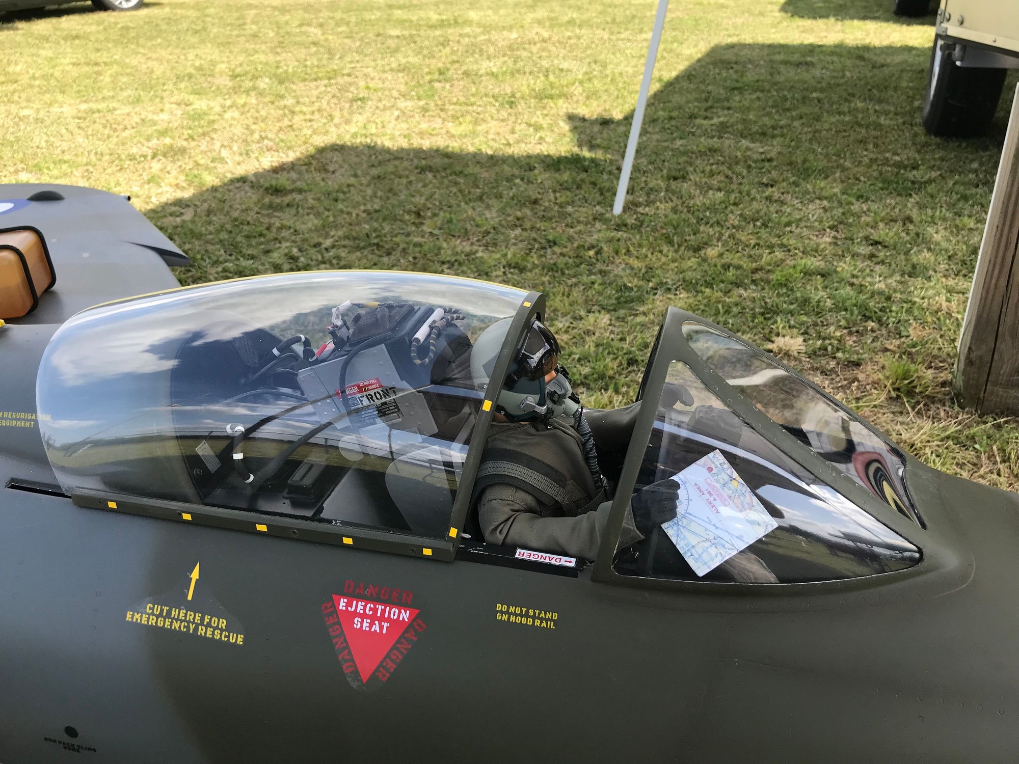

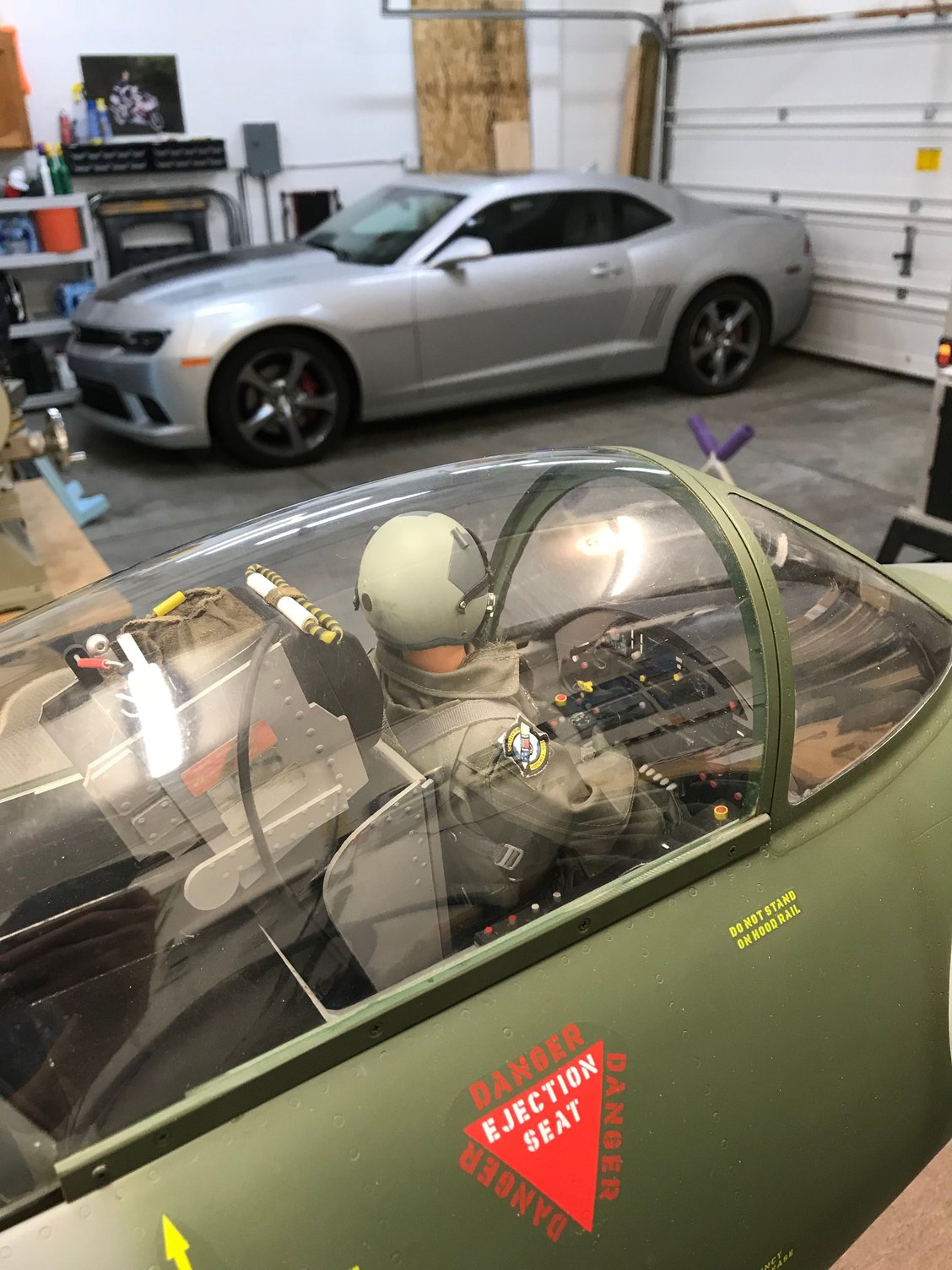

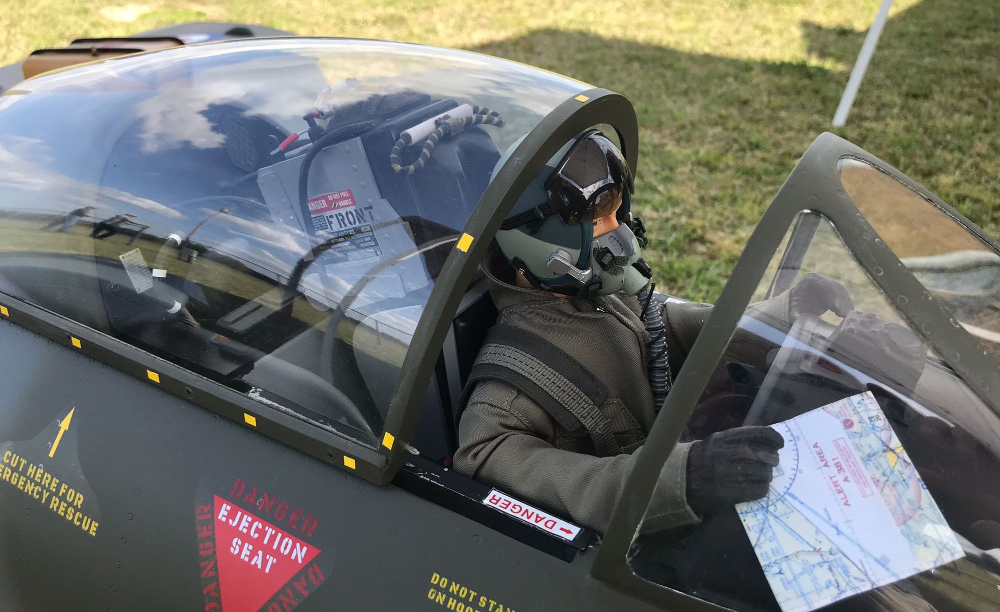

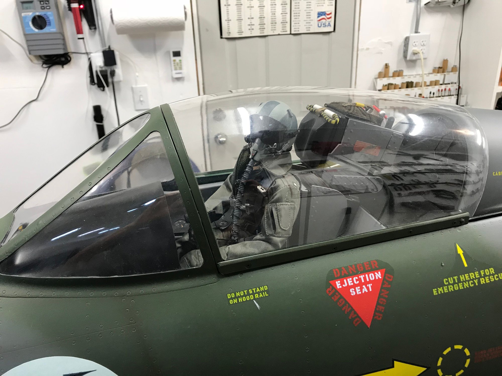

Frank, what pilot are you using in the cockpit? Scale of this jet is 1/4.3 but my 1/6 pilot is much too large.

Dave, here is the BB 12" pilot in my Hunter. I think it is sized about right. I tore the seat out and put him on a balsa block to get the height I wanted. Keep in mind you cannot get the cockpit out thru the canopy opening with this pilot in there.

Hello David,
I used the 15 inch jet pilot that was available from the good folks at Dreamworks.
There was some removal of the interior body foam/cotton to exact a nice fit. I also had to remove a good portion of the provided seat, and rebuild to allow for the larger fitted pilot to sit in a more scale-like position.
Mr furloughed is correct in stateting that the cockpit tub is “only” removable with the seat being vacant of the pilot.
Take care guys.

We just returned from a spectacular weekend of flying at the "Tiger-Field"
near Scranton, SC! Had many flights on our new Hunter and we were absolutely delighted with its performance! A highly recomended airframe choice for those of you that enjoy the "scale" aspect of the hobby!
We did unfortunately suffer a grounding event that luckily occured during a turn to finals....
The turbine compressor had ejected a blade or two, and thankfully this was on final at a low thrust setting. Normal landing with a slightly high pitched squeal from the engine and an imediate shutdown.
There is a slim hope with the repair, however i am aligning the purchase of the replacement as I write this.

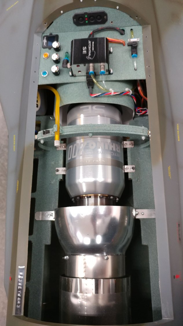

Hello folks,
Out with the old.....
And in with the new.....
Just mounted the Jet Central "Rhino-SE" !
Super smooth engine starts, and surprisingly cool running!
Does anyone have the brush-less fuel pump PW figure's?
Want to get an installed base-line number so as to keep an eye on the pump/filter performance as
I place this engine into service on the Hunter.
Thanks in advance,
