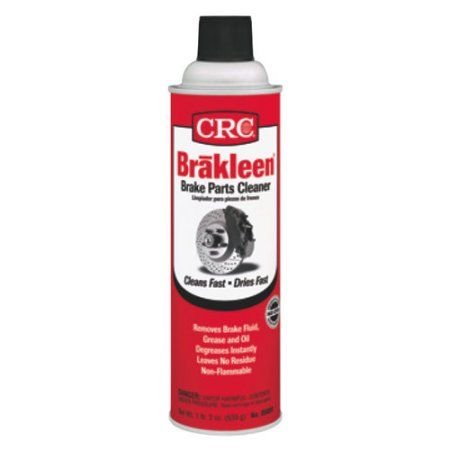

I've used Chlorinated Brakleen several times (the red can). It's cheap, effective, and you can pick it up at any Auto Parts store or Walmart. Degreases instantly on both fiberglass and balsa/plywood.

Keep the brake cleaner off any painted surfaces!

Brake cleaner works well, but it's harsh. It will eventually dry out the fiberglass and make it brittle. Not to mention, it can "Craze" any plastic parts it comes in contact with. It WILL absolutely kill lexan/polycarbonate parts. Because of that... it will not come anywhere near any of my models. (canopies are hard to replace sometimes)

Brake cleaner will leave a residue that almost as hard as the oil to get rid of, your painted surfaces will not appreciate electric contact cleaner.

Beware there are different types of Brakleen, that's why I posted the red can which turns to vapor almost immediately. The green can (harsher smell, more like carburater cleaner) can melt or dissolve things, craze plastics, etc. Just wanted to clear that up...The red can is used around automotive finishes, powder coating and will not harm them. Most jets these days are painted with Urethane topcoat....
