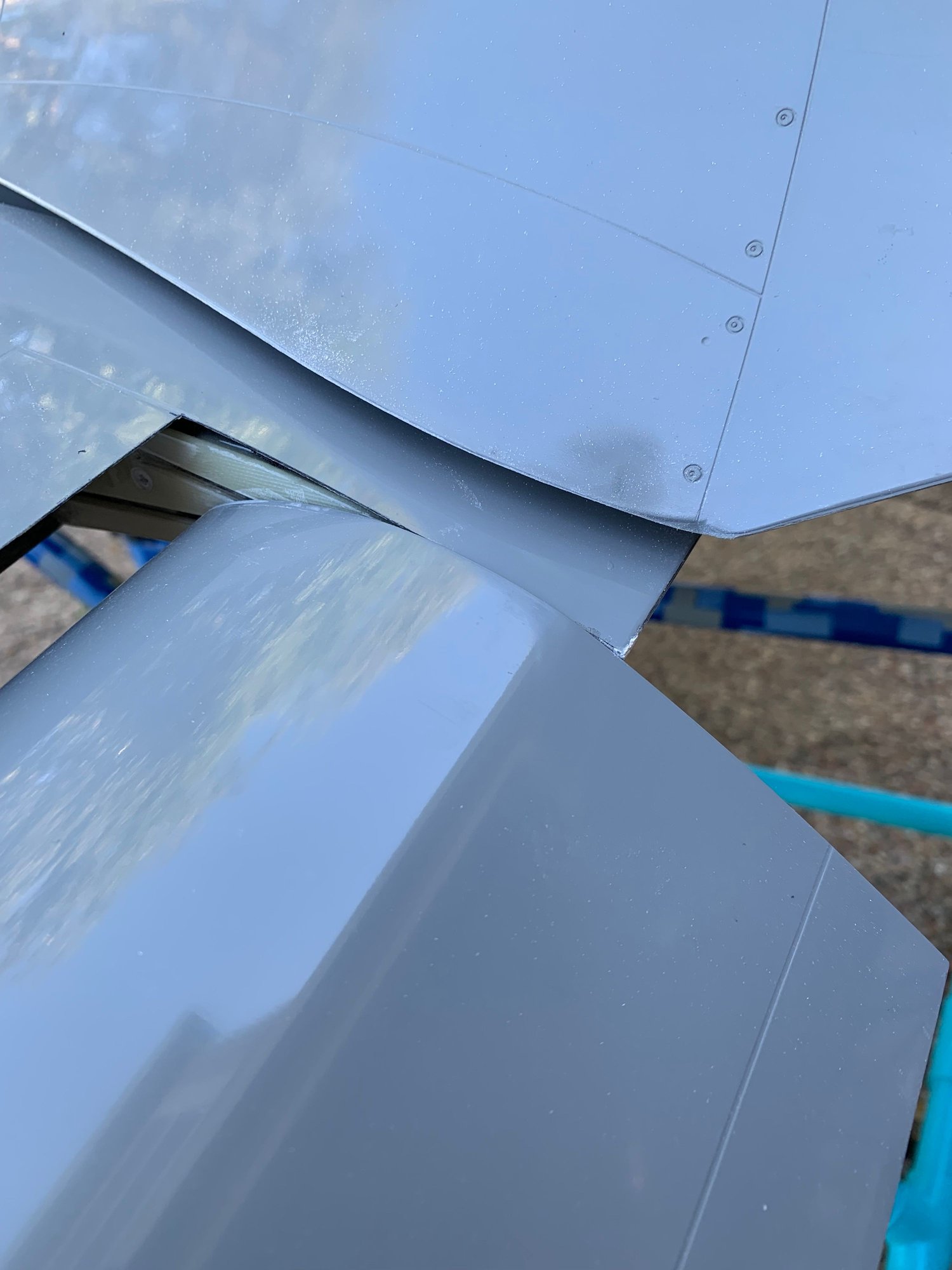

I ran into a problem with the “rootlets”.
The Fowler flap mechanism has the top of the flap move up 2-3 mm above the top of the wing towards the end of travel.
This is caused the flap to rub on the rootlet.
I had to sand quite a bit of material off the bottom of the rootlet so that the flap would not rub on the rootlet.
