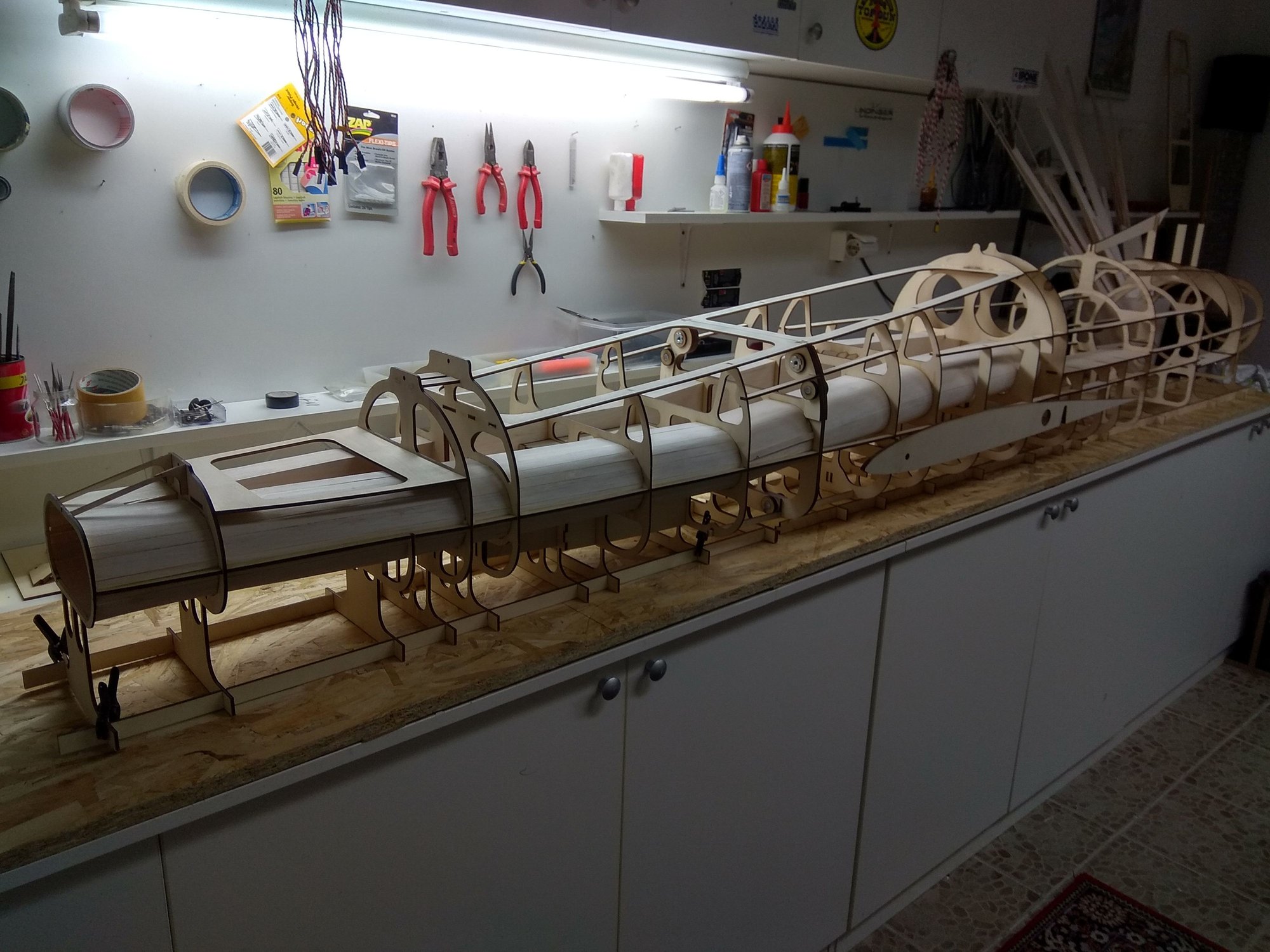

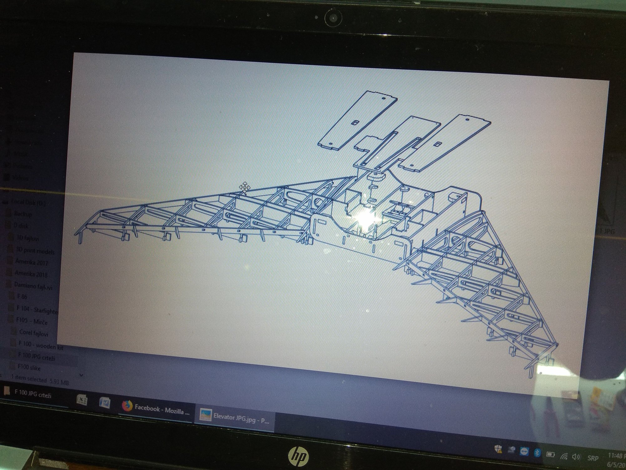

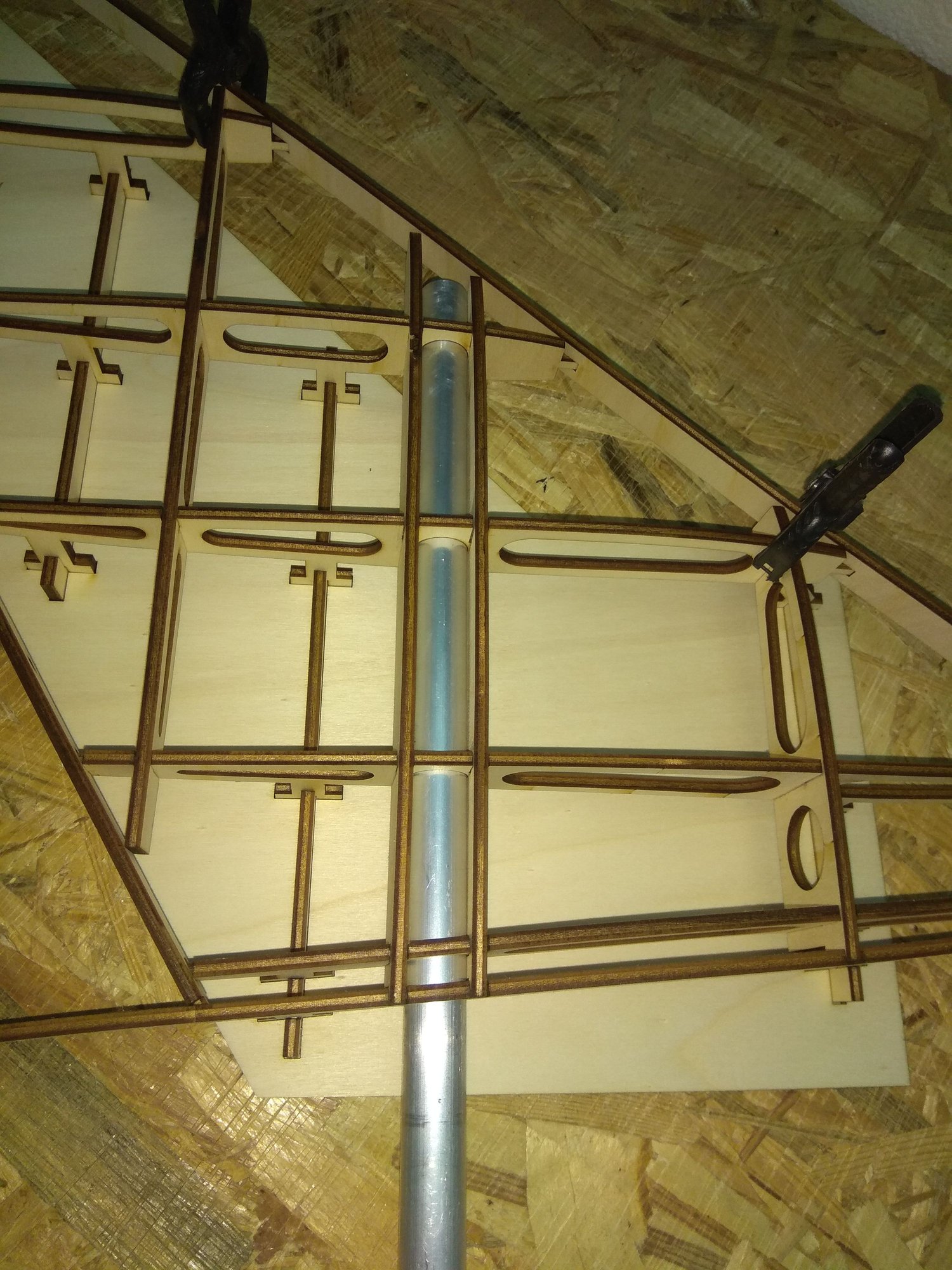

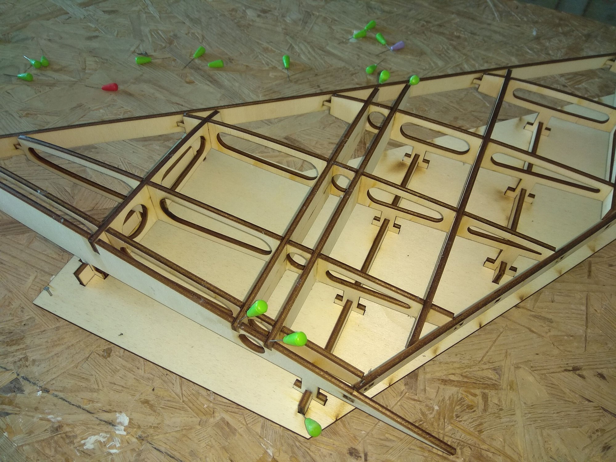

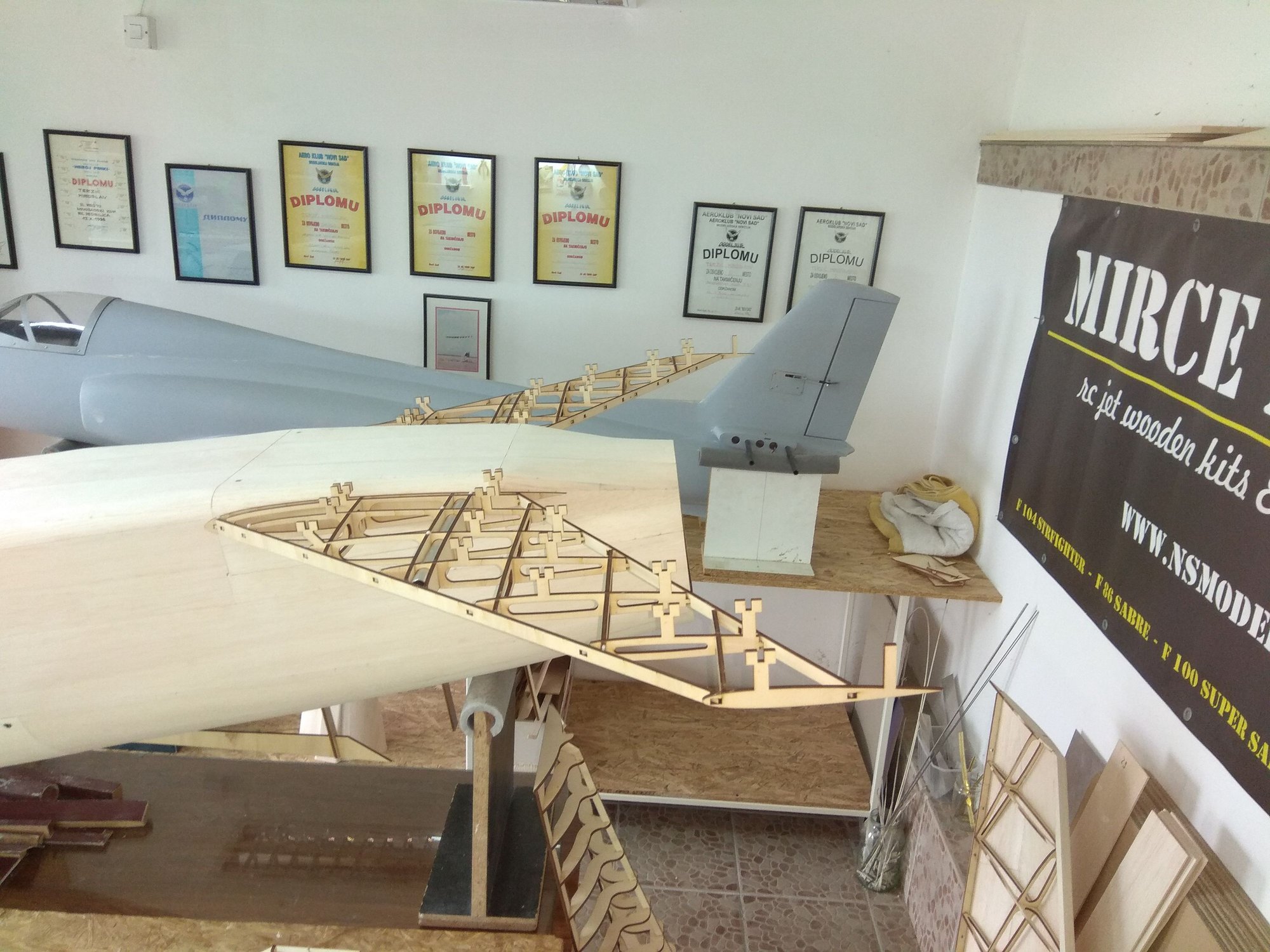

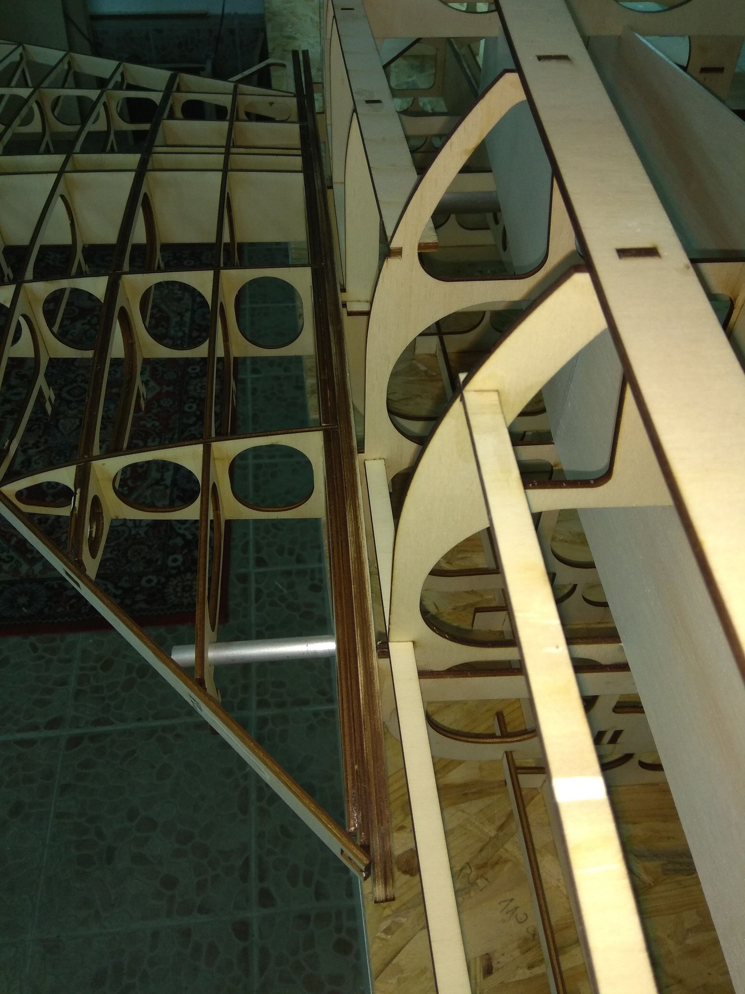

Thank you for comments.

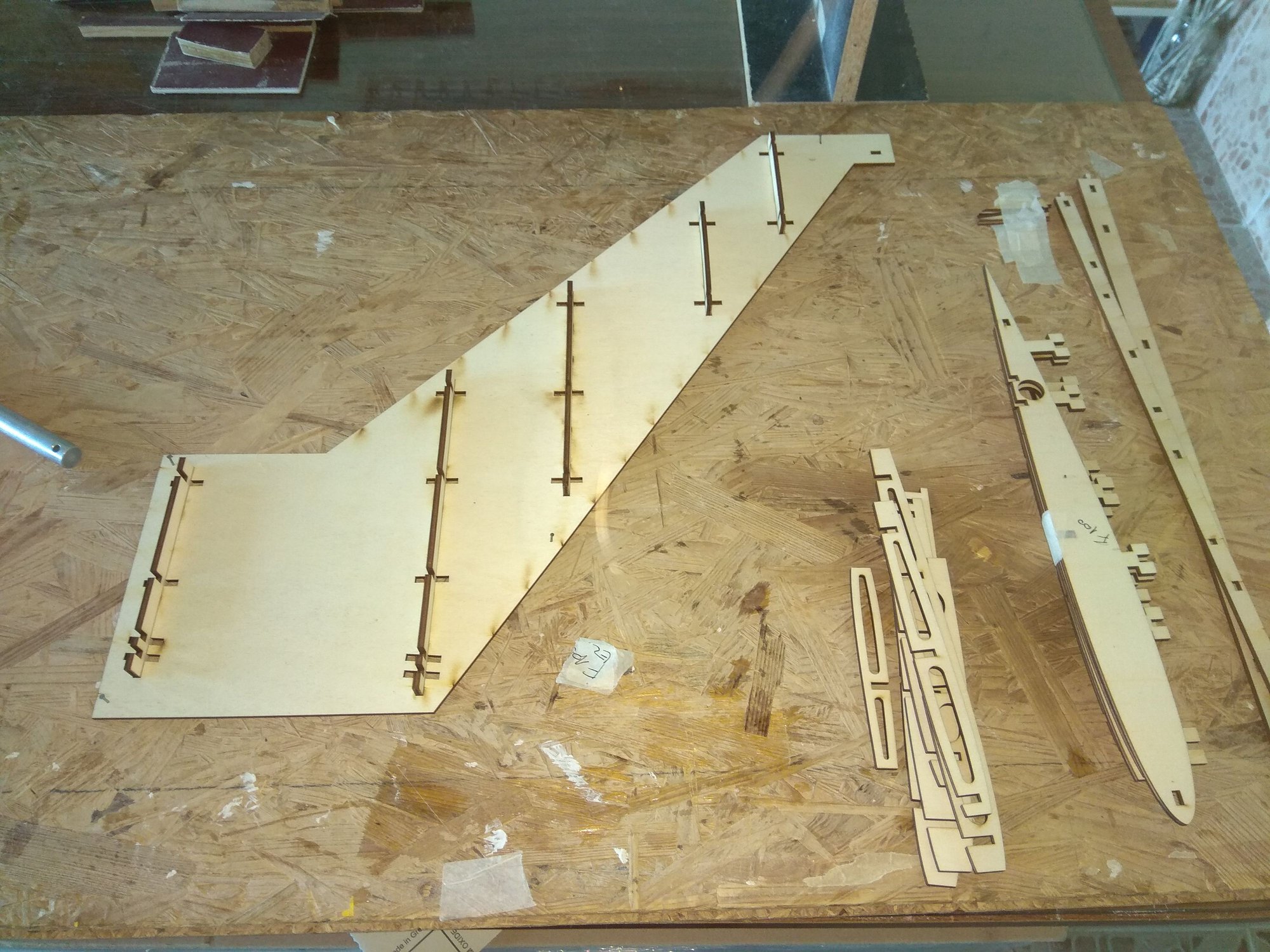

The idea of "Mirce models" is that the market offers a large jet wooden kit models.
3D drawings are made in the Catia program. Since model construction is first drawn, and then parts cut into a laser cut machine, everything fits perfectly.
Theoretically it is not a problem to reduce the model by for example 25%, but then you need to re-draw some parts, make a new cabin vacuum tool, aluminum tubes will not fit, etc...
The thrust tube can be ordered from the manufacturer in your area.
Model have full inlet tunnel.

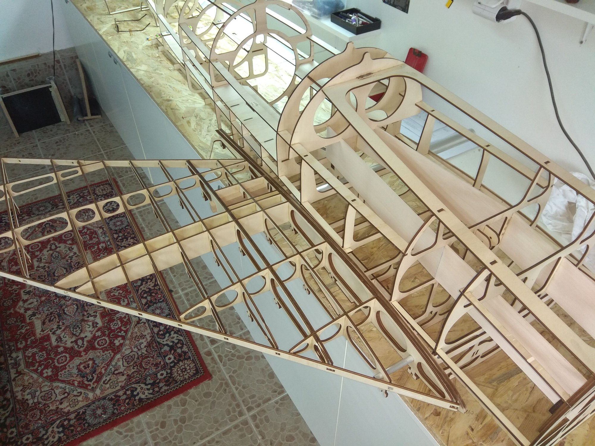

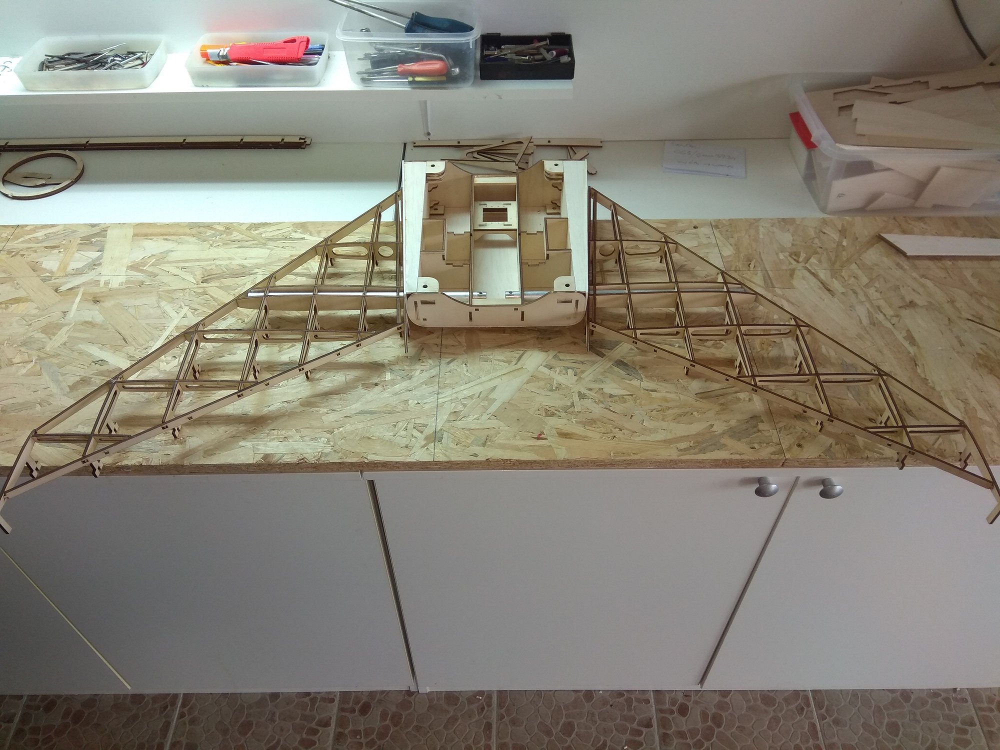

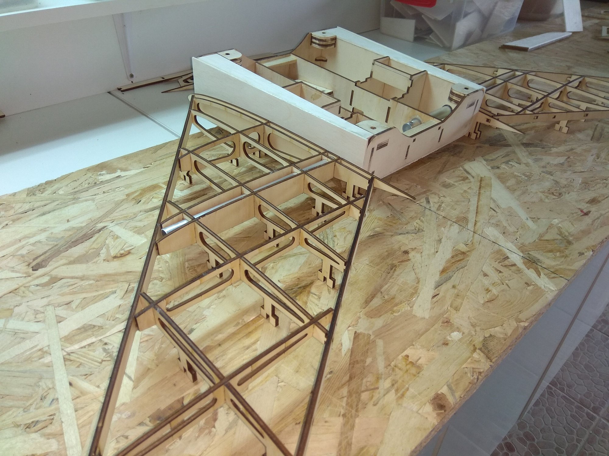

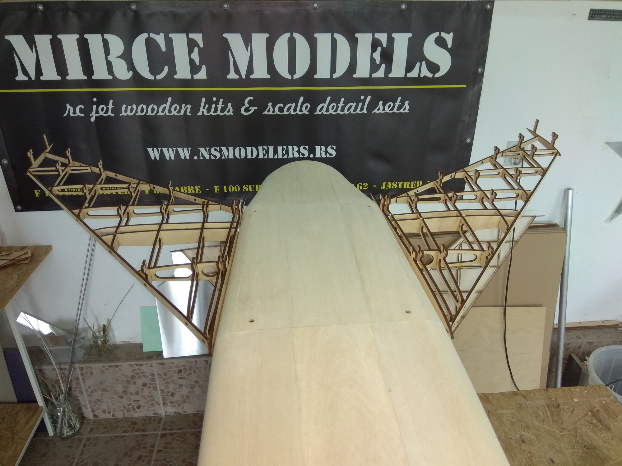

I measure wing in this phase, not bad for so huge construction...
And few photos how wing fit on fuselage...

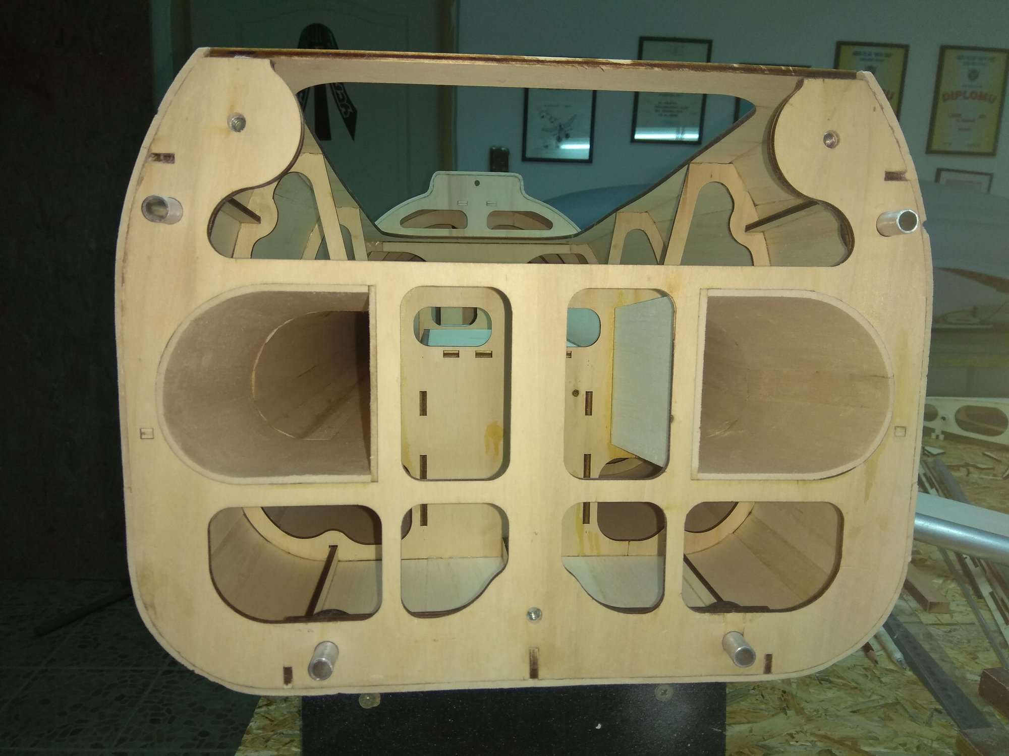

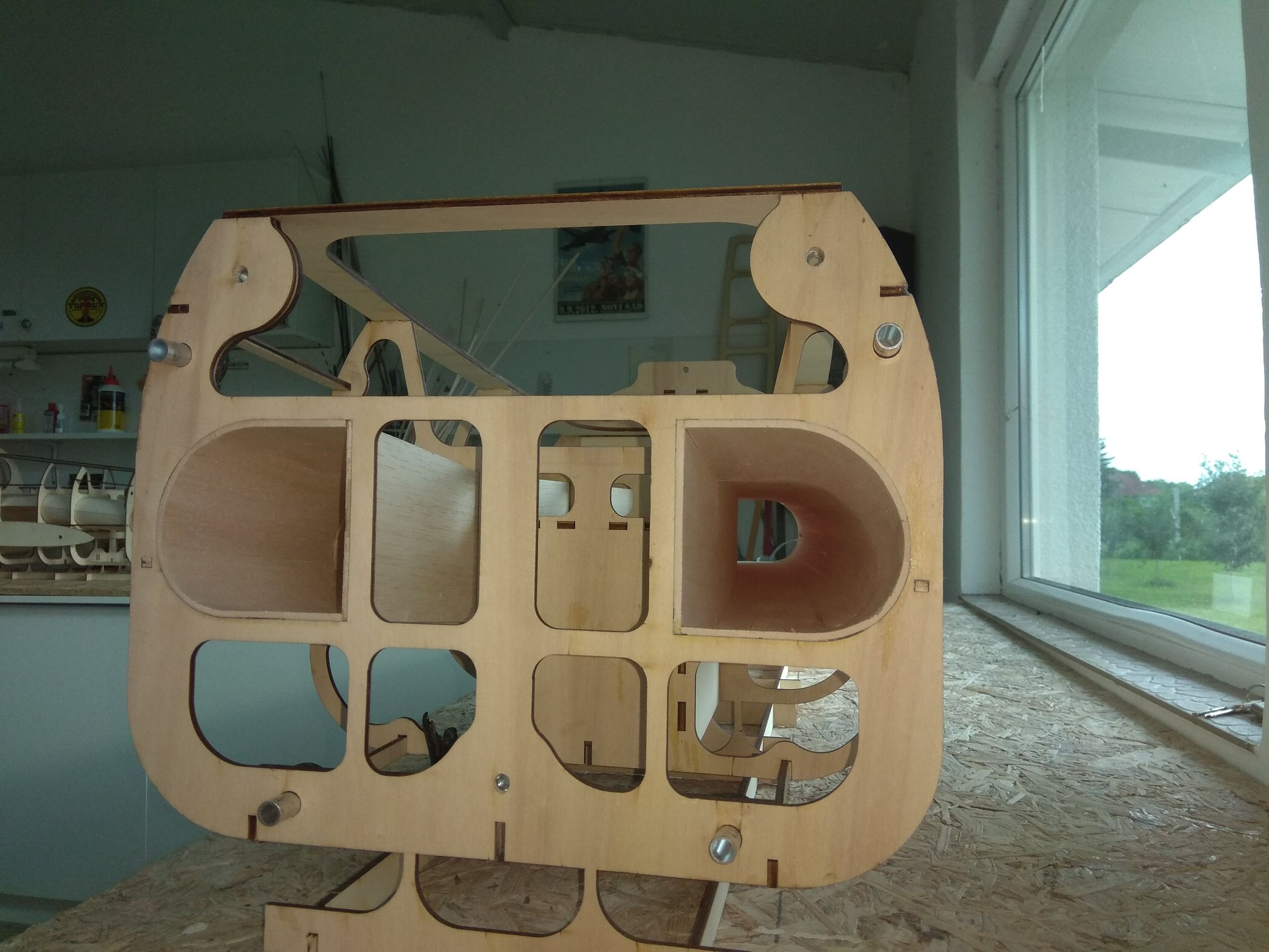

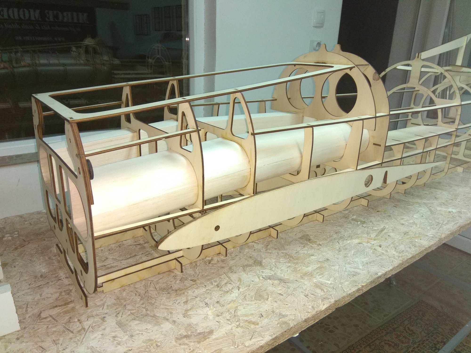

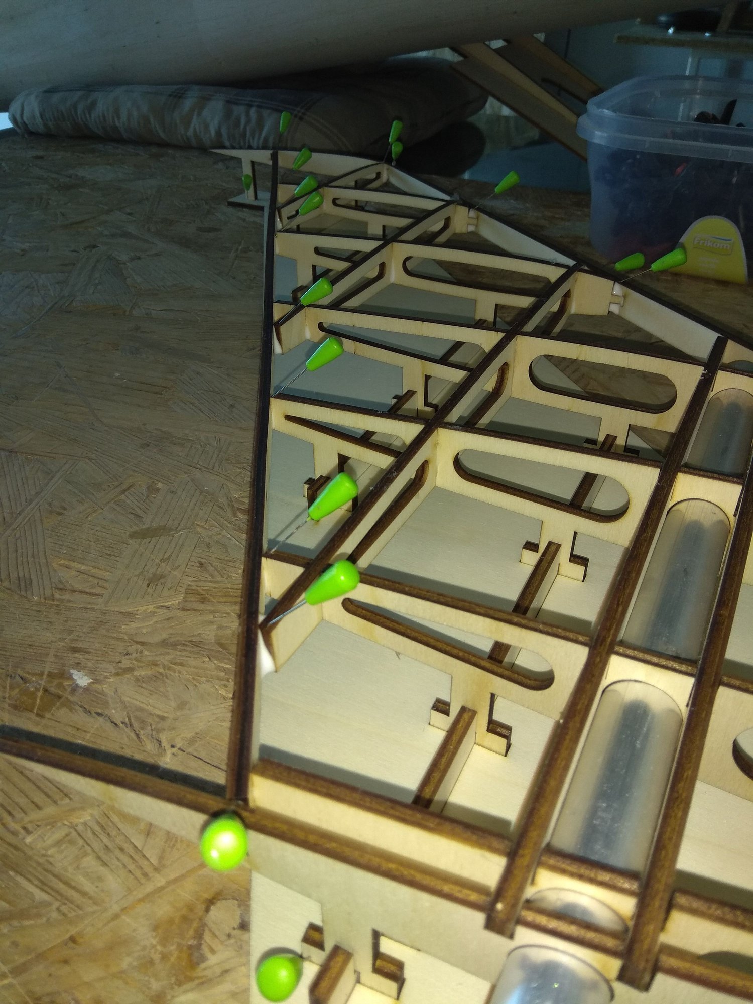

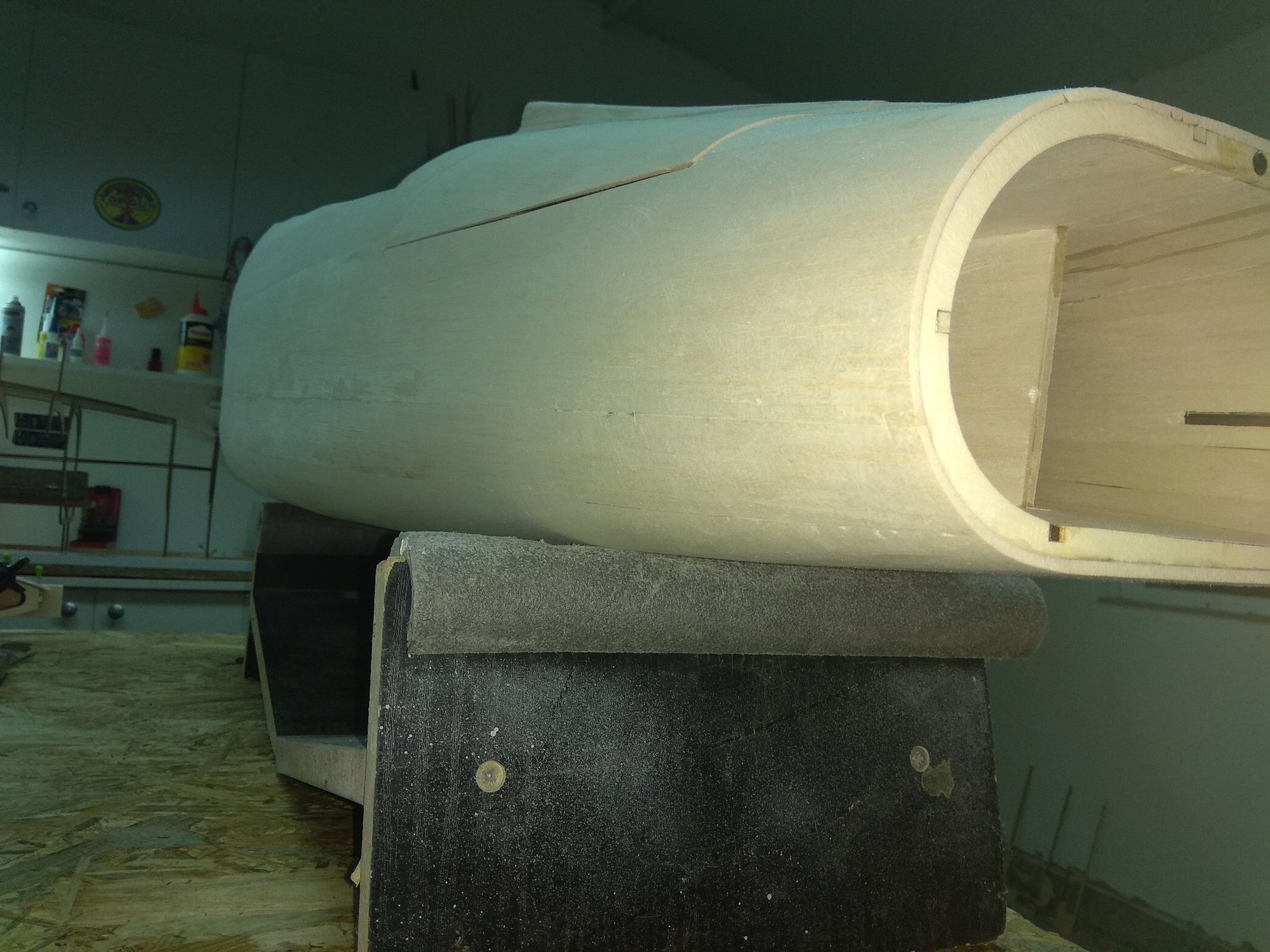

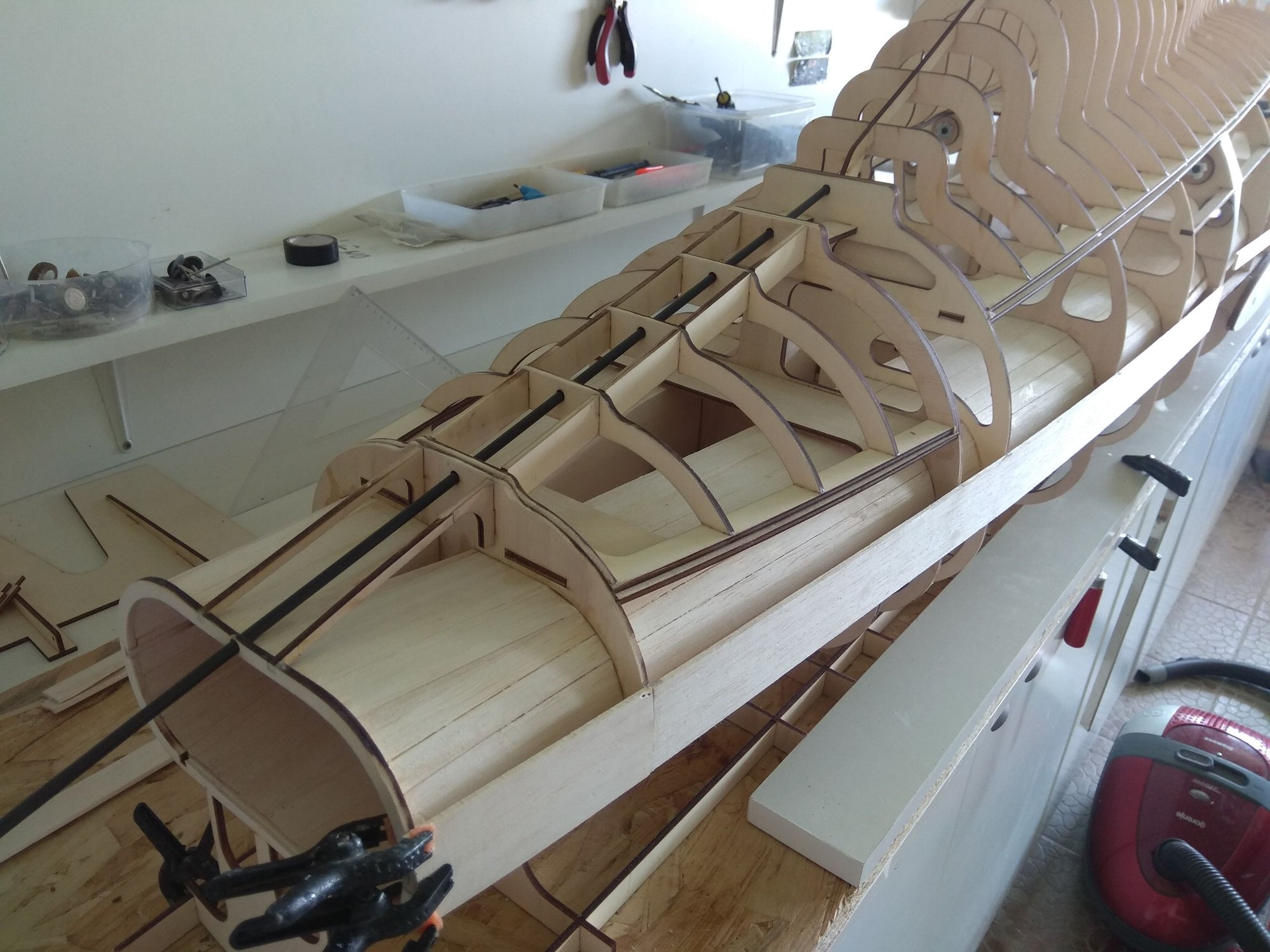

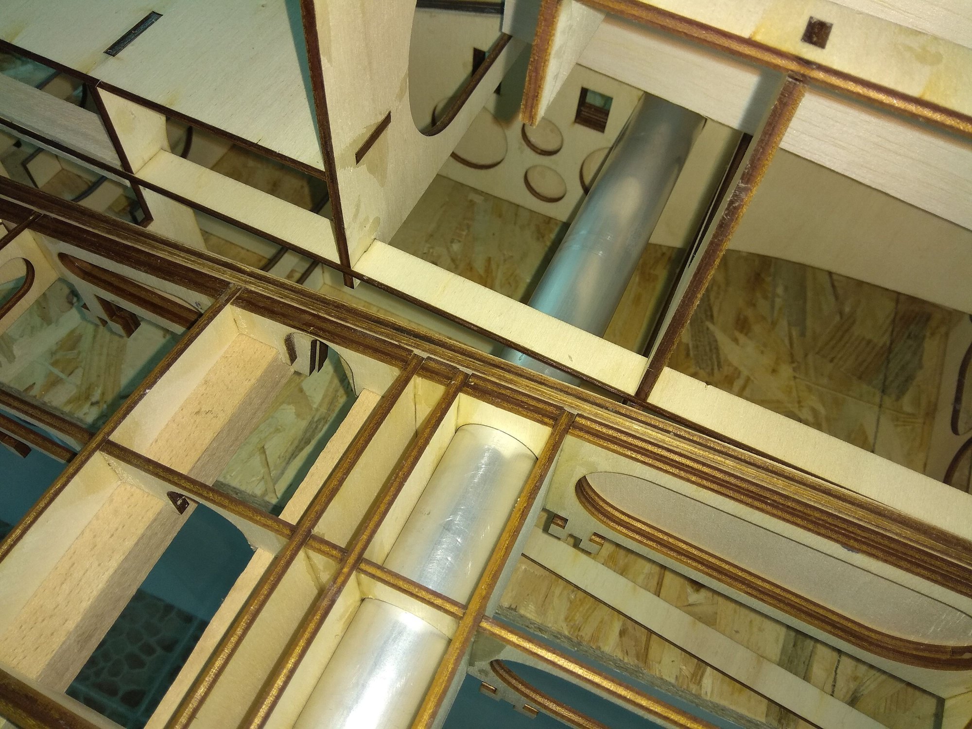

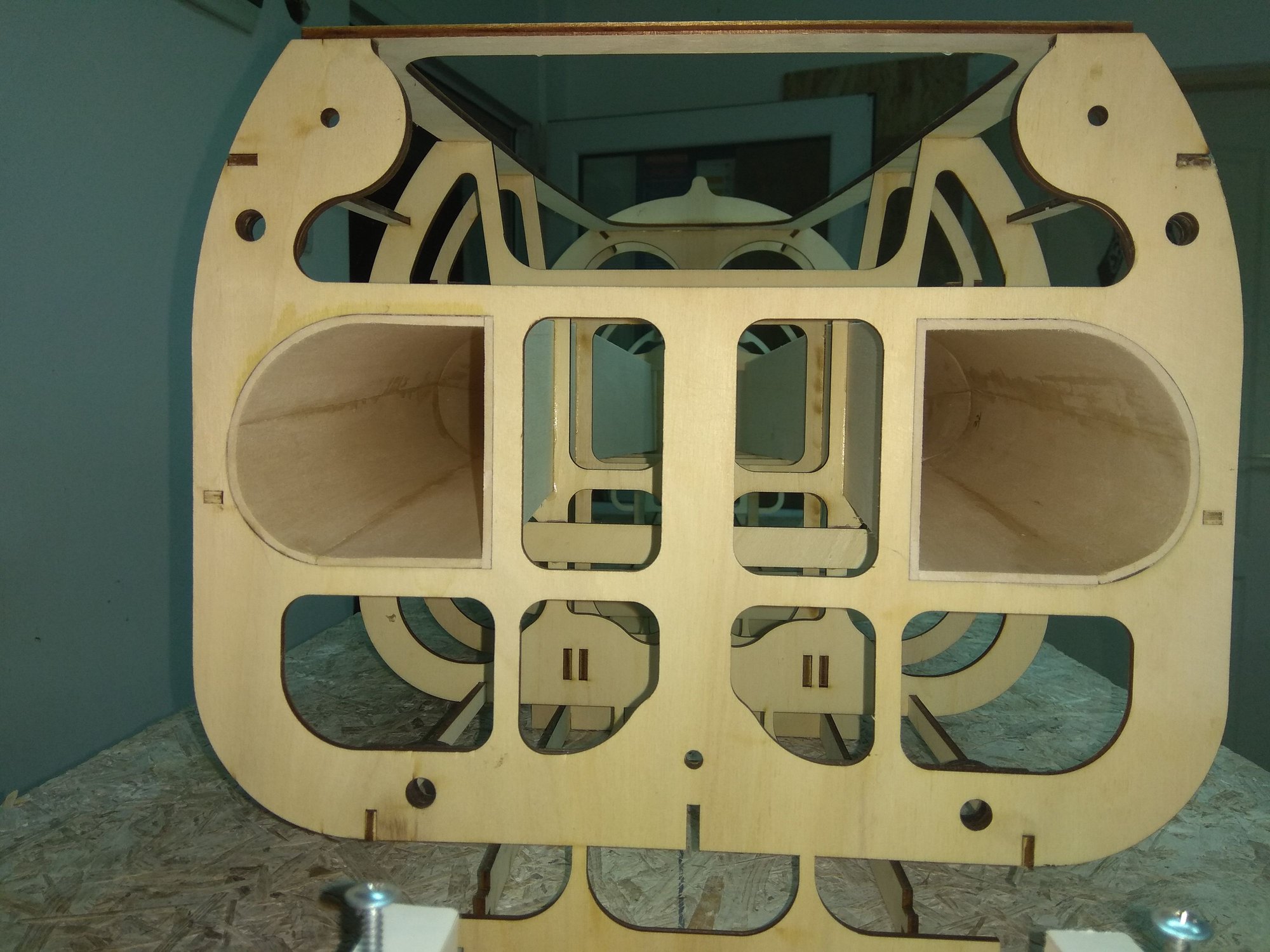

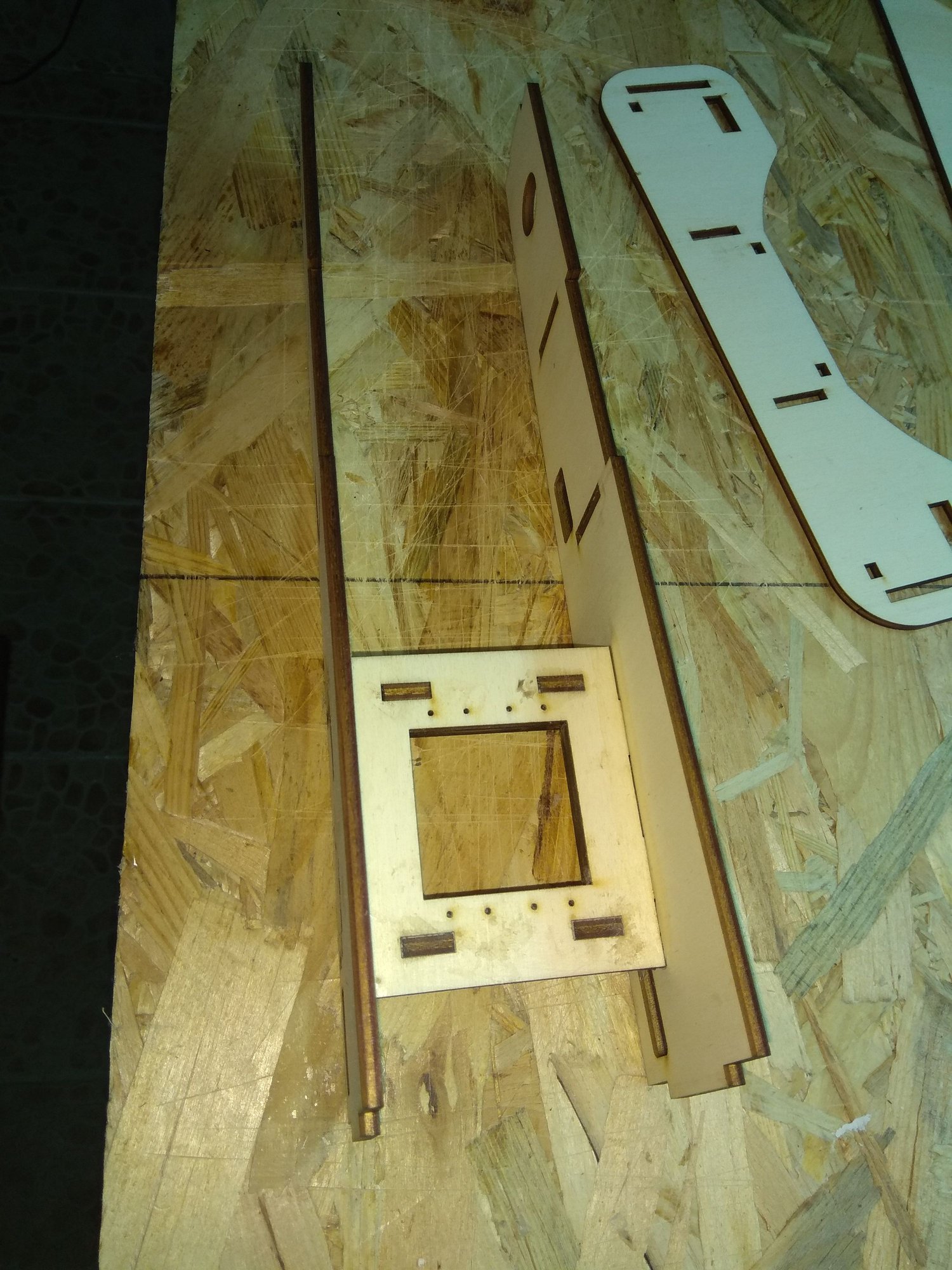

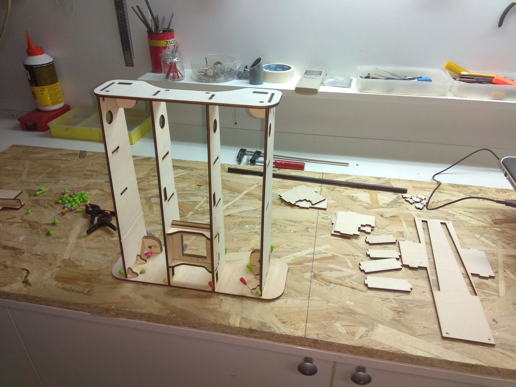

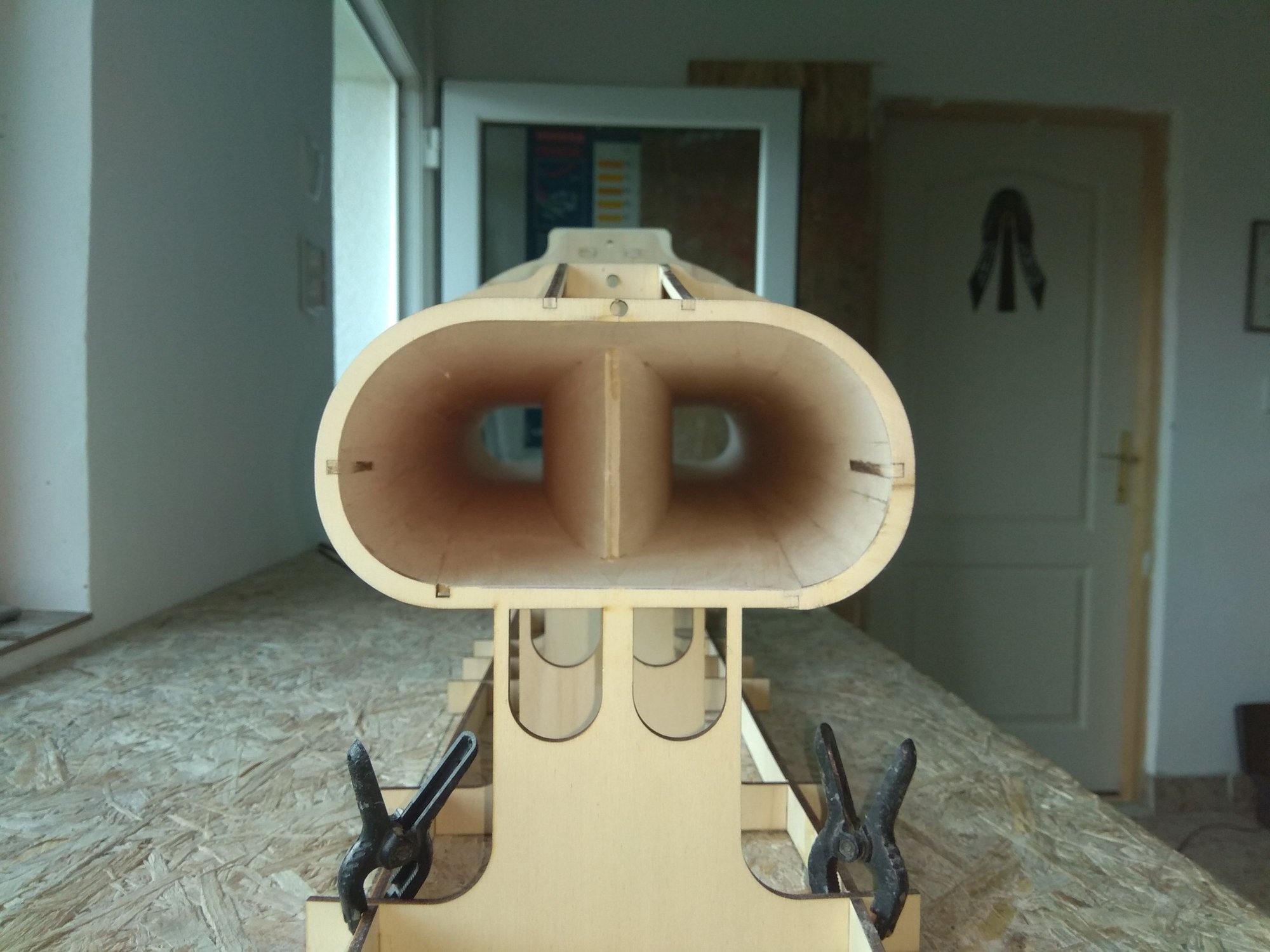

In the fuselage there are channels that bring the air directly to the turbine.
In the front fuselage part, the channels have a mild curve, so they have to be made of balsa strips that are placed next to each other.
I used CA glue for this process.
The channel in the rear fuselage section was a bit easier to make, because the shape is correct, only in one place it has a slight changeover.
To make balsa easier to bend I used hot water and I used a white carpentry adhesive for gluing.
When you assemble the fuselage you can see how long the suction channel is.

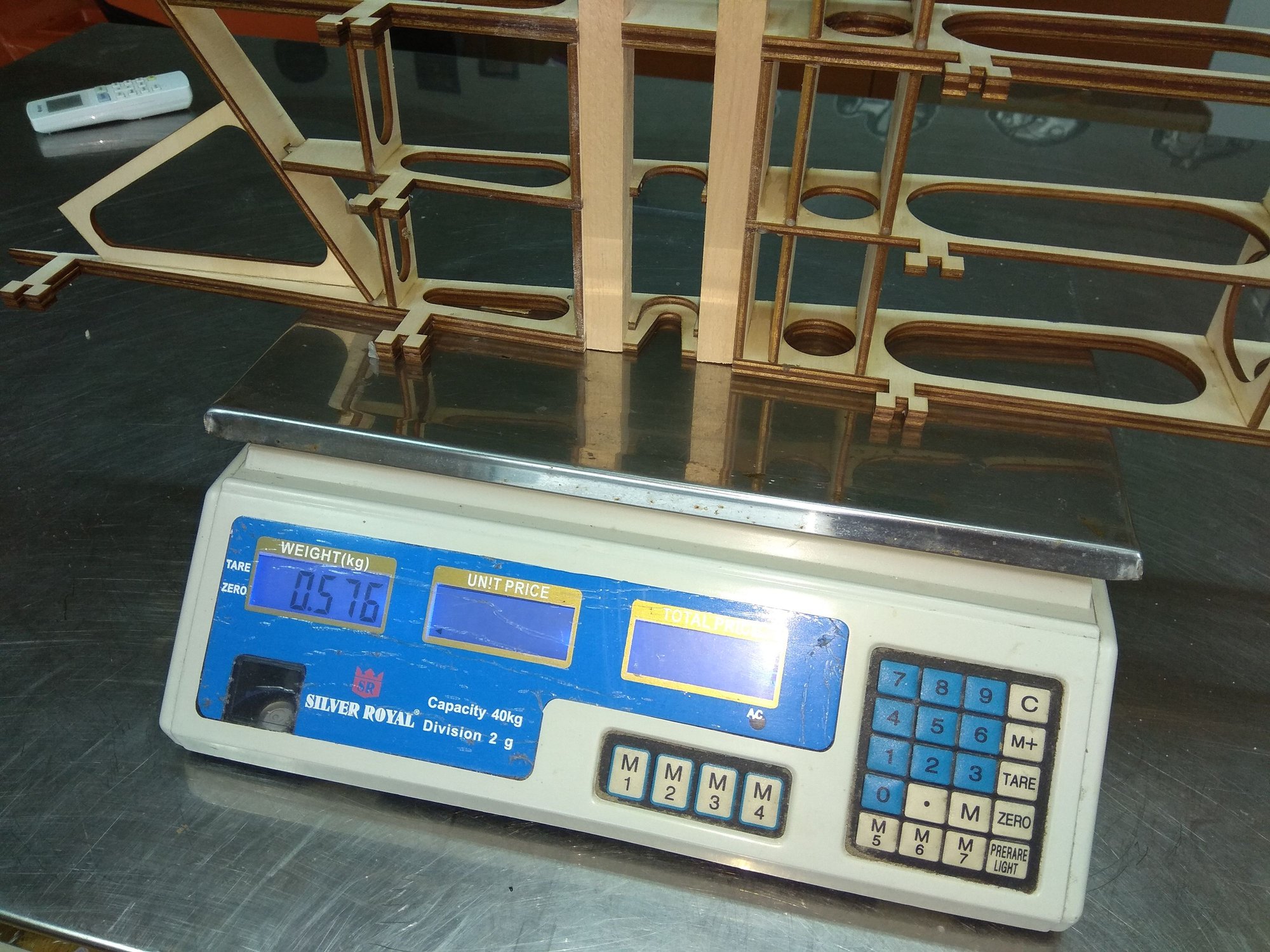

Joe, to be frank I don't know. Weight depend of many aspects, but I hope it will be much, much under 20 kg. We will see...
I'll post weight of parts during building.

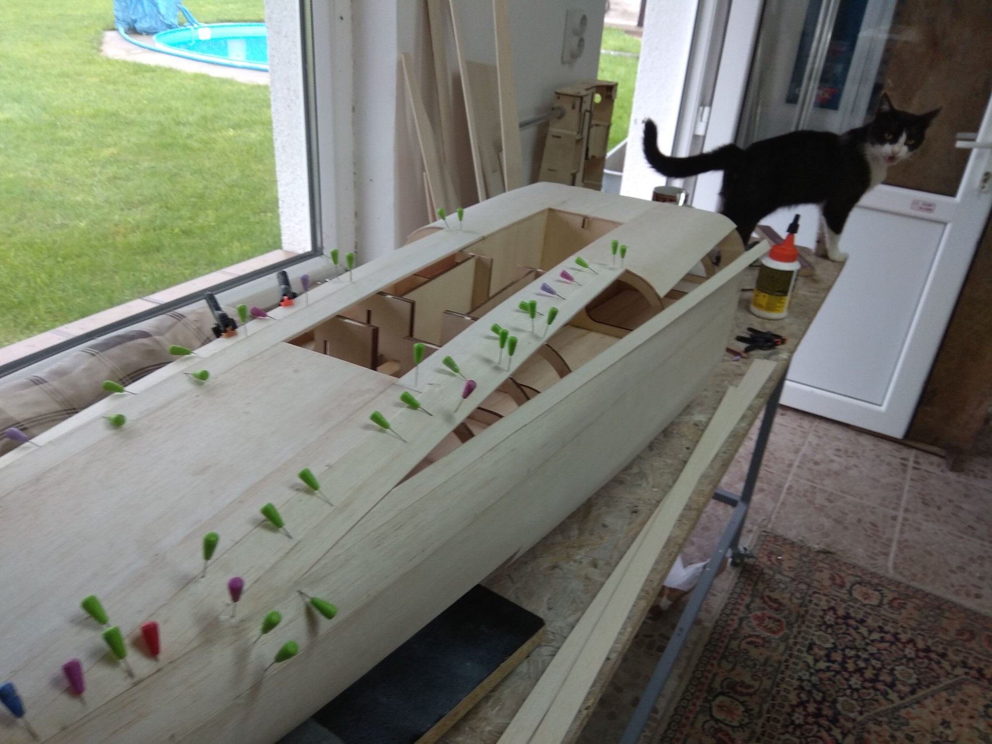

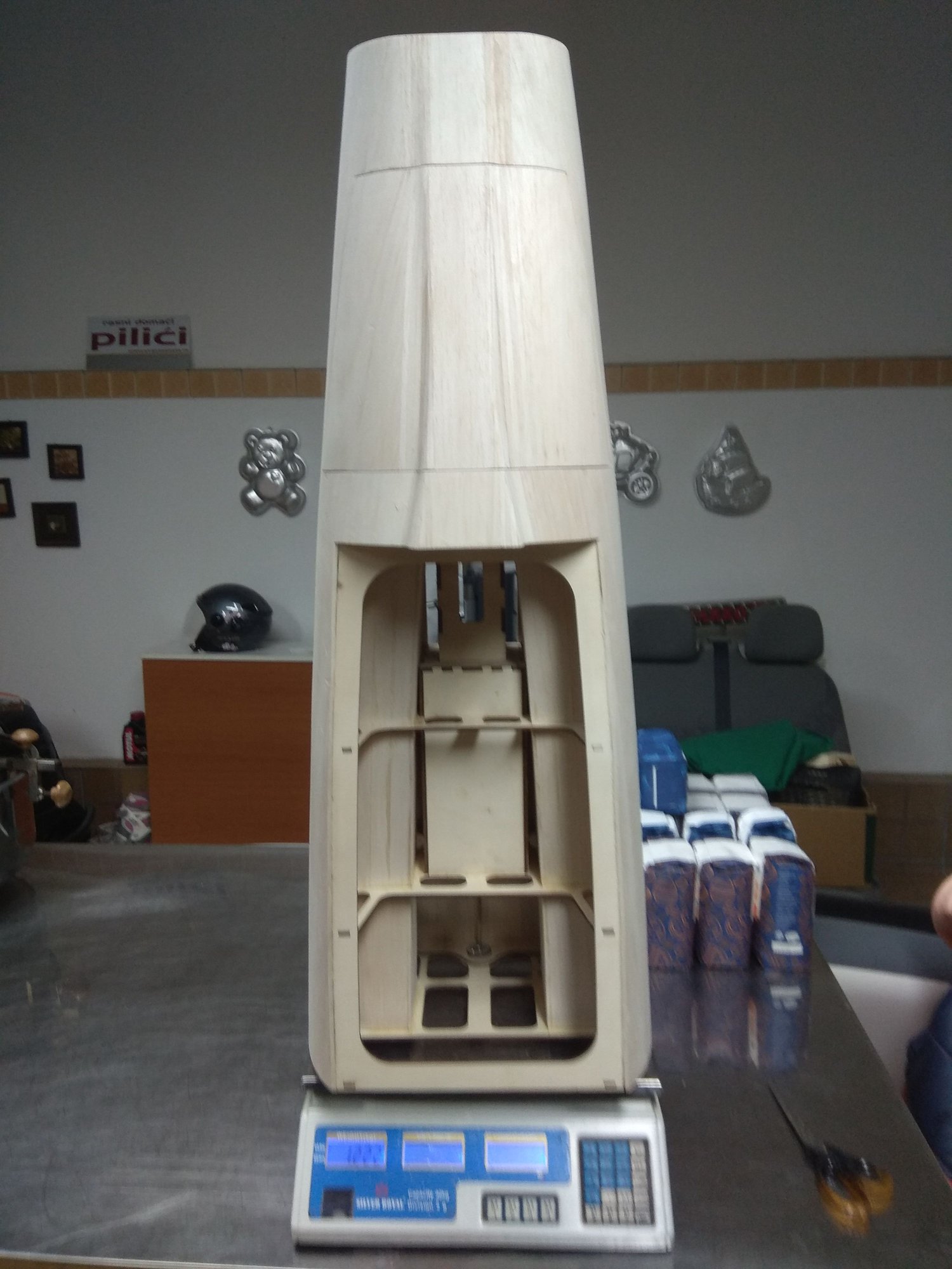

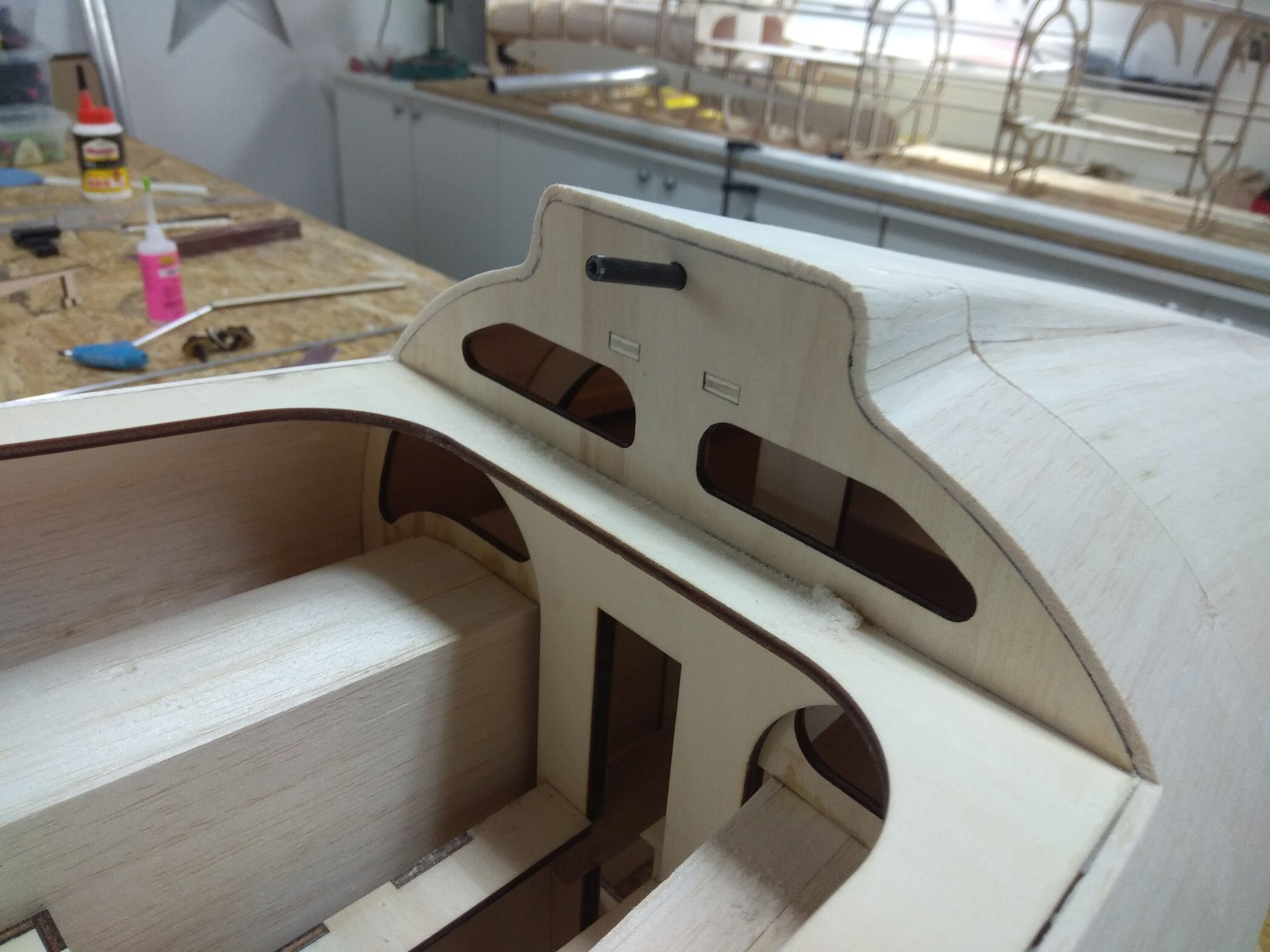

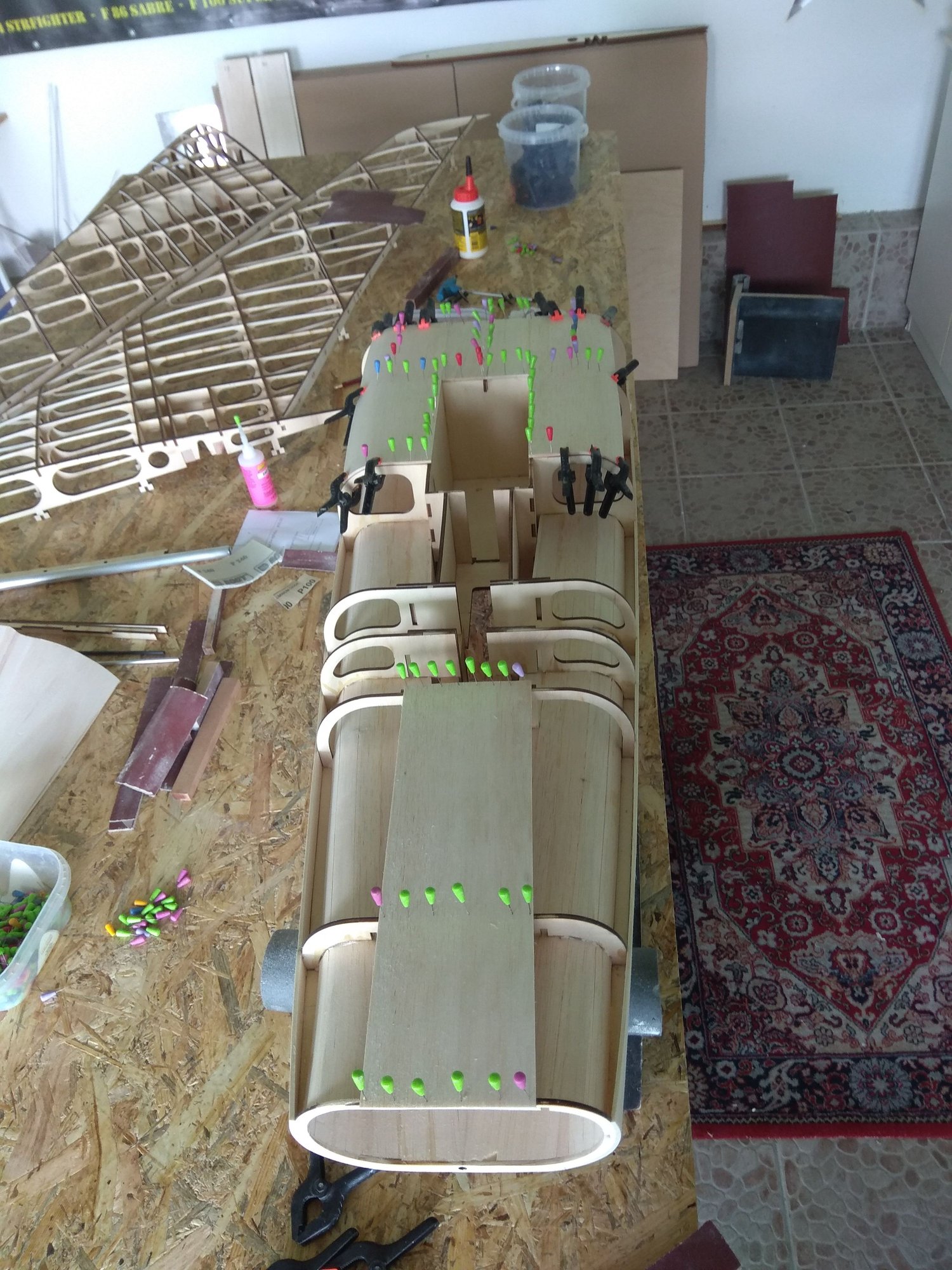

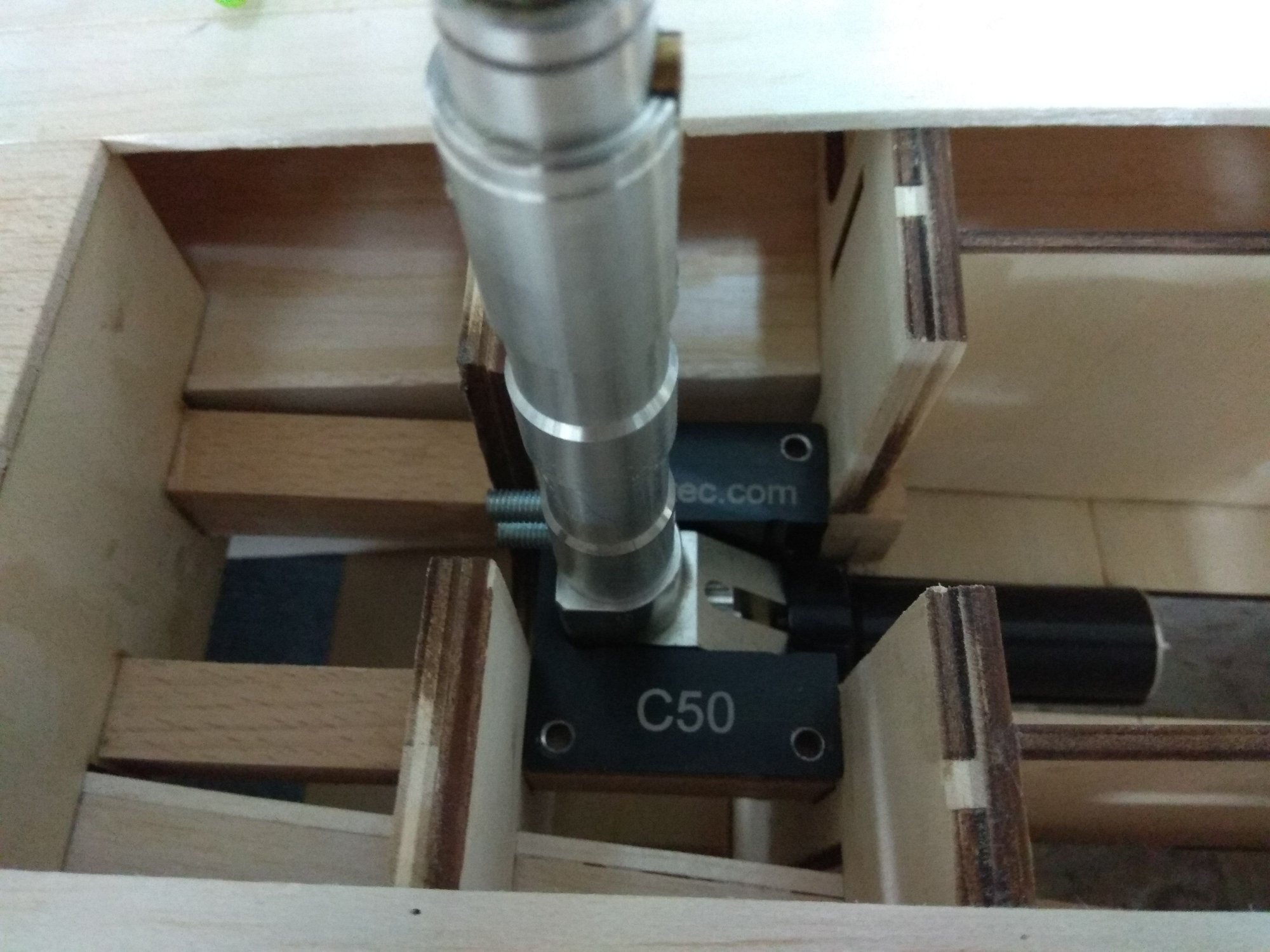

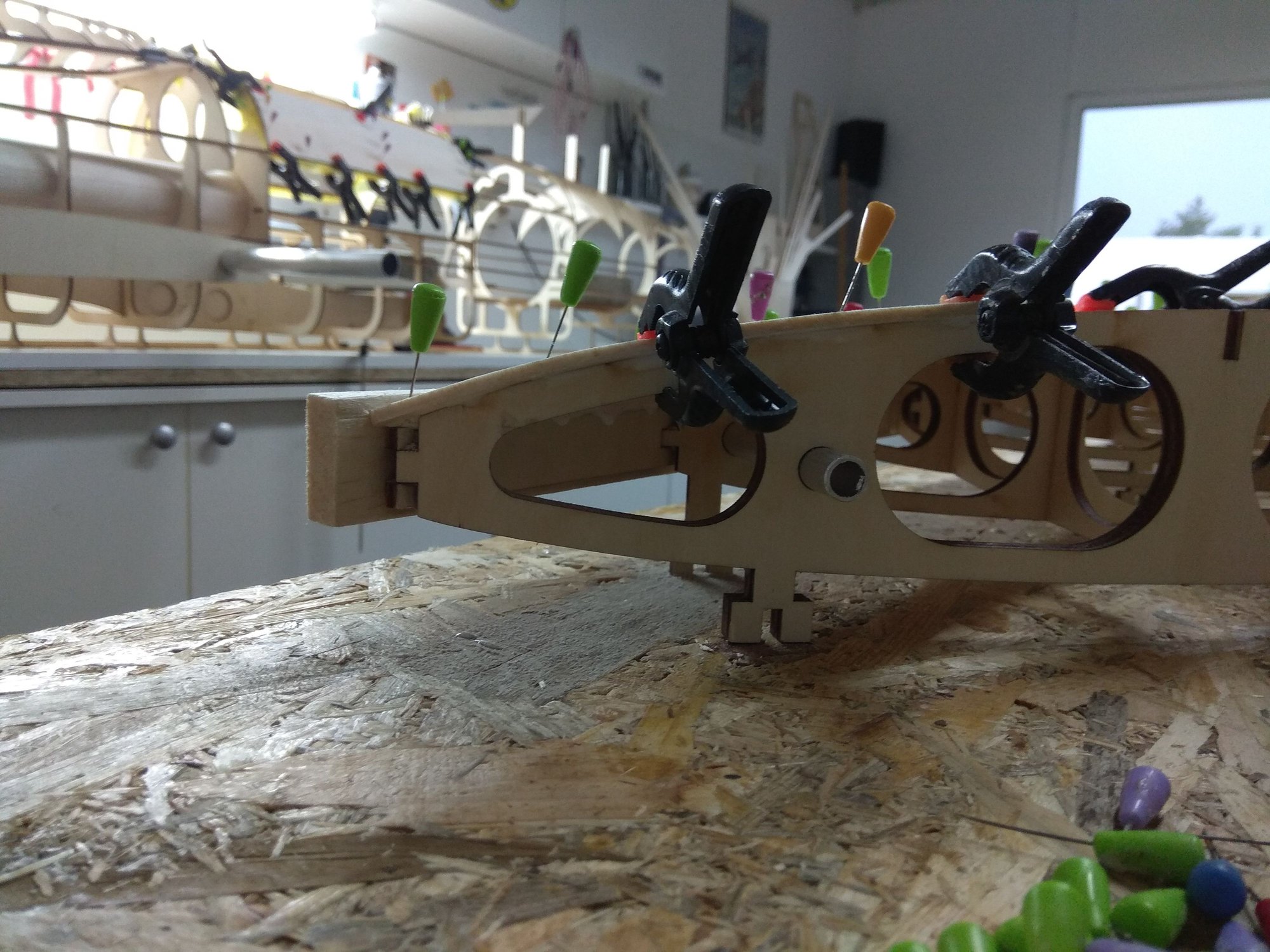

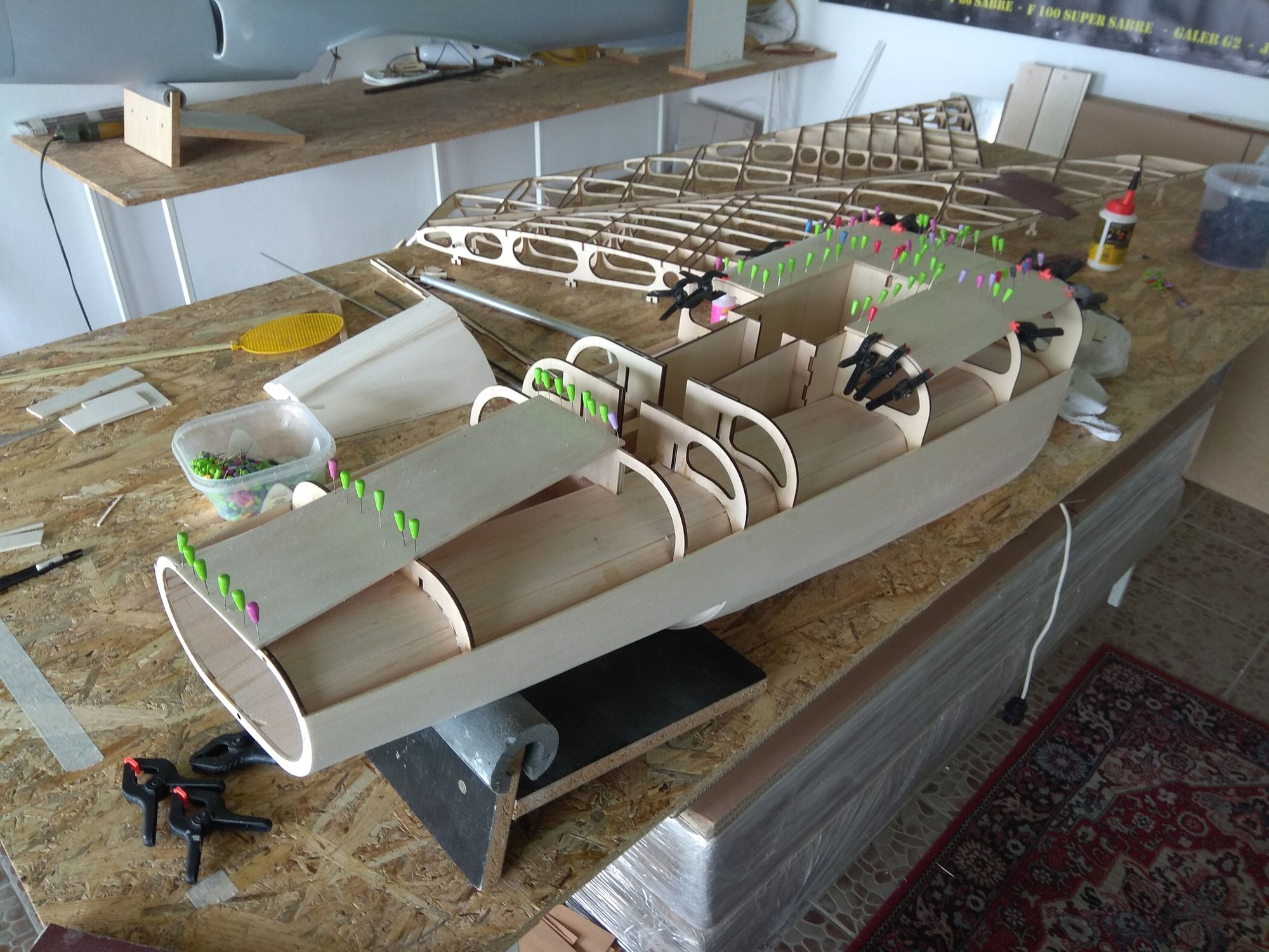

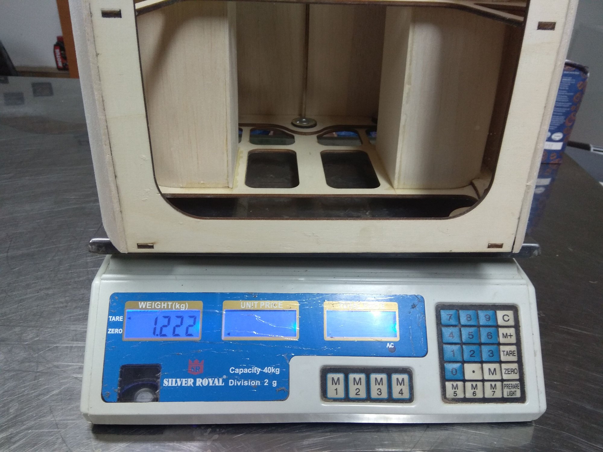

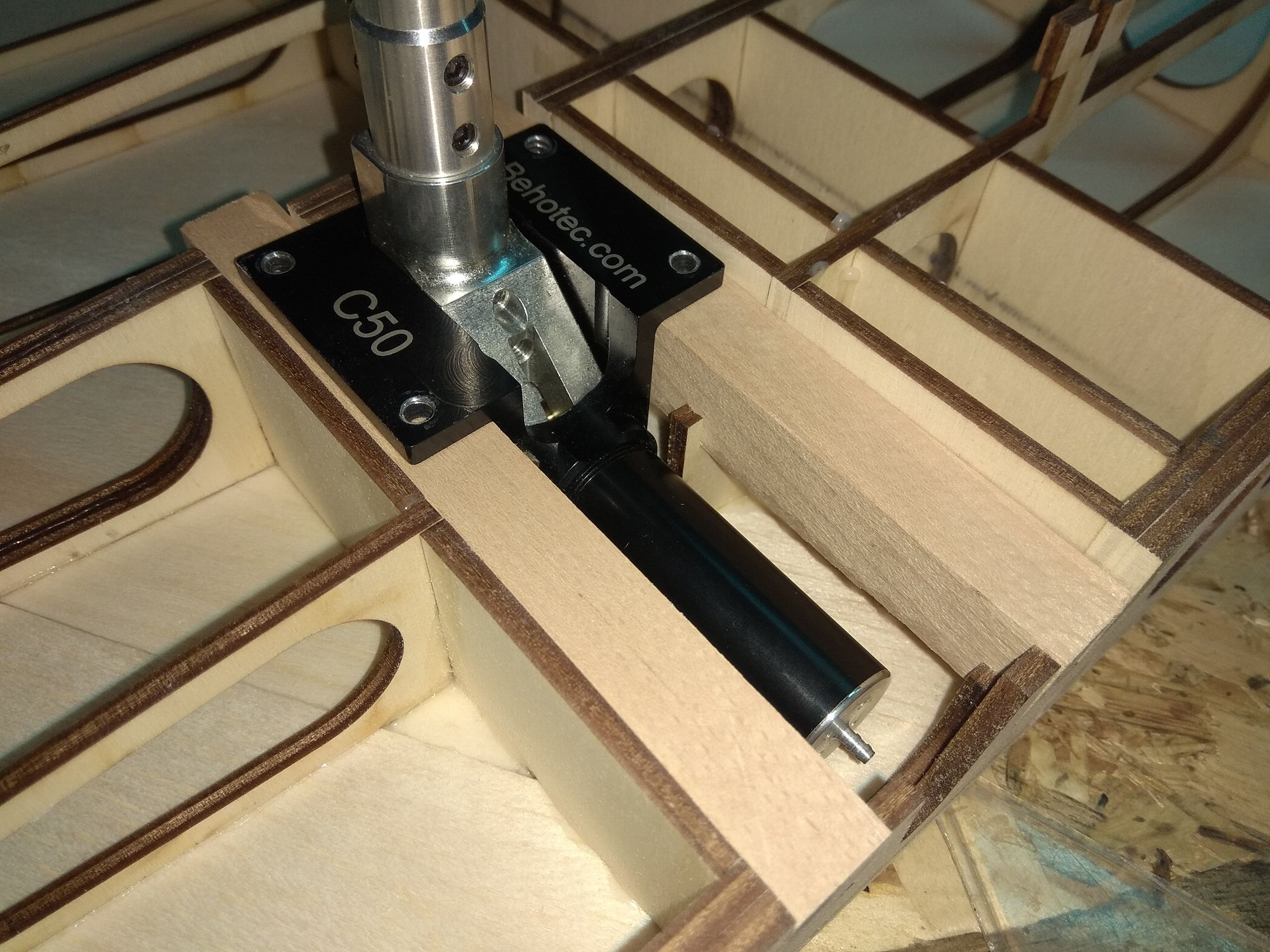

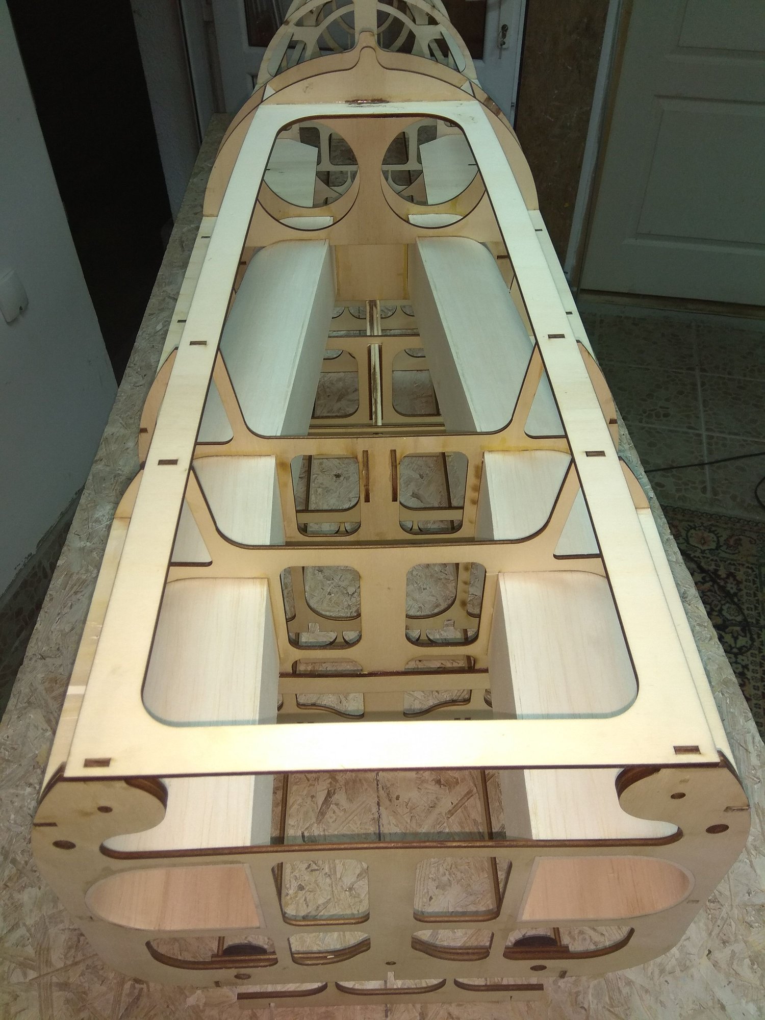

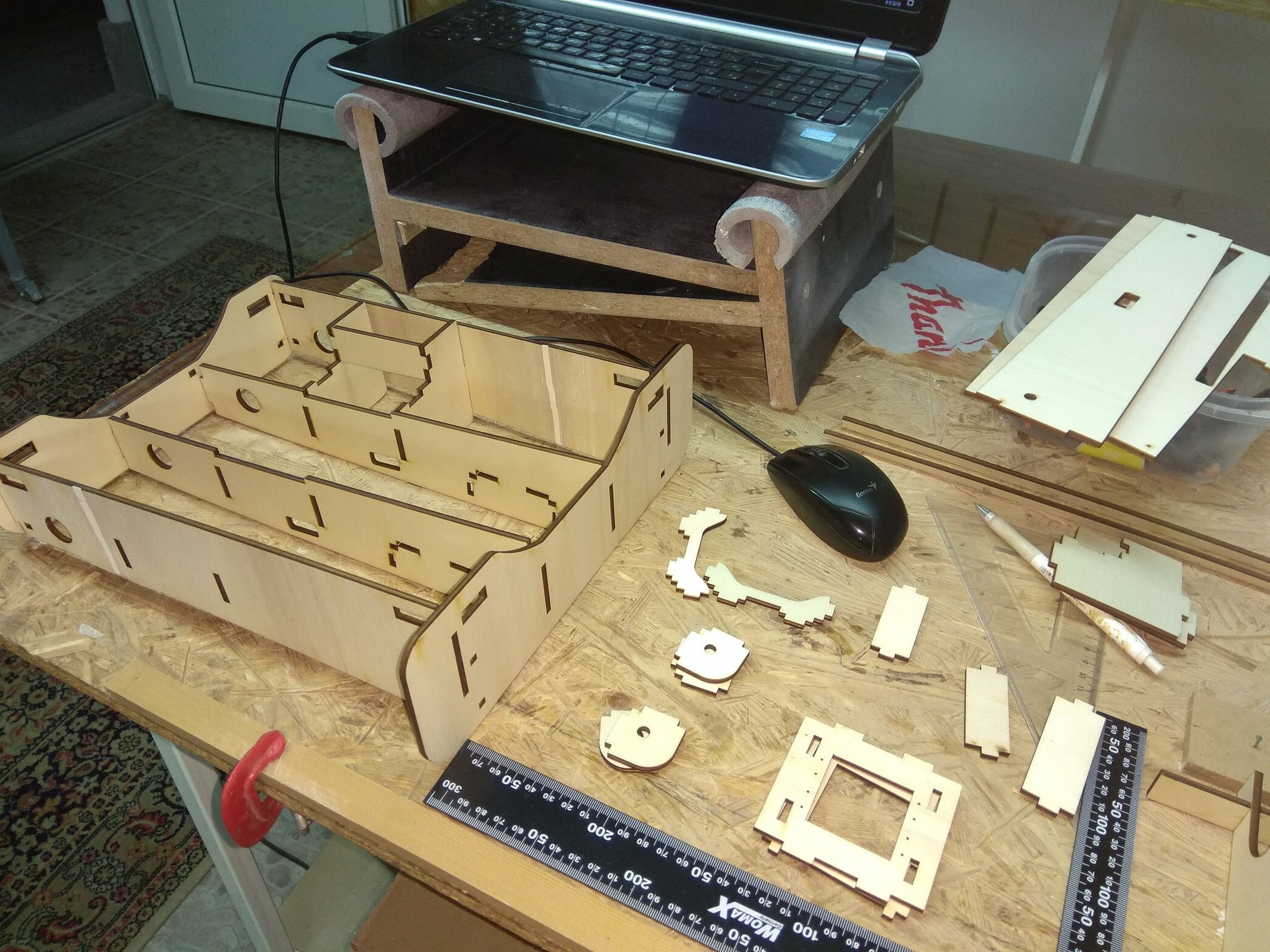

Front fuselage part planking. For this process I use 3 mm balsa & white (carpenter) glue...
But before that another Damianos great idea, locking system for the front cover and the front side of the canopy.
Now, planking of the front fuselage part...
Than, bottom side...
Weight - 1222 gr...
Behotec C 50 landing gear fit prefect in front fuselage part.
OK, strut (leg) is not for F 100, for test I take out this gear from my Jastreb J 21.

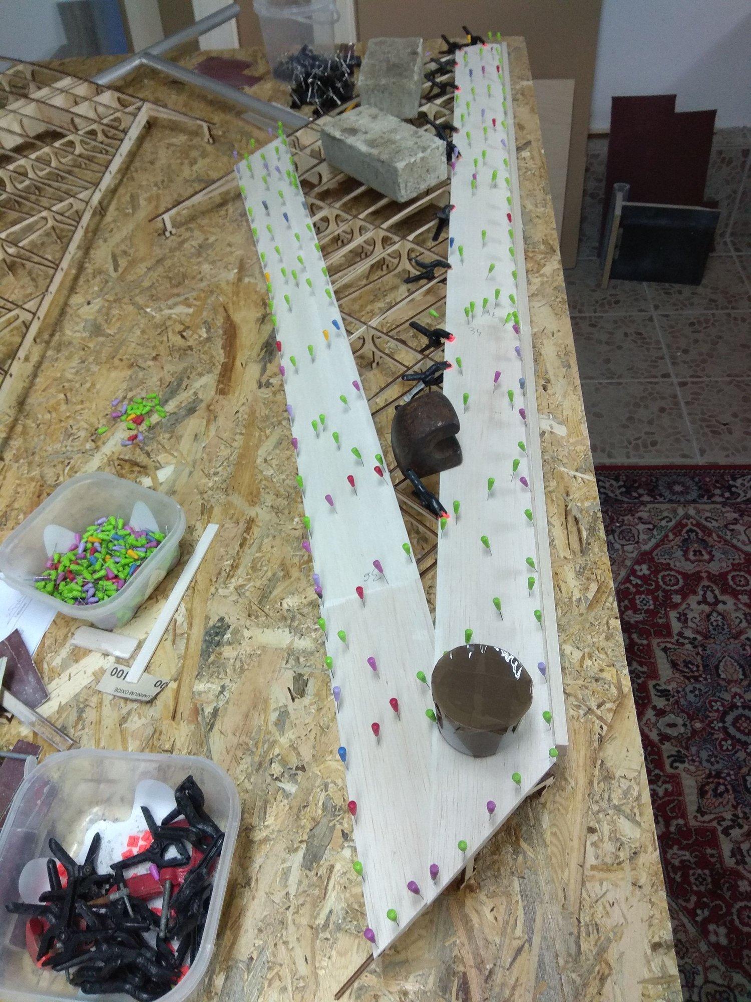

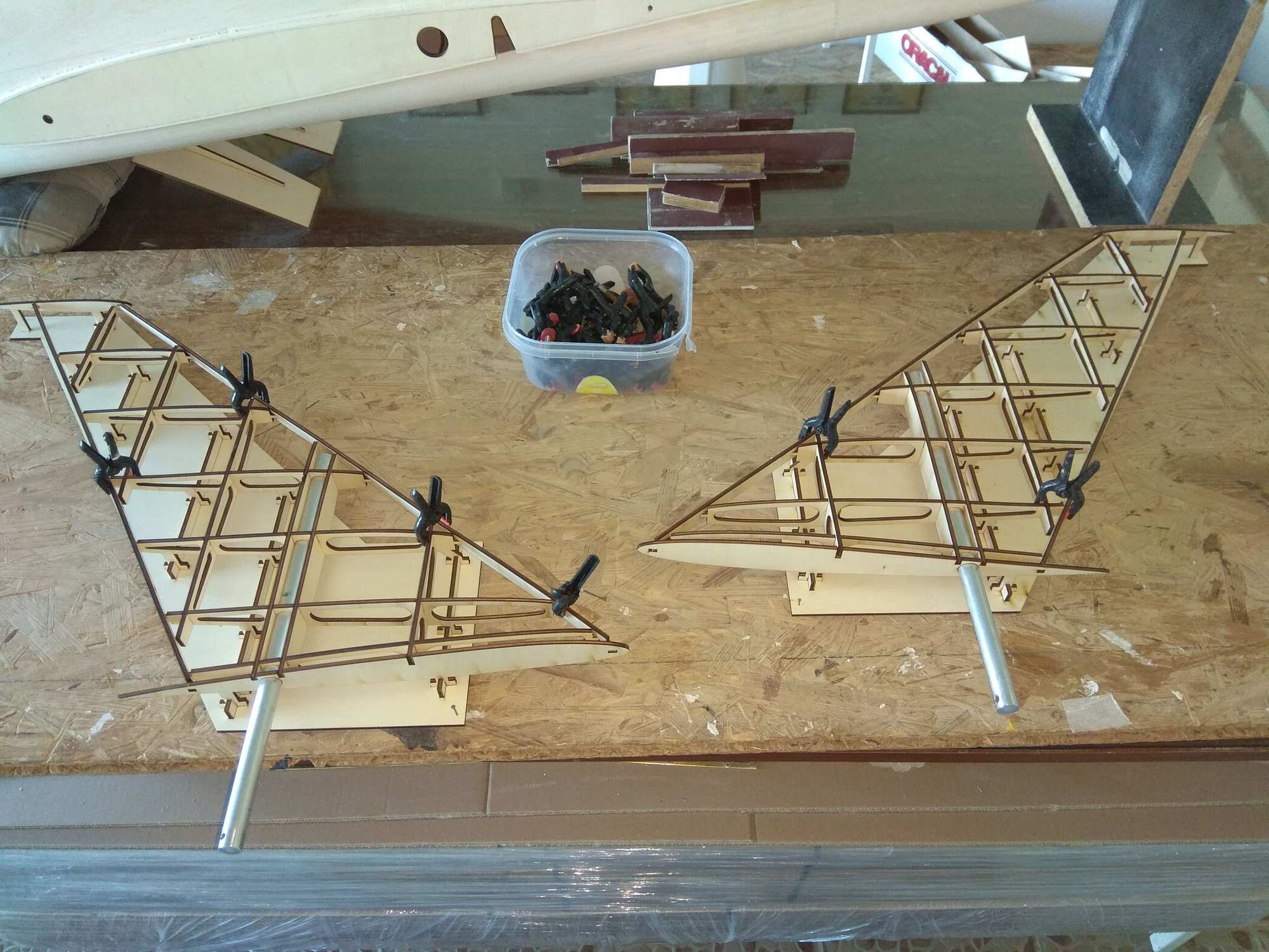

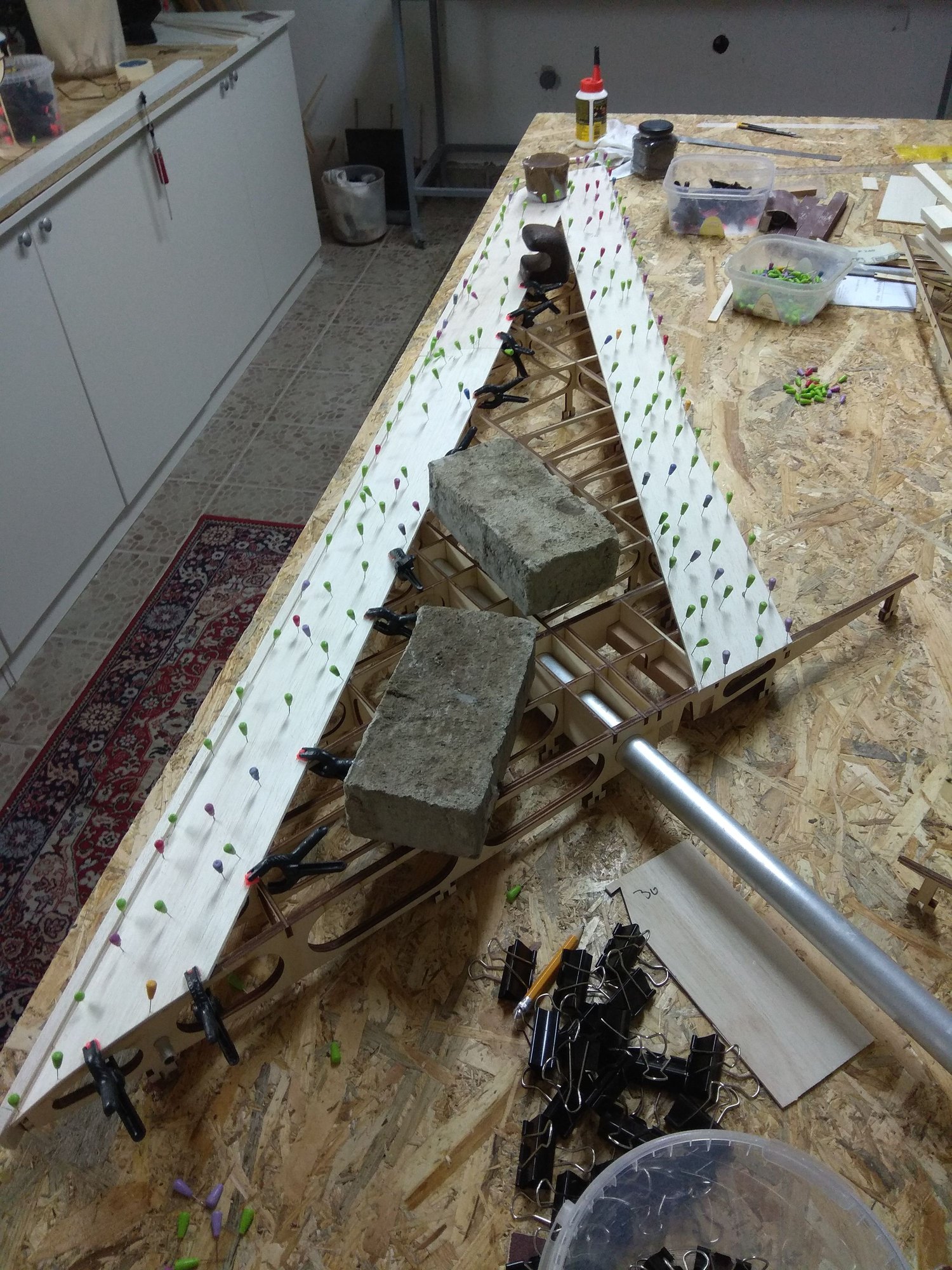

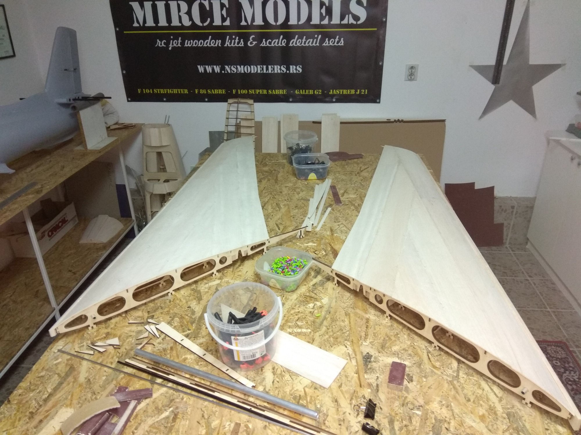

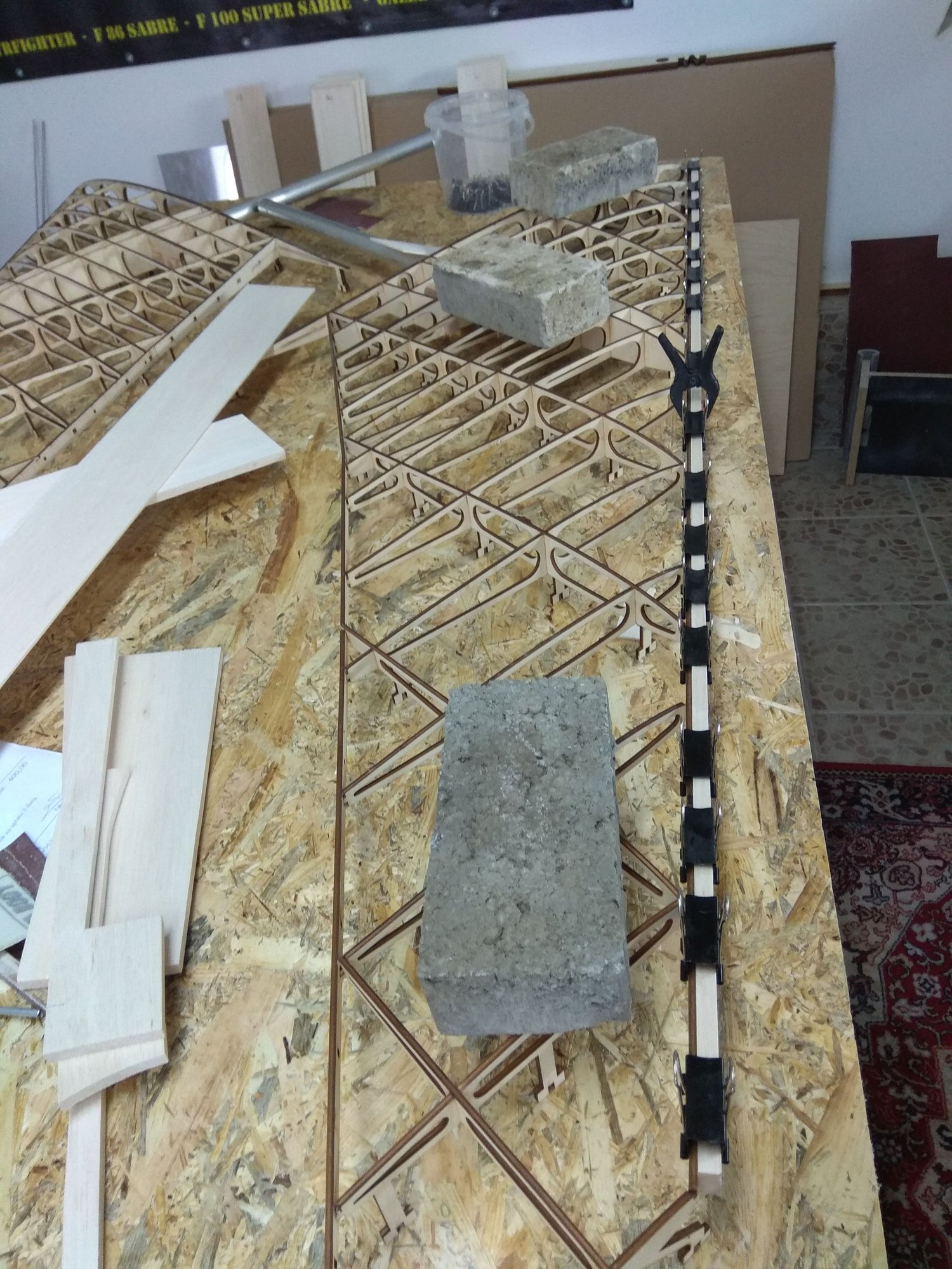

Thank you Sparhawk and Kevin. Today, wings sheeting...
First thing was to glue 10 mm balsa for leading edge. It's little higher, because the first 3 mm balsa plate is glued to it.
Now first balsa plates, near leading edge.
Next was on trailing edge and after that one in front and one behind...
Than copy - paste everything on other wing...
I try how fit landing gears. I haven't struts right now, this struts are from Jastreb J 21, my other jet model.
Struts length and wheel dimensions I'll post here later...

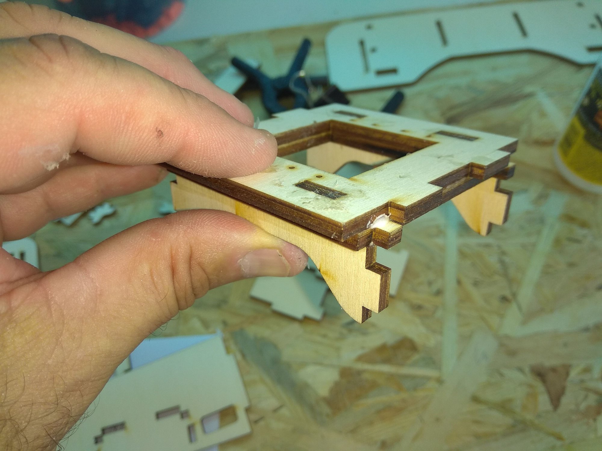

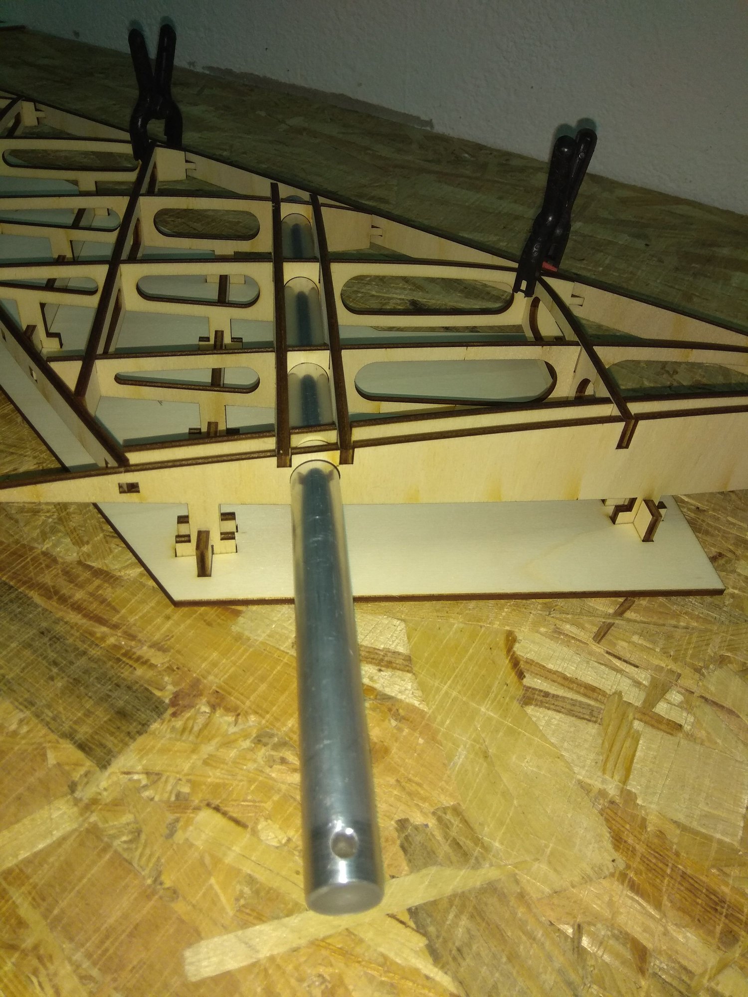

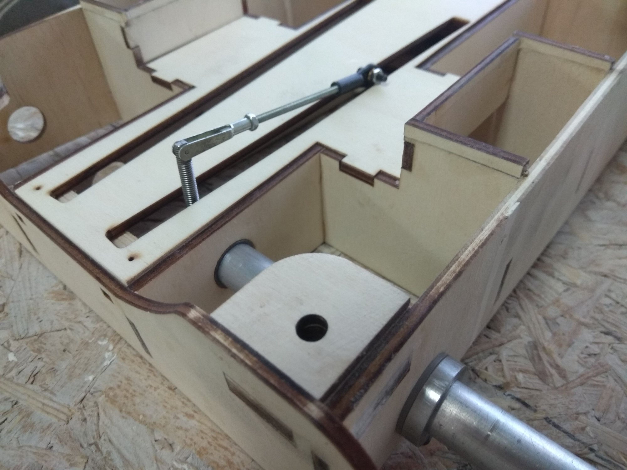

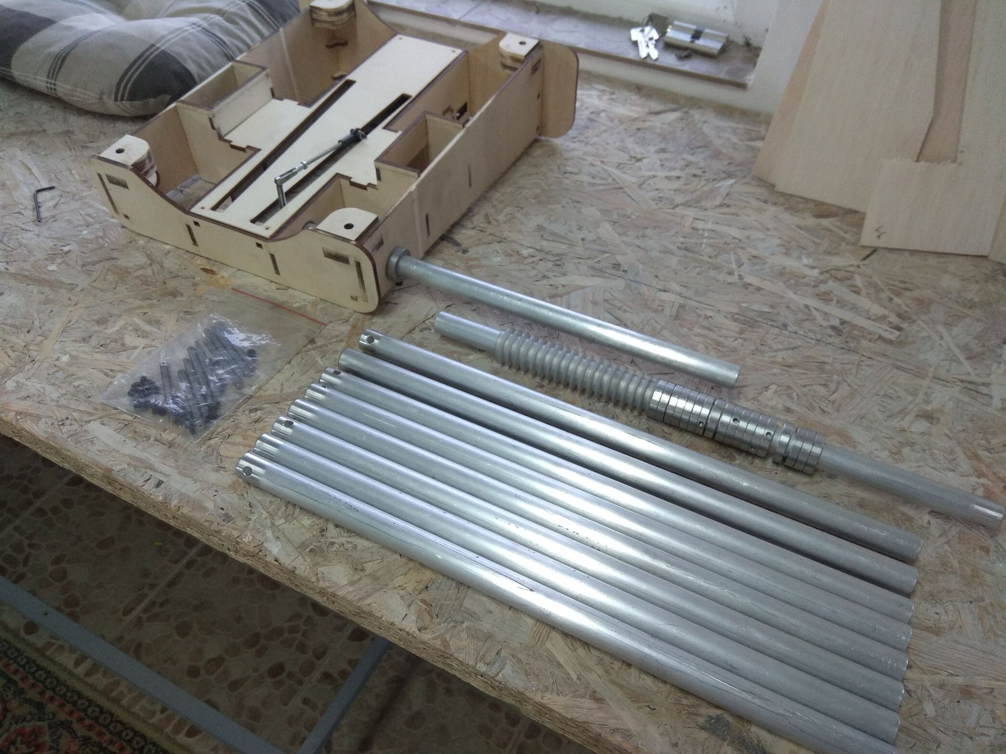

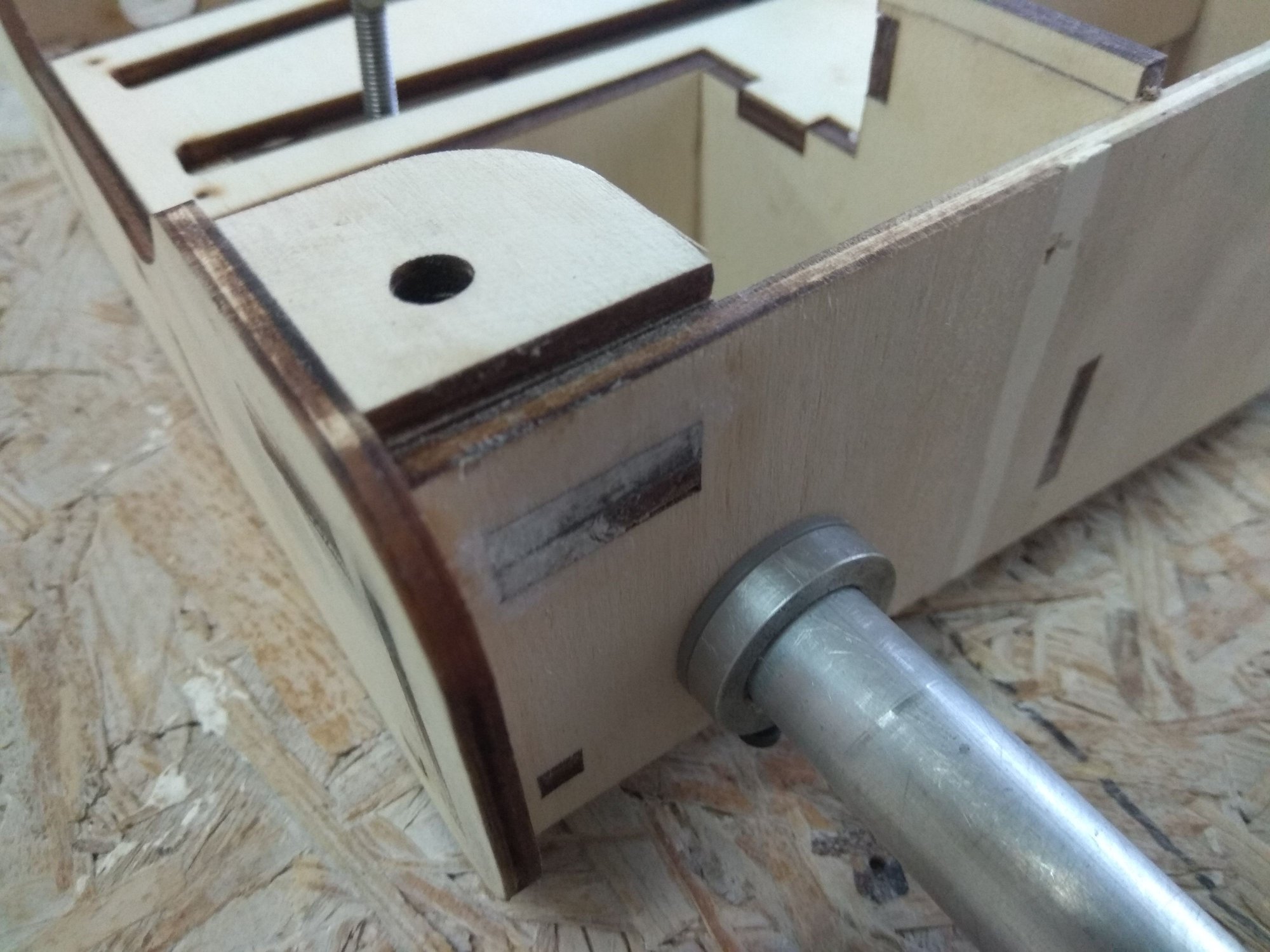

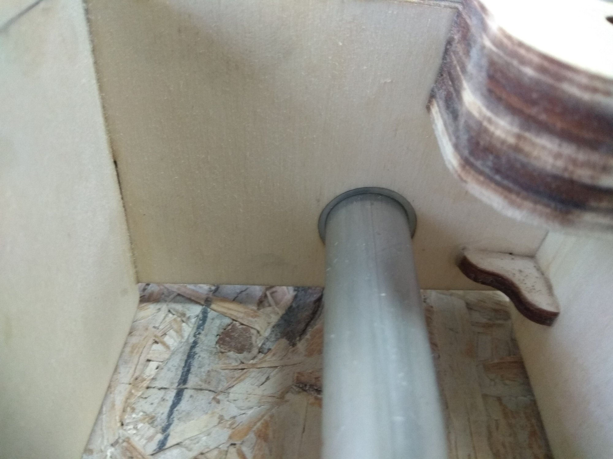

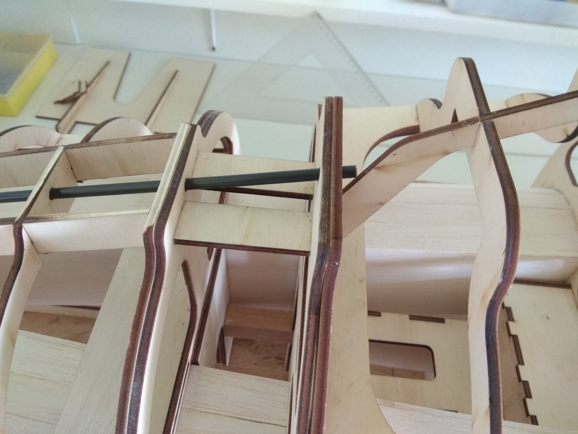

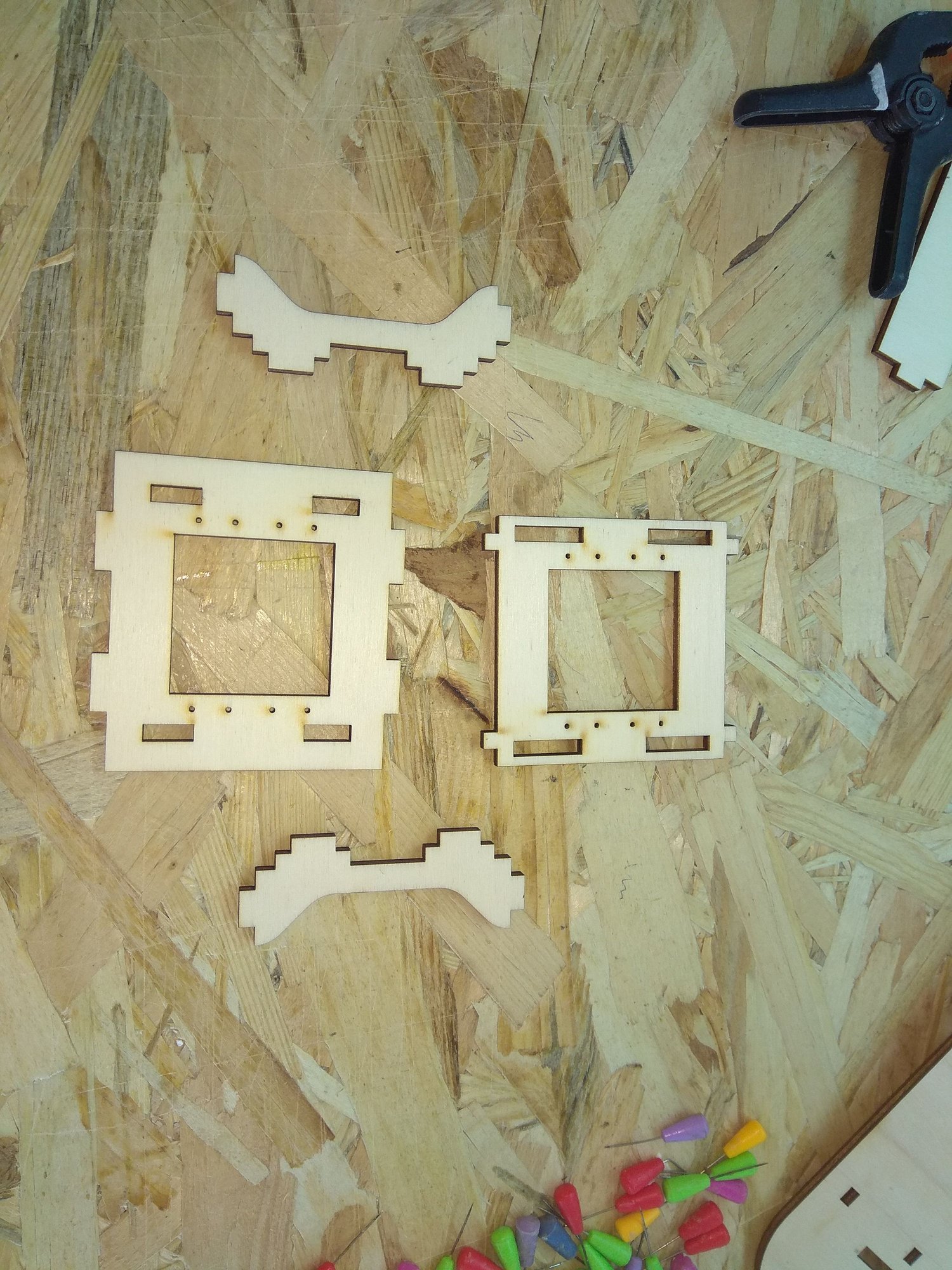

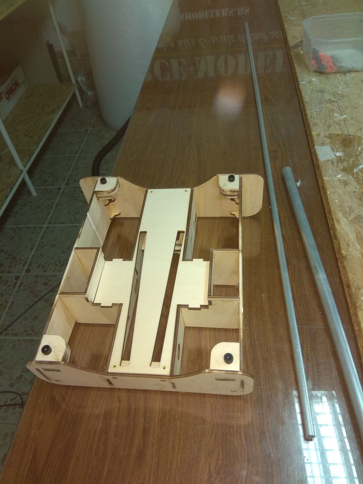

Another great Damiano's design is elevators system.
On bottom fuselage side is "box" where are servos and elevator shafts. With four screws you can remove complete system for easier transport.
In my friends machine workshop was made all plastic & metal small parts...
The entire assembly for one F 100 model has:
- two aluminum tubes for elevators
- two plastic plugs
- four plastic rings
- four aluminum fasteners for fixing
- two stainless steel thread for connection with servo
In the workshop, a plastic plug is inserted at the end of the aluminum tube and through it an opening is made, through which the stainless steel tread part passes.Aluminum rings serve not to move the tube (and elevator) to the left - to the right.
Plastic rings are glued into a wooden construction.
To be continued...

For elevators and rudder I made template for easier assembling. With this ply plates building tail section is "piece of cake"...
Same story is with rudder, but first, Martin fix rudder drawings, now fin is a right size...

Mirce the build is looking fantastic. Are you going to include the ply templates for the elevators and vertical fin in the kit as well?
