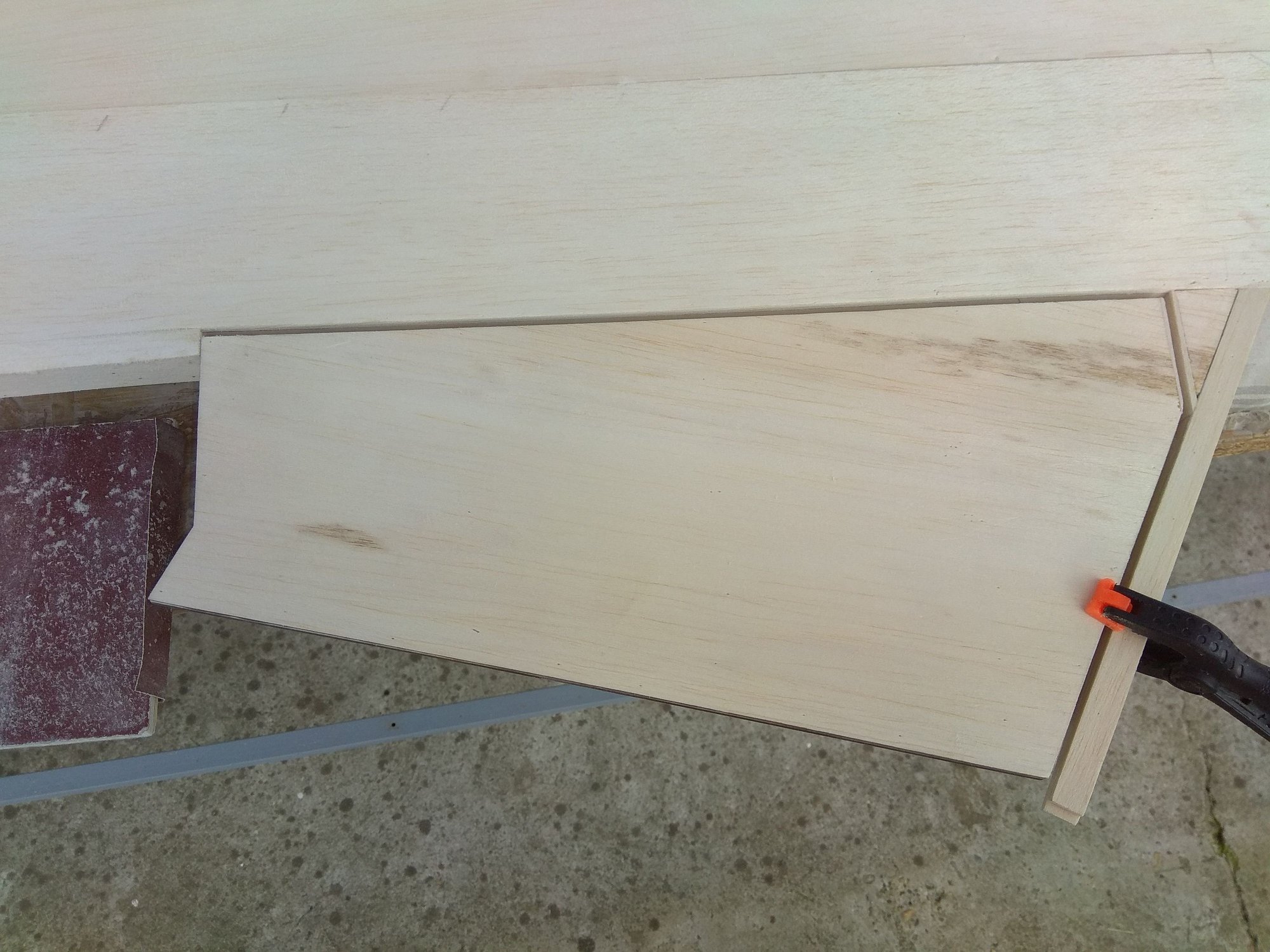

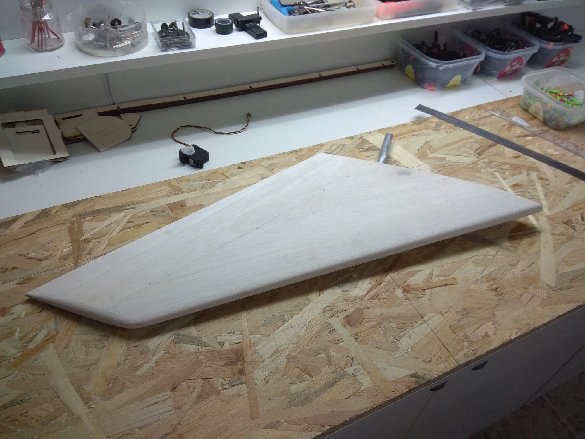

Thank you Sonicboom, photos are from my workshop, I have one and only file for cutting, so everything must be exactly like I post here.
This is new wooden kit model for me also, so during building I check all details. You can see that almost no any sanding on parts, everything fit nice and precise.
Rudder building system is same like elevators, ply plate template, parts fit perfectly inside. Extreme easy for work...
Fin...
To be continued...

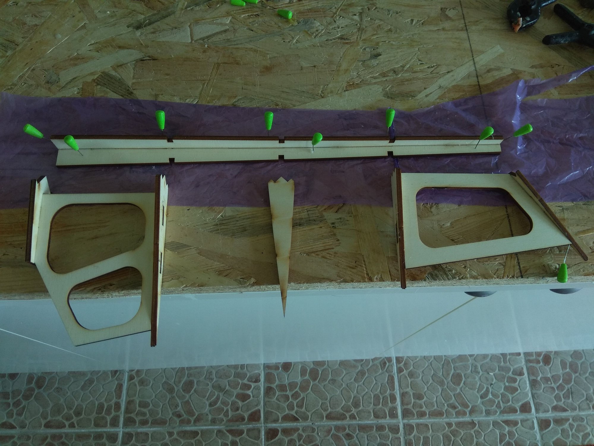

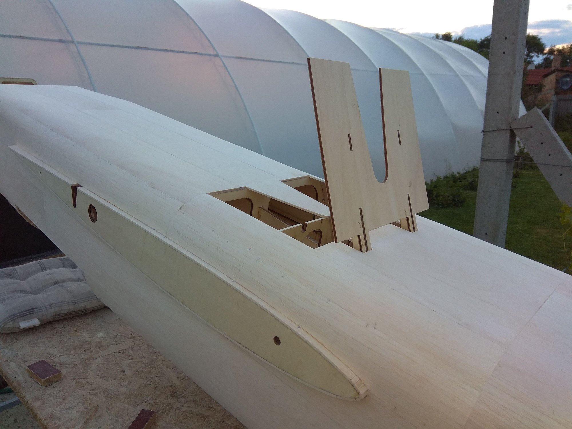

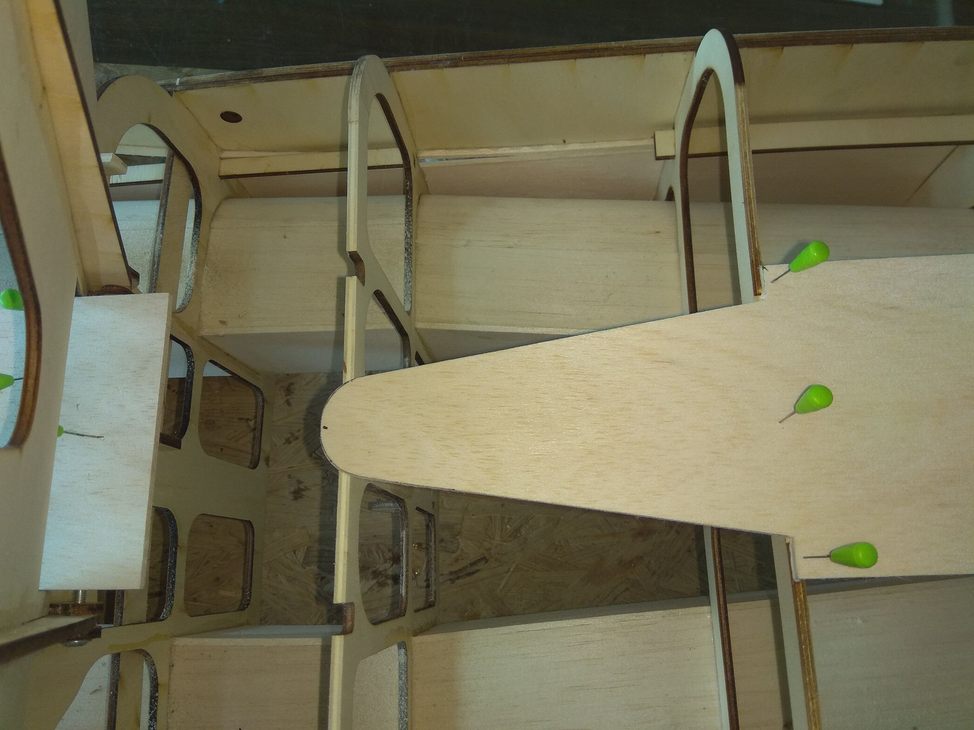

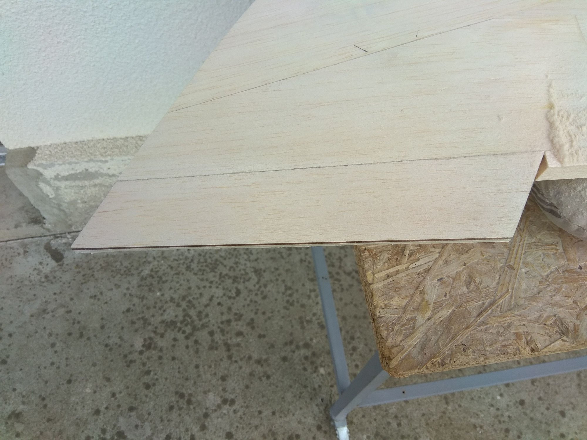

Before elevator & rudder I almost cover all fuselage with 3 mm balsa.
Front fuselage part I show before...
Rear fuselage part upper side...
Now I turn fuselage and cut support "legs"...
Next was to check how "elevator box" fit in fuselage and are wing tube and elevators tube parallel.
To be continued...

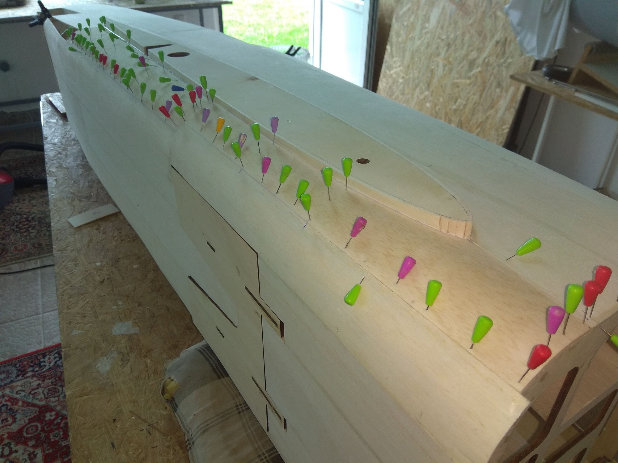

I merged the front and back part of the fuselage and sanded everything.

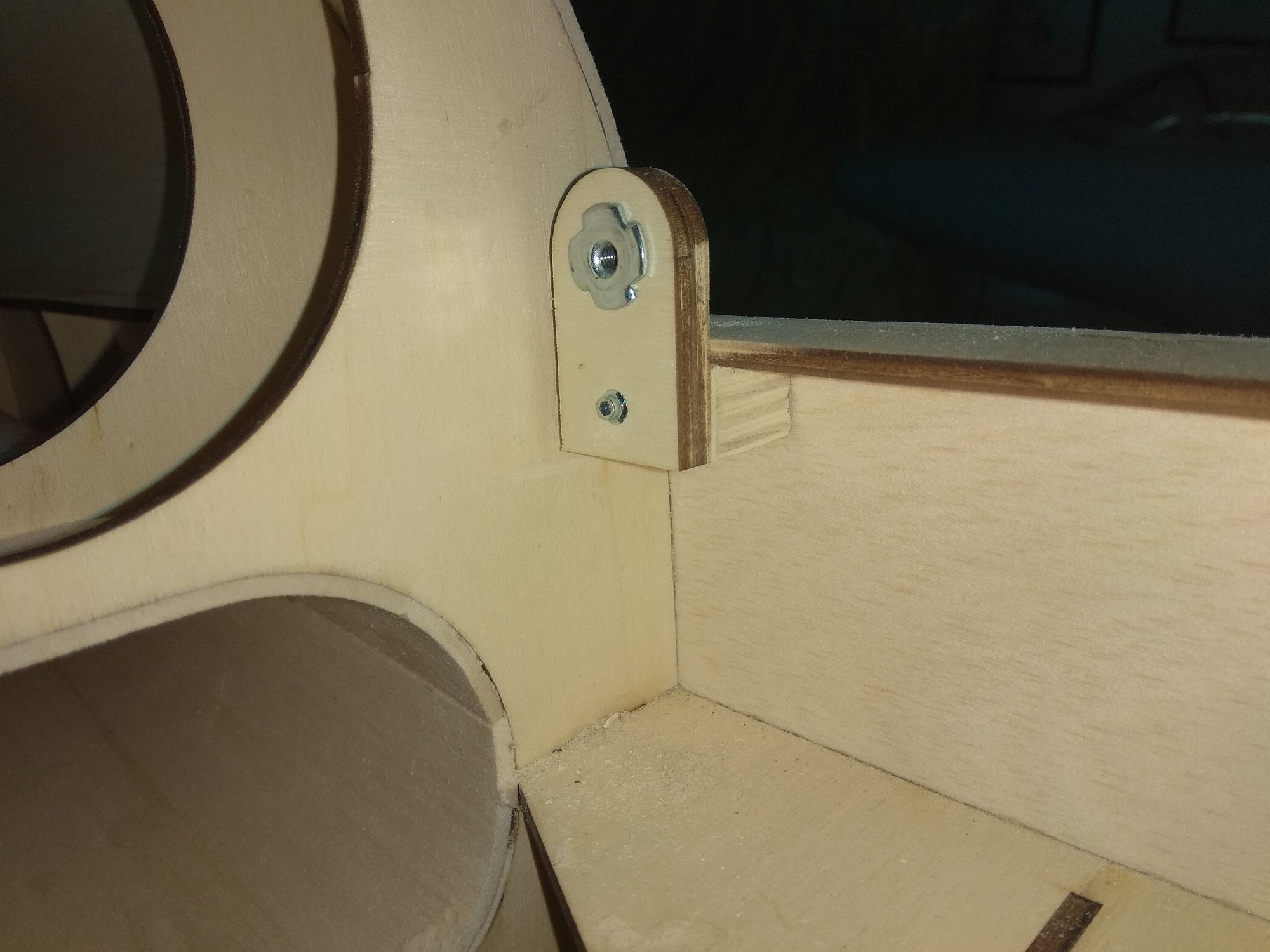

After vacation works on "Mirce models" F 100 continued.
For tightening the cover of the turbine and the cabin on the model I will use 4 mm screws.

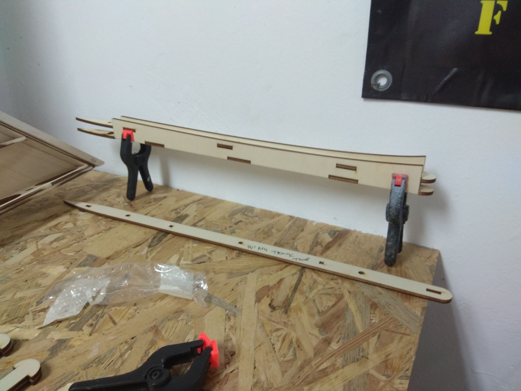

Rudder...
mirce is offline
Reply With Quote
Old 09-12-2018, 02:50 PM
  #67
mirce
Join Date: Feb 2007
Location: Senta, Serbia
Posts: 1,448
Gallery
My Gallery
Models
My Models
Ratings
My Feedback
Rudder - part II...
Unfortunately, during the work in the workshop, I broke the last fuselage rib. That's why I made a cone at the end of the fuselage separately and then glued it.
Elevators are also finished...

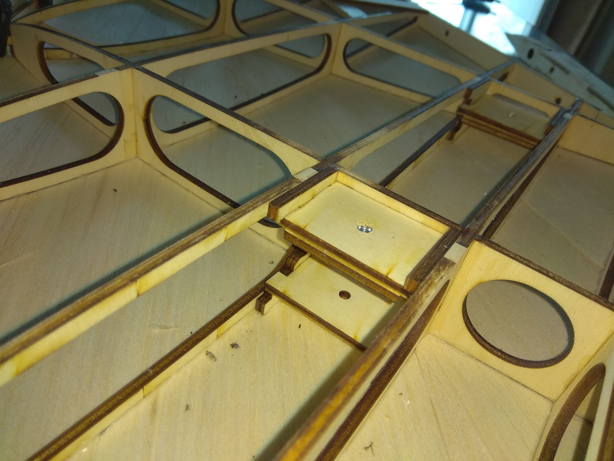

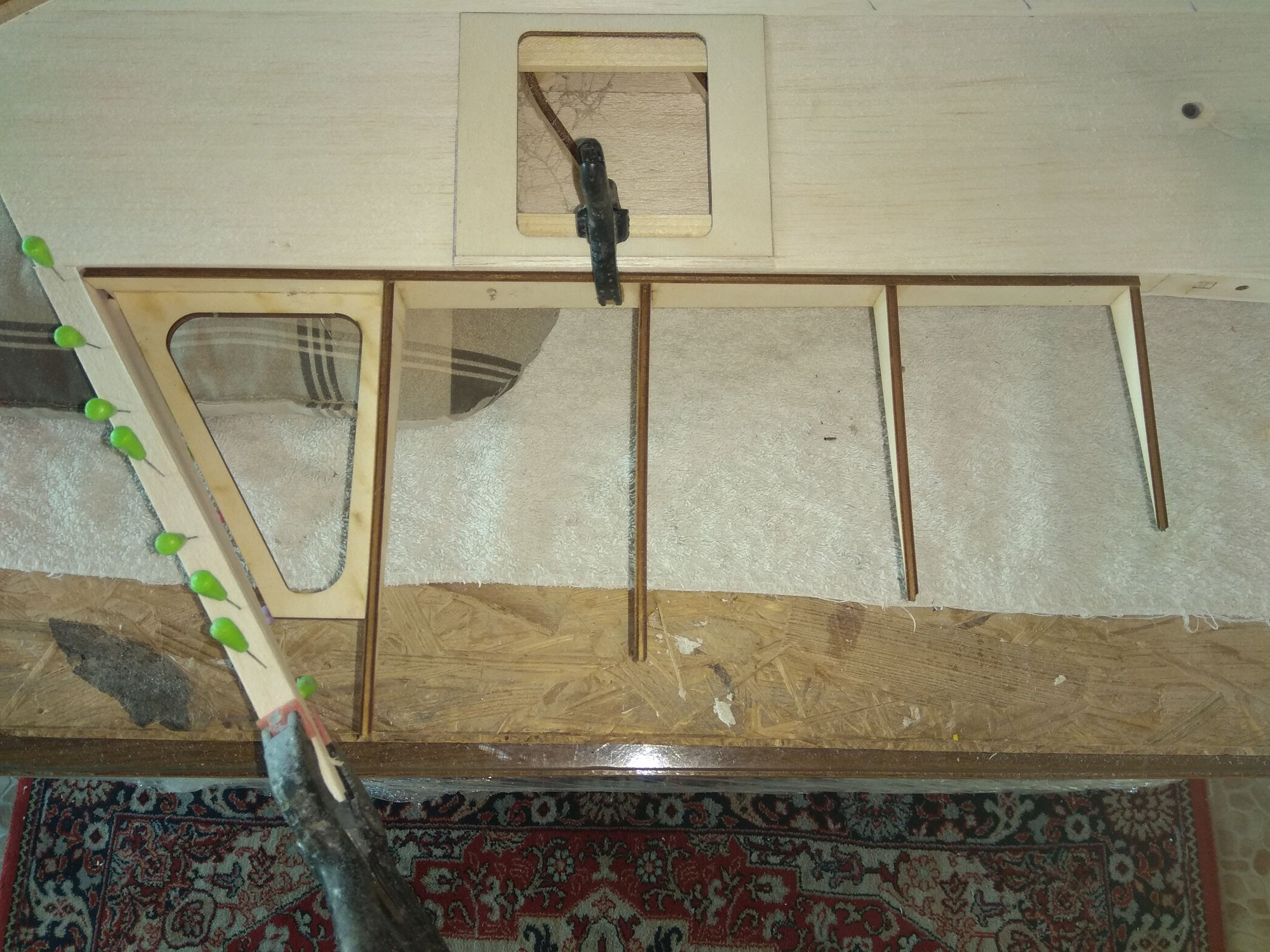

F 100 wings ( continuation )...
On bottom side first I add servo holders.
Servo carrier & cover - NS Modelers
Before planking with 3 mm balsa on the bottom side, I must insert in the wing pylon holders.
The previous step was to make the pylons.
One of offer from F 100 Super Sabre wooden kit is wing tank & pylon kit:
F 100 - wing tanks & pylons - NS Modelers
I made pylons first, take care you have left and right pylon!!!
Now parts which come into the wing...
After bottom side planking...
You can see on photos, front and rear pylon side are made from balsa. Ply plates give shape, so it is easy for sand.
Three bolts are for wing - pylon connection and two other holes are for wing tank.

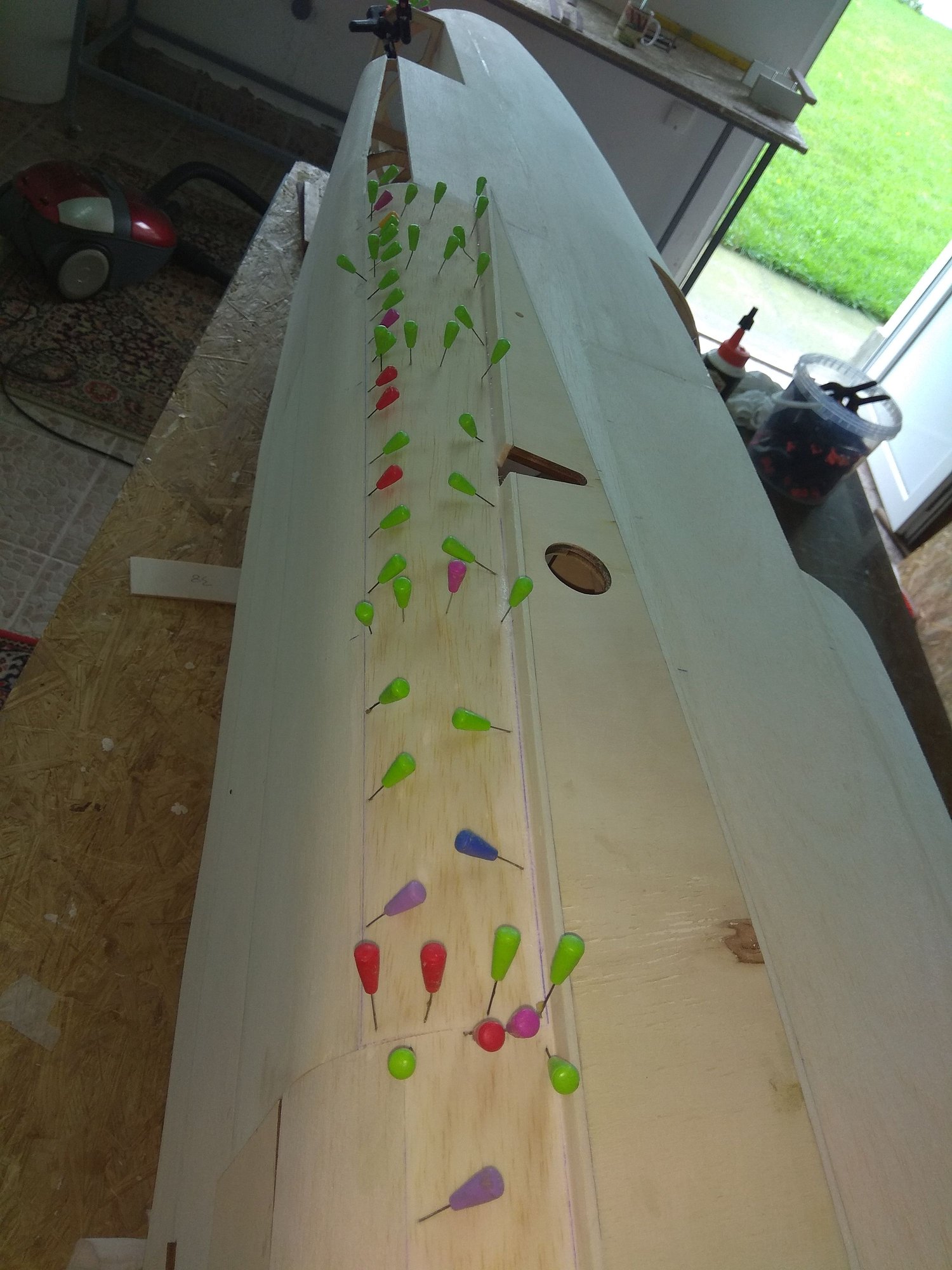

Hey, very nice ! But what are those little colored pins ? Where did you bought them ?

Small pins are from "Mibo model" hobby shop - Modelarske bucike 0,6 x 20 mm 50 kos

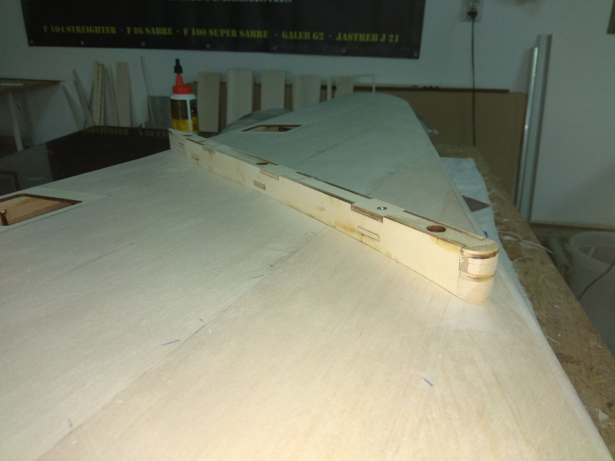

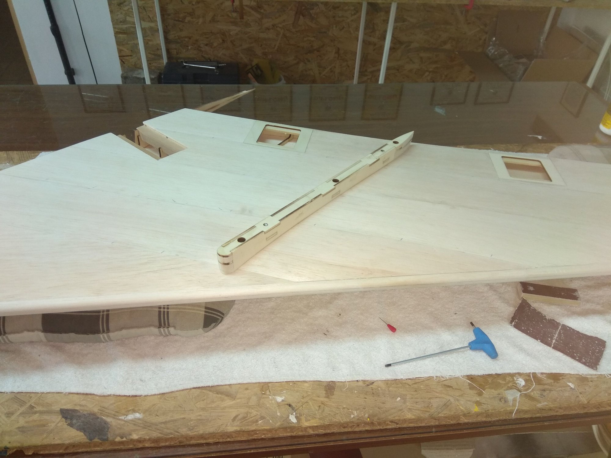

Wing trailing edge, flaps, ailerons & wing tip...
