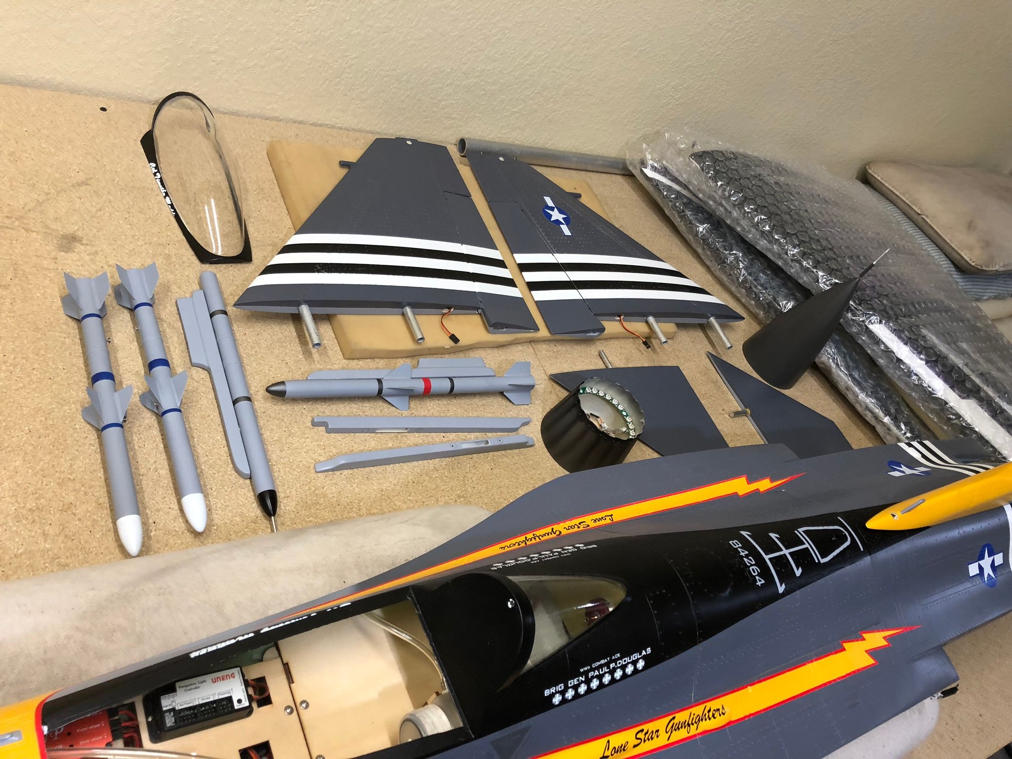

Will go over the plug and play version. This plane is 1\8th scale. Has electric brakes and gear and doors. Light option along with after burner lights is available also.
evening number 1
spent about 2.5 hours on it this night.
this aircraft is available at pacificrcjets.com
contact Dirk
How she comes out of the box

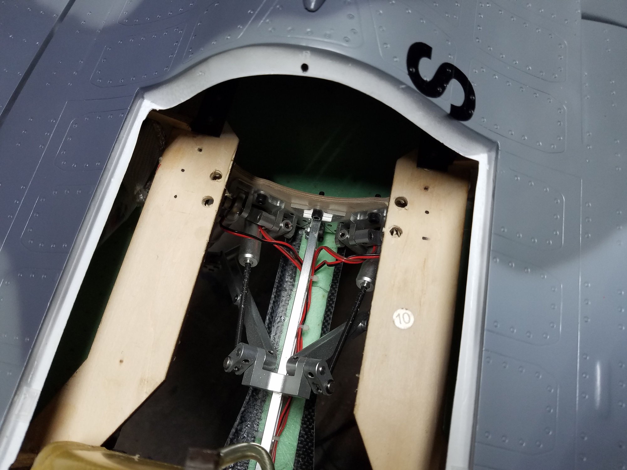

First I installed the vertical and wings. Servos are already installed and wires done so this is easy.
next was the horizontal stabs. First remove the little panel on the bottoms to access the linkage. Remove the arm and slide the elevator on and tighten the 2 set screws. Reinstall linkage and panel.
a nice touch is the wires for the tail surfaces all have heat protection on them from the factory.

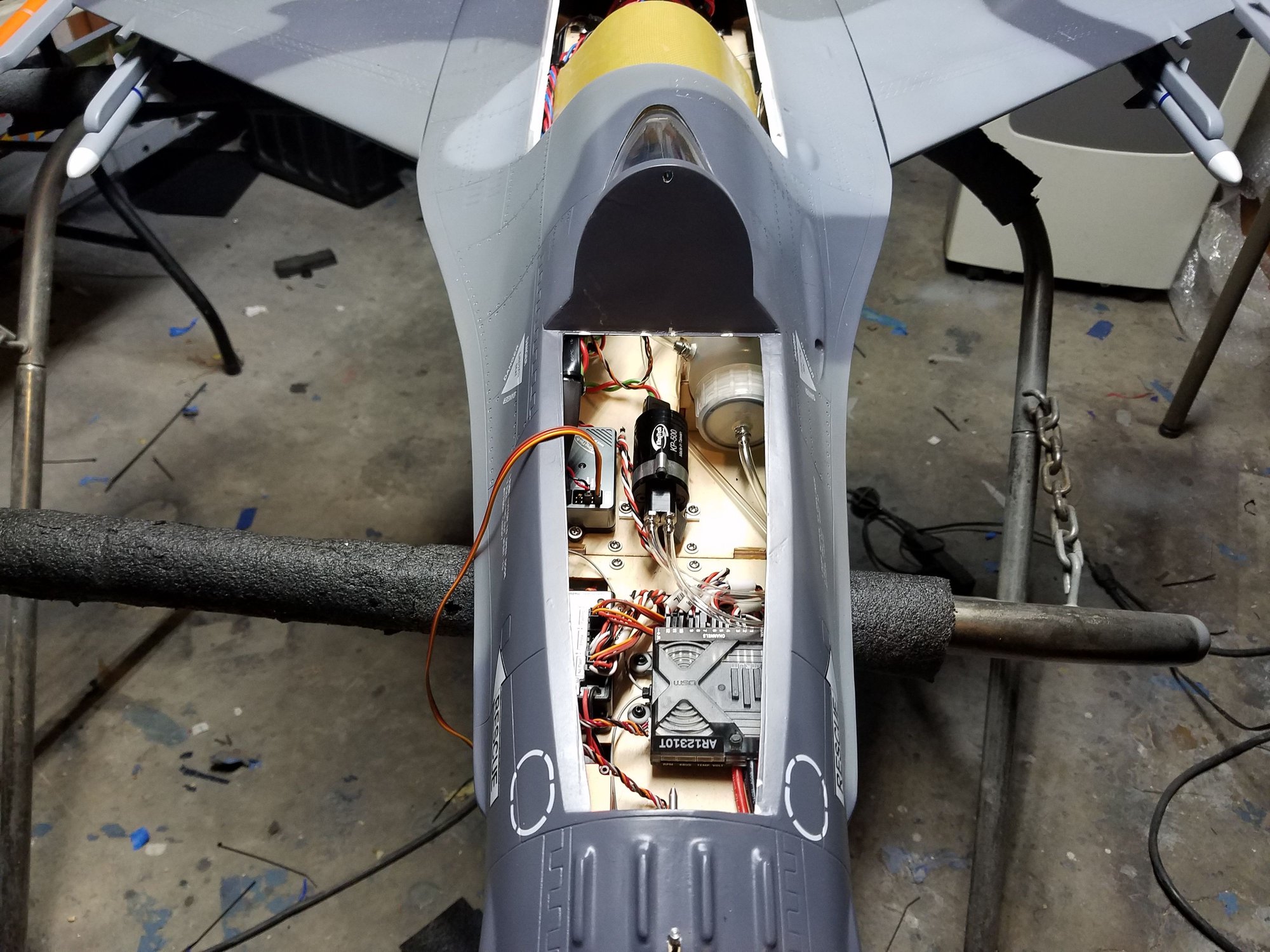

Next I started on installing the receiver. I'm using a 12 channel power safe receiver and will install the new asx gyro.
this part took some time. All the wires where labeled but it was in Chinese and I could not read it. So took me a while to figure it all out with all the light wires in the same bundle. We will work with the factory to try and get this changed.
Under the fuel tank you will find a power wire to use to power the light controller and brake controller already made. Note it has and xt60 connector on it and needs a small 2 cell lipo.

So far only spent about 2 and a half hours on it and got all flight controls done lights done and gear completed along with gear doors. Tonight I will be working on the fuel system and turbine install and if all goes well she will be done. Will be powering it with a kingtech K85. Look forward to watching my son fly this thing at Kentucky jets.

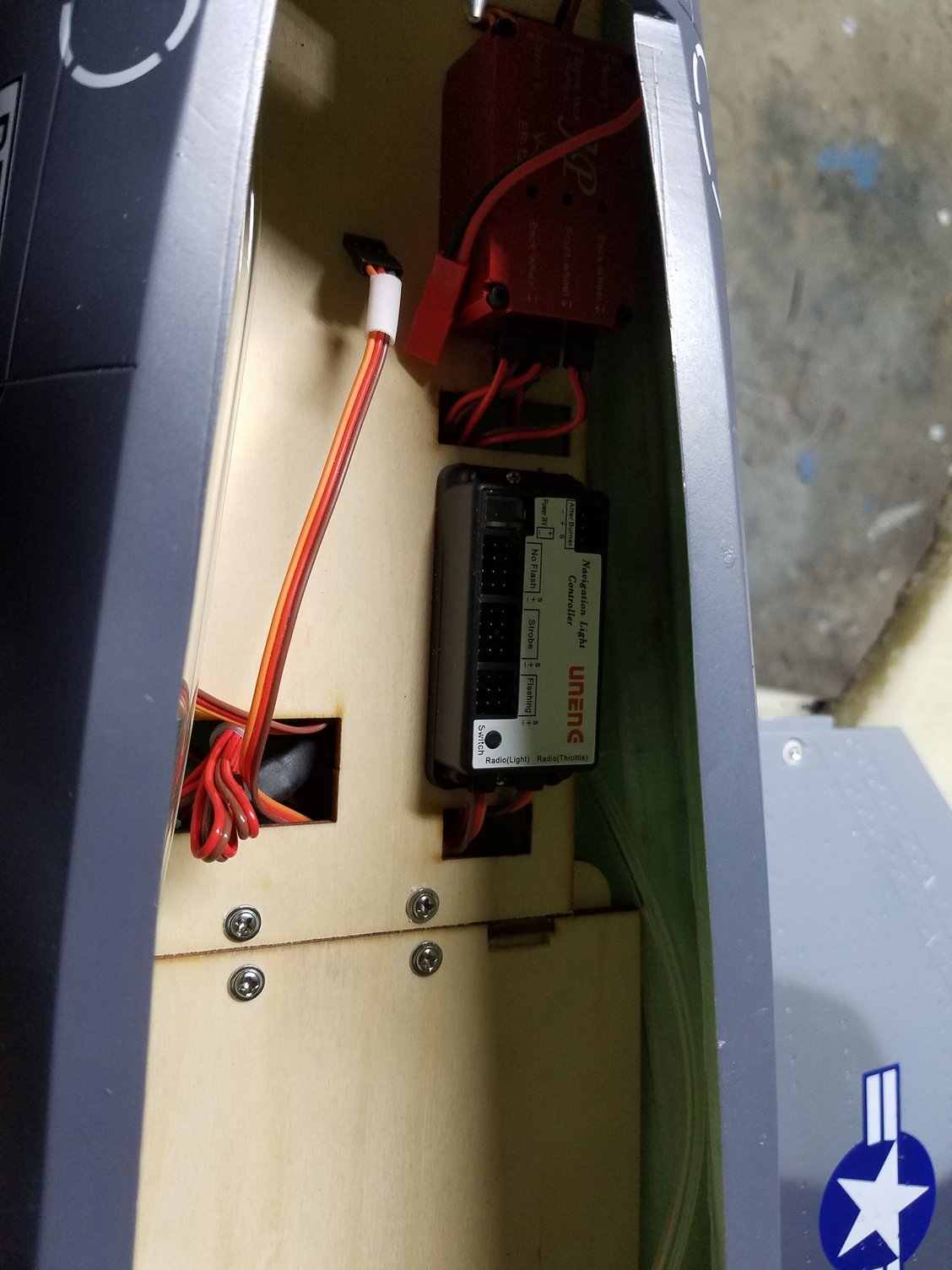

Just curious, would you ever consider running the lights off the turbine or receiver battery? I know they draw little to nothing and a tiny lipo will handle them, but in that same regard I figure why bother with an extra battery at all?

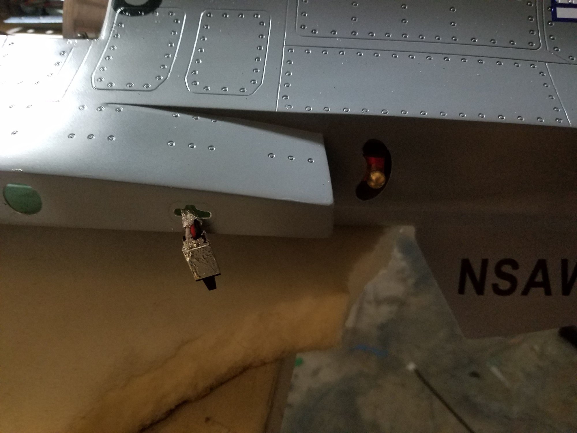

Good luck with the Nav lights! The factory installed ones on my T One still are not working correctly, and I have been waiting for weeks to get answers/resolutions from Dirk! One was dead on arrival and the other will not strobe or flash no matter which controller output port you plug into. The instructions for the Pilot Nav Light Controller appear to address the provided controller. There are three different modes accessed by the manual switch. Also, instead of using a Txer three position switch for the different modes, you have to toggle the controller's on and off switch three times to get thru them. Same for the manual switch. No instructions makes for a bit of bench time investigating these issues. Have not found a supplier that can supply an exact match for the DOA Green LED. The only ones out there that I have found are a bit brighter and have a different mounting on the heatsink. They run a bit hotter too. Hopefully the Lens Cover won't cook. Still looking for a resolution for the lower fuse LED that will not flash or blink. Like I said, Good Luck!

for the lights I just hooked it all up and left the wires that go to the receiver to turn them on and off not connected. All lights working fine.
worked on it for about an hour and 45mins. Other than cg and gyro programming she is ready to fly. So easy build can be done in 4 hours no problem.
all hidden linkages also.

I am with you! I hate lipos. But these lights will only work on 7.4
I tried the ecu life pack and they started getting hot. 2 cell life and they don't come on. Dirk is trying to get them to use a different light controller in the future.
