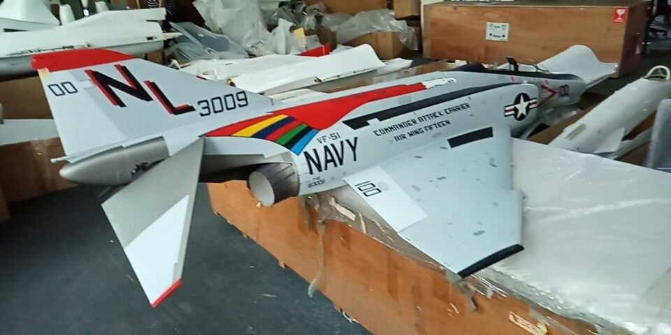

Well my new ride is almost finished
They are changing the wingtips to Red and adding another color to elevators. Cant wait to get this one going. It has tanks and bombs galore coming as well

Very nice. Twin?

Very nice Kevin. Is this the big one or the really big one??

I guess its the middle size now. I wanted something I could take in expedition without trailer. The biggest one would have been a challenge. But my buddy ordered the biggest one in same paint so I guess I will get to test fly that one.

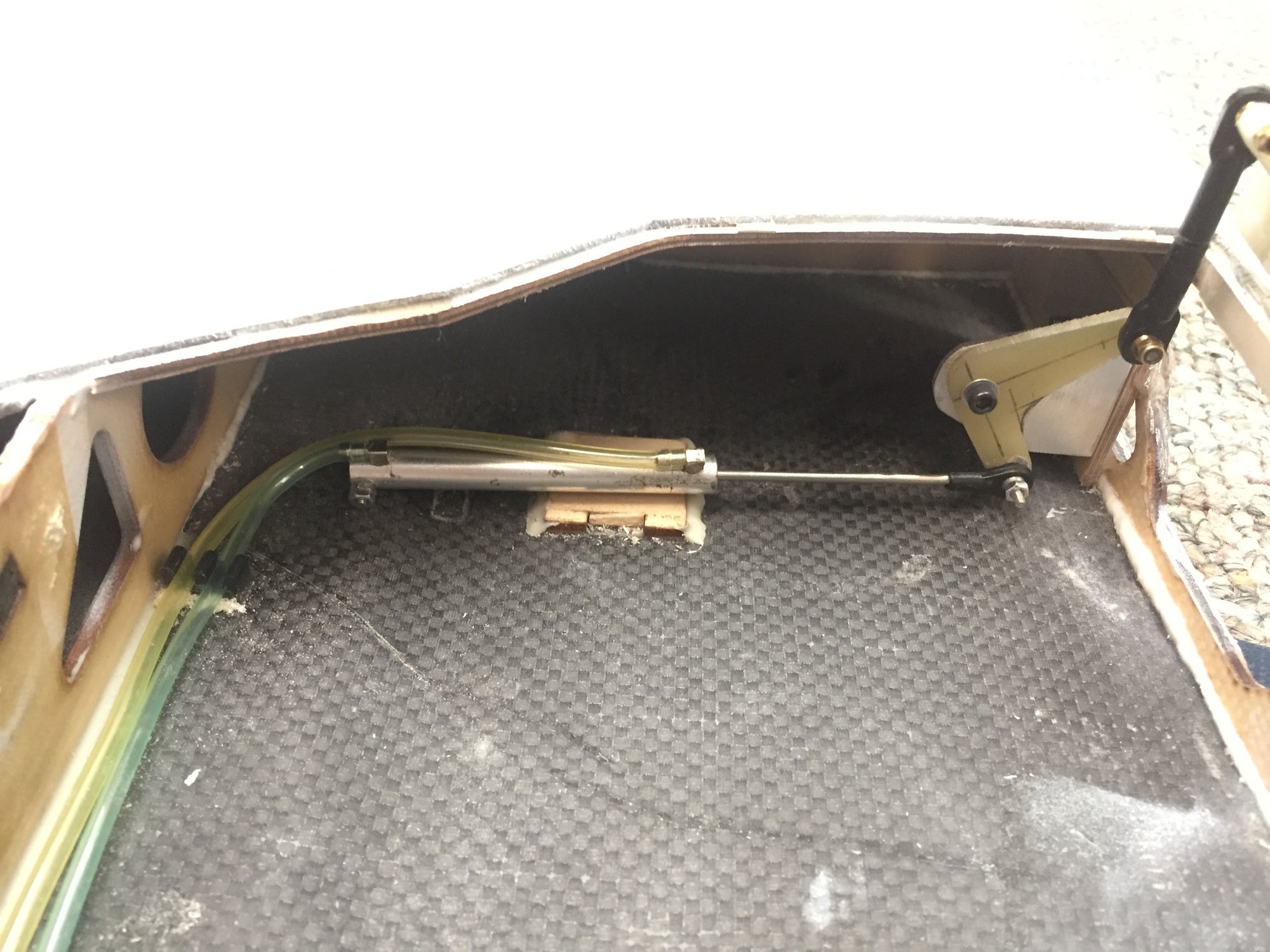

I actually worked on beefing up my main gear mounts just last night. I added 8mm plywood doublers to each rail, and I will be swapping the wood screws for 6-32 bolts and blind nuts.
I'm also going to change the main gear door linkages to use 90 degree bellcranks so the force of the air cylinders can be maximized.

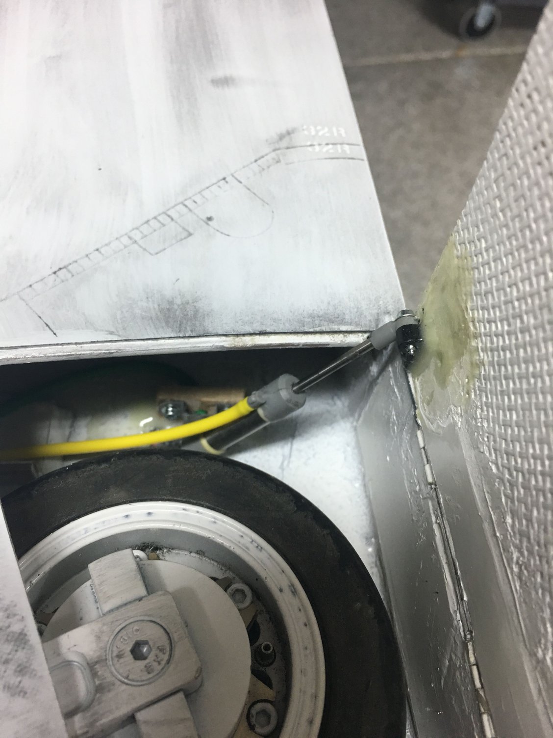

Kevin(s)
I changed the main gear doors (inner) to BV cyl at a very different angle as they never shut per the stock setup. I can take pics if you need

Kevin,
I got the bellcrank geometry figured out today. I don't have the air cylinder mounted yet, but this should give you an idea of what I did.
I tried using standard Dubro nylon bellcranks at first, but they are only 3/4" arms and did not give enough throw. I had these G10 bellcranks that I made for another project years ago and was able to modify them to work for the Phantom. The arm is 3/4" on the air cylinder side, and 1" on the door side (center pivot hole to ball link hole). The bellcrank is mounted to a piece of 1 1/2" angle aluminum that I cut and shaped into a bracket for it. The other side of the bracket is drilled and tapped for two 4-40 screws and mounts to a piece of 1/8" plywood that I glued to the wing root rib.

Hereís what I did thatís been working for me

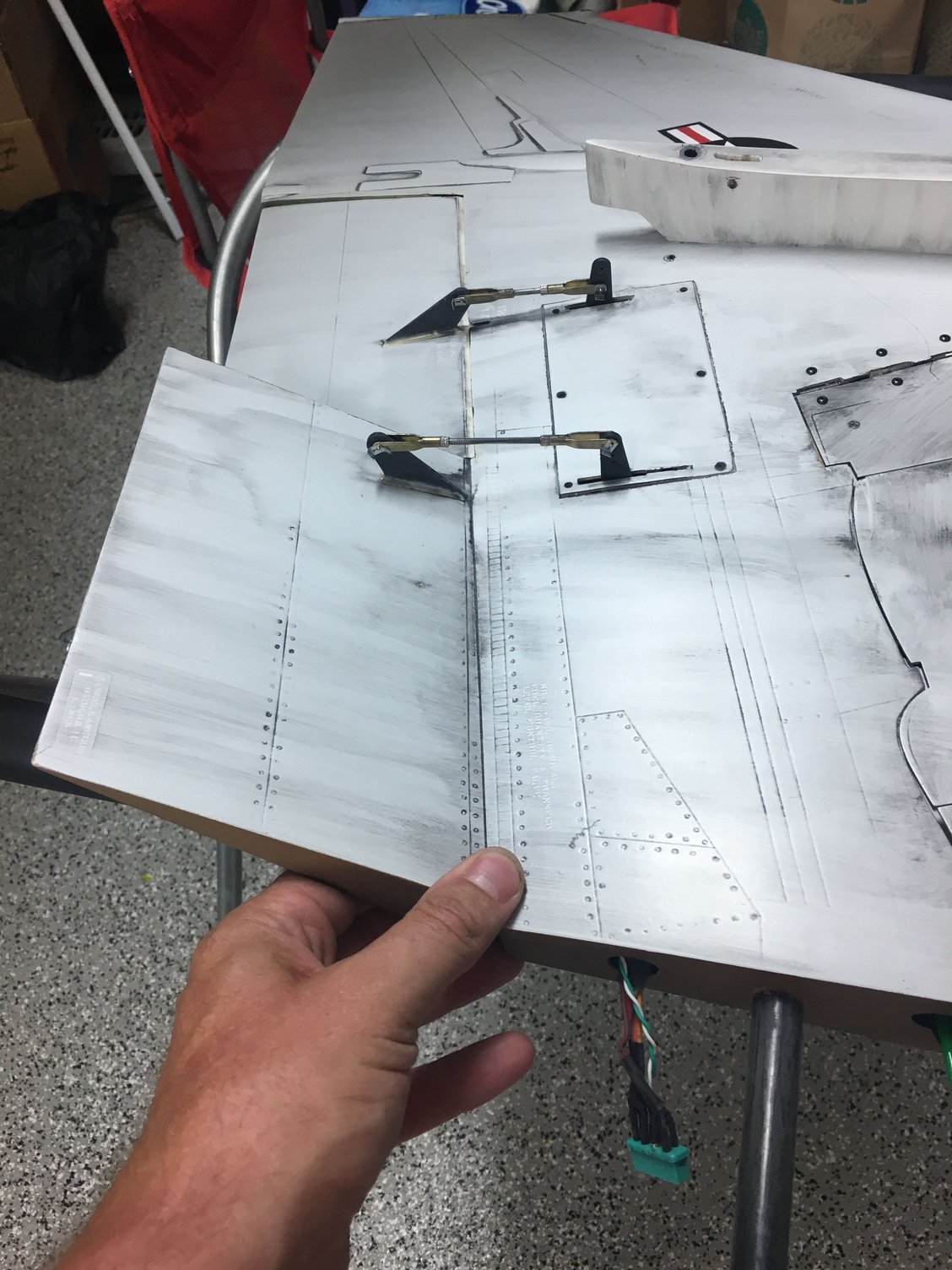

I also did this with flap horn as long as I have the wing out. Gives great geometry and a ton of deflection
