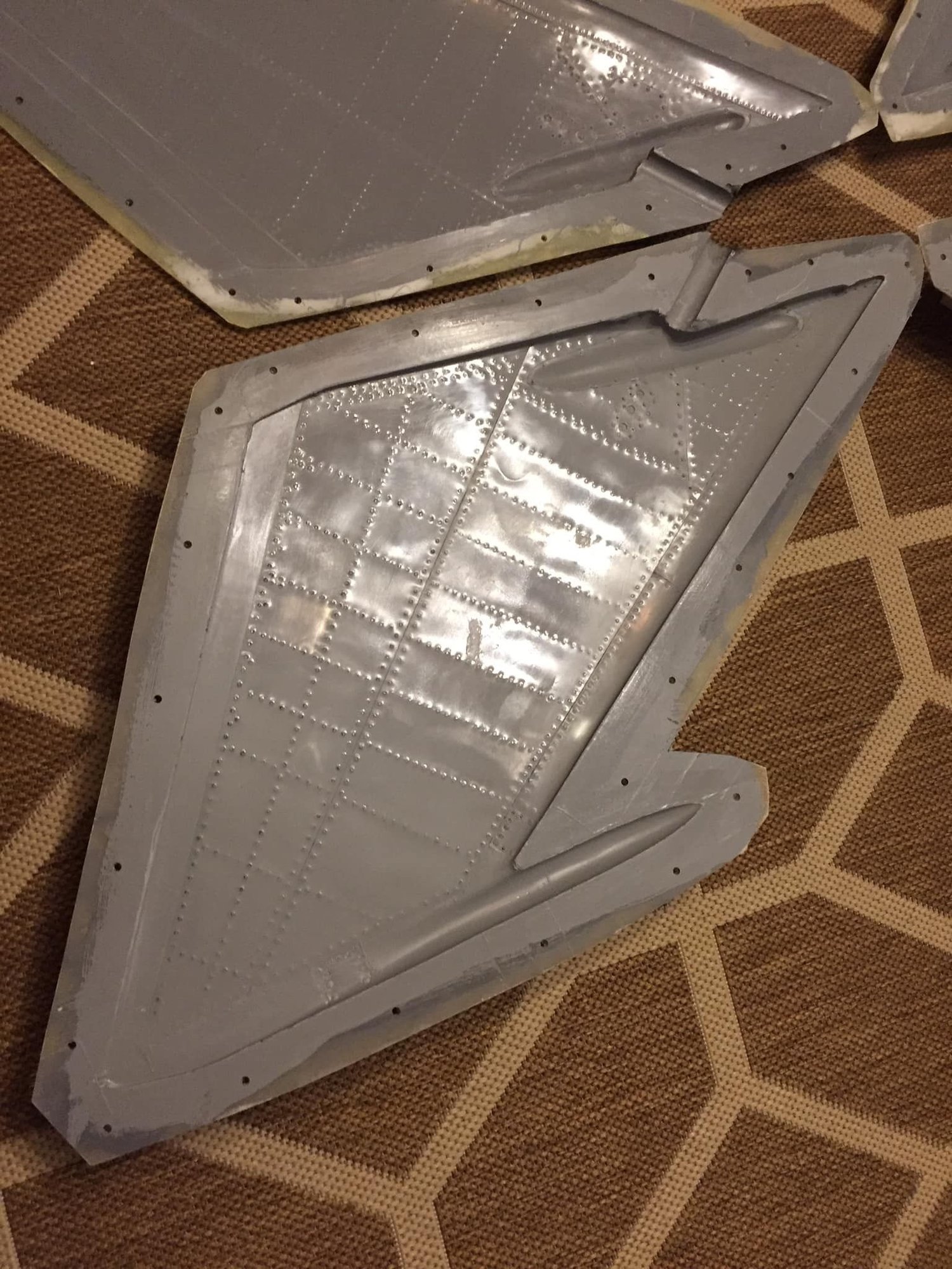

Working on last details for the plug and the mold for speed brake!
MIG 21 1/4 scale #MuguModels

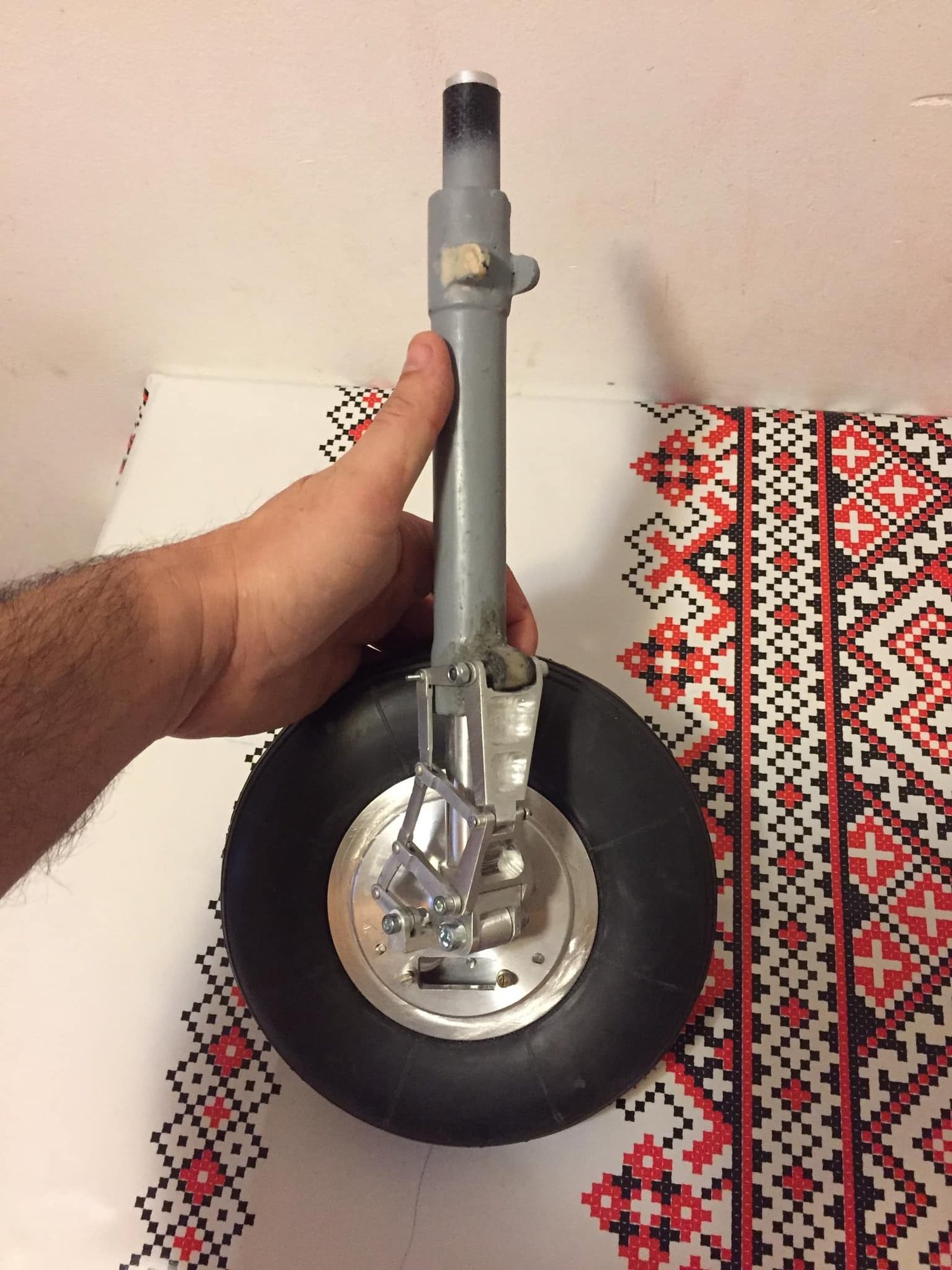

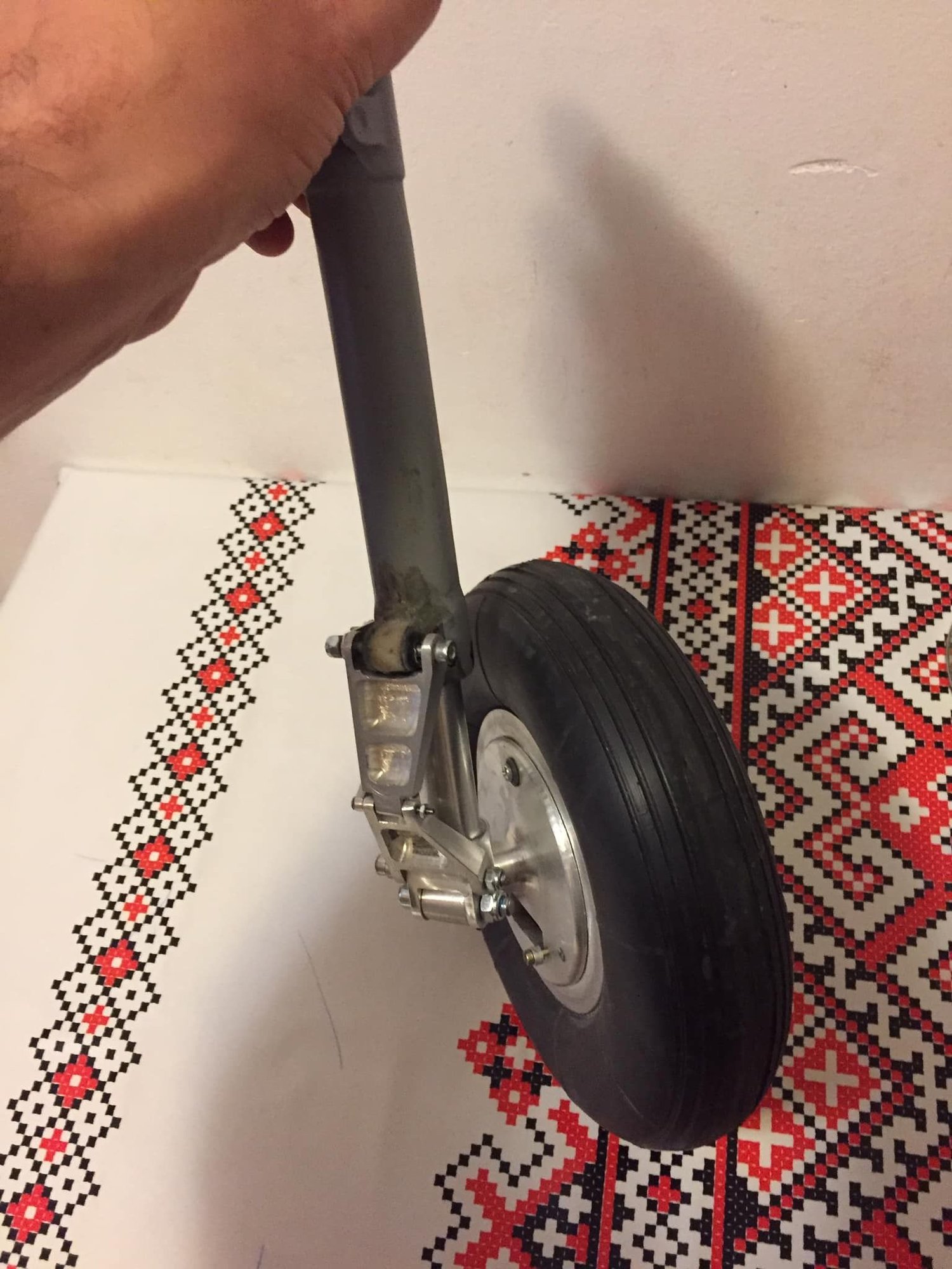

MIG 21 main LG prototipe 90% ready
Coming soon KIT #MuguModels

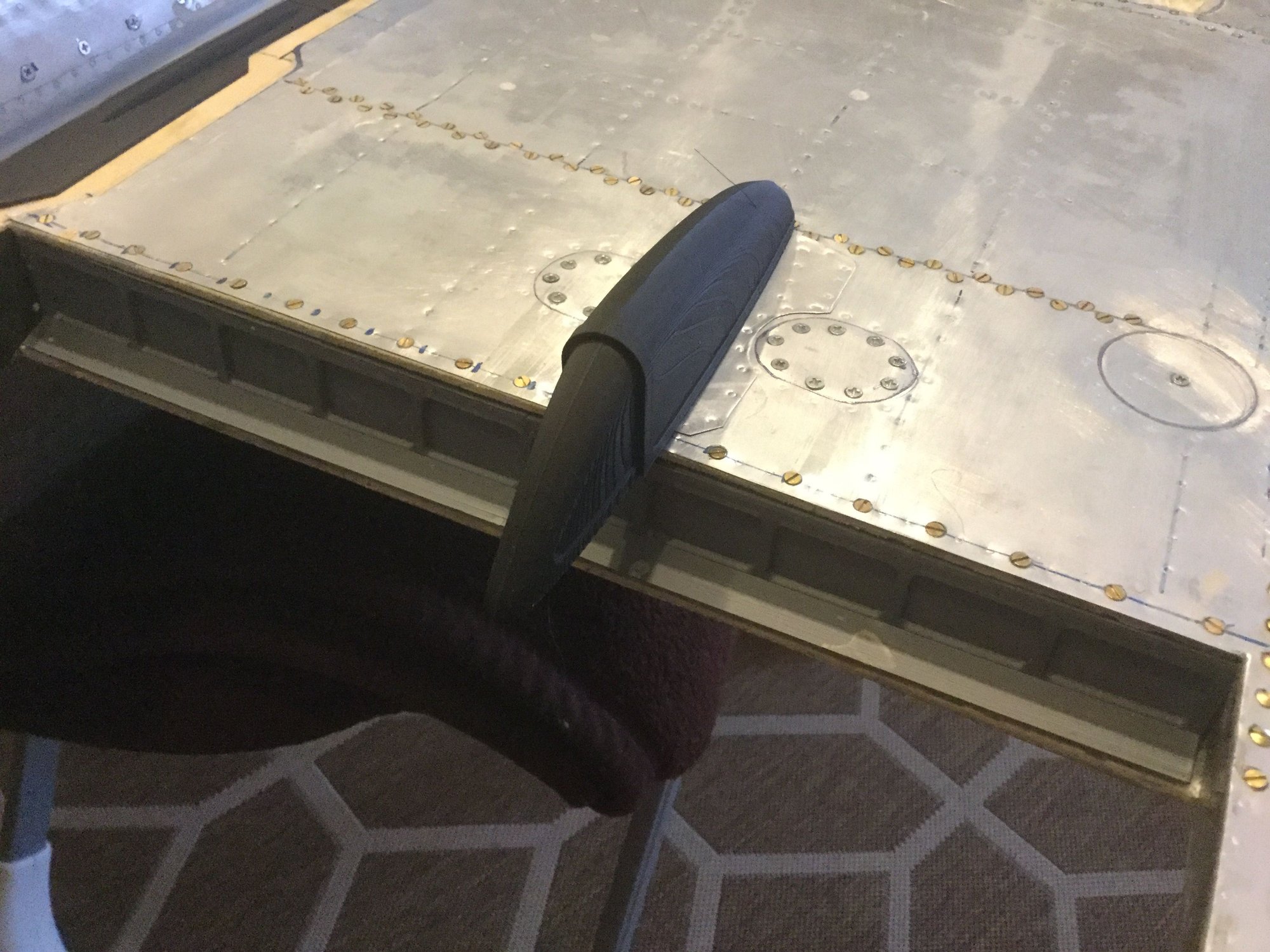

Perfect mold for interior door main LG MIG 21 1/4 scale Kit

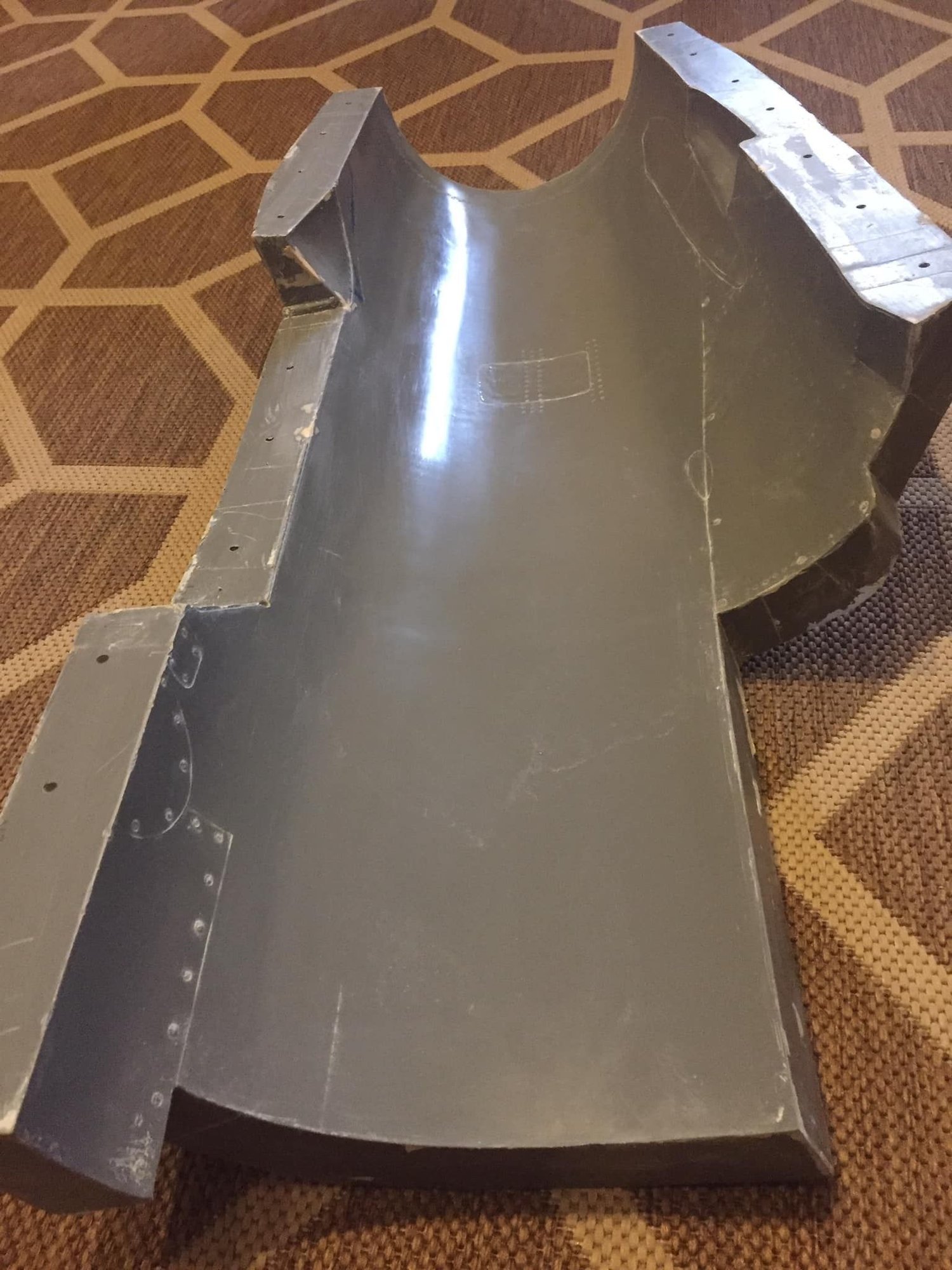

KIT MIG 21 molds makeing

Working hard to finish the mold next week and start with the first plane for the maiden fly!

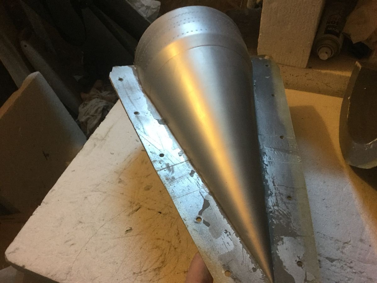

MIG 21 cone mold ready !

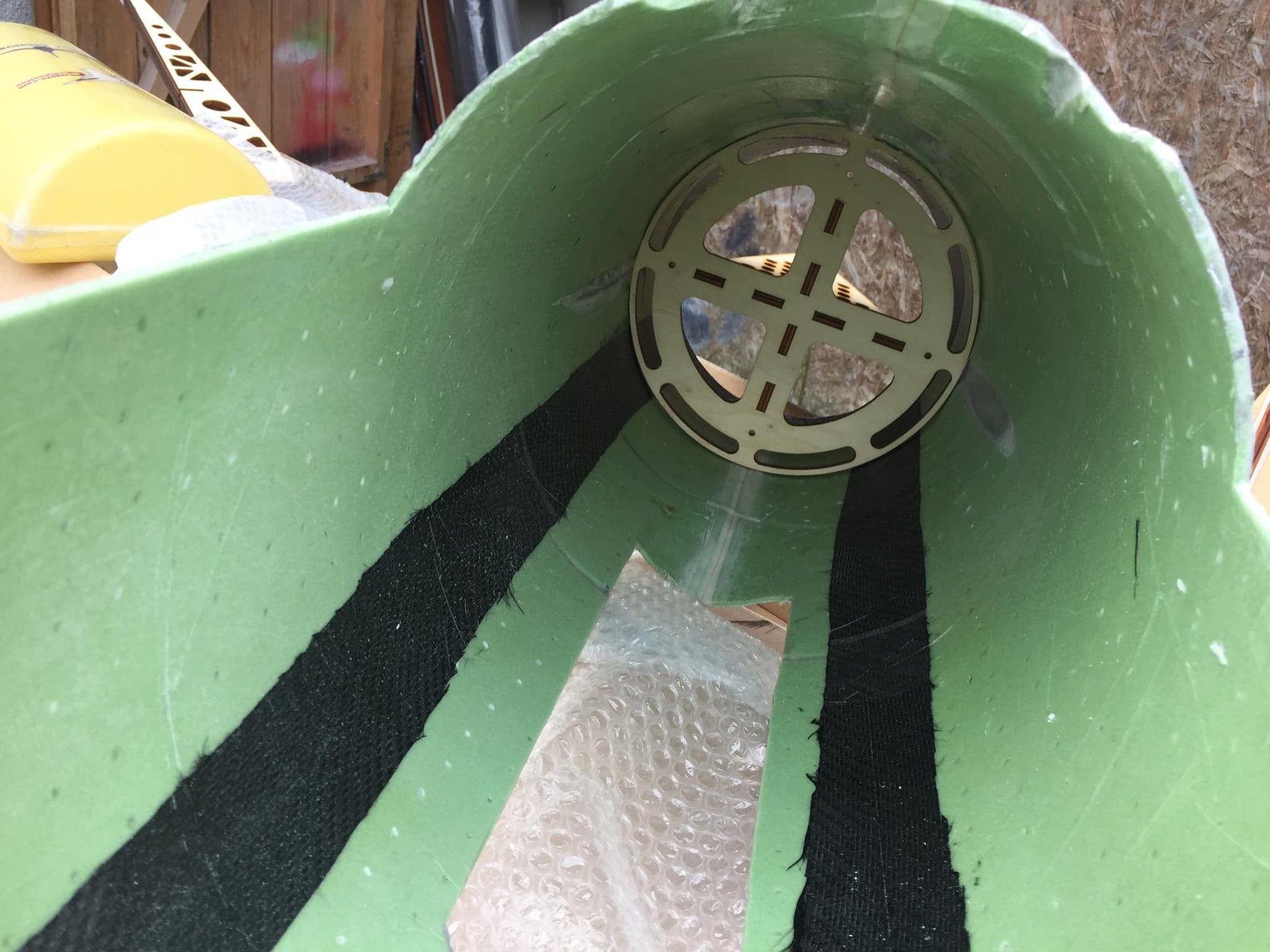

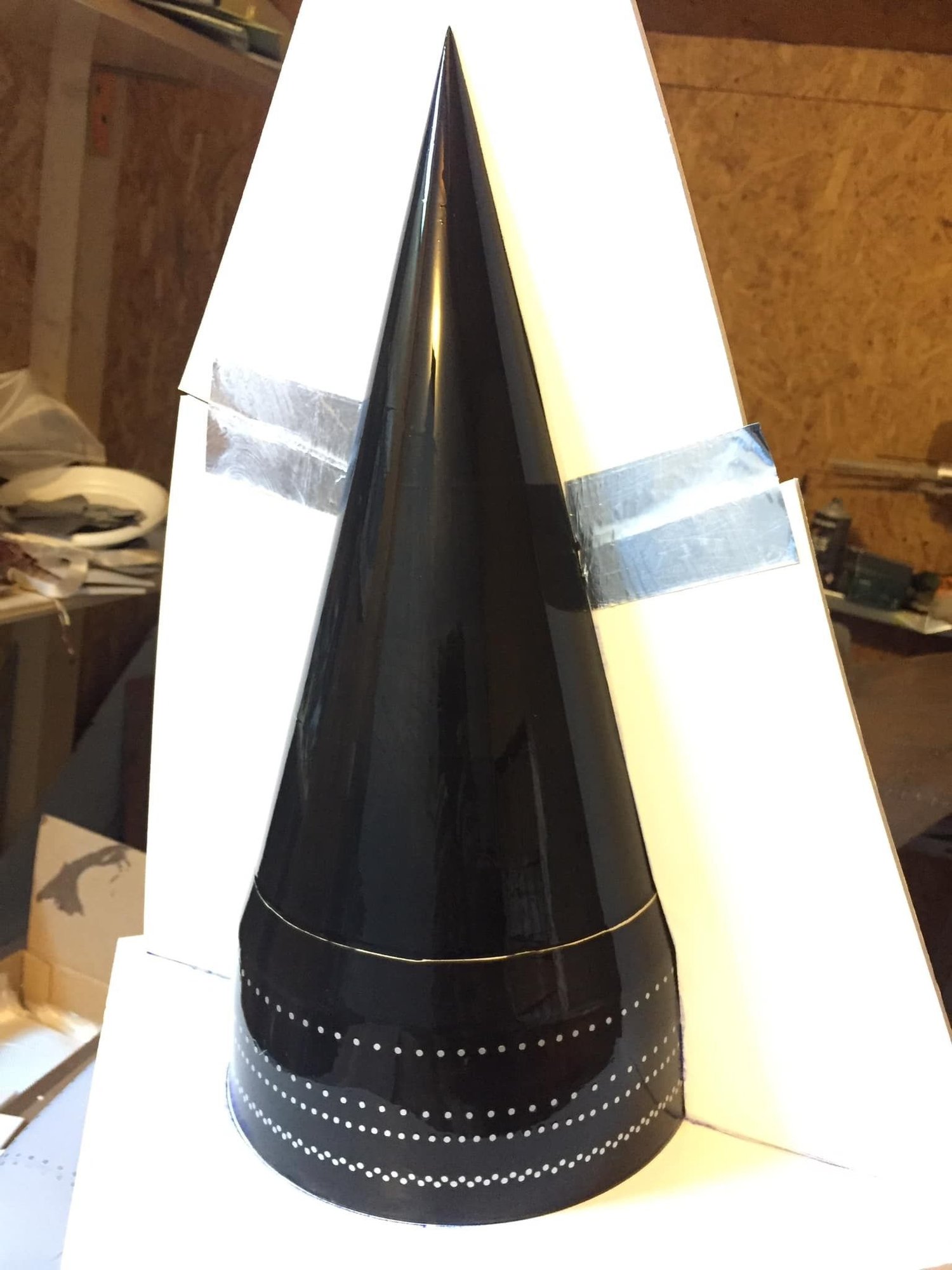

MIG 21 kit, first pieces out frome the mold,cone and front part of the fuselage,Very Very Light ,I’m very Happy🙃🙃🙃🙃
front fuselage 479g and cone 98😊

At speeds up to M = 1.5, the cone retracts to the maximum inside the air intake. In modes corresponding to speeds from M = 1.5 to M = 1.9, the cone moved to the middle position, at speeds above M = 1.9, it moved as far as possible.

Mugu,
What is your composite layup composition - number of layers and weights of cloth?
Very impressive.

I use 23 g firberglass airex 2 mm and 23 g fiberglass one layer
