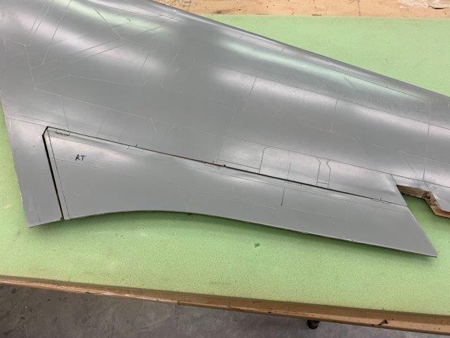

Finally got a little shop time today. Glued flap hinge covers back on flap leading edges.
Flap hinge covers ready to glue back into position
15 min epoxy used
Hinge slots opened up on bottom half of flap with a perma grit dremel grinder. The slots should not show because they are hidden by the gapless hinge design
This shows about how much material was removed to make the flaps rotate in the wing trailing edge
Hinge slots should be completely hidden by the wing trailing edge
Ready to sand the hinge covers flush with the surface
Ran out of time before I got the right flap sanded to shape. Will be next week. Leaving tomorrow for the Southeast Model Show swap meet in Perry GA.

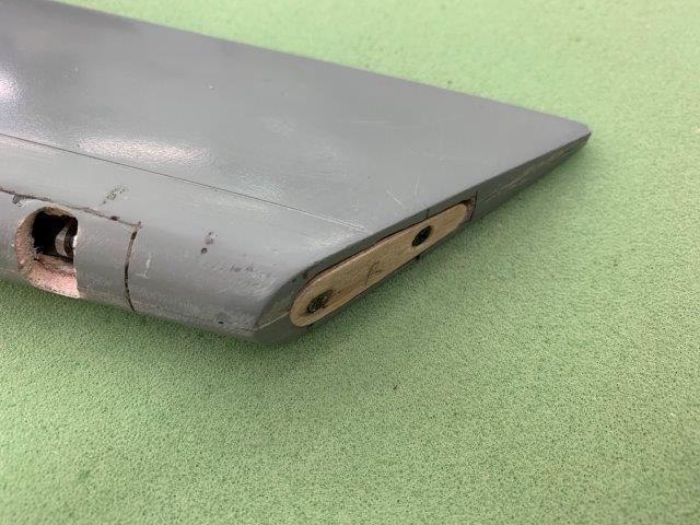

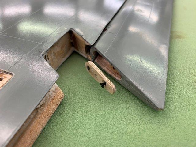

Had a good trip to the Perry GA swap meet. Sold everything I took and only got one thing to bring home. Got a new Freewing 90mm T-45 EDF foamy for 40% of new price.
Finally got back into shop this week and got started again. Finished flap end caps.
Ground out a recess in flap root end to glue in a screw plate
End caps also ground out to glue in a screw plate.
Plywood screw plates installed on both flap and end caps and drilled for servo mounting screws
Screw heads recessed below the surface level of the flap root end cap.

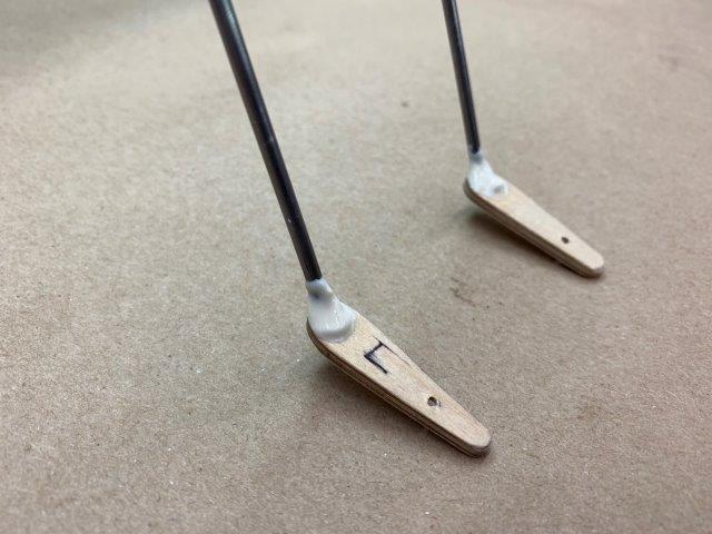

Finished the flap hinge wire retainer on both flaps
Plywood insert cut and drilled for hinge wire
Hole for retainer ground out on end of flap
Flap hinge wire retainer fabricated. Screw hole drilled and countersunk with wood block inside flap to catch screw. Plywood CA glued to wire. Hysol applied to wire later.
Wire retainer tap flush with end of flap.
Dry fit before hysol applied to wire
Hysol applied to wire and plywood tabs
Final fit flush with end of flap
Flap hinging done.

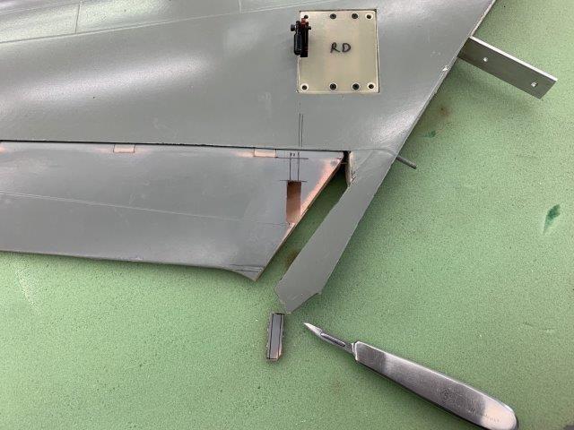

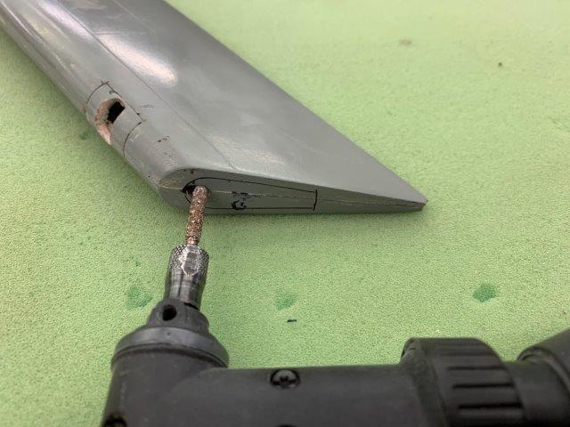

Started hinge work on ailerons
Hinge positions marked, and drilled. You have to use a dremel router bit and thin perma grit grinding shaft to open holes because a drill bit will slide off center because of the hard epoxy splooge inside the seam. I hit wood on the ends but the center missed the wood because the installed wood was not on the center. Have to install a new block for the center hinge.
Used masking tape to mark the cut outs
Ready to cut out hinge covers
Razor saw and Xacto knife used to remove the hinge covers
Covers removed and ready to clean up the wood and install hinges

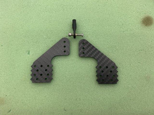

Moved to rudder control horn while waiting for hysol to cure on aileron hinge pins.
Elected to use these large CF dual horns from Booma RC for all the surfaces. Comes with ball link and bolt. I computed the servo torque requirements for the rudder using a 1.5" control horn. Spent some time to figure how to cut the bottom to get the correct position and distance over the hinge line.
Plotting location of control horn hole in rudder
Hole cut with scalpel blade.
CF horns cut to shape with dremel cut off wheel and dust collector to keep dust under control. You have to hold on to the horn after cutting or guess where it goes! Ask me how I know. Lucky it got stuck in hose and did not go through the impeller fan.
Dry fit test mock up using a plastic cotton swap stick and 3/16" balsa between the horn arms.
Rear view.

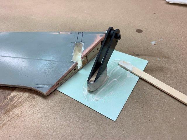

Gluing rudder horn into rudder
Rudder has no wood block to mount horn into so I reversed engineered a wood box to glue the horn into.
Used 1/4"balsa to line the hole to give the horns something to grip to.
3/16" balsa CA glued inside horn halves.
CA penetrated holes in the CF and balsa and turned the whole assemble to a very ridged control horn
Hysol applied to all parts. I used the stick to force the hysol into all the cracks and voids
Final position after clean up of hysol squeeze out. A weighted Phillips screwdriver used to hold the horn in place during cure.
Rudder control horn done.

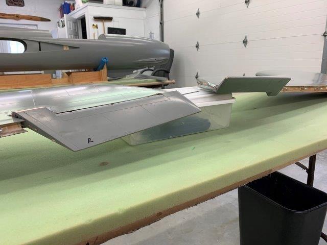

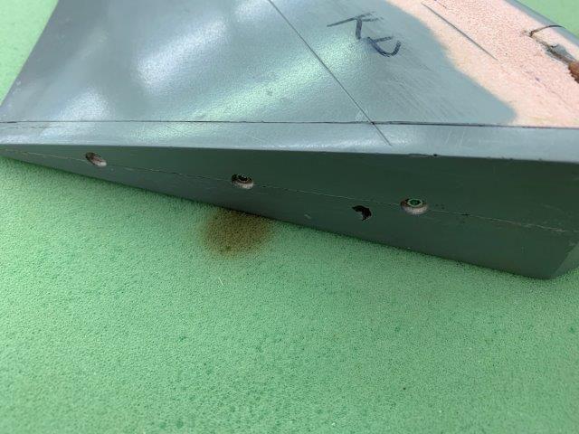

Well the next morning... the ailerons moved but just barely.
Hinge pins were all well glued in and no hysol was on hinges but ailerons were very stiff. There was no rubbing on the wing like the flaps so the problem was the hinges.
The hinges have a very tight tolerance between the slots and any offset caused binding. I had to open the slots up slightly with some sand paper. This took a while.
I also reamed out the holes with the wire technique used on the flaps. I had to open up the counter weight cut out in the trailing edge of the wing to get full deflection of the aileron.
The last step was to use a drop of BVM dry lube on the hinges and now there is almost no friction when moving the aileron.
The end caps were installed like the flaps using some plywood mounts and servo screws recessed below the surface.
We now have full aileron deflection with very little friction.
And the opposite direction.

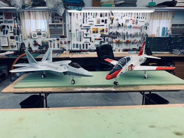

Took last week off from F-105 work to get ready for the Jason Jordan Jet Jam in Piedmont, SC.
I had previously ordered a Freewing F-22 90 mm EDF which was still in the box. Also I picked up a barely used Feewing T-45 90 mm EDF at the swap meet in Perry, GA. So I got the foamie fleet ready to go last week. Got the camper woke up from winter nap today and packing tomorrow. Departing for the jet meet Wednesday for the weekend.
Hope to get back to the F-105 next week. Looking forward to getting back to it after having some time to think through how proceed next.
Foamie fleet ready to fly!

Well I finally got back to the F-105 today. Spring chores, flying season, and family trips took up the last 5 weeks and the project sat in the corner. Last week was the Carolina Jet Fest in Scranton, SC, and even with the rain and wind was a fun time. Mostly caught up on house and yard chores now so I started at it again today.
Finally got the flat head screws to secure aileron hinge wires into the wing tips. Countersunk the holes and screws are flush now.
Tip of both ailerons.
Applied light weight body putty to the sanded areas of the flaps and ailerons. I plan to sand smooth and apply lightweight glass to the sanded areas and reprime.

I wanted to get the sanding of the flight controls done and install control horns today. Mother nature had different ideas. I just got the sanding done and then a squall line of thunderstorms rolled through South Carolina and took out the power. So much for shop time to day. Its still off now even as I write this. I've got my flight line generator running the refrigerator, TV, and computer. Hopefully better luck tomorrow.
This is as far as I got before the power failed after three hours of sanding. I don't think I will need to glass the parts again. Everything looks good and has a hard surface so I think a good coat of 2K primer will be ok. Most of the sanded areas will be hidden inside the gapless hinge area of the wing anyway.
Next step is to install control horns. The ailerons will be straight forward with the servos mounted on the servo well hatch. That is bad geometry for the flaps as it puts all the flap air loads into the servo when extended. I want to look at lowering the servo into the wing to get the servo arm nearly inline with the flap pushrod when flaps are fully extended. That will require redesigning the flap servo mount. We will see.
