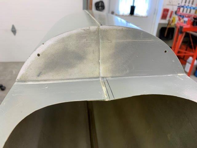

GeeBee, thanks for following the build. Its a slow process. A two seater would be cool but since I flew single seat so I'll keep the one holer. Besides I'm in over my head just mashing these parts together.
Made some headway on the hatches today.
I started to fit the turbine hatch and found it was not square with the fuse. When in place the front and rear edges stuck out a lot. So I decided to mount it and then figure out how to make it fit. This is the aft right side, about 3-4 mm off.
Aft left side is recessed about 2 mm on bottom and a little on top
The front right edge is recessed about 3mm
The front left edge sticks out about 1/4 inch and looks like somebody took a hammer to it to smash it back in.
Dowel holes marked on front of the hatches
Dowel holes drilled for carbon tube dowels
Hatches taped to fuse and holes marked from inside. I made a long extension for the marker to get in from the rear to mark the turbine hatch holes.
Turbine hatch holes marked on front of hatch
Turbine hatch holes drilled.

I started to sand the edges of the hatch and fuse to get a better fit. I used a permagrit bar and electric sander to make faster progress.
Sanding the front left side of the fuse opening
Sanded the front left edge of the hatch. Cut through the glass in one place. I will patch it from the inside with some glass and carbon tow in the corners.
Sanded the aft right edge of the hatch
Sanded the aft right edge of the fuse opening.
Fuse turbine hatch opening front edge sanded hard on left side.
Final dry fitting with carbon dowels
After several hours of cut and fit I finally got the hatch to fit OK.
Viper1GJ is offline

First dry fit. Had to sand the bottom of both side to make it fit.
Canopy taped into position.
Hinges points tacked in with servo screws in previously drilled holes.
Canopy bow from inside looking forward ready for tack gluing with medium CA. The plan is to drill a hole on each side near the bottom of the bow and use a hatch latch mounted in front of the bow to lock the canopy down on each side
Canopy removed after bow tacked in with CA
This is as far as it will open with out removing the rear section of the canopy
The rear wall of the canopy bumps into the top of the hatch behind the canopy and stops the opening. I will deal with that later.

Securing canopy
Holes drilled in canopy bow
Canopy taped to canopy hatch and holes drilled through the bow into the forward canopy bow
Forward canopy bow holes drilled
Latch dry fit into holes
Latches tacked in place with medium CA. Everything worked so far. All parts will be secured with hysol later.

Cockpit hatch latch installed
Latch slot cut and latch pin hole drilled
Latch tacked in place with medium CA
A dot of black craft paint applied to tip of latch pin
Latch pin hole position marked by fitting hatch and releasing latch pin
Cockpit latch fit and working
Plywood donut tacked in to backside to provide a better latch pin load bearing surface with 5 min epoxy. I will secure with all the parts with hysol later.
Viper1GJ is offline

Turbine hatch latches installed
Turbine hatch latches installed as before with slot and latch pin hole cut and then tacked in with medium CA.
Latch pin holes marked with black paint as before.
Latch pin holes drilled.
Latches installed and working ok.
View from the rear
Plywood donuts installed as before and tacked in with 5 min epoxy. Will secure with hysol later.

Canopy hinges completed
I cut the back wall out of the canopy frame with a dremel cutoff wheel and trimmed it with a permagrit grinding drum
Plywood support donuts installed and hinge arms drilled and tapped for a 6-32 x 1/2" socket head bolt. Fortunately the hinge arms had a wood block installed during layup to support the bolt. I hardened the threads with thin CA and the bolts are very well seated in the wood threads.
Now the canopy will raise and lower normally.
Rear view and hatch latch
Happy snaps to look a the days progress.
I installed the radome just for the "cool factor" in the photo
