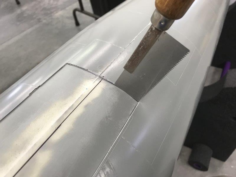

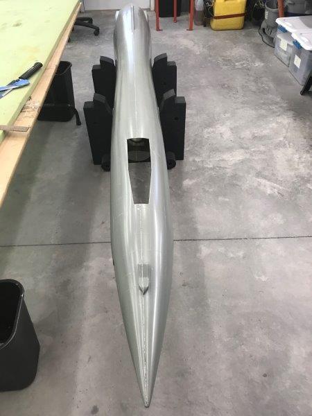

I cut out the nose gear well using a razor saw and flush cut saw. My kit did not come with nose gear doors and I'm not sure if there are any. Larry is looking to see if there are some in his kit parts. If not I will use the nose gear well cut outs as doors so I wanted a thin kerf so I used the razor saw instead of the Dremel cutting wheel.
The seam line is not the center line so center line was marked after sanding the seam line smooth. I wanted to do the rough sanding before cutting because it would be easier to hold the fuse rather than the small cutout.
Razor saw with pads taped on help hold on to it.
Corners cut with thin flush cut saw
Gear well cut out removed and edges sanded smooth
The seam line is not the fuse centerline. Easy to see on the gun camera housing.

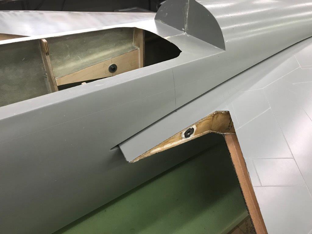

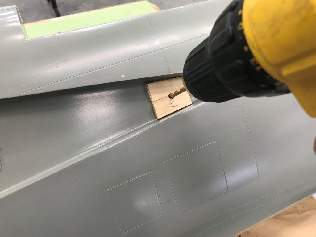

Next steps are to install the wing trailing edge hard mounts. Still working toward getting the jet on the wheels to check the gear toe in.
Projecting the location of the trailing edge wing bolt. The plan is to drill all the way through the wing root to the flap side and install a 10-32 blind nut.
There is a 1/4" gap between the fuse and wing root when the wing is bolted on. I installed a spacer so the bolt will hold the wing firm with out pulling it in.
Pilot hole drilled from outside in spacer location
Wings installed and bolt hole drilled from inside out through wing root
10-32 blind nut installed with bolt
Blind nuts secured with hysol
Wings installed ready to mount gear

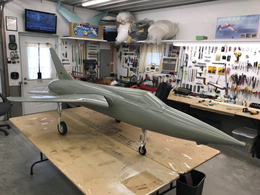

Next step is install gear and get it on the gear. Then check the ground pitch attitude and then main gear tow in.
Main gear installed
The gear looks huge, just like the real ones
First look on the the wheels, it sits real tall and the main gear has lots of toe in...bad.
Happy snap on wheels
Ground pitch attitude is slightly positive so the nose gear mounts are ok.
The nose gear strut is slightly forward as planned from the three views I have.
View from the rear
Aligning the fuse parallel to the tables to get a center line to check the main gear toe in
Fuse aligned and centered on table ready to mark the gear toe in angles

After checking the main gear toe in I got a little discourage and and hurricane Florence was approaching so I decided to stop working and make the F-105 a static display for now. This is when I experienced a little scratch building humor.
The fin spar blade attaches to a plywood former inside.
OOPS I followed the "instructions" but must have skipped this step...the former will not fit into the tail after the aft turbine rail half former is installed. Note to all you guys building your F-105s don't install the half former until you install the fin former...just in case you wanted to know.
Solution is cut the former in half.
Half former inserted and fin spar clamped on. Good enough to look at for now

Static display eye candy before hurricane Florence. Enjoy
