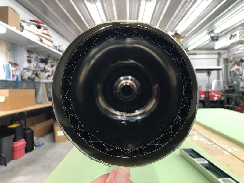

I went back with more time to do a repeatable shim test to make sure the turbine and pipe are straight and level with the fuse.
This time I used a 3/4" shim under the turbine and pipe. The fuse was leveled in pitch and roll.
I ensured the fuse was level and the pipe was level and centered in the nozzle exit hole.
Pipe centered in nozzle exit hole.
Now it looks right from the side. I will go ahead and cut some longer 3/4" plywood shims to mount the turbine and pipe on.

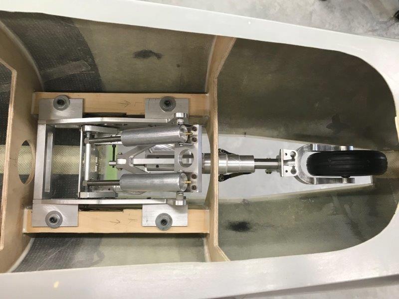

Dry fit of nose gear and gear door hinges to check for gear and hinge clearance.
Mock up of extra large offset door hinge from enlarged drawing of 3D printed hinges from Ultimate Jets.
Double sided mounting tape use to place hinges in fuse for testing
Wire use to keep hinge pivots in line
Blind nuts installed in nose gear mounts
Nose gear mounted to test for clearance of door hinges
Gear strut clears hinges when extended
I had to move the large hinge forward to clear the tire when retracted.

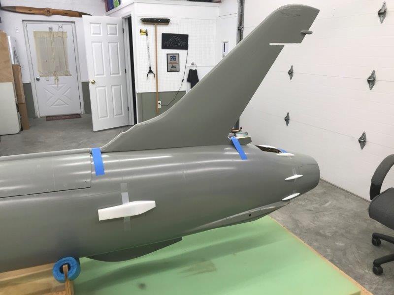

While I've been cutting and hacking in the shop a good friend, Keith Alexander, who is real good with the 3D printing stuff, offered to help with 3D printing of the engine bay airscoops and speedbrake hinges. The speedbrake hinges on the full scale hinge the 4 pedal speedbrake shell that also functions as an afterburner nozzle. They are quite distinctive and add character to the jet. The speedbrake 3D print file was developed by Bob Rullie and he emailed it to me.
The engine bay air scoops were added on later model F105s to help stop engine overheats and fires. They are on all F-105Ds which is what I am modeling.
Speedbrake hinge tear drop shaped covers on full scale jet. There are 8 total.
Engine bay air scoop on full scale. There is one on each side. I gave Keith this photo and several others, some known dimensions from the model, and we were able to determine the scale size of the scoop for the model. Then he developed the CAD model and 3D print file based on the photos.
Speedbrake hinge 3D printout.
Engine bay air scoop 3D print out.
Full set ready to go. We will print two sets, one for me and one for Larry Sorenson plus some spares. Thanks Keith for all your help.

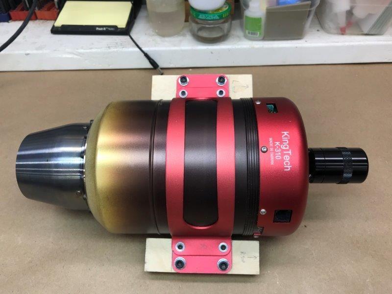

I started trying to get the K-310 turbine in the mounts. I quickly found out it is really tight even though my pink foam template showed a good fit. The F-105 coke bottle fuse shape is most narrow at the turbine mounting location, which makes the tight fit worse.
The K-310 has a wide can size and large mounting bracket. I did not realize the bracket extended so far under the wing inset pocket. That makes it is very hard to get the holes drilled, a bolt in, and a tool to turn the bolt. The is not much room between the can and the wood rails for heat resistance on the wood rails so I considered shaving off some of the inside rail. Then I looked at using the bracket bolts for mounting to the rails but there is not much wood meat there after shaving a little more clearance for heat. Also to center the turbine on the fuse centerline it has to be slightly offset to the right on the rails since I found the entire fuse to be slightly offset at the turbine mount area.
The photo does not show well the distance the mounting holes are under the wing pocket. Its really under there and not much clearance to get a bolt in.
After all this for a day I got frustrated with it and put it in the penalty box for a while. I have some radio installs and upgrades to do on other jets so I'll do that and think about what to do here. Maybe a smaller turbine would be best, but I like the thrust available if you need it. Plus I got the K-310 in a no cash trade so no funds spent on it. Arrrggghhh!

Get a couple of mounting tabs from BVM and discard the engine mount. You can use the provided hoops that come with the mounting tabs or a pair of extra large hose clamps, Unless there is a specific need for the kingtech mount.

You could just use the inside holes of the hoop also? Either w/ blind nuts or self-tapping screws. I have never had a problem w/ self-tapping screws since they is no vibration.
Seems like an easy fix.....

Yes the inside holes of the bracket were my first idea. Probably will work ok. I got several ideas sent today, angled bolts with threaded inserts on bottom, bolting the turbine to the 3/4" risers and then bolting the risers to the rails, and others. The F=105 been on the back table for a week now and it seems workable now. I just got frustrated that my plan did not work at first so taking a break has produced several solutions. That's what's so good about this forum. There are so many smart folks here that provide great ideas.

Also, you could add a carbon plate under the ply mounting rails and tap into those.

I finally got back to the F-105 this weekend. I took a couple of weeks to update and install the Jeti radio and CTU in my Sabre XLT and Avanti XXL. I'm very impressed with the CTU on the install, programming, and test runs but have not had a chance to fly it yet.
I made progress on several issues with lots of help during the work break plus I figured out the turbine mount from a suggestion from Jamie Snipes. I do my best CAD (Come Along Design) work while walking around daydreaming, so a couple of weeks didn't hurt.
The turbine needed to be raised 3/4" for alignment so I made blocks from plywood to make the risers.
Layers of aircraft ply laminated with epoxy to make 3/4" thick blocks
Blocks trimmed to size, cut out, drilled and counter sunk for bolts and nylon lock nuts.
Top view
Bottom view with nylon lock nuts counter sunk flush with bottom surface
Turbine dry fit in position, holes will be drilled through the blocks into the mounting rails to fasten turbine in place after the rails are glued in and alignment determined.
Raising the turbine made it more difficult to insert the wing trailing edge mounting bolt. I will have to drill the hole offset to insert the bolt and then level it to fasten the trailing edge of the wing to the fuse. The bolt only provides tension holding so the offset hole will not matter.

During the work break I received the large offset nose gear door hinges. These hinges were 3D printed by Oli at Ultimate Jets on special order. He did a great job and the hinges look like they will work great on the large gap due to the gear door taper.
Viper1GJ is offline

My friend Keith Alexander has been helping me with 3D printing the engine bay airs coops and speed brake hinge fairings. He gave me his first cuts at the shapes and they look real good. He is going to tweak the air scoops a little but over all they will really add some scale character to the jet. These parts would be a real pain to carve from wood. Many thanks Keith.
Gary
