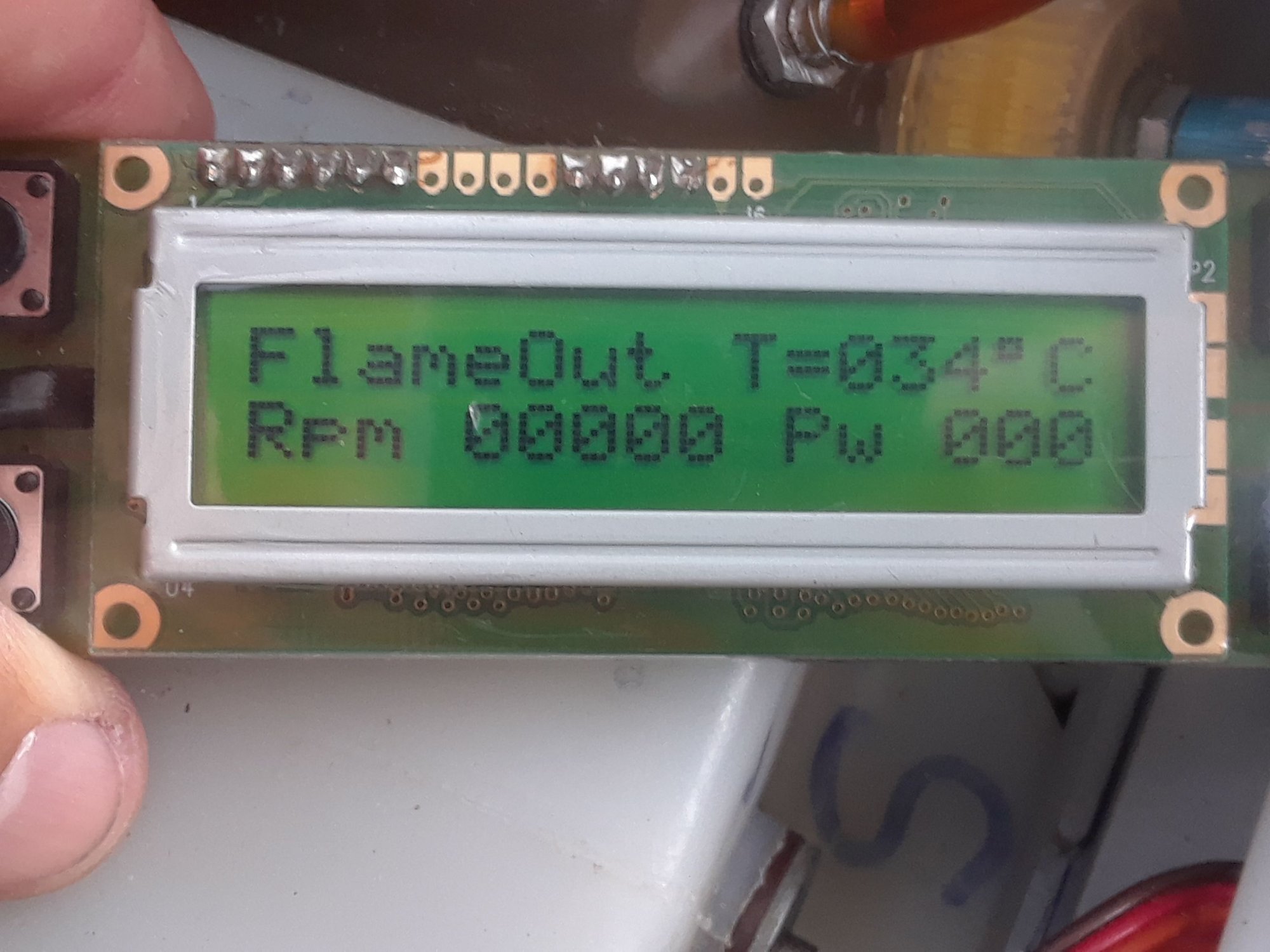

I've been reading the radio manual, ECU manual and from postings on RCU regarding fail safe.
Most of it is clear now, I turn on the radio and airplane and tried to make it to failsafe but it didn't then I run the engine a little higher than idle then turned the radio off, two seconds later the engine quit, here is a picture from the GSU right after that event ( top ) and a picture after turning the airplane off then on.
Thinking about what changed from before the first flame out that happened about a month ago to before that, the only thing that changed was that I had swapped the radio's battery from a 10 years old 3 cell LIPO that was still good but it was starting to show weakness during charges to a 3 cell LIFE, first I didnt like the LIFE voltage displyed of 9.9v, compared to the 3 cell LIPO of 12v right after been charge, this may not have to do anything with the problem but, that has been the only thing that changed, I now have a new fresh 3 feel LIPO back in the radio, .

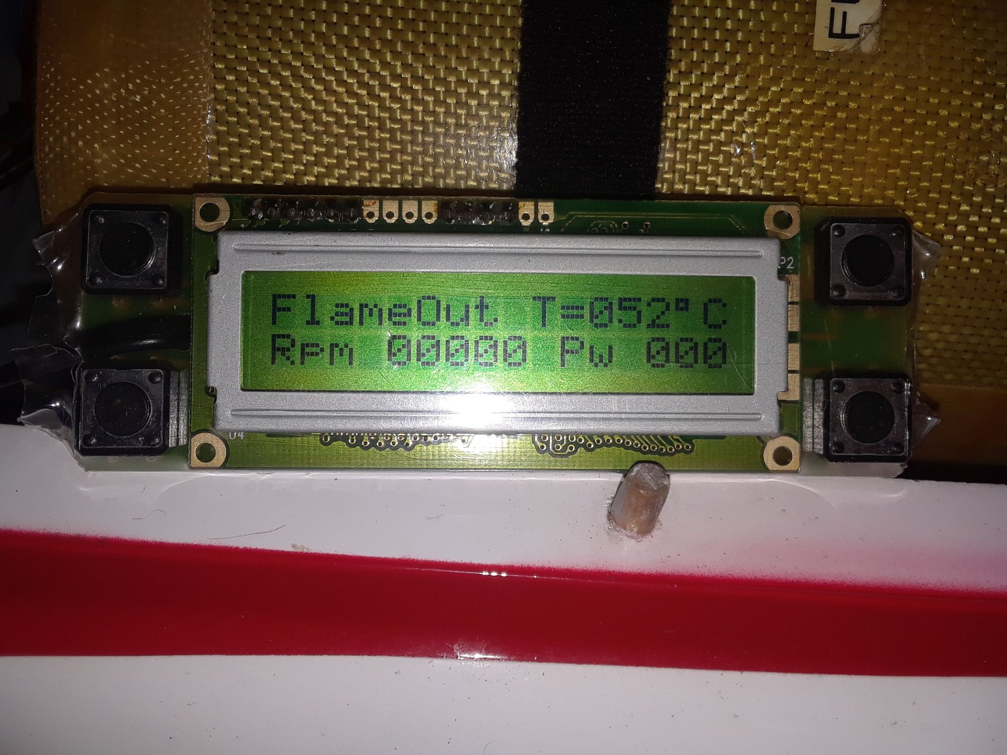

Here is the pic of the GSU after the second flame out when I was testing at the field.

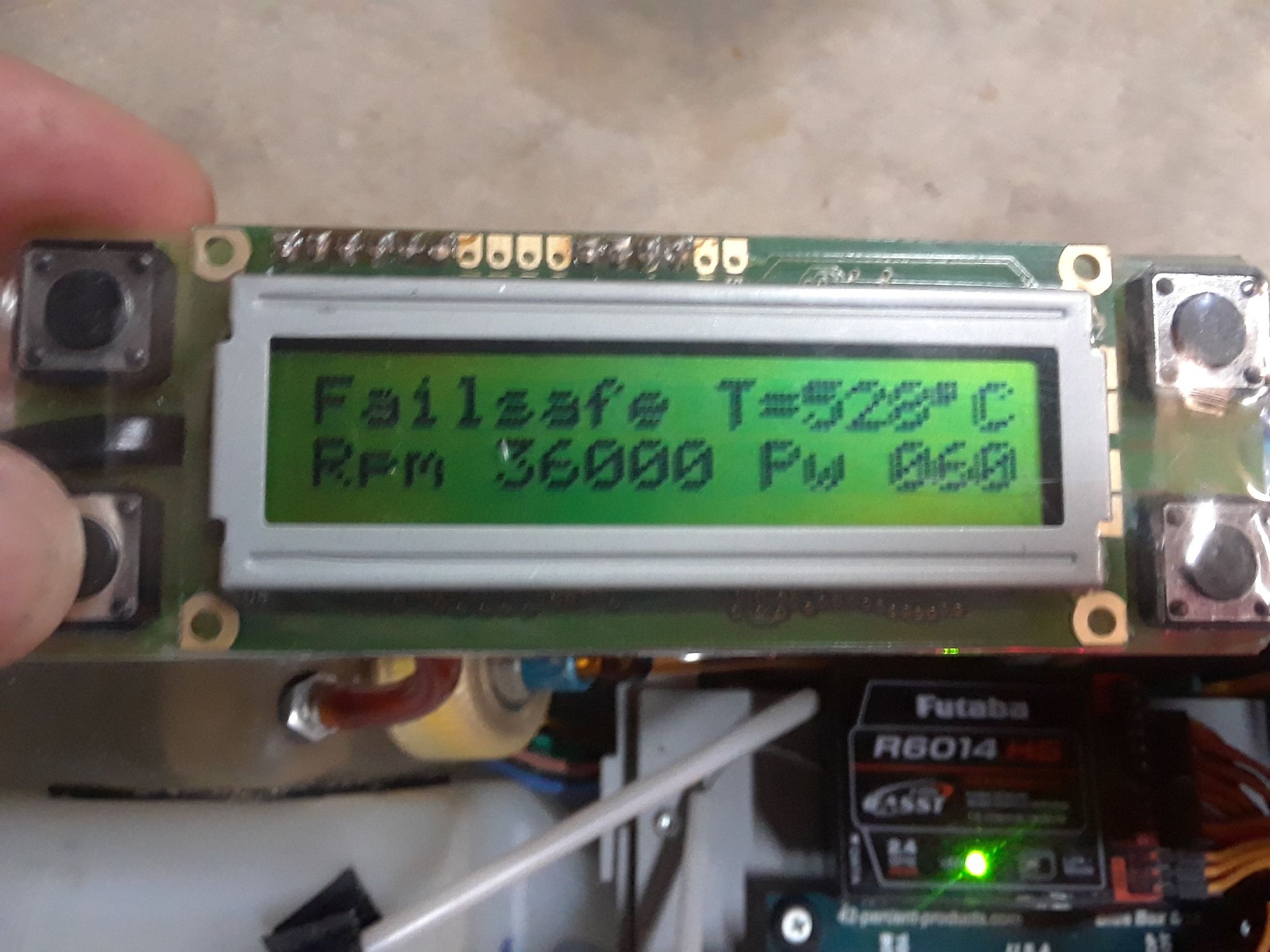

Ok then, my fail safe is now set up at140% and my learn rc is at 100%
Tomorrow I go flying, with the new adjustments if I get a fail safe shutdown I should get a fail safe shutdown massage from the ECU on the GSU as the cause of the shutdown.

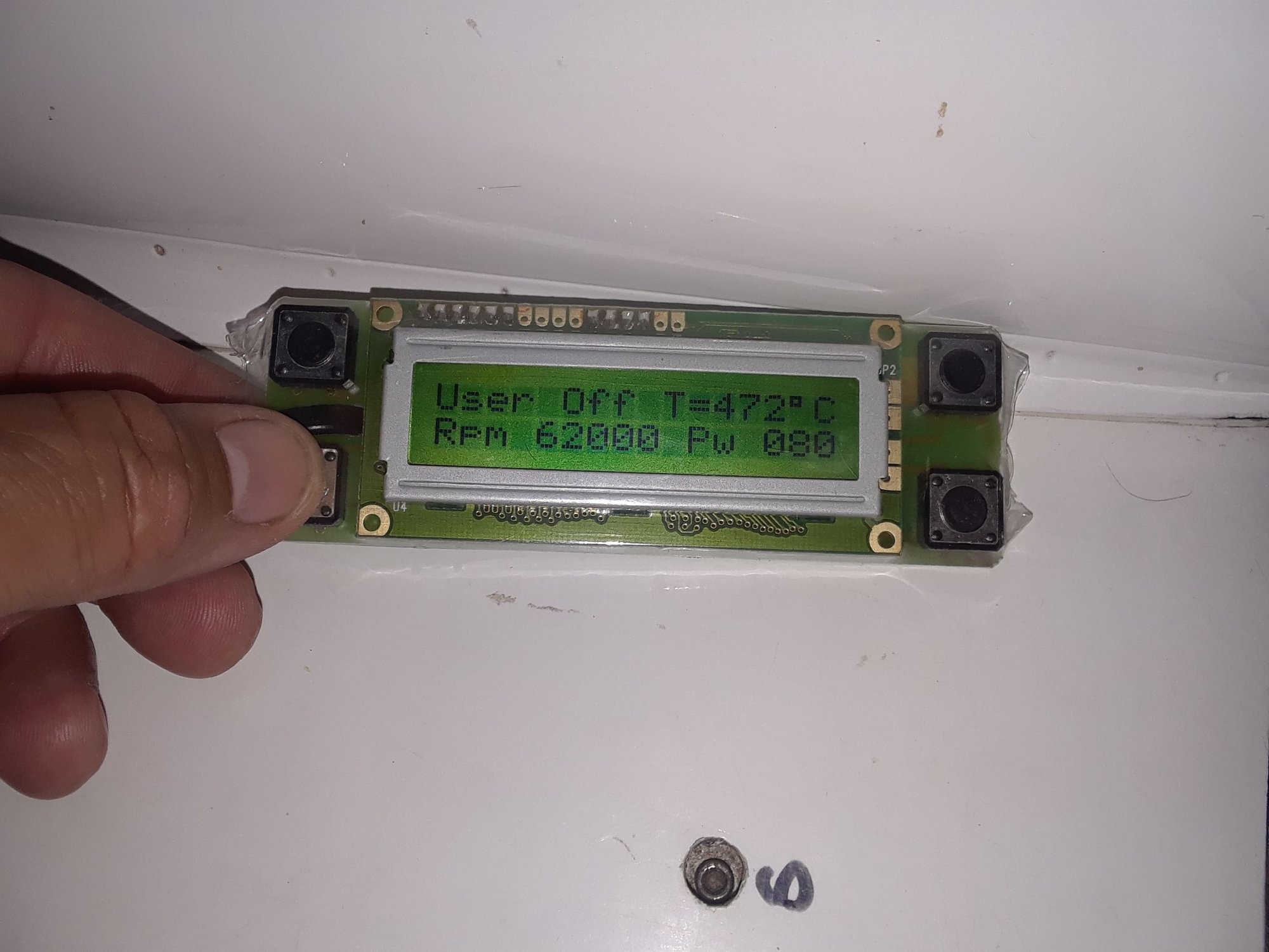

Fail safe is correctly set up now, I'm still chasing the why the engine quit on me twice.
