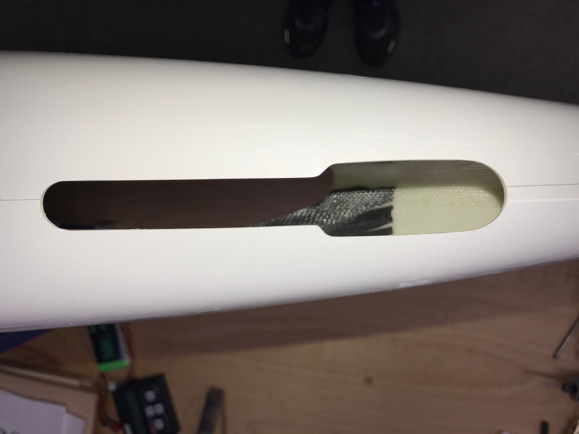

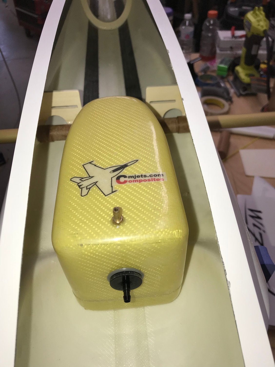

Just completed this very cool little jet from ZN Line.
This was built from the basic kit. Paint was applied by my friend Ted Schoonard. This is the first kit Iíve built from ZN Line and was an absolute pleasure to build. The glass work is some of the nicest Iíve seen.
Wizard S basic kit
Merlin 100
HiEP pipe
CM Jets tank
Jeti REX 12 w/REx R900
Jeti MUI 30
Cortex Pro
Digitech CTU and IAS
Ditex TD0806MD servos (ail,elev,rud,nose whl)
MKS HV747 servos (flaps)
FCT UAT
Electron ER30 gear
Pulse 2s 5000 pack
Danny

Default Build photos

My Feedback
