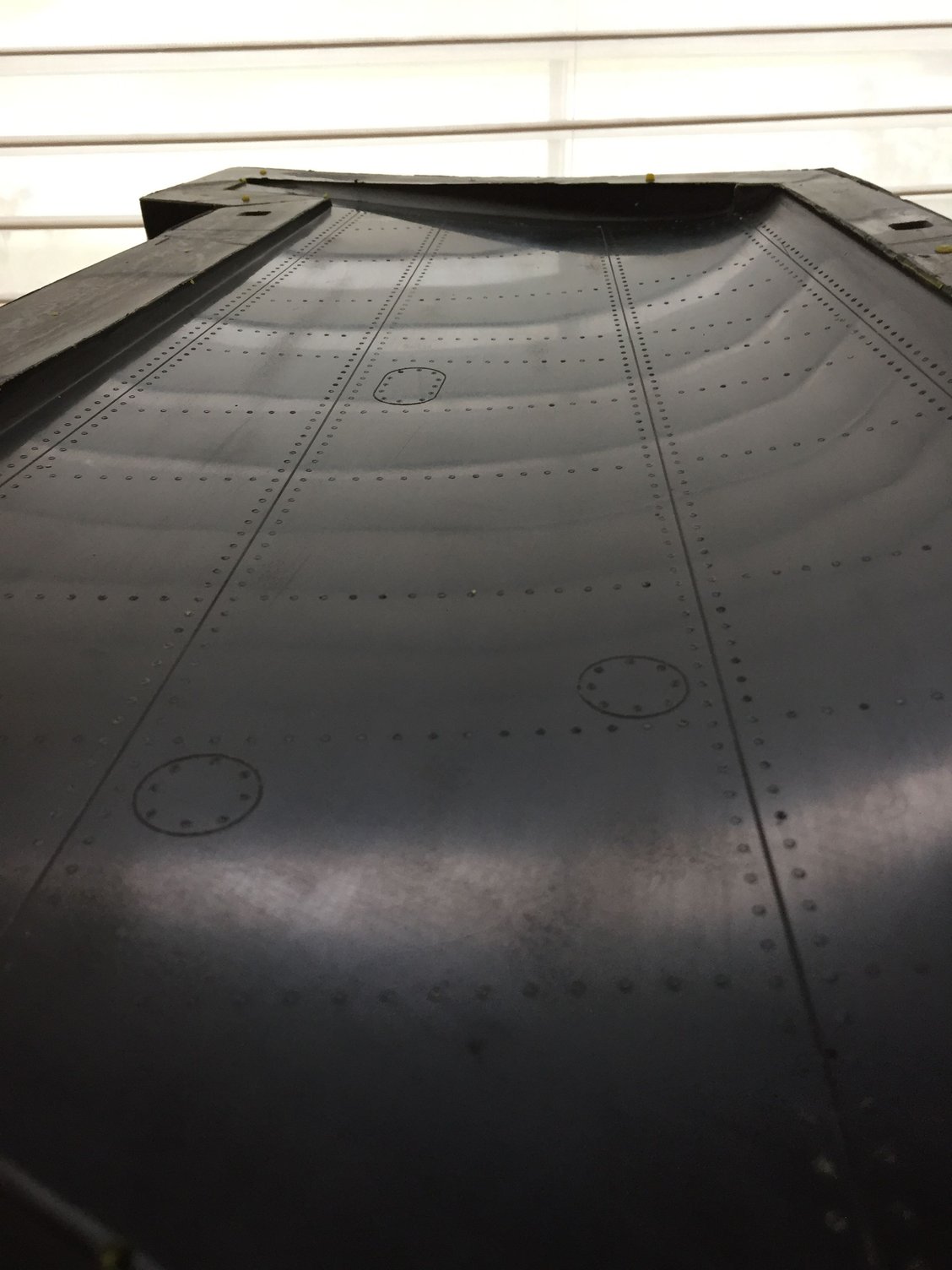

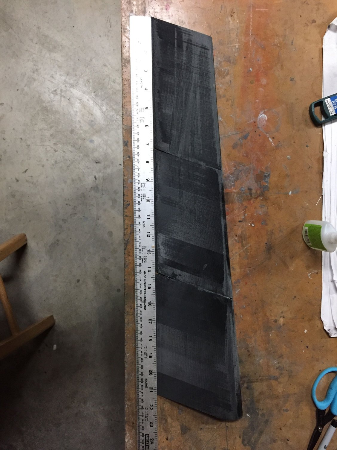

Next up were the wings.
I made the wings separate at the scale wing fold line and worked on the outer wing panels. Like the tailplane these were of a traditional built up sheeted construction.
With the wing designed in CAD, I separated the flaperons and 3D printed them, split into 3 pieces to fit the printer build space.
Once glued together, the flaperons were glassed to give a consistent surface and to reinforce the CA joints before getting a Duratec surface coat.
The full scale has raised rivets on the flaperon, so a few head scratches working out how to reproduce the rivets. I eventually settled on laser cutting a rivet pattern into a thick sheet of self-adhesive stencil paper, applying the stencil to the flaperon surface and then filling the holes with Duratec surface coat. Once dry, the excess primer was sanded off and the stencil paper removed. An instant set of raised rivets. The only downside is that the rivets are raised but flat topped, not domed, but hopefully once painted the difference will be negligible.

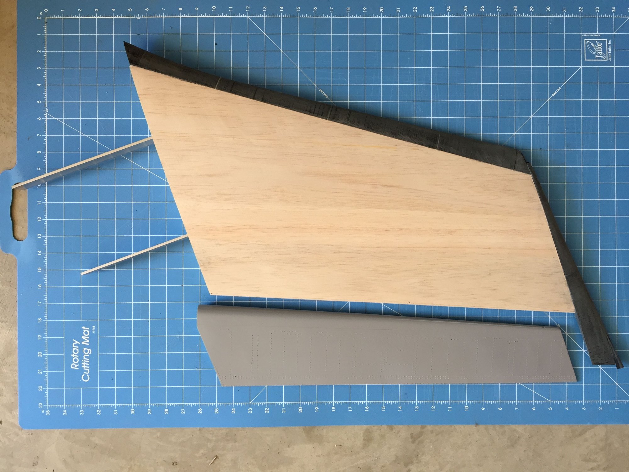

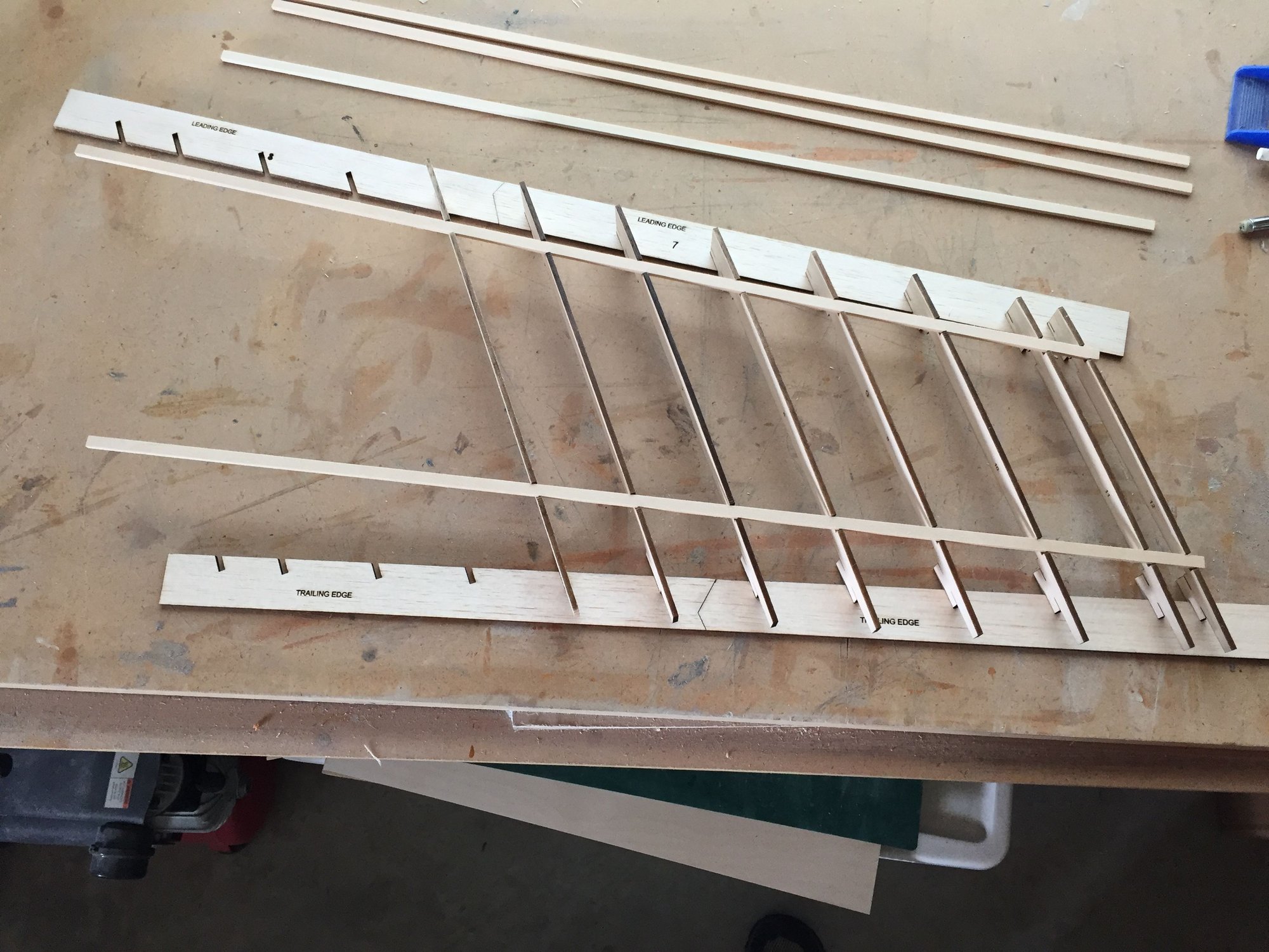

Onto the outer wings. The plug was of a traditional balsa skinned built up construction, but I decided to 3D print the leading edge and wingtip in order to capture the complex curves. The LE was split into 3 parts to fit the printer build volume. I made a cutout in the wingtip for a nav light a with a recessed edge to facilitate bonding in the clear cover.
The wing was designed with a 3deg twist (washout) along the hinge line and individual tabs on the ribs captures the correct rib alignment. I made a building jig to align all of the ribs. It was then an easy matter to glue in the 1/4"x1/8" basswood spars. No internal shear webs were used as this wing doesn't have to take flight loads. The inner ribs were cut from ply in order to be able to hold the wing joiner spars which will be used to provide alignment in the mold and during wing construction.
With the ribs being laser cut, alignment of the wing with the 3D printed leading edge was excellent and no filler was needed.
