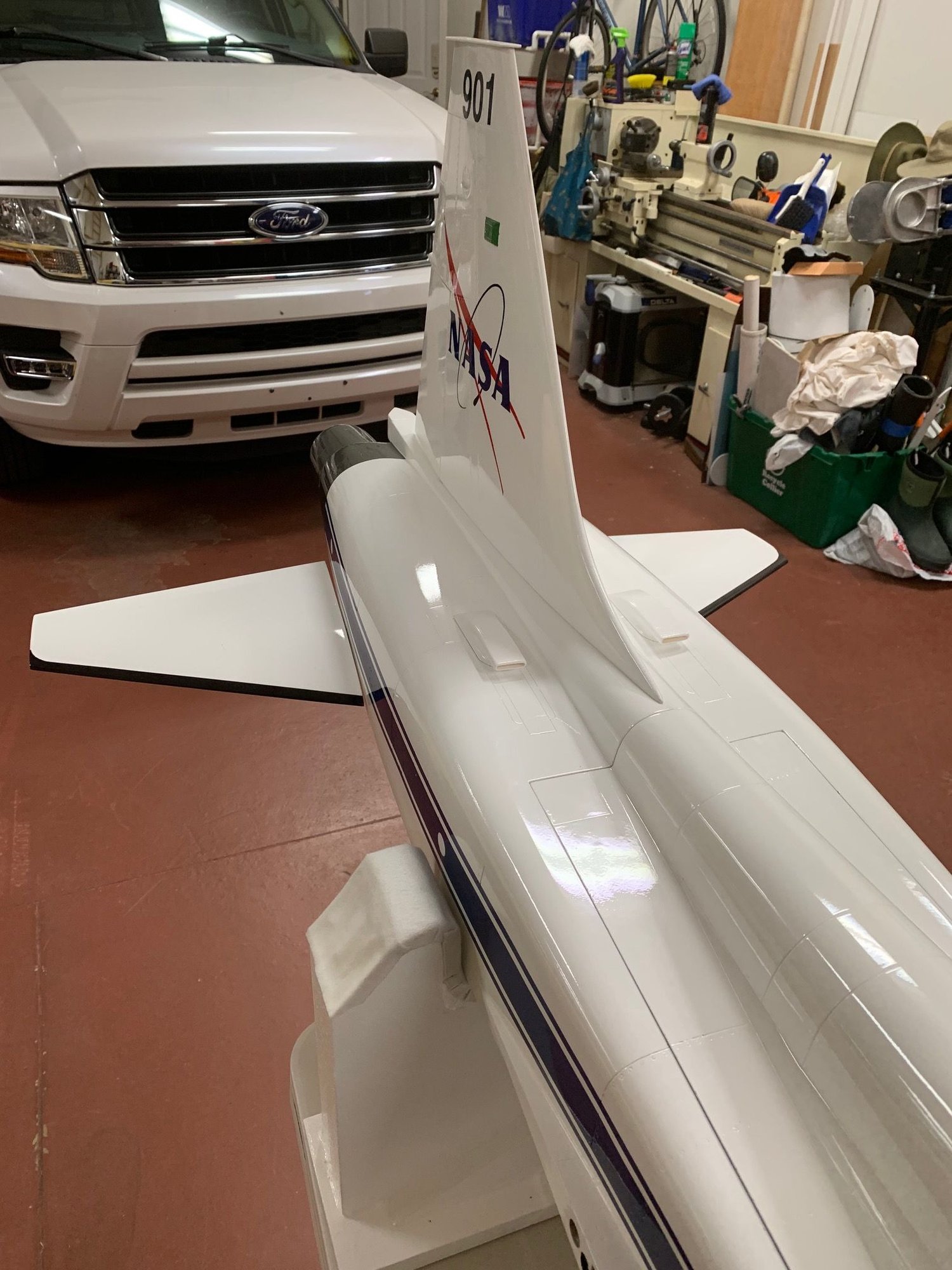

I got the correct paint and sprayed up the scoops. They are now mounted to the plane:
I am planning on a second flight tomorrow.

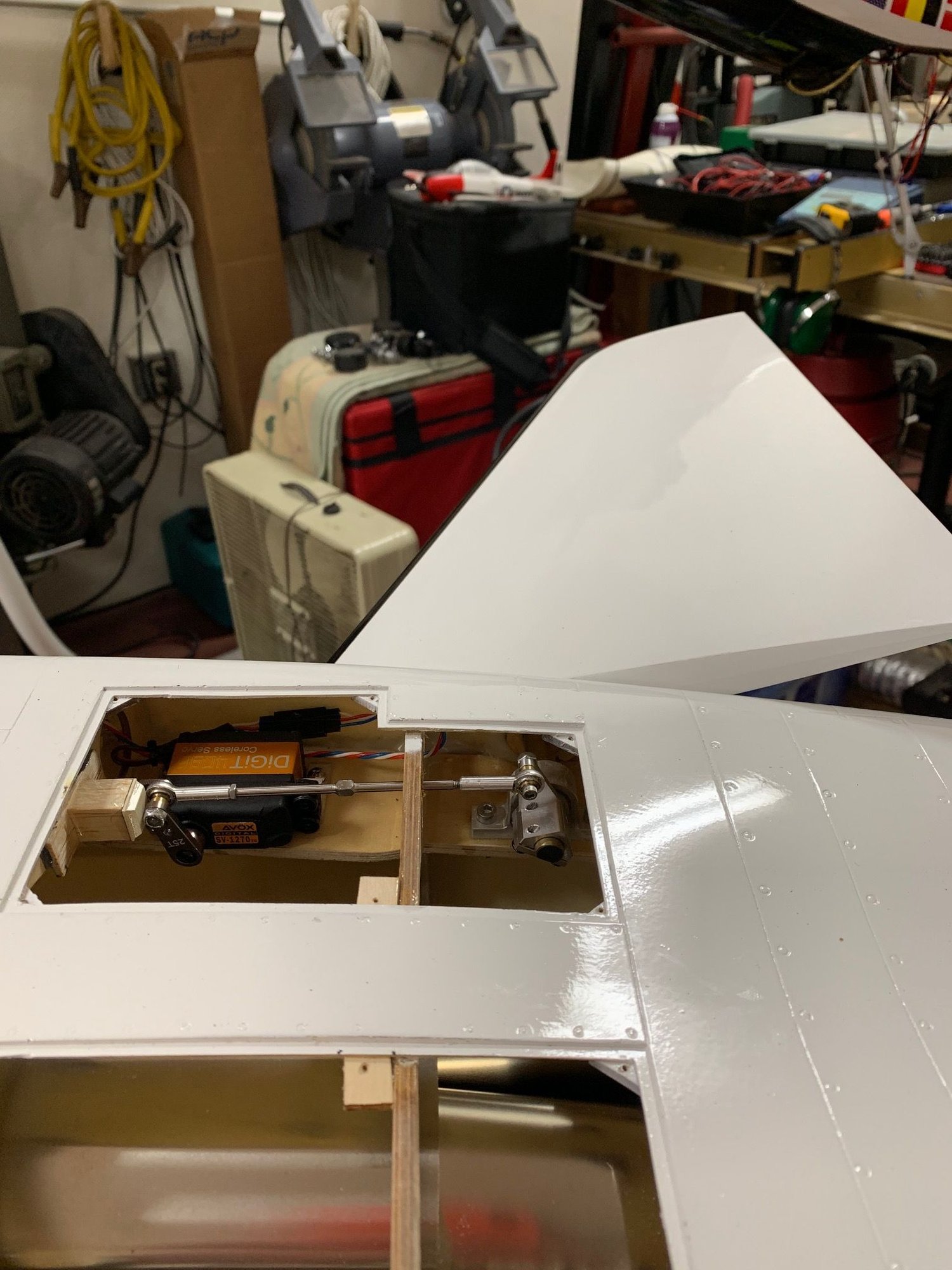

There was a mishap however. After I landed and shut it down there was a gust of wind that blew the horizontals stabs down hard. One got stuck vertically somehow. I could not easily straighten it so I turned the receiver on. There was a grinding noise and still the stab would not move. I had to open it up and free it but the servo was stripped. I do have an extra servo. I am into the repair now. I am planning on adding some blocks to prevent over rotation of the stabilizers from this point further. Take Note - this is a must.

I installed the rubber baby buggy bumpers on the down elevator side. I used sticky rubber feet on square balsa posts. But I also glued them in place around the edges. When the epoxy dries enough I will do the bumpers on the other side. The overall motion is still more than twice the "high rates" setting. When the servos are energized obviously there is no need for these motion limiters.
When there is no power to the servos however the elevators can passively move past 90 degrees and get stuck. This happened with just a gust of wind the other day. Also, when stuck down the elevators almost touch the ground making it hard to wheel the plane back to the benches.

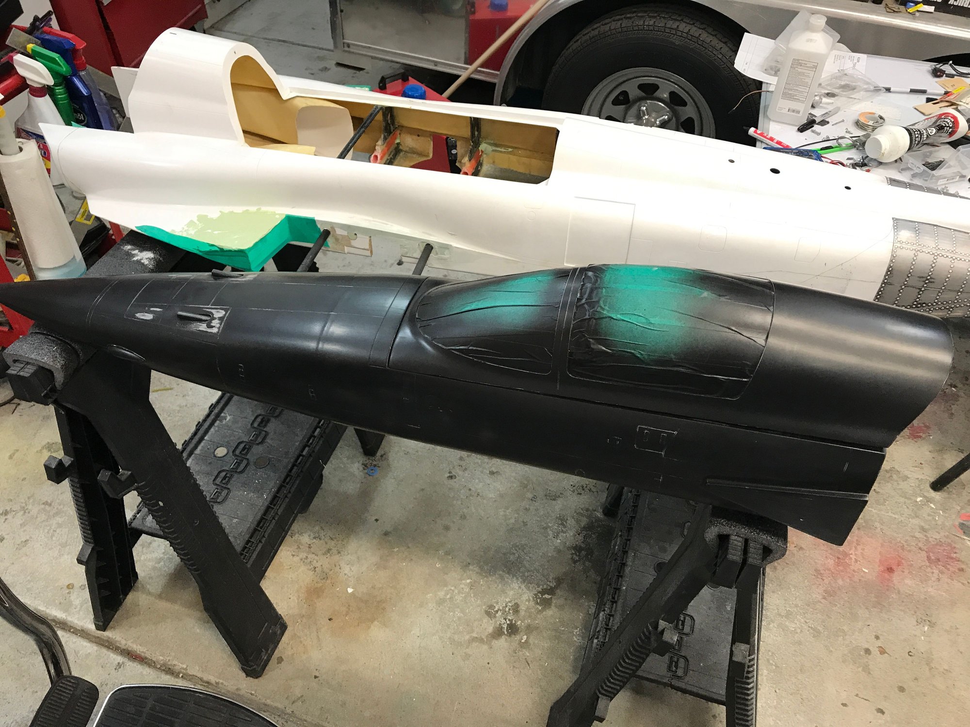

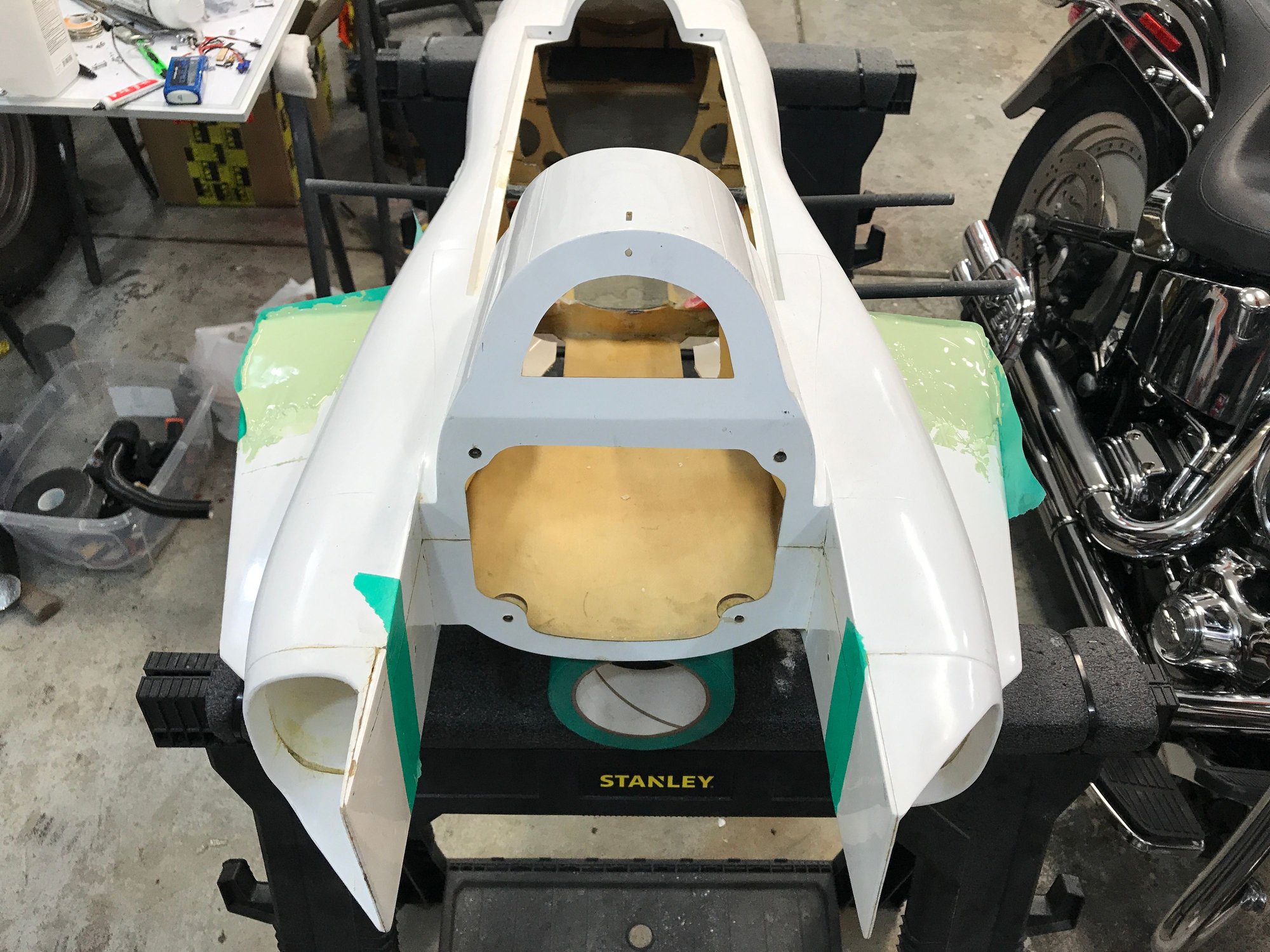

So after some break and finishing up the big f-18 I got back to the f-5 so today just did some bondo to the leading edges right by the fuselage they just dont match up with the wings as they should the wing stocked up in one place about 3/32 so the bondo its a only solution.

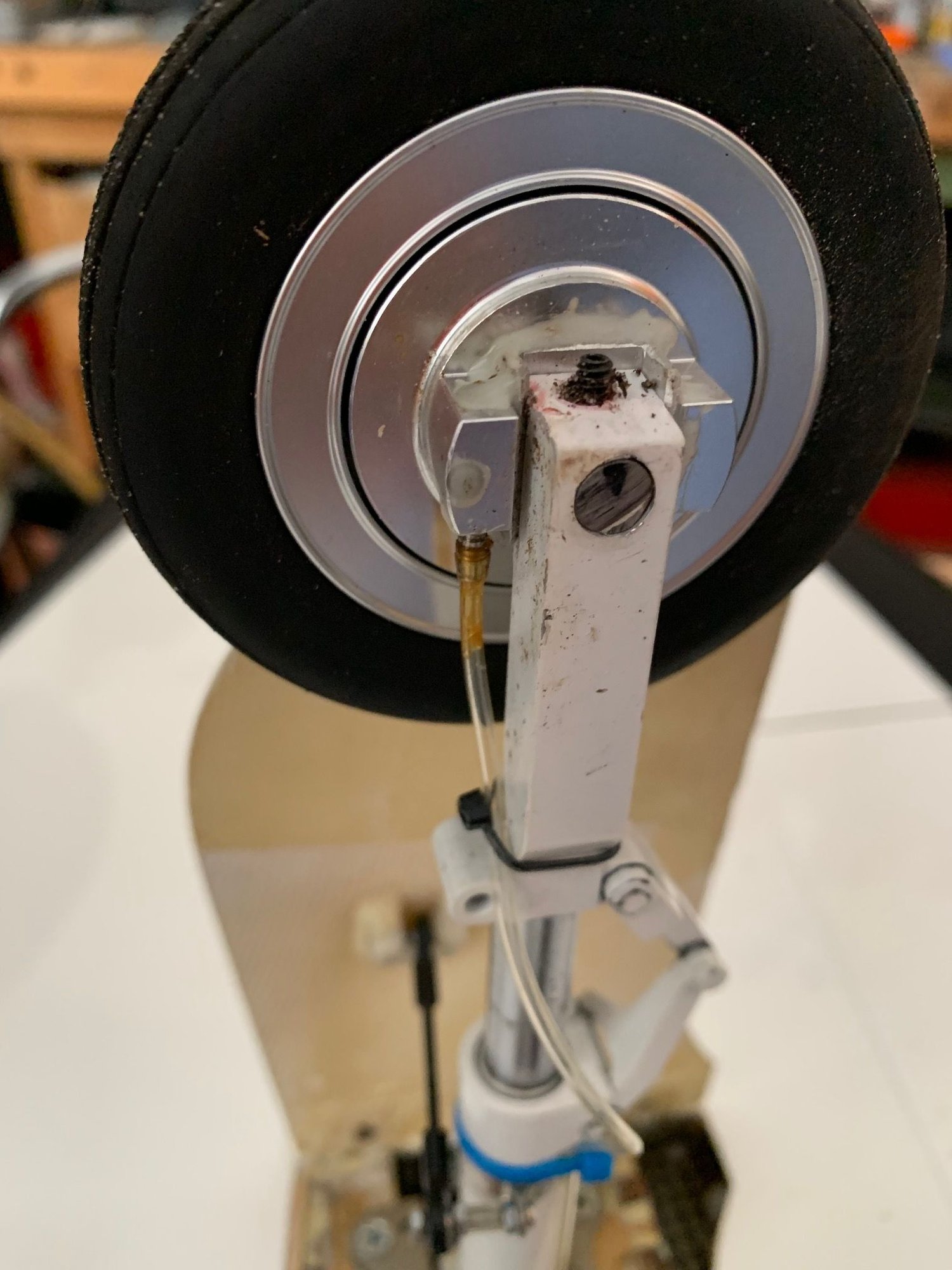

For my T-38 I wanted to make braking stronger and long lasting. I changed to pneumatic Intairco wheels and brake hubs from Dreamworks. I had to add an air tank. It is a medium sized one as it only works the brakes. So far I filled it once, played with it in the shop, flew once and it is still essentially full of air. Also it has sat around for over a month. Obviously it uses about no air and there are no leaks. I had to use a U-aluminum channel inside the hub as the Skymaster struts are narrower than the Intairco slot on the hub. So a little fitting was needed. No big deal but the braking is now what it is supposed to be. This plane does come in, land, a little fast so it is important to have good braking as my field is only 500 feet long. If you are short at all or even long you will have your gear ripped out, its very unforgiving.
I have been busy with a lot of other things so further progress and test flying will be a little scarce for the time being.
