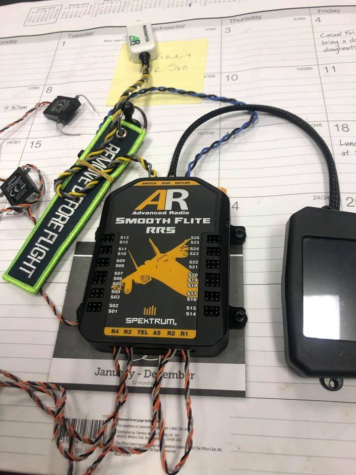

I have the answer to my problems with the channels on this bird. Dirk recommended I look into the Booma RC receivers. I personally have never herd of these receivers. So I checked and WOW they are some very nice units. This receiver will expand my DX18 with servo matching reverse and all that good stuff up to 26 channels. This will let me do what I want to do on the F22. I have a cortex PRO sitting here for the F22 but I am not going to even open the box since this receiver has a gyro built in that takes weight, barometric pressure and accelerometers into account for the gyro gain. Its a very advanced unit and can be assigned to any channel. This will give me gyro steering along with both rudders horizontal stabs ailerons and thrust vectoring nozzles. Flying a 3D jet I have found a gyro on the thrust vectoring on the nozzles to work out very well. This unit also takes into account the MAH of your batteries and gives you amount left. I messed with it some last night and was blown away how easy it was to understand. I just set up a PB on a friends plane I built for him and wanted to commit suicide after I hit a wrong button and deleted the entire program in the setup wizard. This unit is nothing like that and I was easily able to run through the menus' and understand without going through the instruction books. I also have a magnetic switch for this receiver also. We are very happy to announce PacificRCjets is now a distributor for Booma and Drik has a bunch of stuff in stock now. We also have manuals on our site. Every time we are doing a build and see something we like Dirk normally tries to go out and get it. If it makes our builds better it should work for our customers also.
r
Looks like the air valve system is running behind and I might have to install that system after FLjets. This means I will be installing a normal air system with no pump and external fill valves for the time being. Time is running out. Going to be moving very fast on this plane now. She is almost ready for paint.

That’s what I do Gun, when I try something new or find something that’s really nice and helpful to our hobby I try to become a dealer for it. I don’t sell anything that isn’t high quality and useless for that majority.

Gun,
Booma makes great products, I turned a couple fellow pilots onto them.

Hi Guys,
To keep the Data straight on this RRS unit. This unit was built special for us to include the Gyro and 6 channel sequencing and will also be available shortly to all Spectrum users. Normally the RRS unit does not have the Gyro or sequencing built in like the ARXL unit. This unit gave us the capabilities to just plug in the 4 satellites and no need for an actual receiver to be used, but gave us the ARXL functions. The ARXL, multi protocol unit (select your radio protocol) includes the gyro, sequencing etc but will require at least a 8 or 9 channel Spectrum receiver with 2-3 satellites to operate as the receiver will regulate the voltage to the satellite receivers. I am very impressed with Booma RC's products and was very fortunate that Booma let us become a Dealer. The technologies that are being used in Booma products seems to be far superior to other products currently used. Kris mentioned some technical features about the gyro, I just wanted to add it also has automatic gain control so there is no need to set up gain modes as the unit will self adjust based the jets needs at that time. It will adjust for high speed, slow speed, 3D and landing gains. Our shipment of products should be arriving hopefully next week and you can find all the information on our website including many other cool products they offer. Like Kris has mentioned on how easy the unit was to set up, you can find numerous "HOW TO" tutorial videos on youtube as well. Keep the build pictures coming Kris!!
Dirk

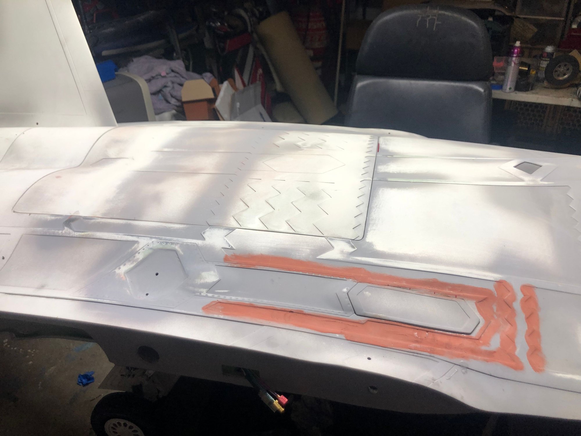

Been too busy to update but itís going together!
I decided for the air system to use an old school servo operated valve for the canopy so when the plane is off it stays open. Rest is electronic valves. Will post pics of it after the weekend.
Also the painting process has begun😭. The F22 is a huge pain in the ass to paint. Probably wonít go over each little step since almost everyone will get an ARF or a PnP.
The edges get painted first.

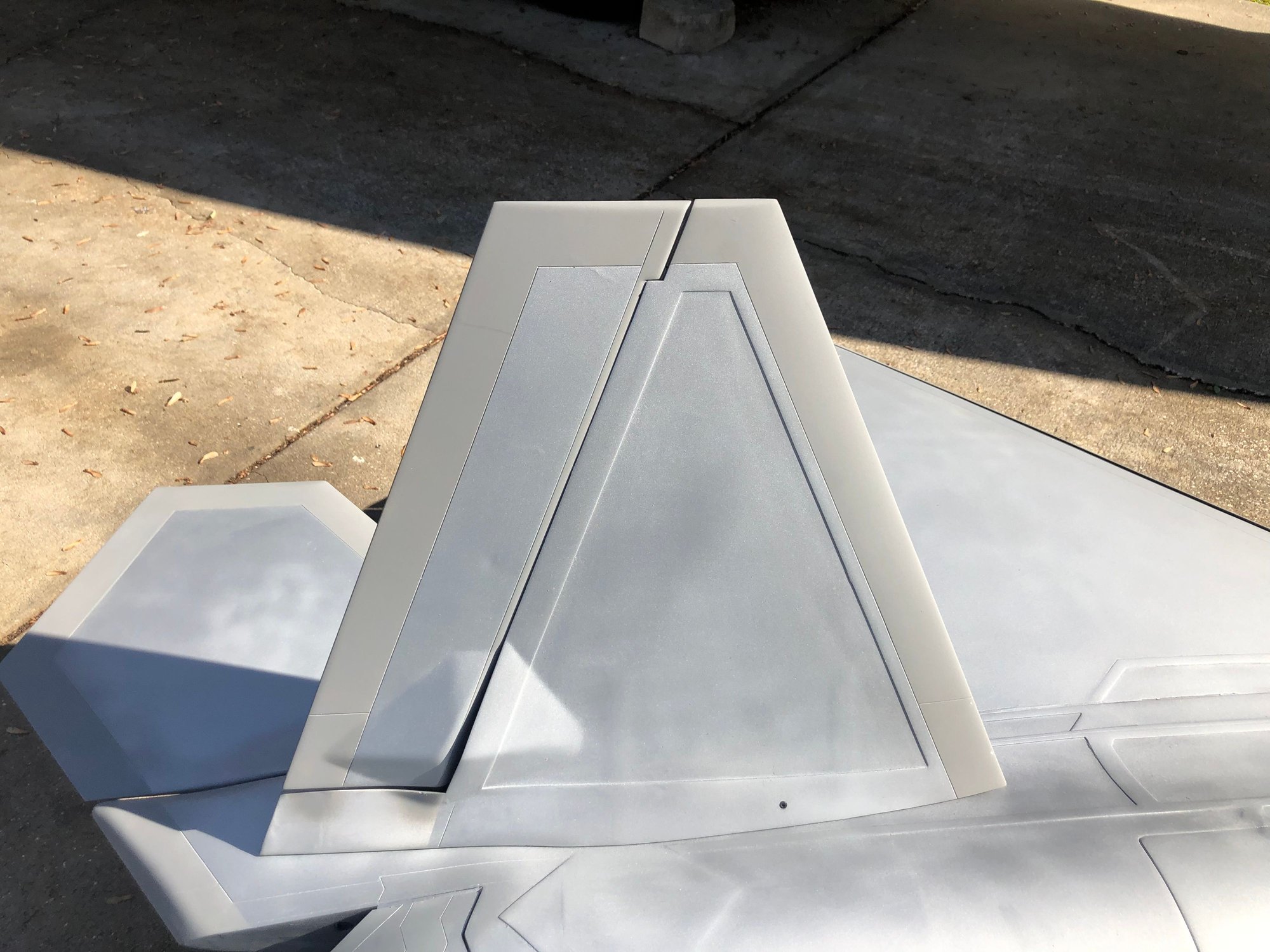

Base coat is on. Radio all programmed. The new receiver is fantastic! Was easy sequencing everything. Stuff is moving pretty fast now.
Got 2 more weeks to go. Still waiting on the markings to show.
