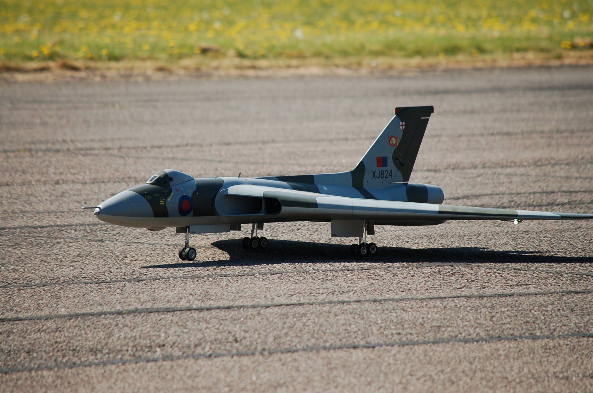

Great weekend with three Core radios being used in Sports jets and scale 18 month Vulcan build.
Dave Wilshere is offline
Reply With Quote

Great to see it is in action. Was that the first flight on that Core for the Vulcan build? If so, that's gutsy !

The Vulcan has flown a couple of times on JR, but yes first ever flights with his new Core radio on 18 months of solid work.
Why not, it’s the best of everything hardware and electronic design.
