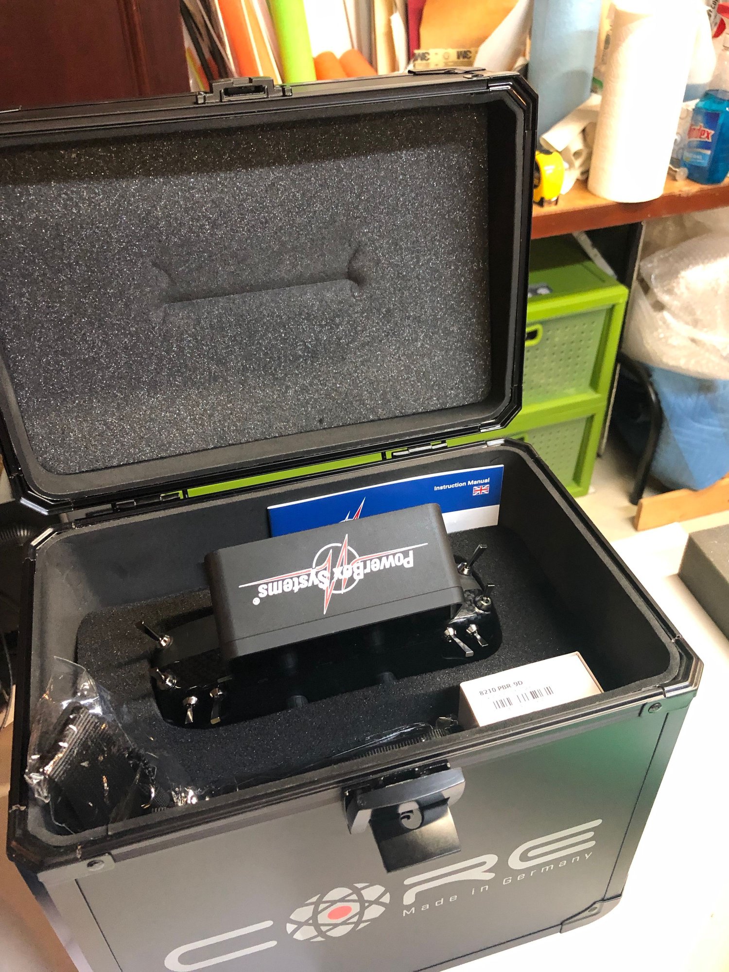

I'll have to mess with it some to see the best way until FMs get here. I just got my Core last night so lots to learn.....
