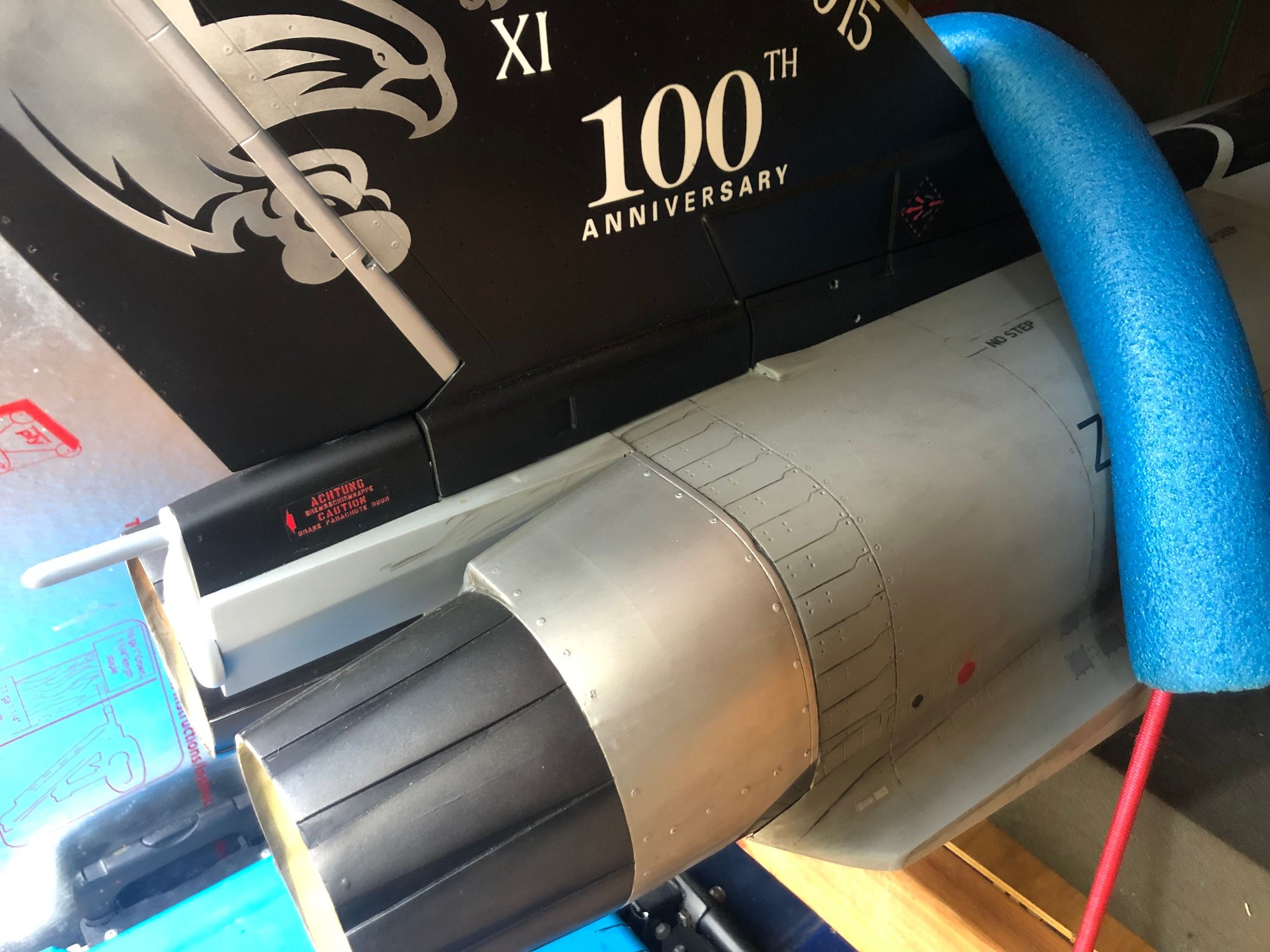

This turbine jet was purchased from Pacific RC Jets in California. Right out of the box the plane looks really great. Nice finish, good looking decals and details such as molded rivets, however the ugly starts showing through when you start the build. The documentation is either wrong or non-existent. This plane is not for pilots without a lot of building experience. The safety of the build is ultimately the responsibility of the owner/pilot.
1. Just when you thought imported instructions couldn't get any worse you find the manufacturer calling for flap throws of 40mm on a delta wing plane. (Delta wings don't use flaps since it's identical to down elevator). If you set up the Euro to these instructions you're going to be in for a big surprise the first time you lower the flaps and the nose heads straight for the dirt. I have heard of some people cross mixing the canards against the inboard flaps, but I wouldn't want to be the first person to try this. All canards I've flown are difficult to stall and as such slow down nicely for landing.
2. You receive a $180 LED controller that tells you in the instructions that the afterburner function doesn't work. Also be prepared to use a hefty sized 2s lipo for the lights since they leave out the part about the landing gear light function not working. The included controller does not allow you to turn off the high intensity (high current LEDs) when the gear are retracted. You can also expect no help from Pacific RC since your emails pointing out these problems will be ignored by the seller who's attitude is that if you ignore them long enough they'll just go away.
3. You also receive LED wire extensions that have the red and black leads reversed! I burned out two $5 7 gram servos before I removed the extension cable and saw the problems. The lesson learned was NEVER take anything for granted!
4. Expect about a 3mm gap under the vertical stab because it won't fit correctly without major modification. I think it's still strong enough and I will fill this in with spackling after the maiden. The vertical stab has a long internal tube that slides down and forward. In my case the tube was either placed at the wrong angle in the mold or the mold is simply bad.
5. Also be ready to dig out and fix the non-working LEDs. My rudder LED was received broken when they jammed it into the vertical stab and then glued it in with some type of 6 ton epoxy compound! After several hours I dug it out and resoldered the lead back onto the wire.
6. The rudder is under designed. There is about a 4" moment from the control arm to the first small nylon hinge. It's a long rudder with only 3 nylon hinges. The last thing I want to see is the rudder come off during a knife edge. If you use a two arm control it will probably hold up. However unlike what was pictured in the manual mine came with a single arm which was a recipe for disaster. I insisted on using the 2 arm control which I received about 2 months later. I also added a piece of plywood to relieve the stress from the hinge.
7, You receive a ton of hardware with the kit. I had an assortment of about 50 screws left over after the build. Only problem is that 80% of the hardware is either the wrong size or spares. For example: If you use the shortest screws provided for the servo hold downs you're going to push straight up through the top of the wing. I ended up having to order M3 x 6MM Socket Head Cap Screws in order to keep them from pushing through the top. I guess M3 x 6mm cap screws weren't on sale at Banggood when my kit was thrown together! I always get a little nervous when I have a bunch of extra parts left over! :-)
8. I always do a dry fit before bringing out the Hysol. The rear elevon surfaces come with pre-glued hinges. I'm not exactly sure but one of the hinges is either glued in at an angle or the pre-drilled hole in the wing is off center. This causes the lip of the surface to catch on the top wing sheeting and creates a really neat wing thud every time it catches. I've tried using sand paper, but with no results. I guess it will either wear itself in or delaminate the top wing sheeting.
9. I've saved the scariest part for last! I purchased the Y tube pipe in order to keep a scale look. There is a metal doubler folded over the Y junction inside the tube which is spot welded. Another owner warned me to trash the included thrust tube and replace it with another $300 tube made by Tam Jets since his doubler came off after a couple of flights. My concern is that if there is a gap under the metal doubler the exhaust gas is going straight into the rear of the fiberglass fuse if the doubler decides to come off. I discussed this concern with Pacific RC and was told that a lot of people were trashing the included Y pipe and buying the Tam Jets version. I was also told that thin metal is folded under the doubler so that if the metal doubler comes loose there shouldn't be an exhaust leak until the metal burns away. Guess I'll find out when I see the rear of the jet go up in flames mid flight? FYI Dirk (Part owner of Pacific RC Jets) recently had his built using two K70's.
The bottom line is that the owner/pilot is ultimately responsible for building a sound and safe plane. I hope that these comments will be useful for future owners of the T-One Eurofighter!​​​​​​​

Do your self a favor and never build another jet unless itís a plug and play if you are having problems with the T-1 euro... itís a very easy plane to build.
I do do agree the instructions are lacking but itís not for a first time builder. I did request they remove the flaps setting a while back but I guess that slipped through the cracks.
For the tail I have no clue what you have going on... I built one and have seen 3 and all of them have the tail right.
You are one bitter guy. Btw this is one of the best flying scale planes I have ever flown! Lots of fun. I recommend you stop crying and go fly.
One more thing.... if your having problems with T-1 you are going to have a very hard time with some of the others lol.
