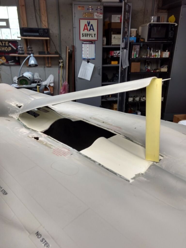

Here more pictures on the hatch with latch installed.

Well Houston we have a issue, the Y pipe I bought is not going to work, now that I cut a hatch at the top, now I need a shorter Y pipe, now I was going to put turbine upside down, the pipe will work, so now I need to order a custom made Y pipe, well it's only money.

Ok, pickup some plywood and order some Hysol glue, everybody rave over this glue, so I will give a try, on building the turbine, take a few pictures for the measurement of the Y-pipe, 1moparman1 makes custom Y pipes, are may have one already made you, I will sell my FeiBao Y pipe, here some pics.

Ok, guys and girls, I'm undecided on putting the turbine upside down from the bottom or putting it right side up from the top, the cost is $600.00 if I put and mount it from the top, the cost of a custom Y pipe, or use my $300.00 feibao that fit perfect from the bottom, the 80oz tank, that I was going to use, would need to be mounted somewhere else, any help would be appreciated on which way to go. ??

Further forward means easier to balance. The more aggressive the angles in the pipe are the less efficient the pipe is, where is easier access for the engine? I'd it's propane start keep in mind that the closer to the top the glow plug is the easier the starts.

Ok, I have a half of a chance of getting a bifurcated pipe made, I had to cut the last former out in the center, which would allow for a straighter V of the pipe.
