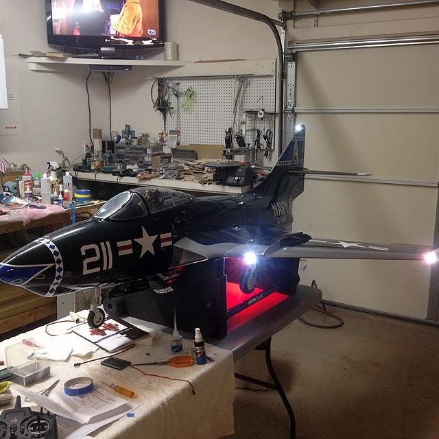

Anyone own these? When I got mine the foam cut outs were bent and not straight (I assume due to heat) and I have been doing my best to use them but they are real soft. Not sure if the Texas heat isn’t helping them much! LOL
Has anyone had issues with these? I love the cradle, just may need to firm these guys up some....

mine did the same thing when my cougar is on it.
take couple of 3/8" dowel rods put 2 in vertically on each end.

Hey guys I have the fix, works excellent and cost about $12.00 in parts you get at home depot. Two sheets of MDF 2x2x1/4" thick. My buddy Addison just took some pictures of it and will post them shortly. Not only will it hold your model solid but you will be able to strap the rack down in your trailer.

Here are a few pics of Kellys foam cradle modification....works great....I am going to do it to all of my cradles as well.

Thanks for the mod pics! Did yours go soft as well? I really like the fix. Looks great! Just gotta find me a band saw to make those clean cuts! Thanks for sharing!!!

Like most everyone it just had to much flex, now its zero. The slots cut in the sides allows you to run straps to hold it secure in your hauler. It was easy and took about an hour to make.
