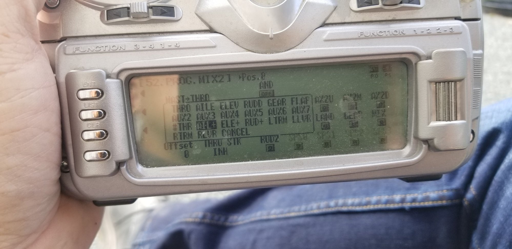

Hi all, I have been using JR 12X for over 10 years but now I am setting up a simple plane and have gotten stuck. I have Aux 2 as slave to Aileron and Aux 3 as suave to the elevator. Everything works except when I trim and or go to flap, only the Aileron and elevator side works and the aux channels don't take the adjustment or don't give down elevator when flap Is deployed. I have checked the manual for hours and still can't figure out why this one is giving me a hard time. I would appreciate your help.

Without seeing all of your screens it is hard to tell what is wrong.
I had this happen once and the only way I could fix it was to start over.
I always do a reset the model first before I start a new one.
I used aileron to aux 2 and elevator to aux 4. My trims worked properly then.
You might give this a try.

When you go into your programmable mixes and select the first channel (the master) you have to use ail+ mixed to aux2 and elev+ mixed to aux3. If you just use ail and elev you will only have trim on the master channel.

See the highlighted channel ail+

Ummm.... This is JR programming funkyness.....
You have to go into the System menu and disable/INH all the channels above #5.Then go into setup and let the radio decide which of the higher channels it's going to assign to the other aileron and other elevator. Then the flap system again using what the radio wants to set up for channels.That way, the trims will follow and the other functions like dropping a bit of elevator with flap deployment will also work but you HAVE to use the three position flap switch or it will not work.

That's sounds like a lot of unnecessary effort. I've never had to program my 12x like that. Not saying it doesn't work but as I said above, as long as you use ail+ elev+ or rudd+ and mix to whatever aux the trims work. I always make sure to inhibit the switches or knobs for those aux channels just so I dont bump them by accident.

what Jeremy said with + solved the trim issue. But one side of elevator still is not dropping with flap. I am sure there is something I have to do to get that activated. That is why I m after.

Why on earth would you be using a program mix for something the JR radio does automatically! Futaba guy is funny as the most illogical complicated pointless programming thing ever!
From fresh memory go to device select in the system menu and inhibit Aux 2 and Aux 3 so the switch and lever does not work. Next to device select is the wing type page, mate ail to Aux 2 and elevator to Aux 3 and it then does everything for you automatically. In the Flap system you can do the elevator compensation, slow flap and elevator down etc etc. Nothing like three pages-menus Futaba would need!

Dave,
just recently setting up a friend's jet we tried that. The radio would only allow mating either ailerons or elevator to an aux channel. As soon as one was mated you could no longer select another. That sounds confusing....
not sure what we were doing wrong, that is why we used the p mix with the ail+ and ele+

Thank you Dave! I did what Dave advised and the problem is solved. I actually had the switches inhibited already but the second part did the work. Thanks again!

Just a comment to expand on Dave’s post about the 12X: To mate an auxiliary channel in the Wing Type menu, the auxiliary channel’s [OUT] setting in the Device Select menu must first be set to INH. The default [OUT] setting for the auxiliary channels is ACT. When a channel’s output is ACT, it is not available for mating but is being used for something else as shown in the Device Select menu. This has been a point of confusion starting with the XP9303 and continuing through the 12X.
