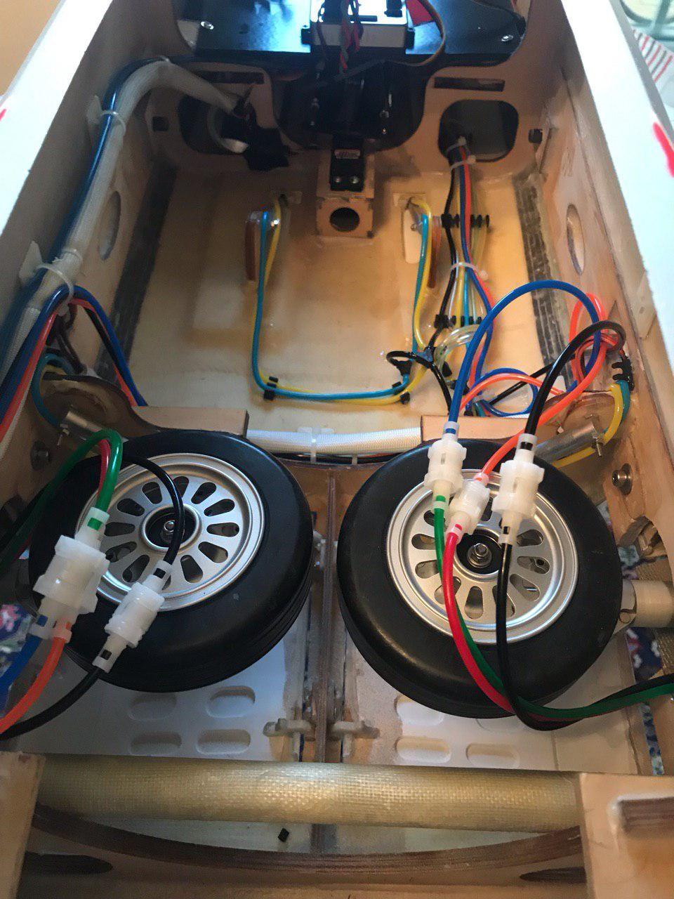

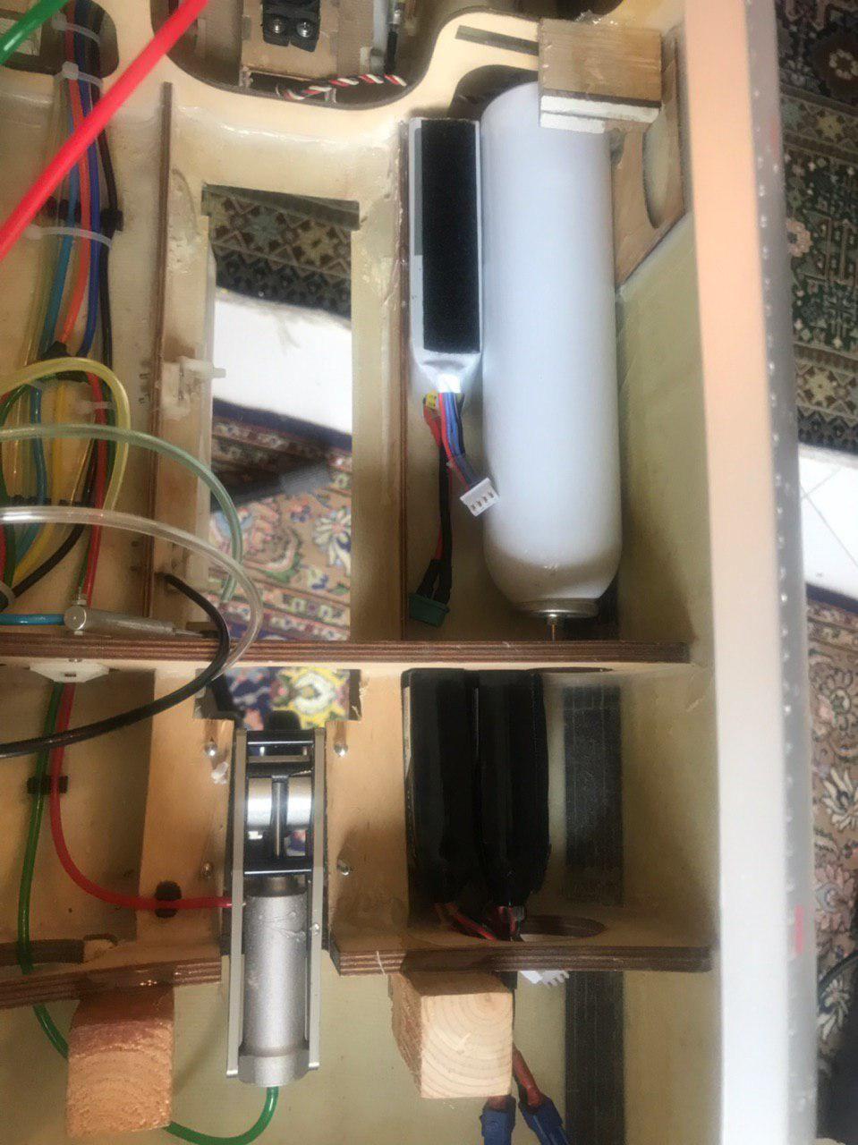

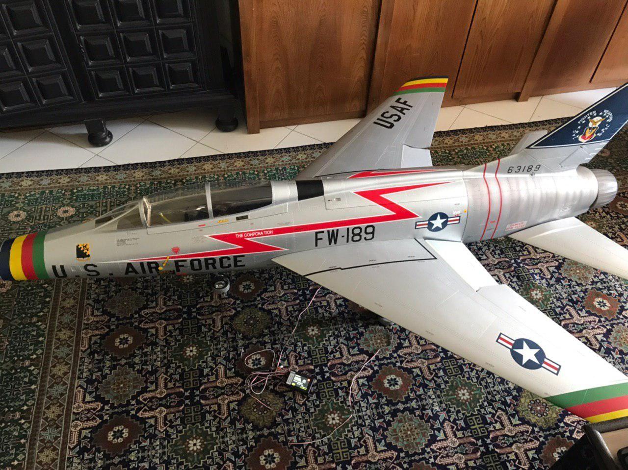

Hi,
just got this beautiful Jet , and i'm going to install KingTech K-160 Turbine on it,
i decided to not install the intakes inside of it , please let me know if you have suggestion or any other idea about it ( specially about the CG );
attaching some photo from start to end and hopefully video of first flight of it,
will it fly like this?!?! LOL
looks fine!
lets weigh it with all equipment!

still working on it ....
dry weight is about 13.2 Kg

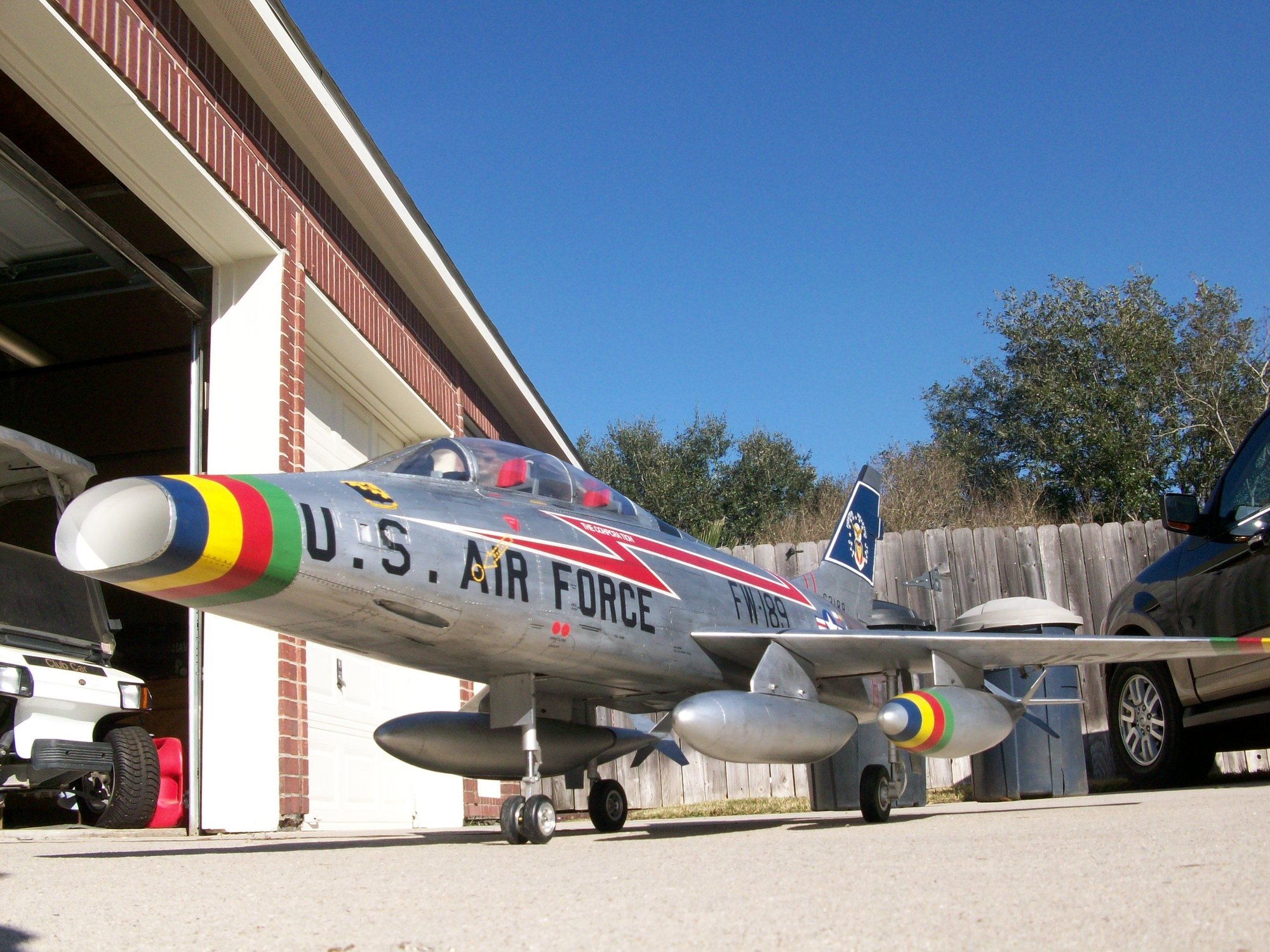

The 160 is overkill and just adding weight. I flew mine on K120 with tanks and missiles and it flew awesome and plenty fast with easy landings. I would rethink the 160???

Default F100
Here is my skymaster F100

Sorry, I used 345 for my cg which was perfect and recommended control throws are good

Originally Posted by ravill View Post
Gotta love huns!!
HI,
its gorgeous
do u have any photo from setup and inside?
Hi,
thank you,
our RC Field elevation here is about 3800 feet and always we lost about 10% of thrust ,
CG is about 330 -360 from leading edge , i'm going set with 345 , do you have any suggestion?

Originally Posted by Abedinpour View Post
HI,
its gorgeous
My F-100 is a bvm. But good luck!!

HI
the maiden flight has done , first flight was very scary because it was nose heavy and in banks i almost lost control ... but i was lucky,
after fix the CG , it flies very nicely and with BF140 i could go full power , half power is more than enough , with half power it flies really fast,
in 4th fly , landing gear failed and i had to do belly landing on dirt , i was lucky only damage was Exhaust , here the link for video of last flight in my instagram :
can i go faster or not? please let me know what do you think
What CG did you use for first flight. My recommended 345 was awesome. Did you use the 330 manual as starting point? If so I understand the nose heavy feel
HI
i use 345 for CG in first flight but i didnt feel right i changed to 360 and slightly tail heavy and its ok now ,
this is link of Friday Belly Landing with almost no damage !!
