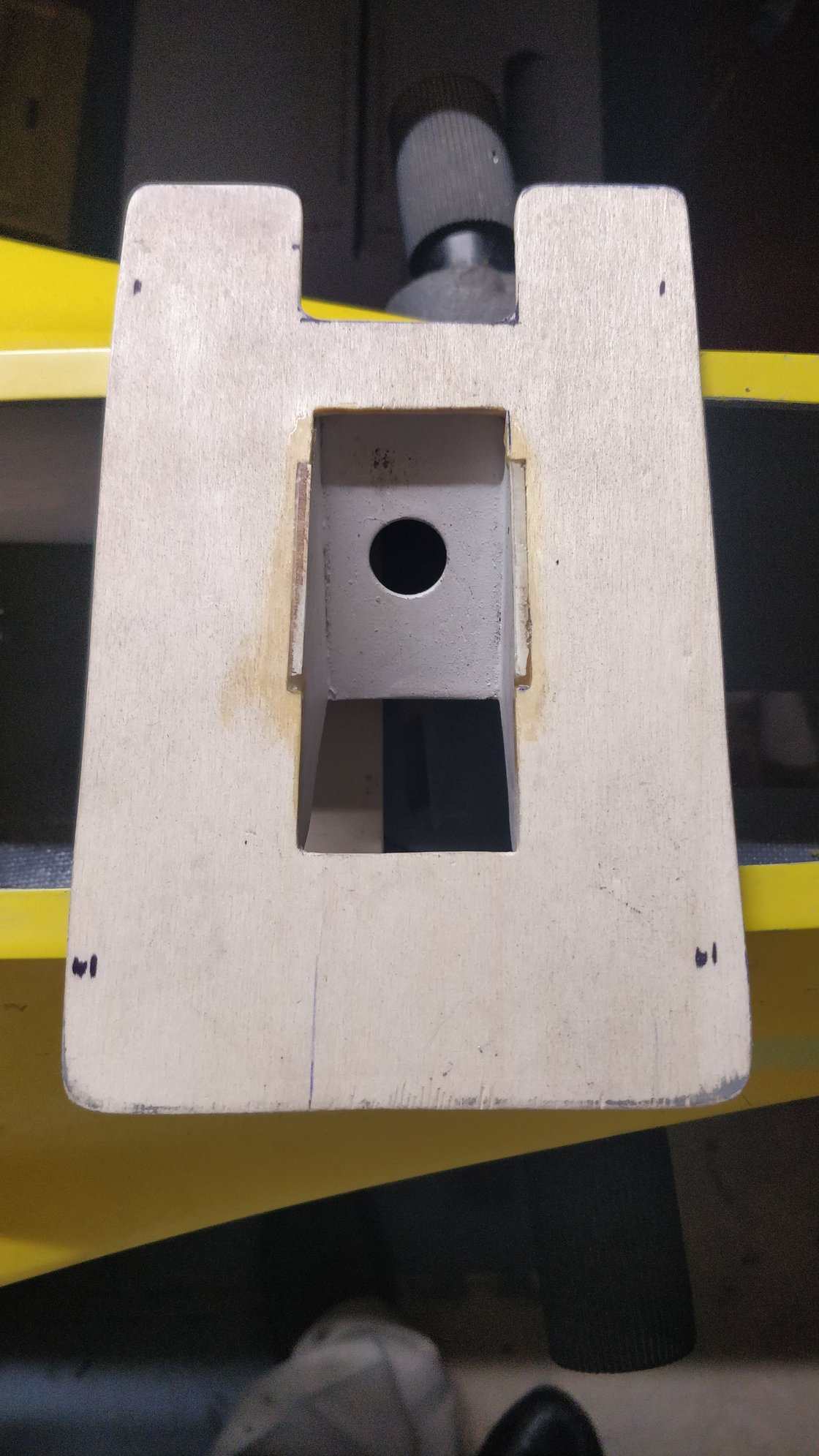

- The servo retract backwards... Towards the engine. Using a mini servo to reduce the weight Vs the standard servo.
- The air tank and jettronic valves plus brake module plus brake battery will be mounted instead of the stock nosewheel servo.

Yes, all retracts are replaced with robart!
Nose strut is same as main, and will drop in two wheels.
That picture was for measuring the servo plate for retractable nose wheel steering servo.
After all this work, I won't dunk it with crappy retracts. They should be here from Robart next Friday. FedEx

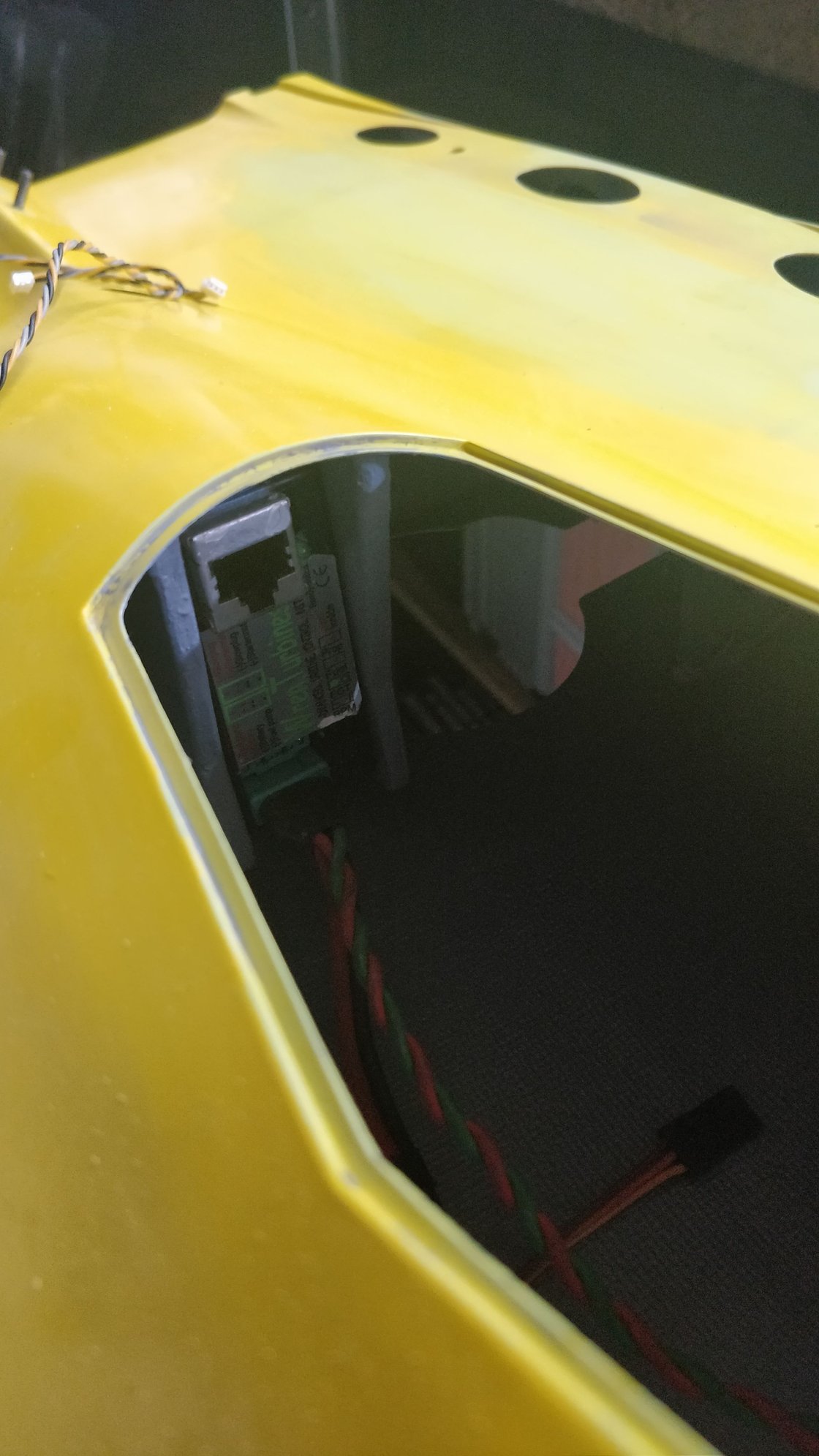

Fadec box fitted. Will grab a few pictures later. The 'phone connector' for the gsu is easily accessible from the speed brake hatch.
Now, like the hotspots, am reinforcing the flex plates with a thin layer of fiberglass. To give them an even spread of force and better withstanding to landing stresses. Will do it on the blind nut side.
Will post pictures soon.
