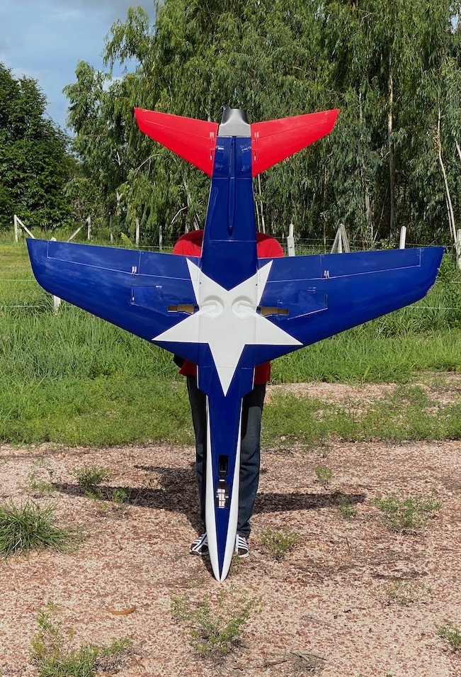

Love this scheme Dave. Looking forward to seeing it all bolted together. What does the wing underside look like ?
If it's stock it looks like this.
https://carf-models.com/en/products/uf-evo
