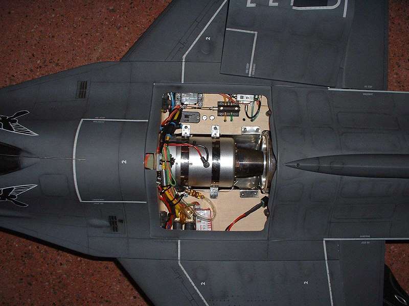

Hi Nic how are you.... we use the little JF-50 Bee it weighs in @ 1.4 lbs and with a LI-POLY ecu pack totall install weight is just a few onces over 2 lbs, it puts out 14 lbs so its 10-1 in thrust PAUL AJUSA
By The way Dave Ribbe flew are combo @ Super man and was very impressed,I agree he knows the BVM F-16 like the Back of his Hand...

Having just tested a JetCat P60 I feel this would be the perfect engine for the F16, powerful yet very compact and fuel efficient. similarly a PST 600r (R version) or the forthcoming Wren Supersport would be excellent choices. A year or two ago I purchased the BVM turbine conversion kit for the F16 and completed its installation. It was going to be an RCJI feature, shame it had to be dropped because the F16s I have seen flying perform extremely well.
