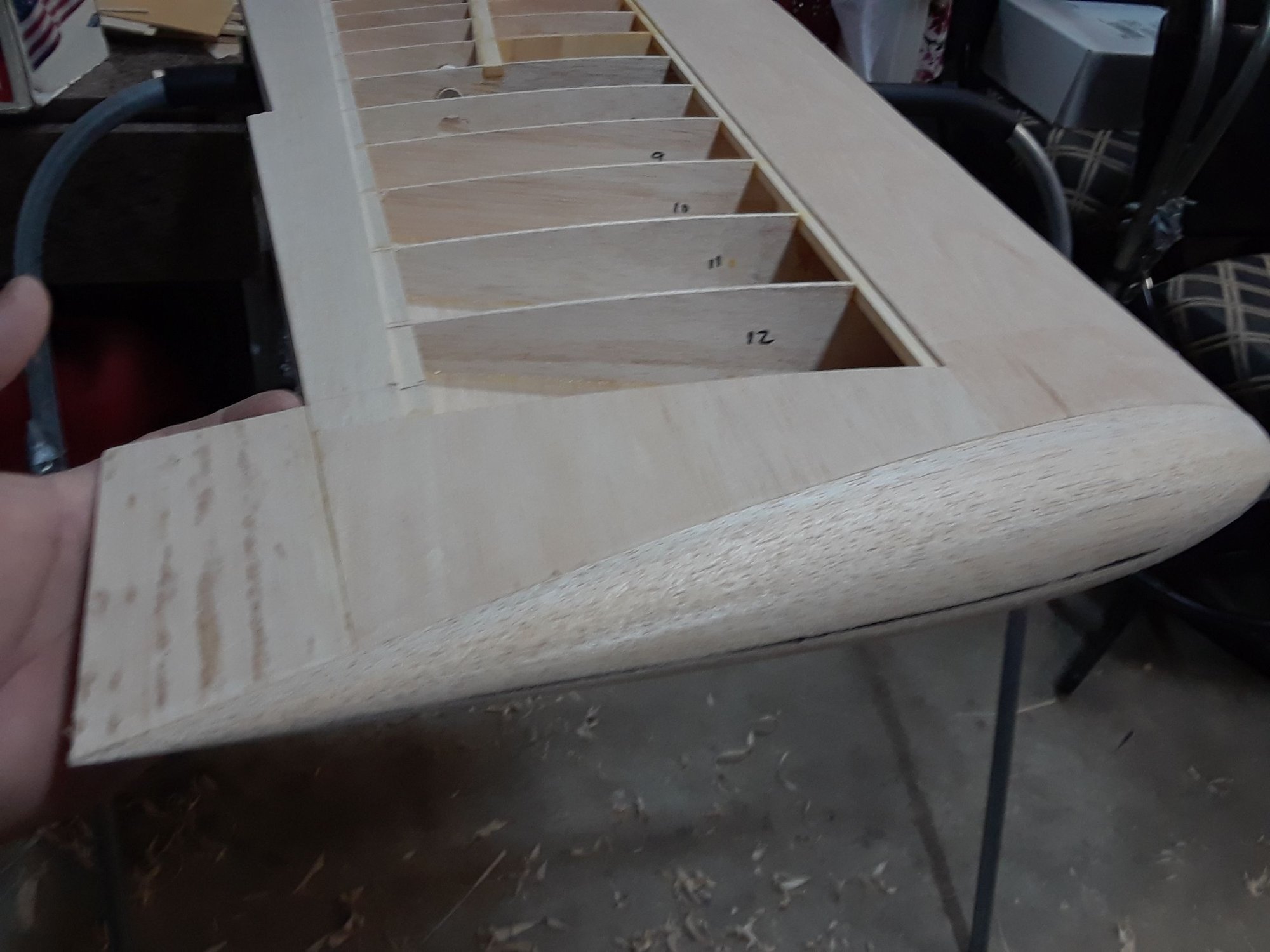

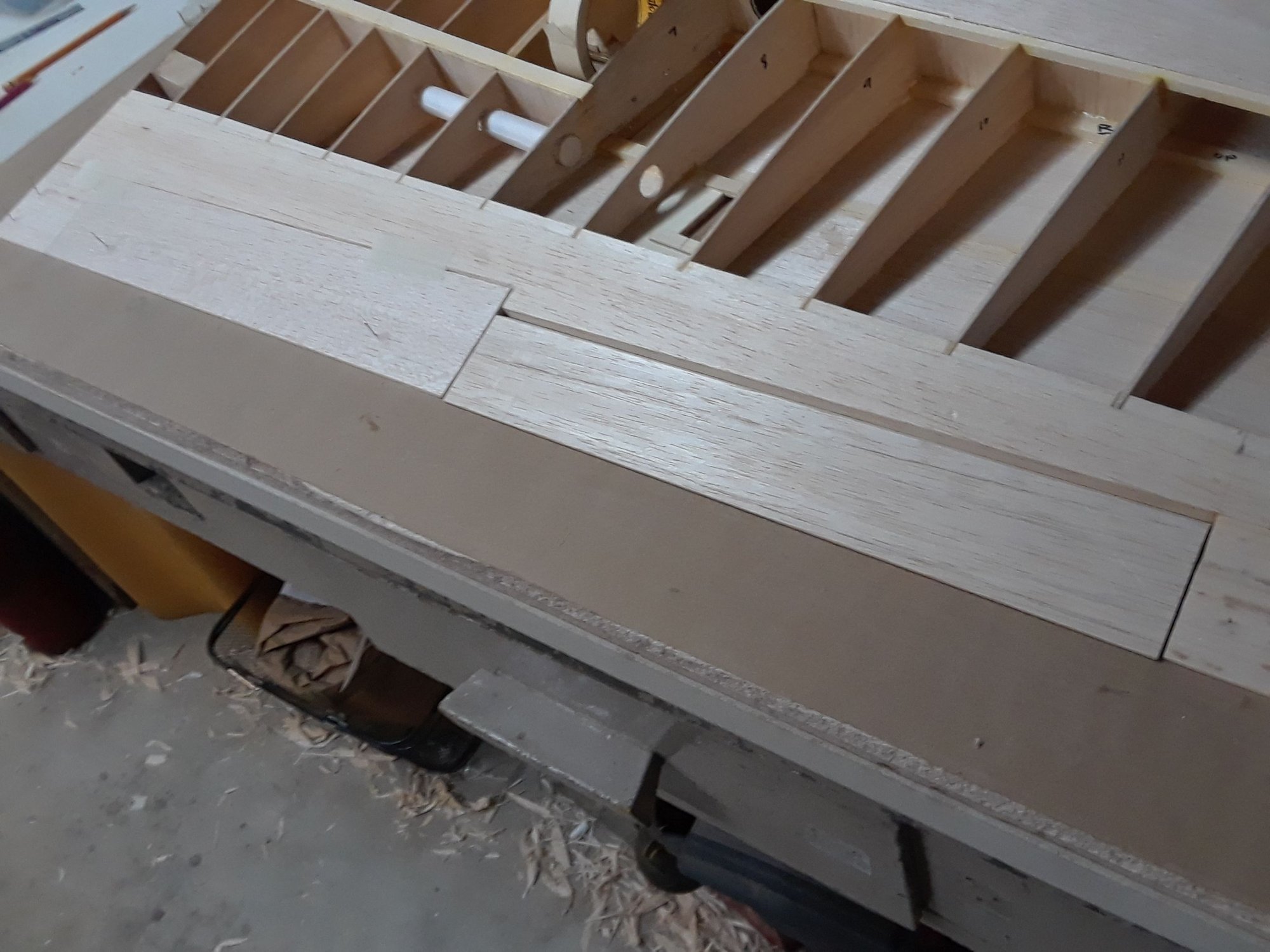

Continuing with the build, the TE extensions are glued, the wing tips and roots are trimed and now waiting for the yellow glue to dry on the tips, wing tips trimmed to a rough tip shape.

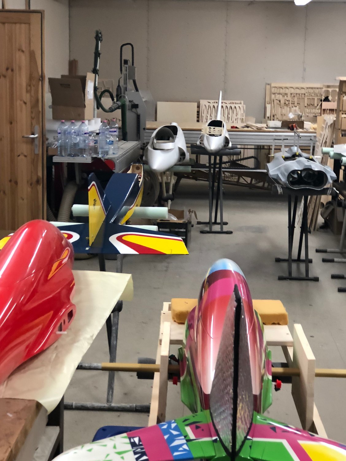

First time out of the workshop with the R54 fuselage for a visit to my friend Jean Pierre ( znline owner). Here is the R54 talking with some future fellows in the znline workshop. I had my R54 balance excell spreadsheet on my laptop and I selected some batteries. According to the numbers the balance should turn not so bad........
We talked fuel system.
Belgium is very small country, you can go from a boundary to a other riding 2 hrs car. and only a very few amount of rc field., meaning we know each other very well.. Friday I should go to Avonds,. Philip Avonds and me share the same intterest for rc vintage kit and I will go to collect a old svenson kit. I'll maybe take my R54 with me just to have the opinion of a rc scale jet world champion about my setup.

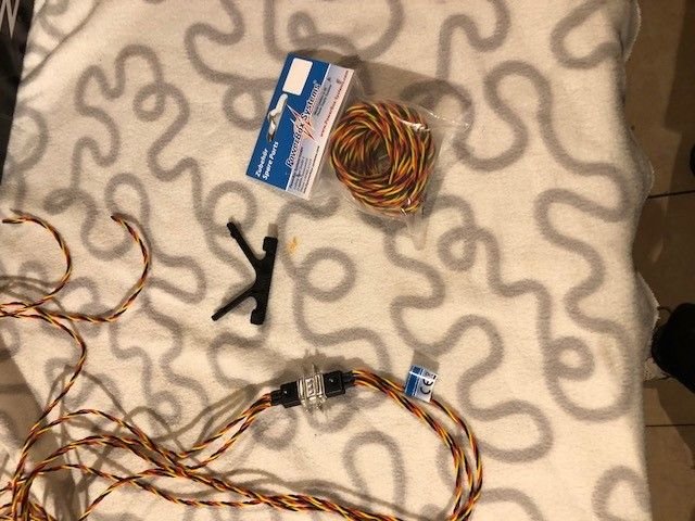

putted those little things in my pocket when visiting JP, wings connectors and this funny cool 3D printer made antenna wires holder

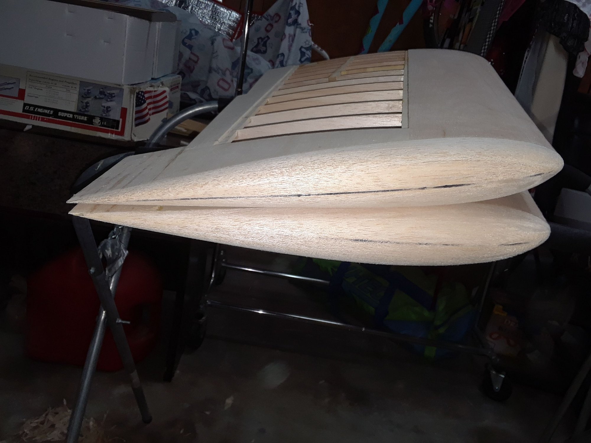

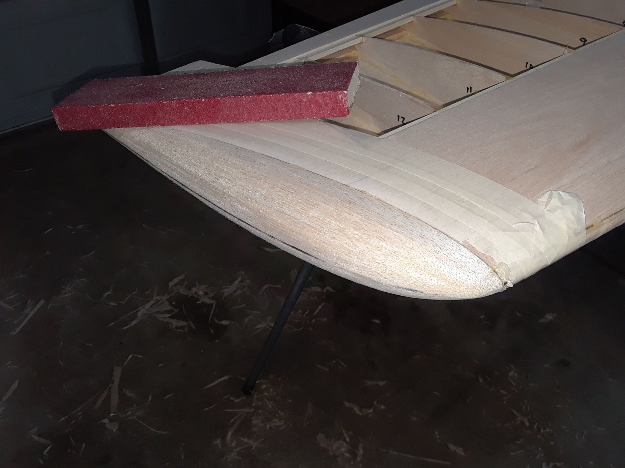

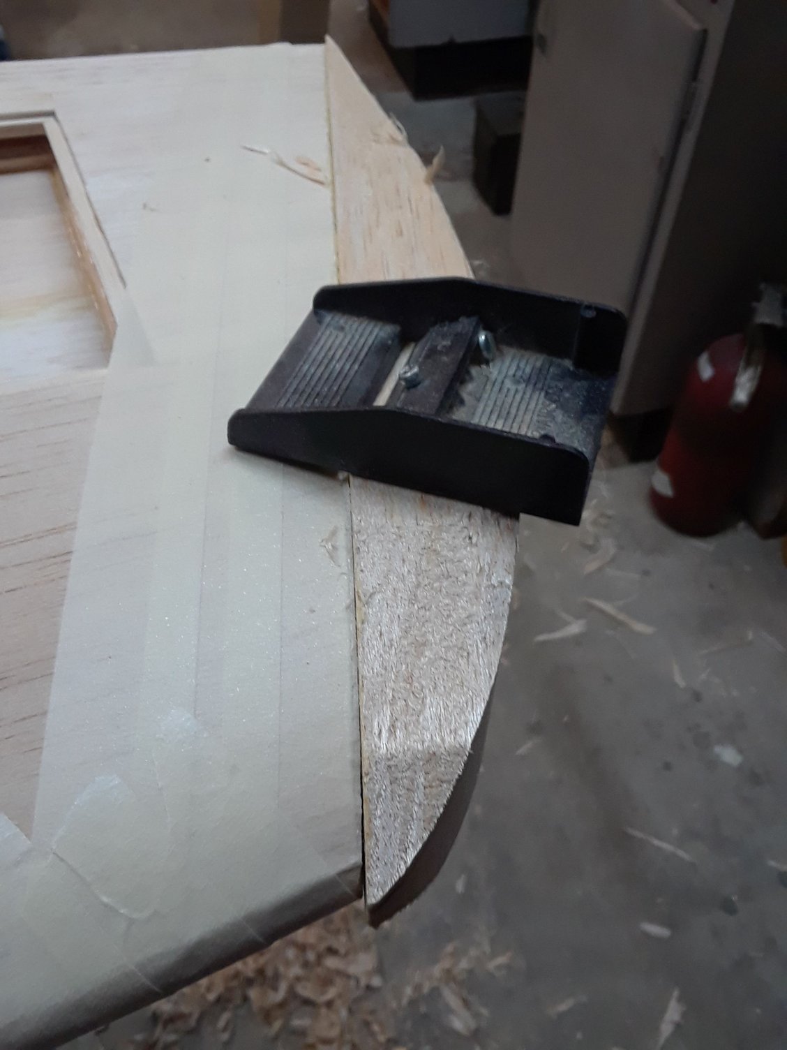

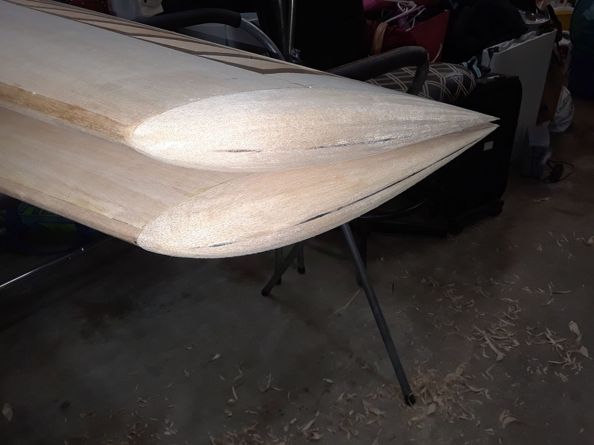

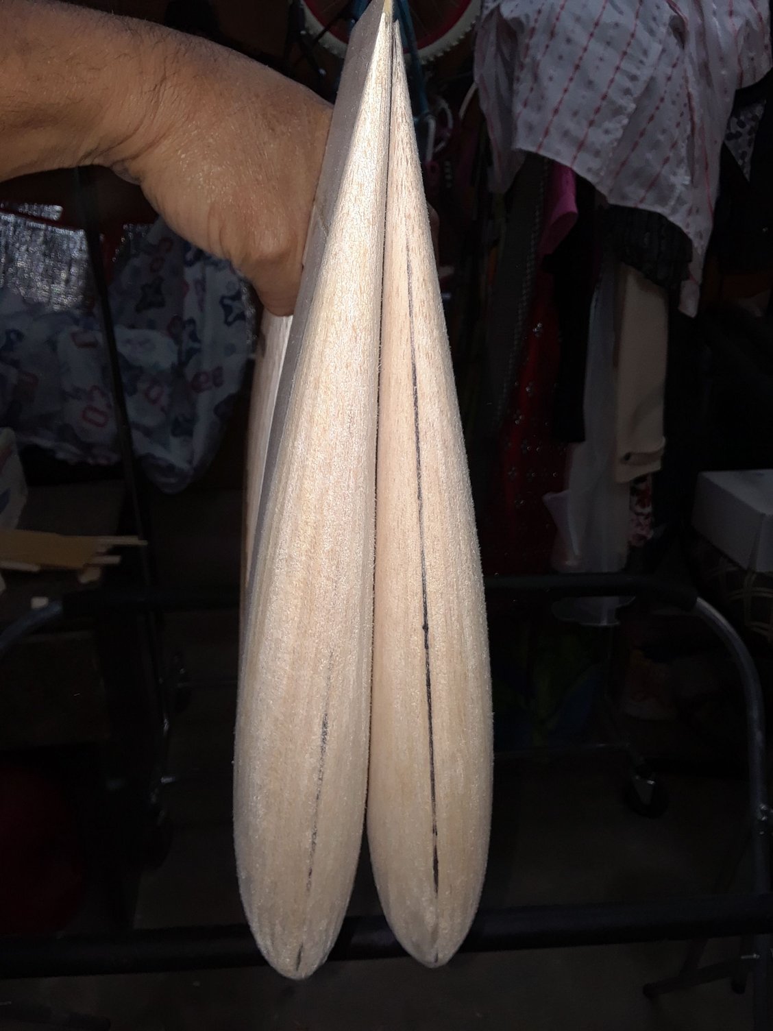

Working on the wing tips to a rough shape, final sanding to be done with the entire wing.
CARS II is online now

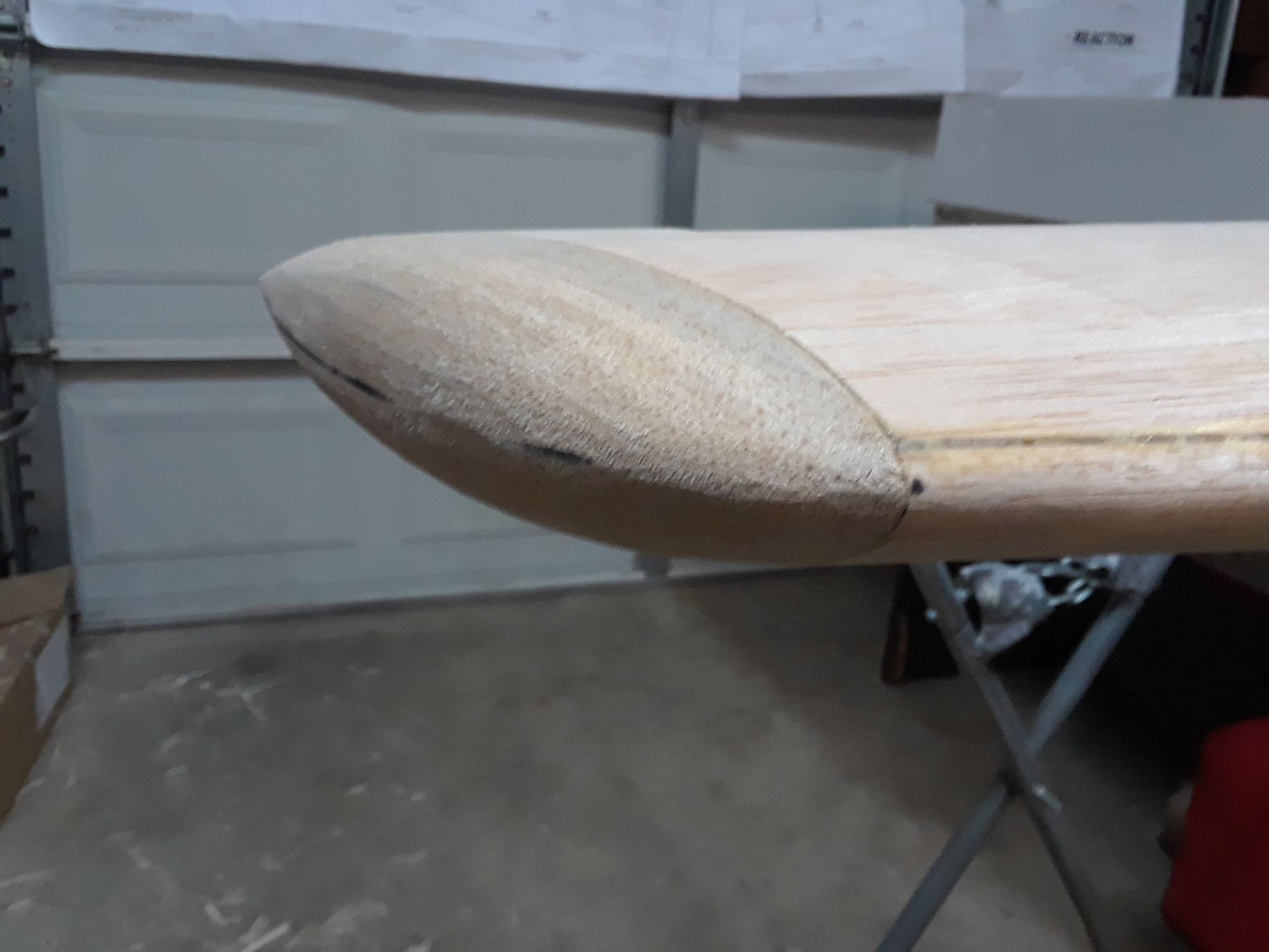

Tips done for now.

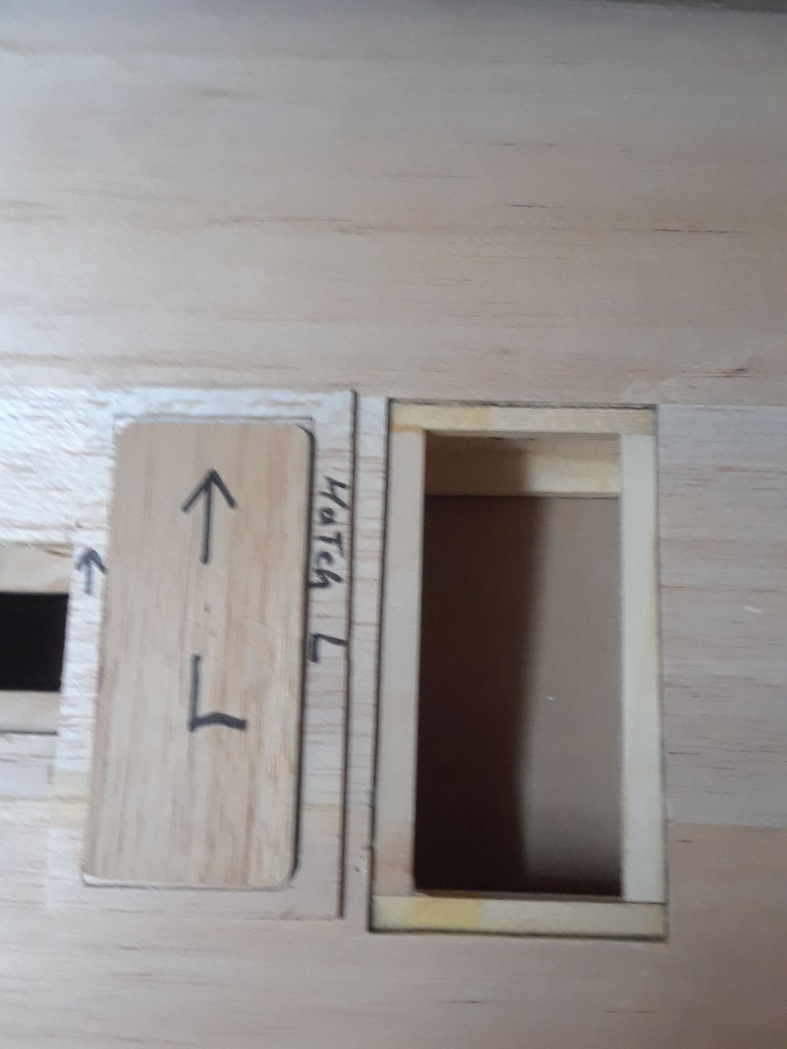

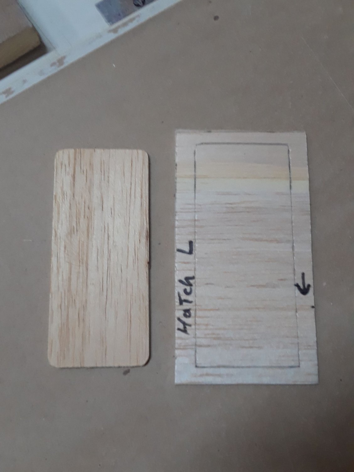

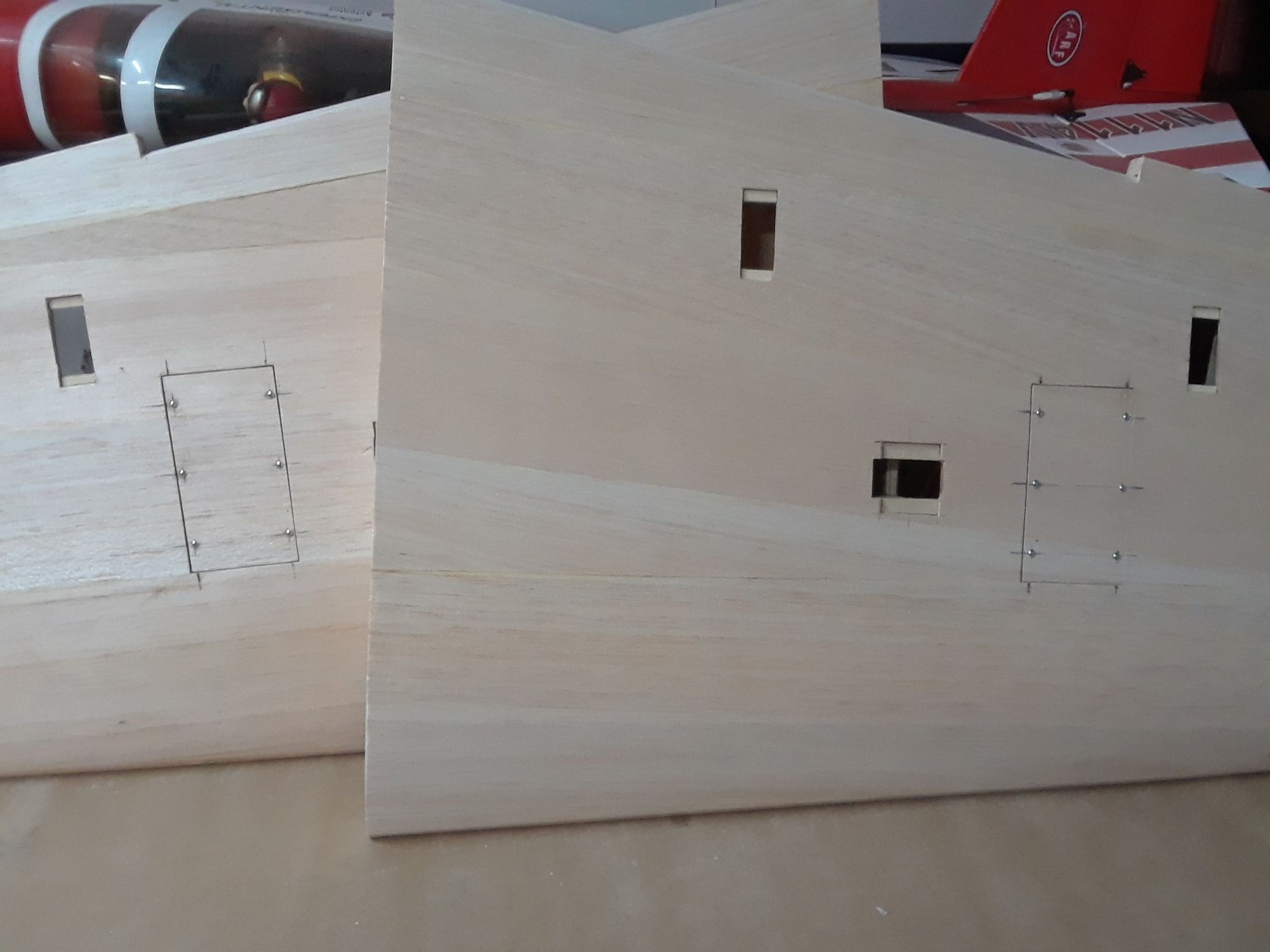

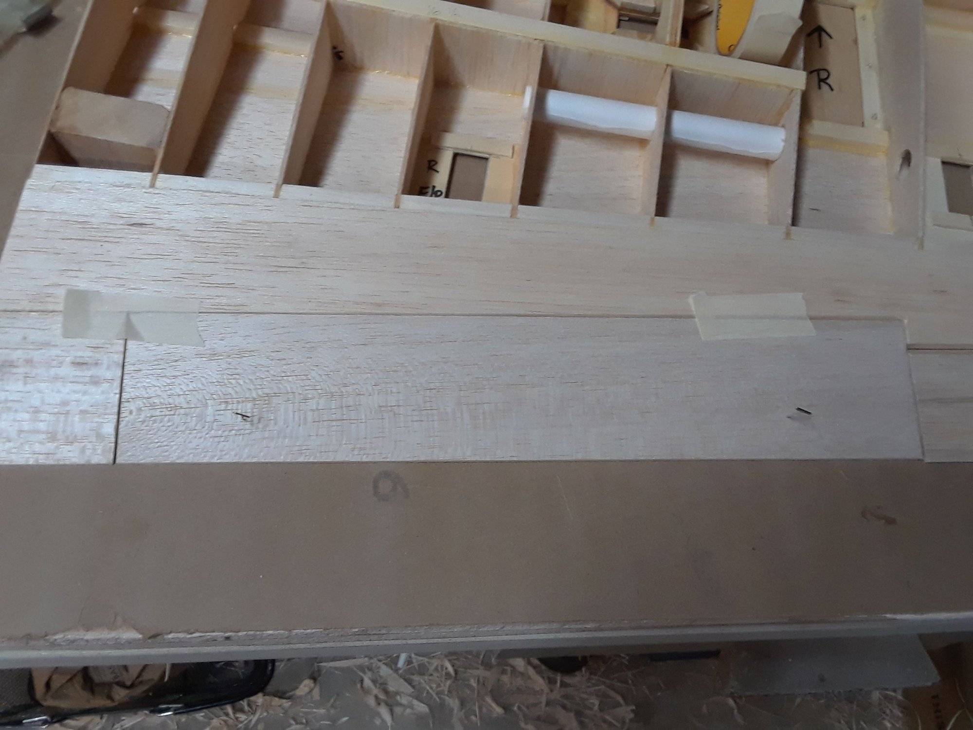

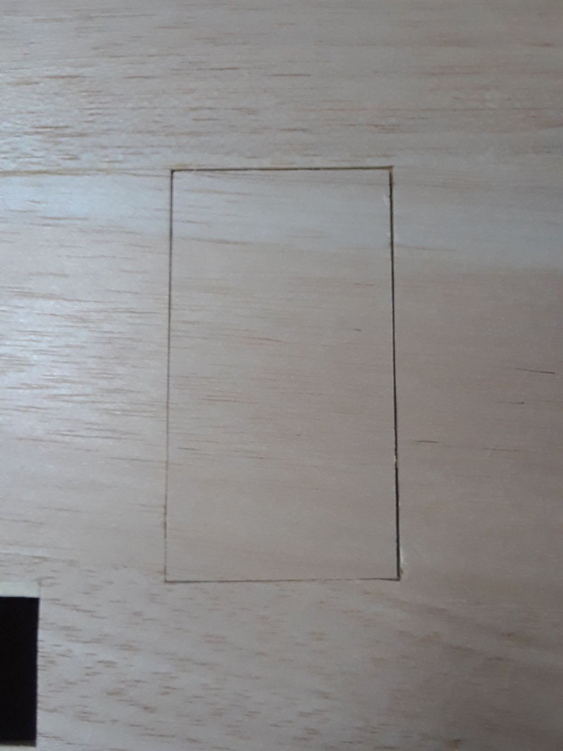

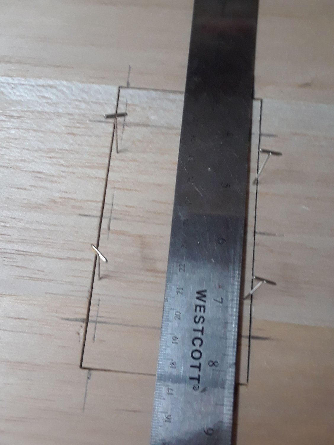

Moving on with the wings hatches, I didn't drill the holes for the screws at the very ends of the hatches because I didn't wanted holes on the main spars, instead I will add transparent packing type to the edges to seal them this will prevent any air from getting in the wing, specially during fast flights, I also added a drop of thing CA to the holes to make them more durable.

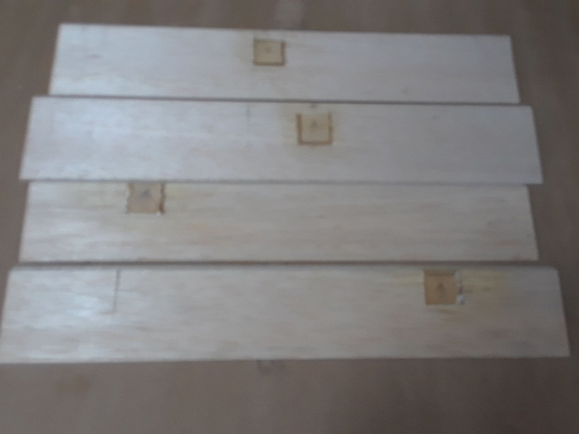

Ailerons and flaps are cut and the control hornes bases were glued with 5 min epoxy.

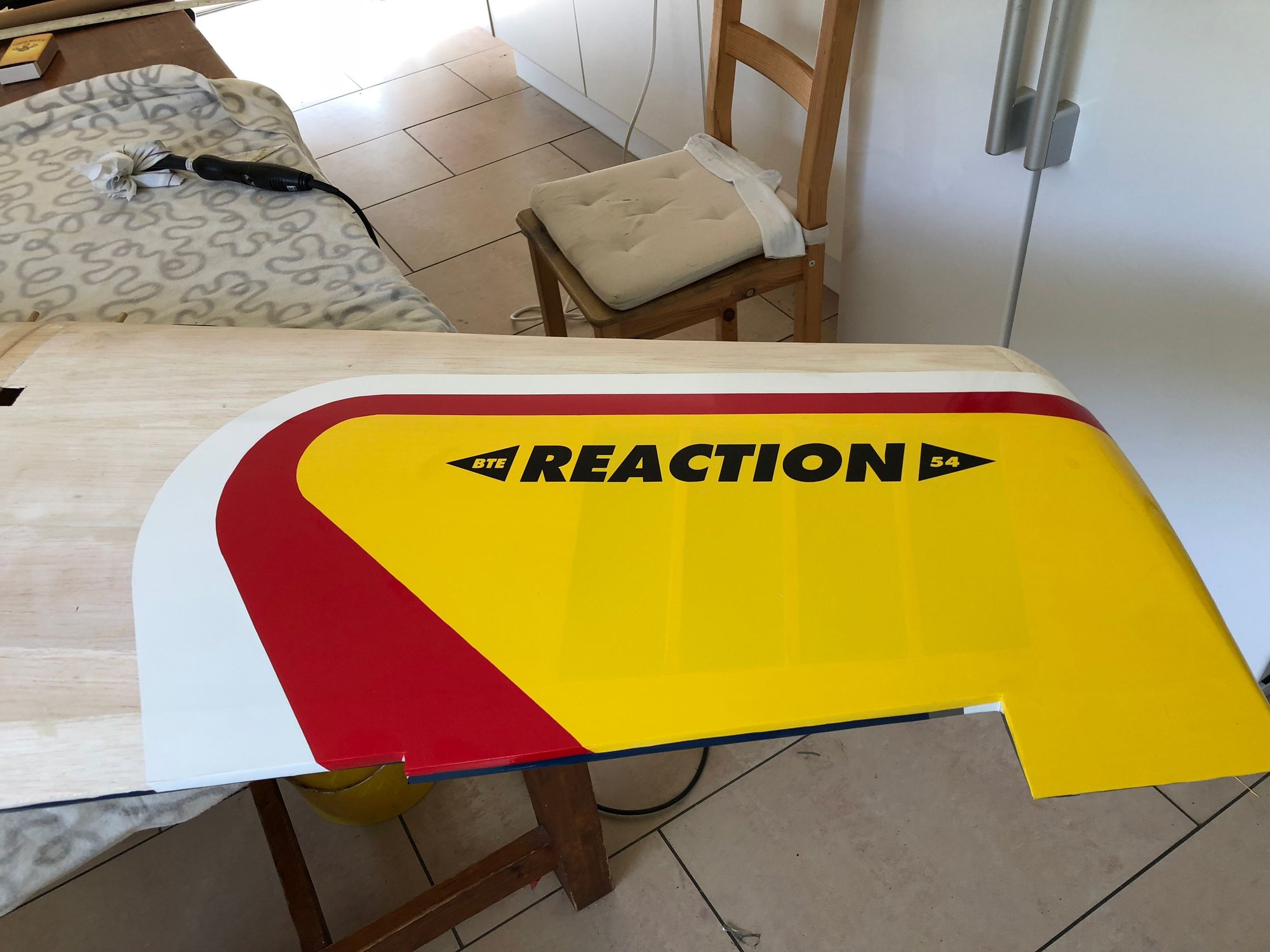

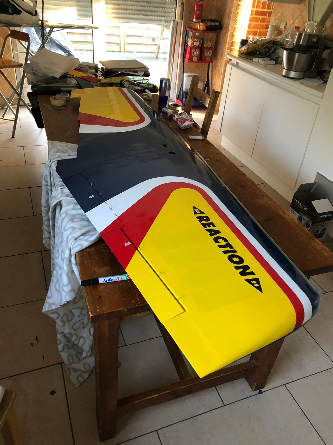

blue arrived early this morning, we ironed all the day and here are the wings . happy this ironing job is behind.

Looking Great but what is all that engineering in the background of Post 3890. Smile. Chic
As far I remember I ordered the color scheme templates with the kit one year ago
by the way either the wings look impressive I found the hatch the most difficult part to iron in this ironing job ( followed by the stab)
