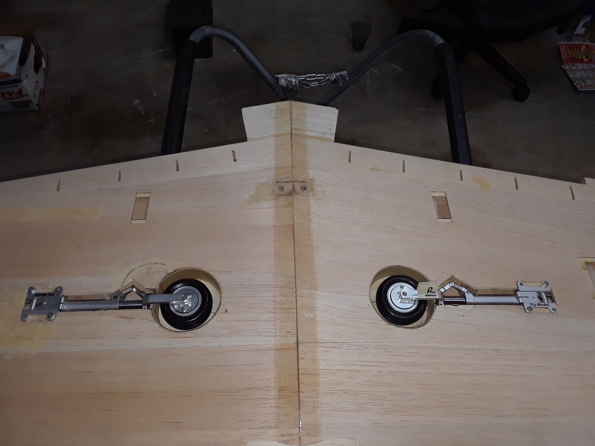

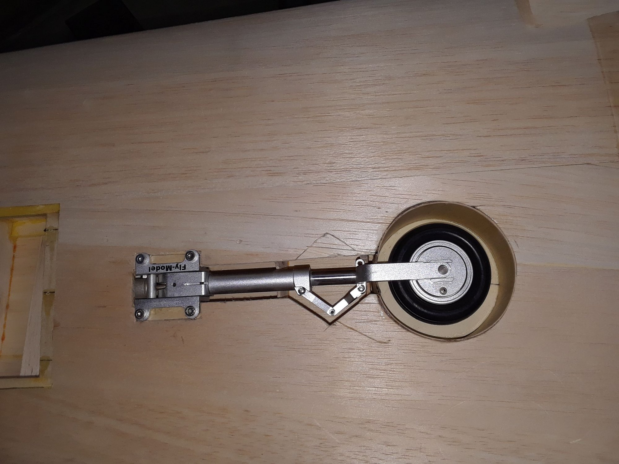

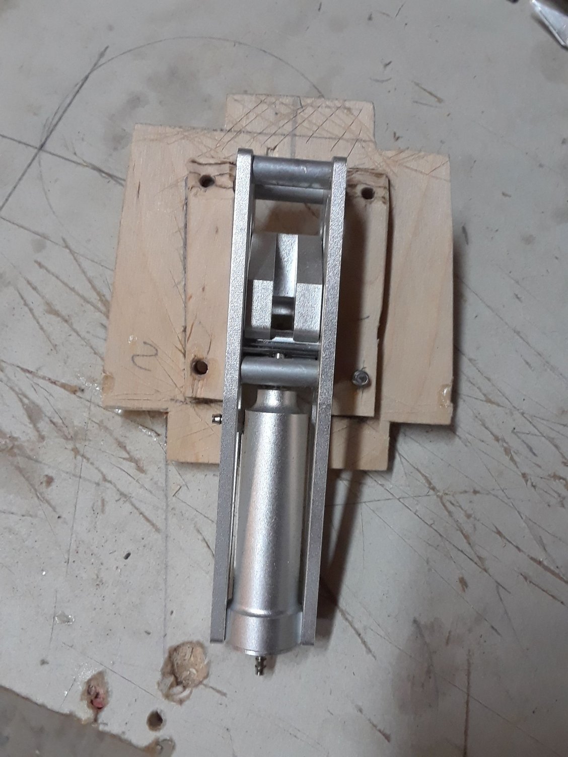

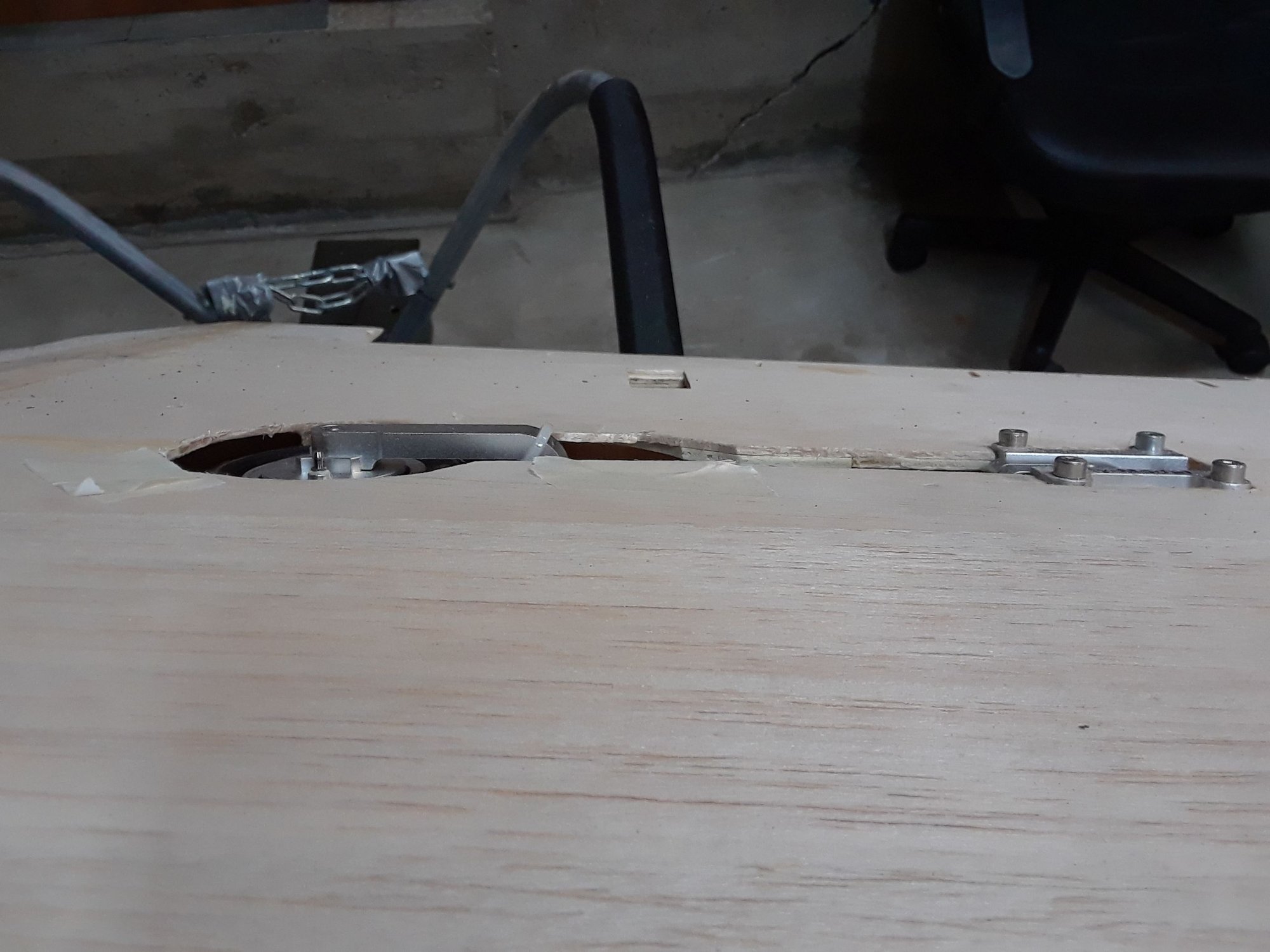

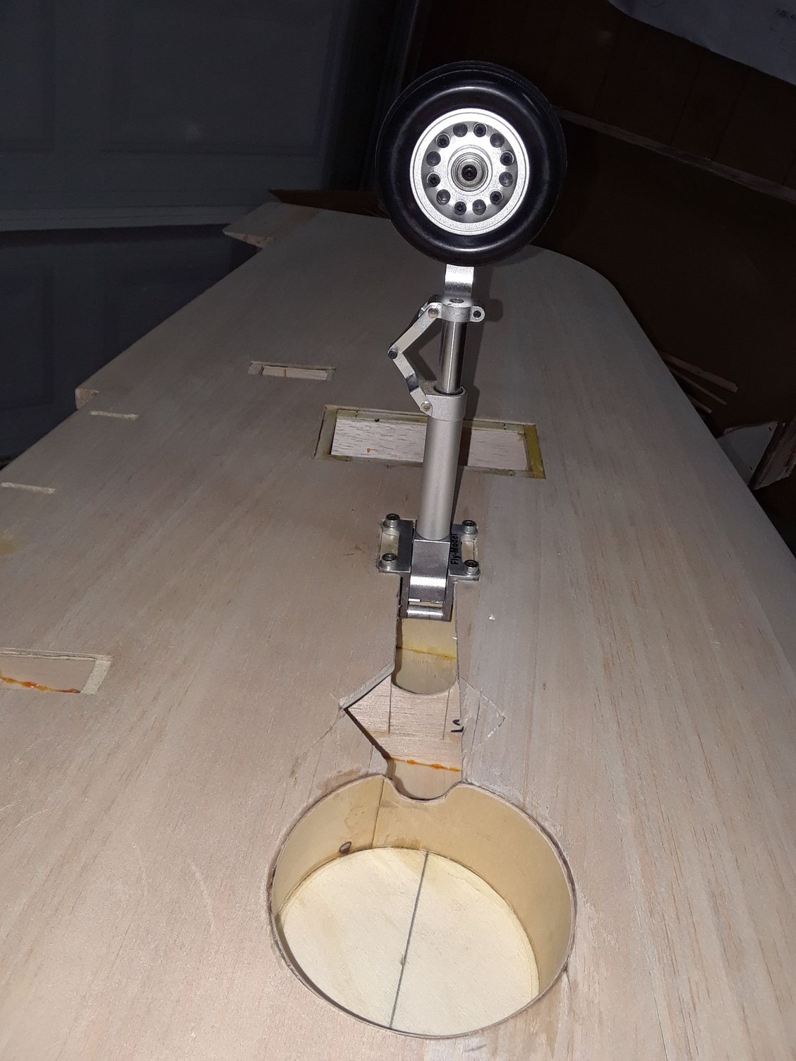

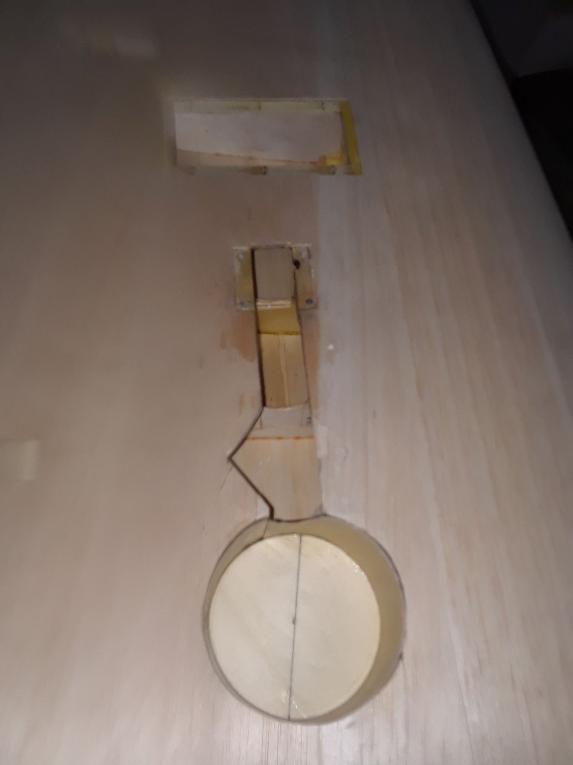

Did the initial work to get the main landing gear figured out, the nice thing about this gear set is that you can flip the trunion fork to swing forward or backward and the compression fork can also be flipped from on side to the other, very convenient, very small mods to fit it in there, used 3mm screws, they fit right in the retract mounting holes, no play and as before, I added another 1/4" ply rails to the retract mounts during construction to add meet to hold the retract screws in place, I don't use blind nuts, my Boomerang XL is this way, this is done in case the main gear has to depart the wing then It will with minimum damage to the rail and wing, it has worked on many builds and counting, the tires have brakes and are hollow, they are to be inflated to your needs but the valves are not in the rims, I prefer to fill them up with inserts like the Robart scale tires that way they are semi-solid.
One other thing I did was to check the gear set completely, made sure all the screws were tight, air nipples too, added locktight to the them also, lube the O rings at the end of the struts, injected some car strut oil, Teflon base to make sure the O rings inside the cylinders were nice and moist, I use 25 weight, by using this oil you can get more cycles out of your gear and on the old retracts the O rings get revitalized and moist.

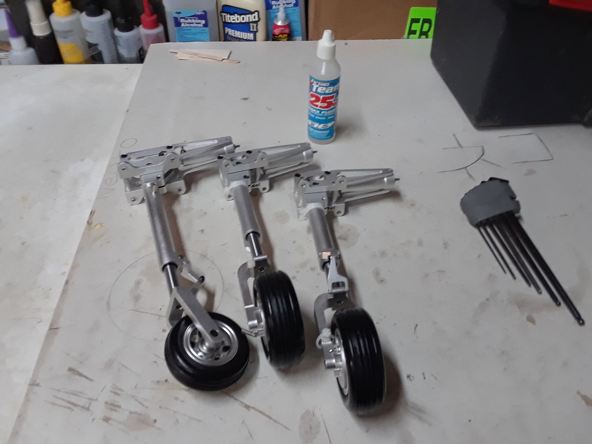

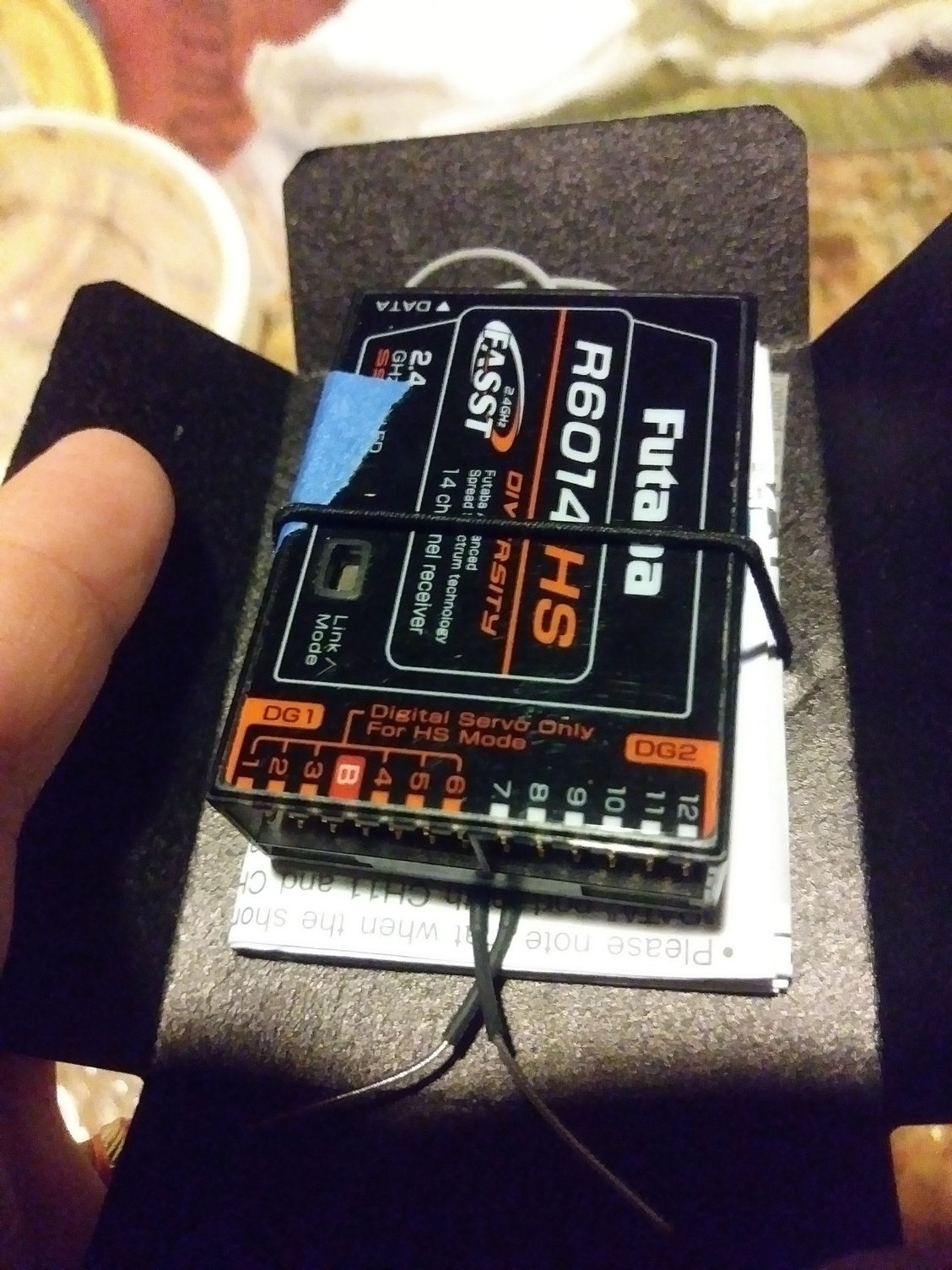

Ok, we got parts, airlines, 14chl Futaba FASSHS receiver, extensions for the Reaction and Boomer xl, wire cutters from Harbor Freight, zip tides, gas for my small torch, safety wire ( green this time ) power switches for both jets, servos to be here Sat, electric heater from HF so to not freeze during the build and lots of time off starting in a week to get it done.
And as usual, my inspectors making sure all is in order

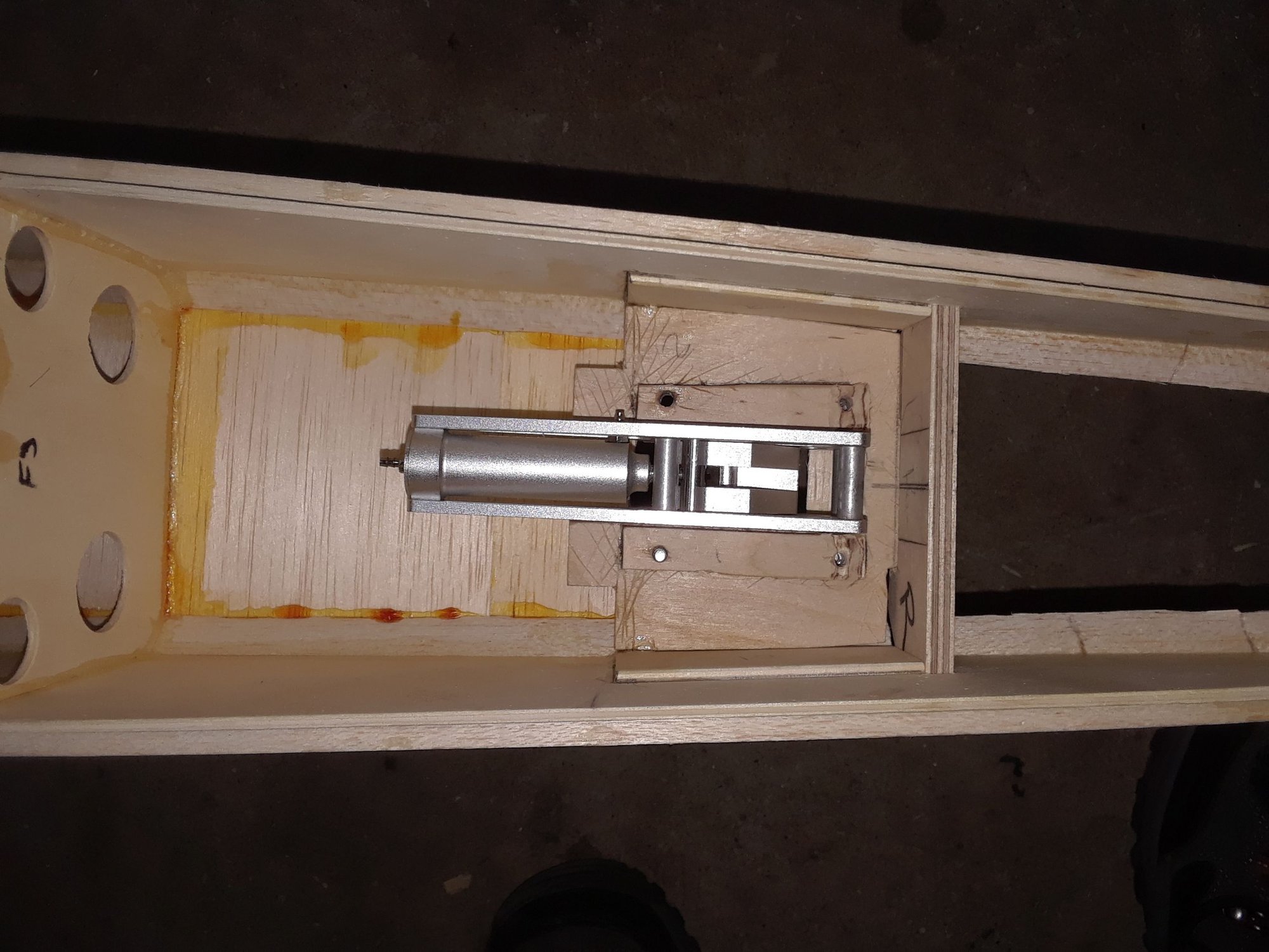

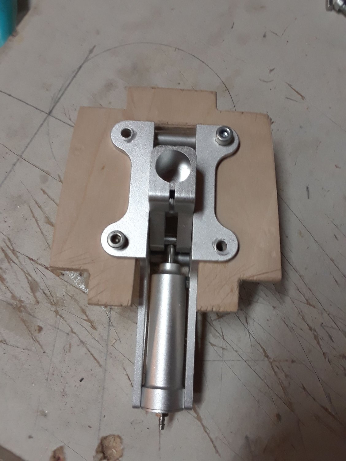

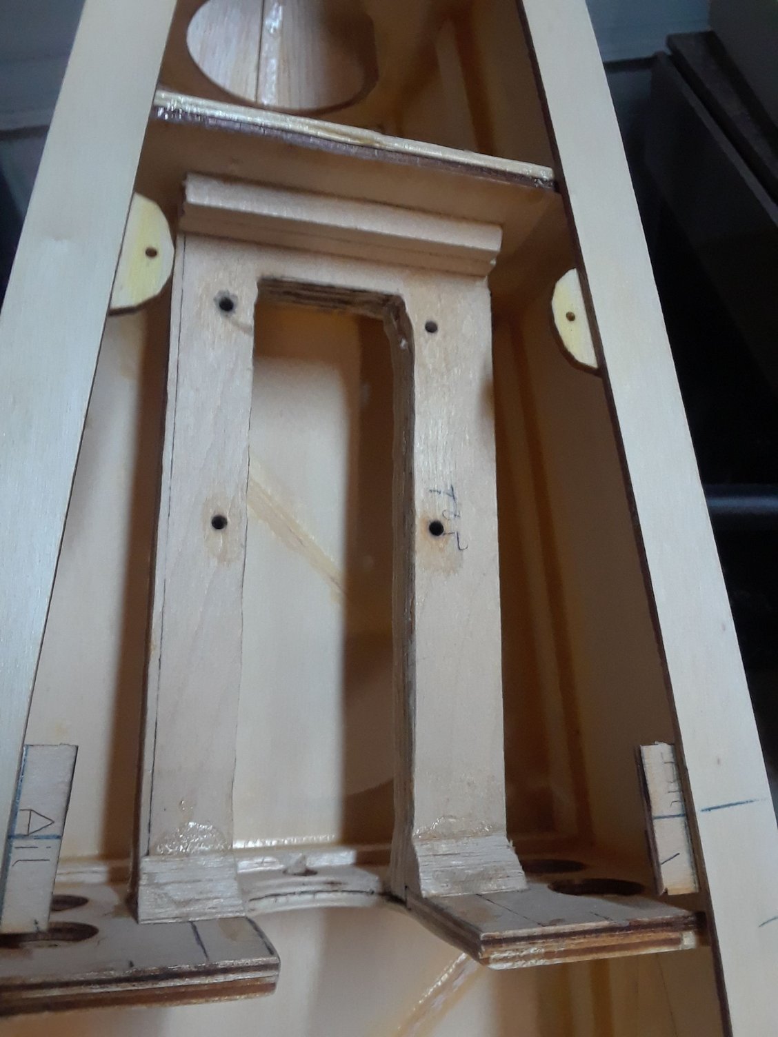

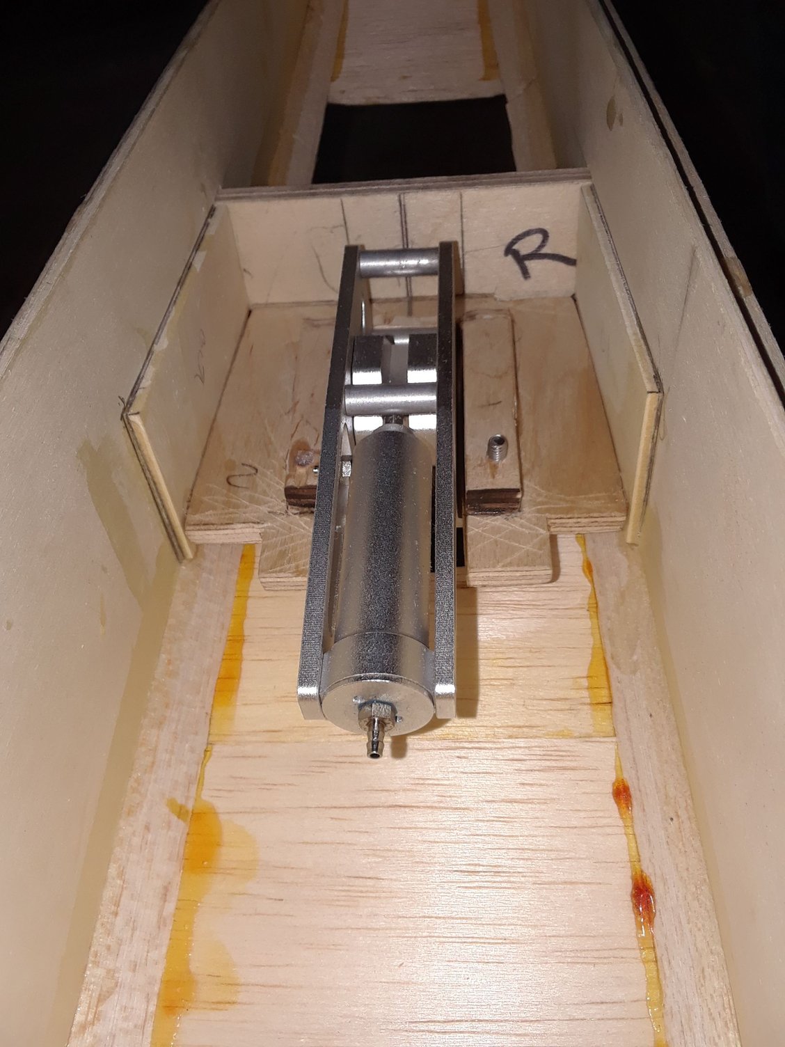

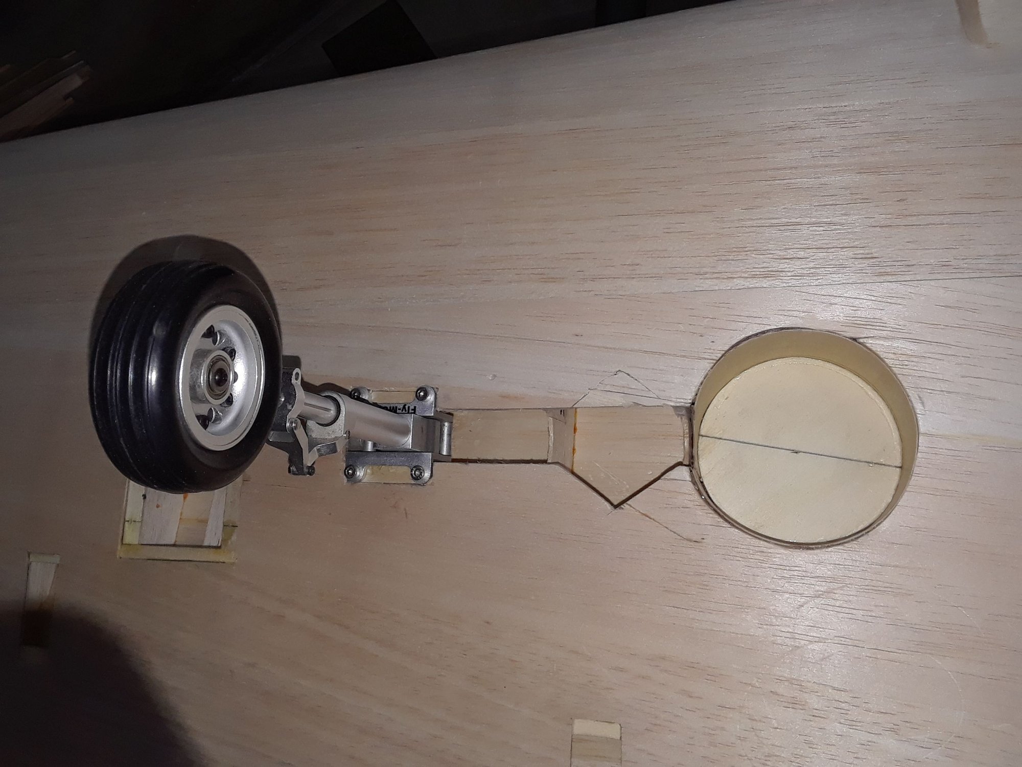

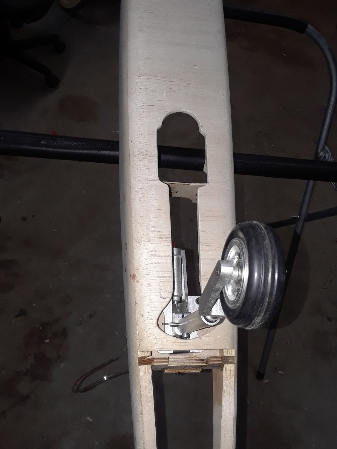

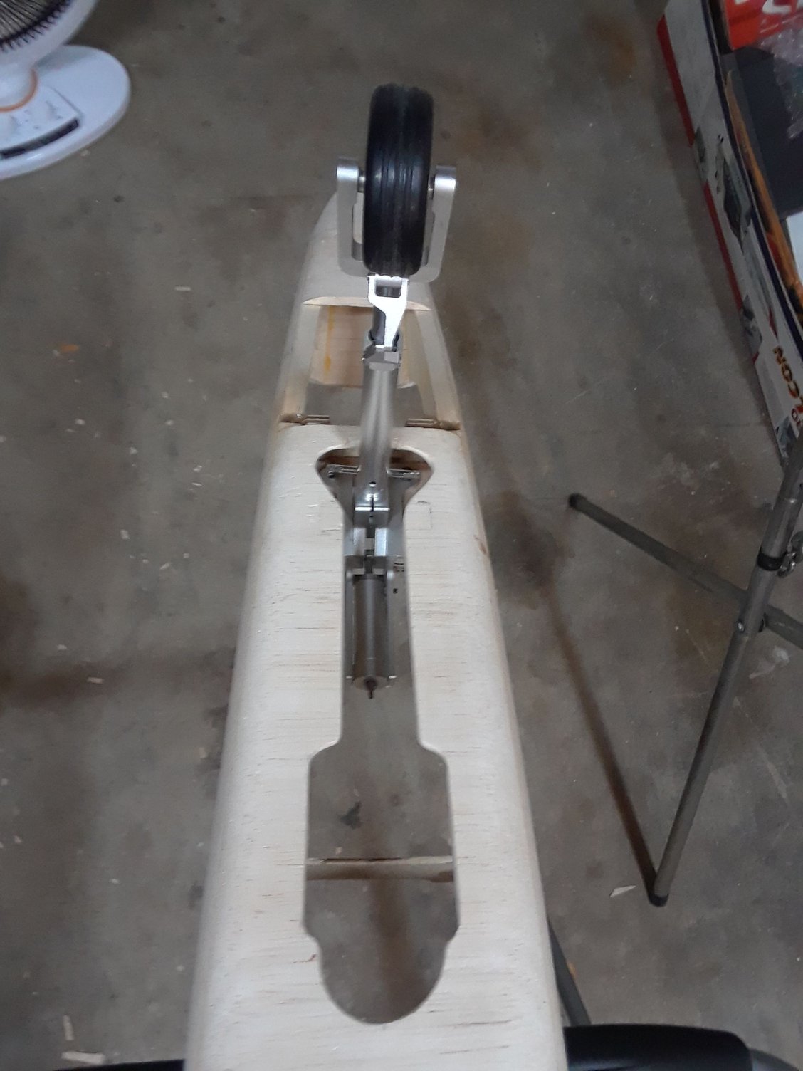

Ok, all done for tonight, one main gear installed, it took some doing, the other one should get done in 1/2 the time, very happy with the way it came out, I added a 1/2 rib to support the wheel well floor, I also kept the wheel well the size shown on the plans in case I want to go with the 3" wheels later.

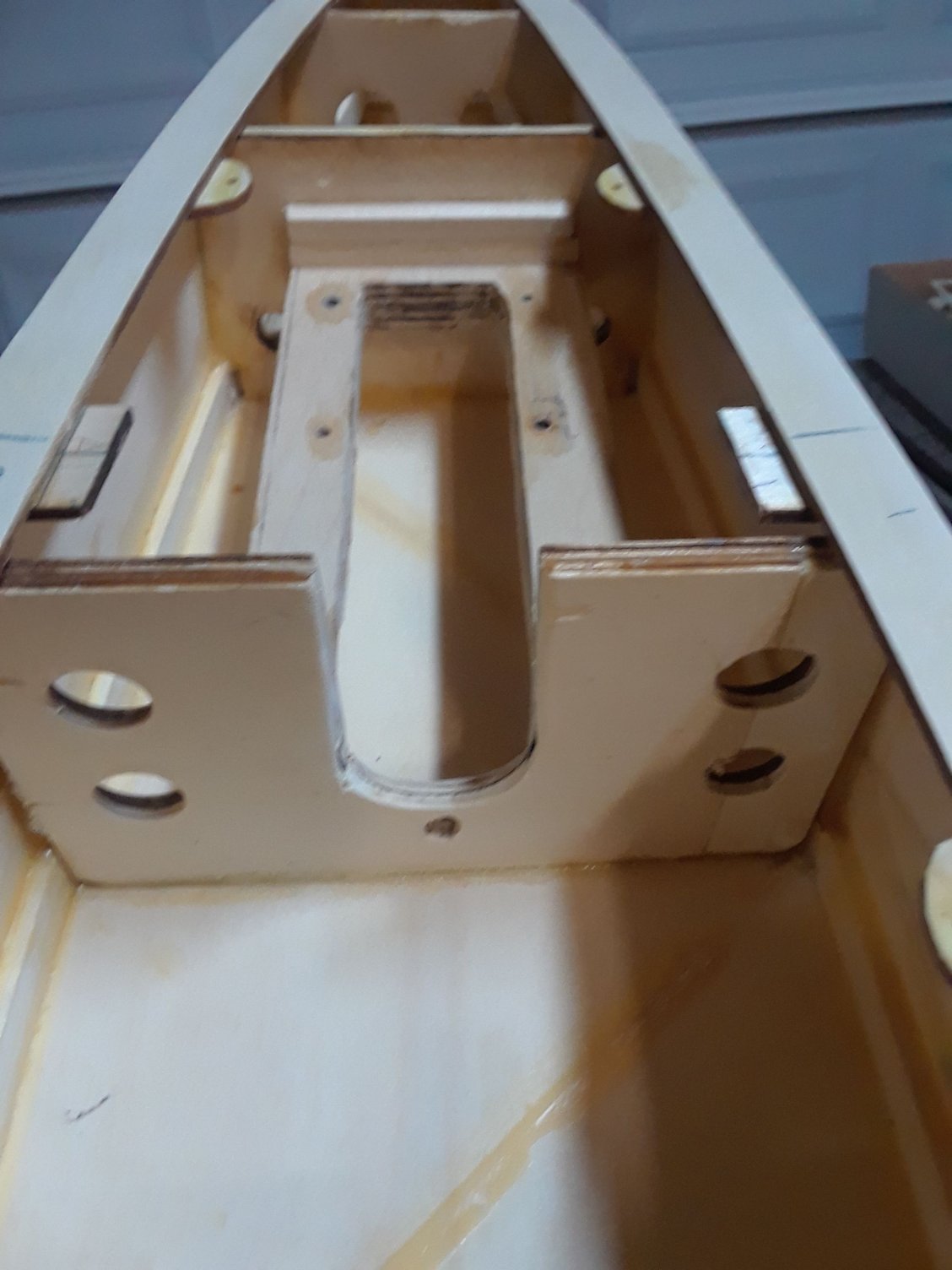

Tomorrow I'm planning to do the other main, on the nose I will construct a new gear mount like the one I build for the Turbinator.

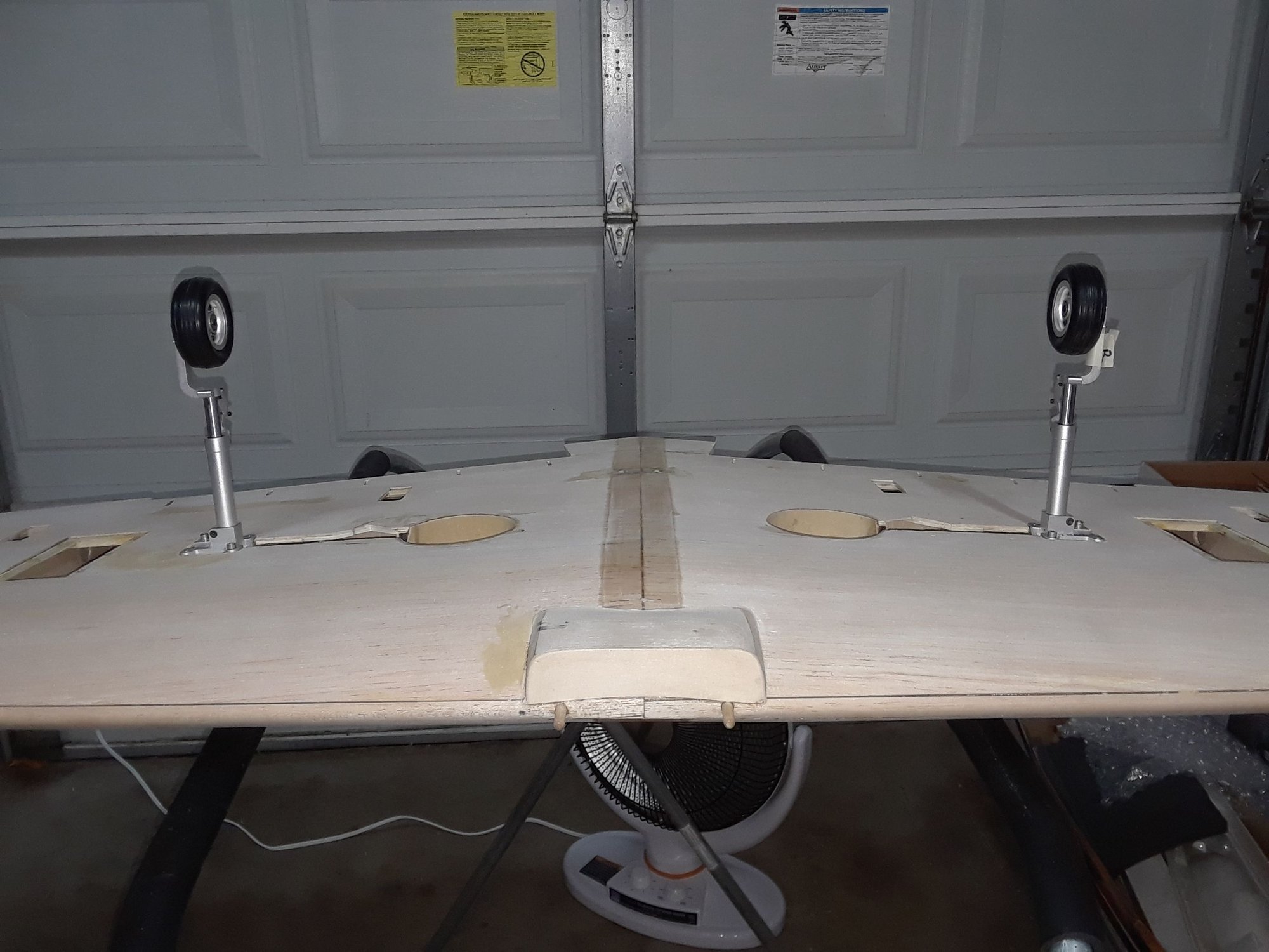

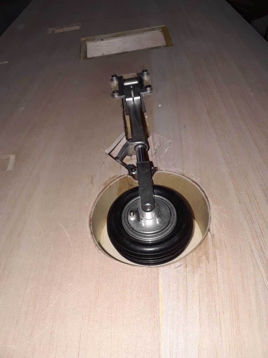

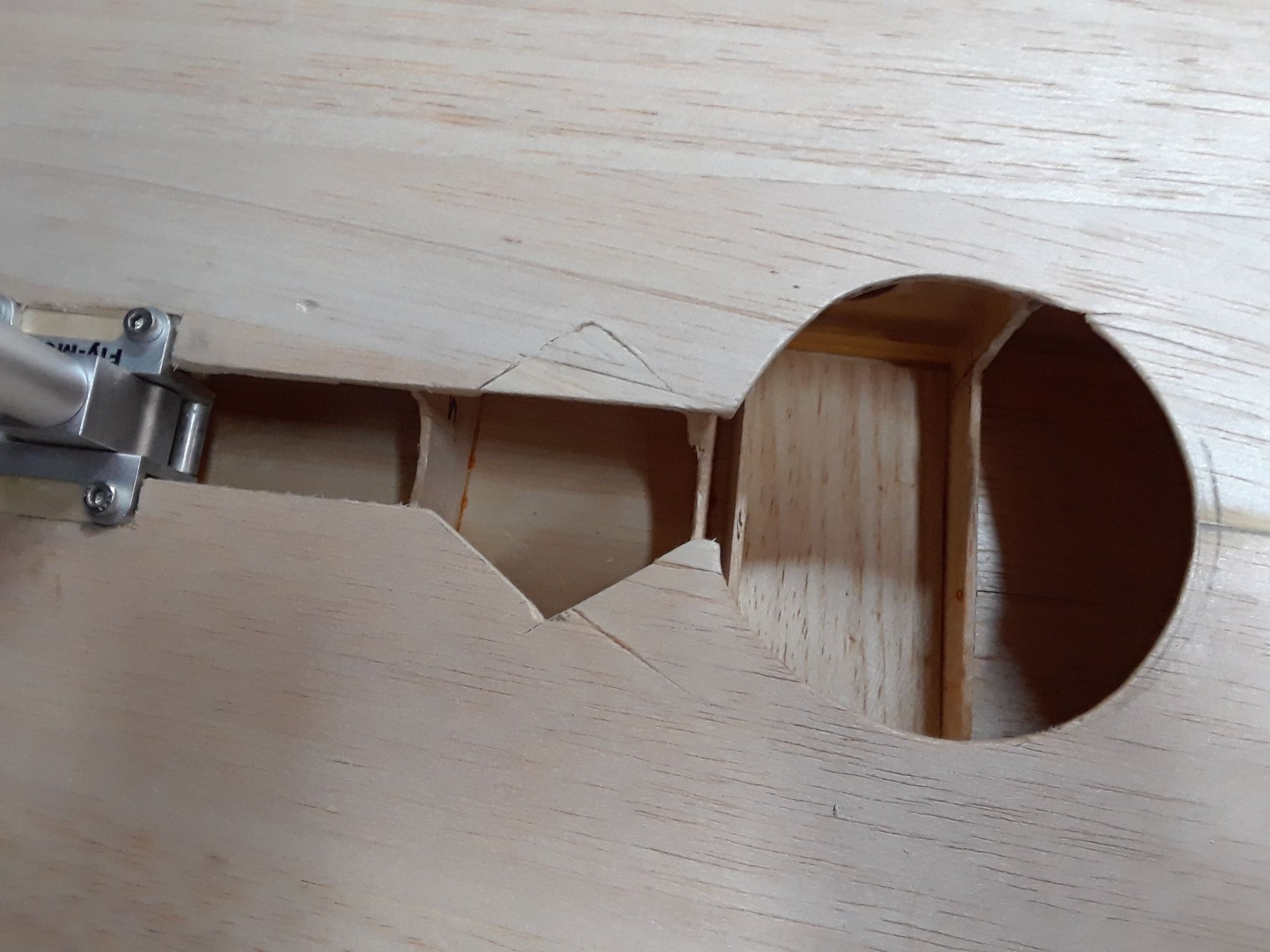

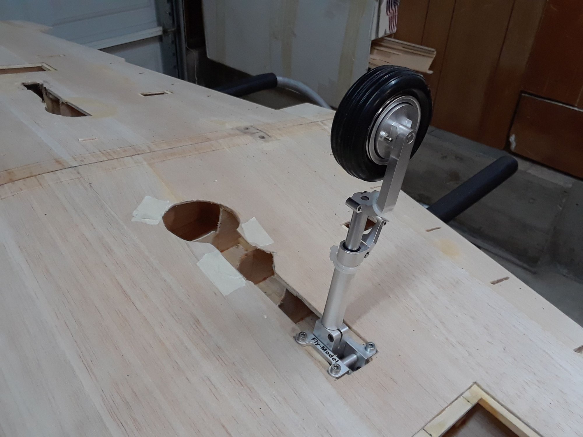

We now have both mains installed, I think I'm going to close the rib bays between the retracts and the wheel well, for this I got to go to the LHS to pick up a sheet of 1/16 balsa.
There are some patches around the struts, I was experimenting with a different set of gears but that one didn't pan out, that is the beauty of building with wood, one can change and fix it back to the way it was till your hearts desire.
On to the nose gear mount

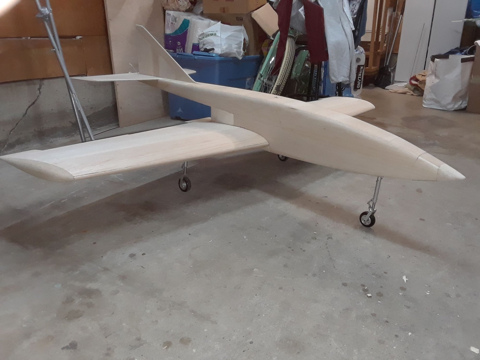

There it is, standing on his own legs, although not completely done with the nose gear mount it is cut and just needs some minor adjustments, then I can glue it down tomorrow.

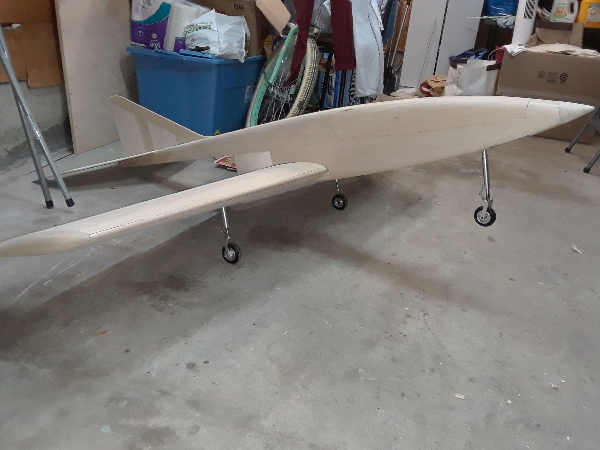

Some work done today, completed the mains by closing the rib bays under the struts and end up with the nose retract on a higher position to keep the steering wires inside the fuse, this one is half way there, should be done by tomorrow.

Ok, the gear in this jet is on and working as intended, it took some doing ( like a billion hours ) the mains were mostly work to be done but the nose gear took some thinking to cut and instal but at the end it all looks good.

Finally at home working on the Reaction, took one of the wheels apart and the rest of my questions were answered, looking at the rim in more detail I found what I suspected was there ( was thinking if it all week at work ) these is how the air gets in the tire and it is retained in there by the O ring.
I'll be using these wheels till they are done then I will switch, if not before, to Sierra Giant plain hubs with brakes and combined with a set of 3" Dubro tires should take care of the shoes after the Airpower ones are history.

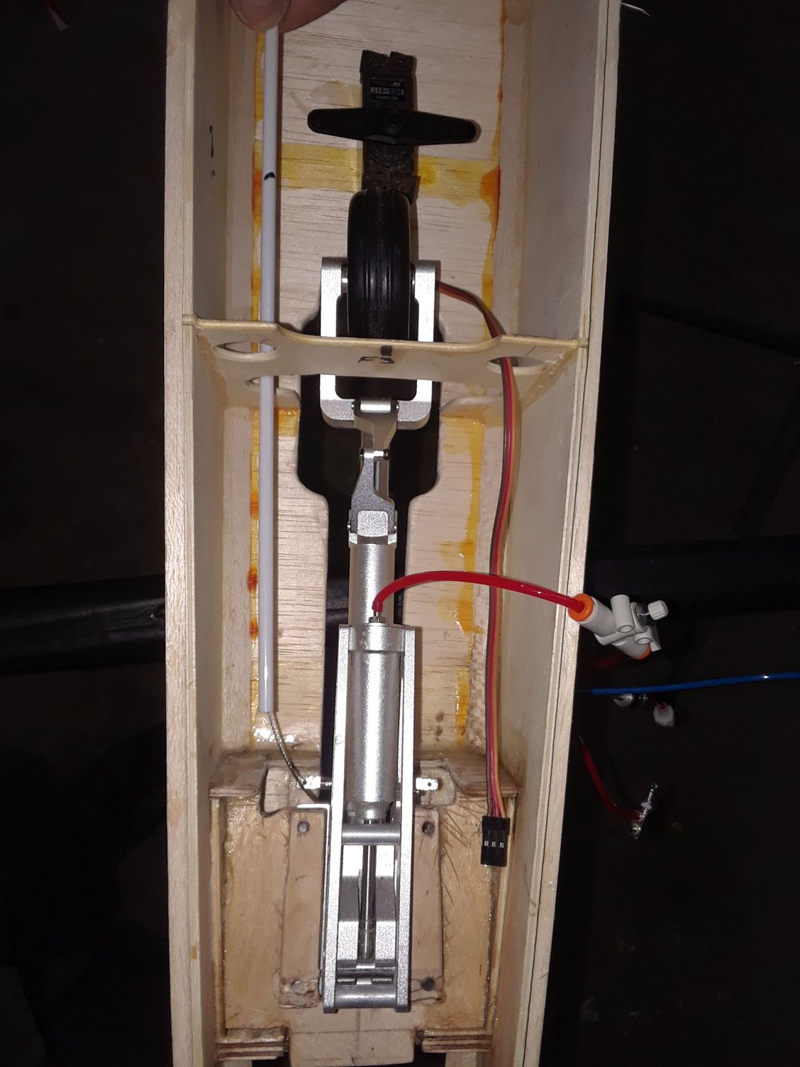

Tested the retraction and extention of the mains in the wing, all checks ok, moving forward to build the steering sytem.

Ok, steering is all thought out and most of it build, I'm waiting for some Hitec servos ( more than 6 ) to return, I send them in for service, in that group is the rest of the servos I will be using to complete the install, the steering cable came from a long gone Escapade 30cc pull/pull rudder system and the cramping tubing from a fuel tank from an ARF that I had a long time ago, the piece of balsa under the servo gave me the gap I wanted between the floor and the servo, used 5 min epoxy, just enough, I like to recycle what I have, that way my inventory at home is small.
One key element in the pull/pull system is to make sure that the loops around the steering arms are tight, tight and small then tight some more to prevent them from swinging around the arm during retraction, if that happens the cable may get tangled on it and the nose gear my not deploy completely.
The pictures give you a general idea of the end result.
