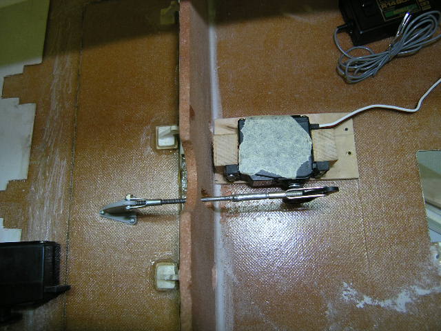

Hi,
a question to the list.
The Roo airbrake has some flexing if pressed backward (simulating air pressure). Airbrake moves around 1/2" - 3/4" backwards.
The Robart type horn (1.25" high type) is situated approximately in the airbrake centre and is connected to the servo by a 4/40 type rod which is about 3" long.
Well a picture says a thousand words so are included.
Should this flexing of the airbake be of any particular concern?
Thanks in advance
Reuben

My Feedback: (29)
RE: Roo speed brake ??
I stiffened my speed brake with a laminate of 1/8" balsa and 1/64th plywood epoxied to the inner surface. I have also seen a roo with what looked like 1/8" ply "ribs" glued perpendicular (90 degrees) to the inner surface. The ribs were only about 1/4" tall and ran to within about 3/4" of either end of the speed brake.
