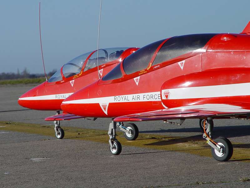

I would like to know if anybody out there has had any experience with this airplane. I was thnking of getting one, but I saw the manuel and was concern with the tail section of this airplane. If you look at the former and the plate that holds the vertical fin in place it looks very thin. The other problem that I see with the airplane is the elevator servo location. Its located in the rear of the airplane at the top of fuse on a plywood plate. Now with the pipe going next to that and we all know that heat rises you would have to be concern with that and hope that that plate does not get lose with the heat. If anybody knows any different please let me know as I would really like to get me one of these airplanes.

I have flown my Skymaster Hawk quite a lot and had no troubles at all.
I don't think that any skymaster plane could be called under-engineered. When I when to the factory I was amazed to see how much actually goes into one of these models.
My Hawk (Well worn prototype model) Actually experienced rudder flutter when the rudder servo stripped in too fast a flick roll. The next pass was balls out and the rudder began to flutter which lead to the entire fin getting a flutter on. I slowed down right away and landed. I was amazed to see that all the fiberglass and woodwork inside was in one piece. I changed the servo and then had another 20 or so flights after this with no trouble.
As for the stab servo and plate. Don't work. If you are using the double walled skymaster pipe this area does not even get warm. I ran an entire tank through a hawk on Sunday on the ground (13 minuets) and at no point did the fuz get hot. This included some prolonged full throttle runs. Again The tailpipe is a little thicker than it needs to be and people are changing them for lighter ones but the skymaster one does the job well.
The only issues I have had with the model are the elevator set up and the flap set up.
We have two models here in the Uk that were set up with Futaba Digital tail servos (9350) The owners set them with the push rod on the furthest hole on the servo horn and midway down the elevator arm. This seemed fine but any load on the all flying stabs caused the stab to blow back. This looks like a case of bad geometry on the linkage but my one with the JR 8411 set up the same had no problems on the ground or in the air. My advice would be to make sure you set your elevator link up for maximum mechanical torque.
As for the flaps. On the hawk they are very powerful. Probably too powerful. Too much flap or flap deployed at too high a speed will result in a nose pitch down. This can be so severe that the elevator can not override the flaps. My advice is use the flap deflections in the manual as a maximum. And make sure you set the flap to elevator mix so that for every increase in flap deflection there is increase in elevator compensation. we had a case where a customer set his flap to elevator mix so that all of the up elevator trim came on in the last few clicks of flap. This was not good.
Lastly applying the flaps. You have to apply the flaps in stages and at slow speeds. It is no good motoring down wind and jamming in full flap. This will cause the model to pitch down. Instead on a up wind or gear pass start to slow the model and gradually apply a bit of flap. as you turn down wind apply a little more until you are on finals and you are applying full flap. What I suggest people do is take themodel up high and play with the flaps up there. get a feel for the model at height and see how nice it flys at slow speed. But under no circumstances apply too much flap too fast.
