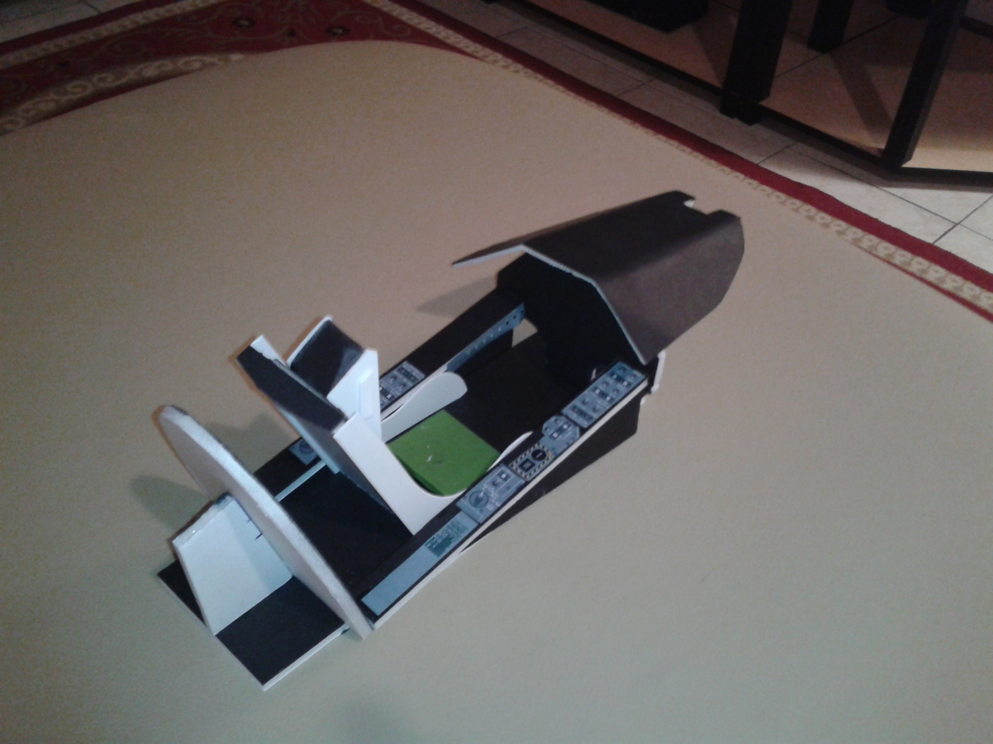

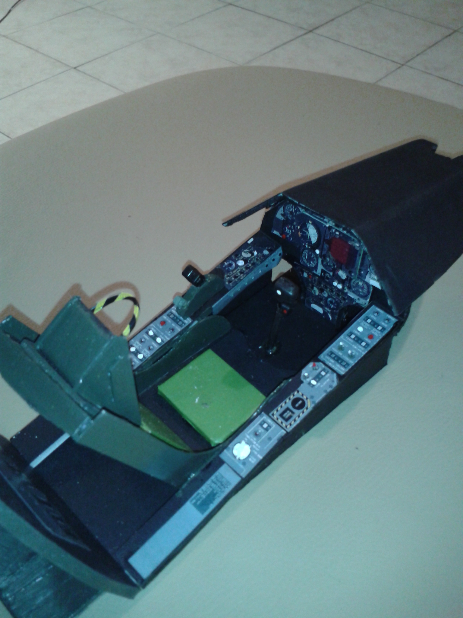

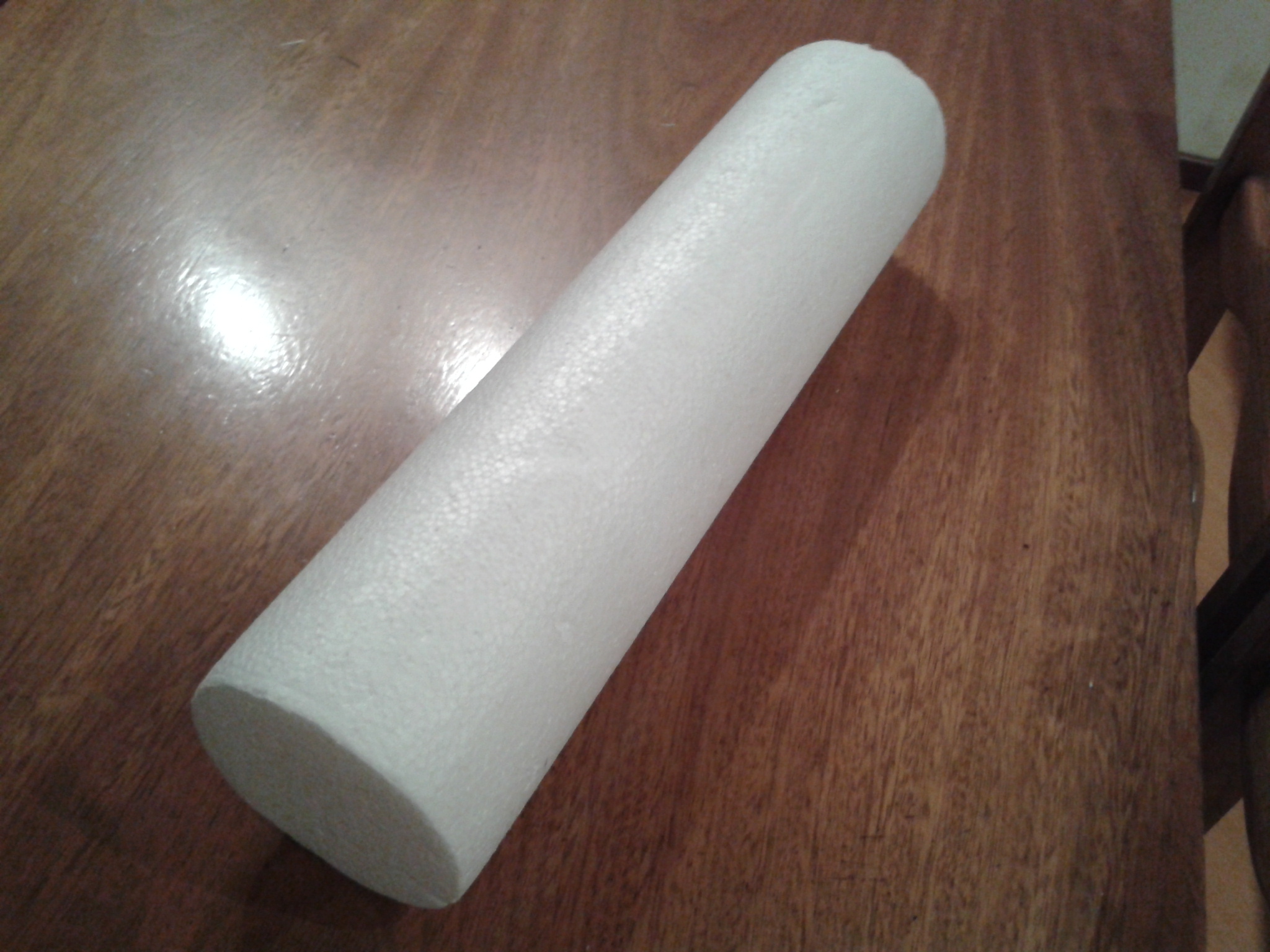

And talking about the wing tanks they are huge compared to the size of the airframe .. 3 foot long and about 5 inches wide. found this foam cilinders in a shop and with 4 of this and a foam lathe and some fiberglass I will be able to make them.
I also bought some depron /cardboard sheets used in archictectural models and started building a cockpit. In this shop I also bought a white poliestirene sheet to make some other details, like this antena behind the cabin. I sadwiched some FG and CA glue in the assembly and it turned out well. It´s light, rigid and very quick to make.... of course having visited the full size airplane and being allowed to get into it helps to reproduce the details in the model.. this visit happened by sheer luck and was a unexpected and pleasant surprise!

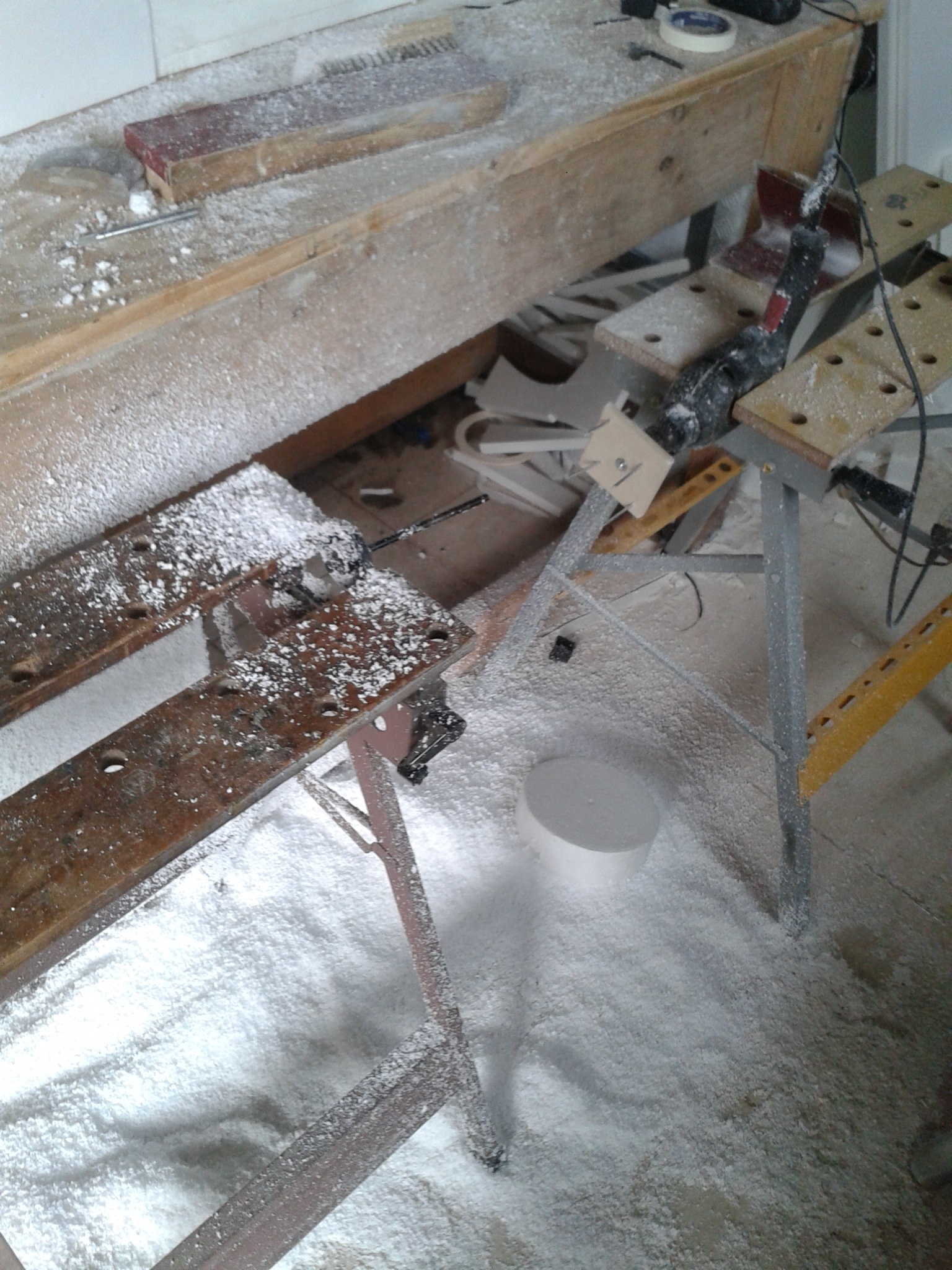

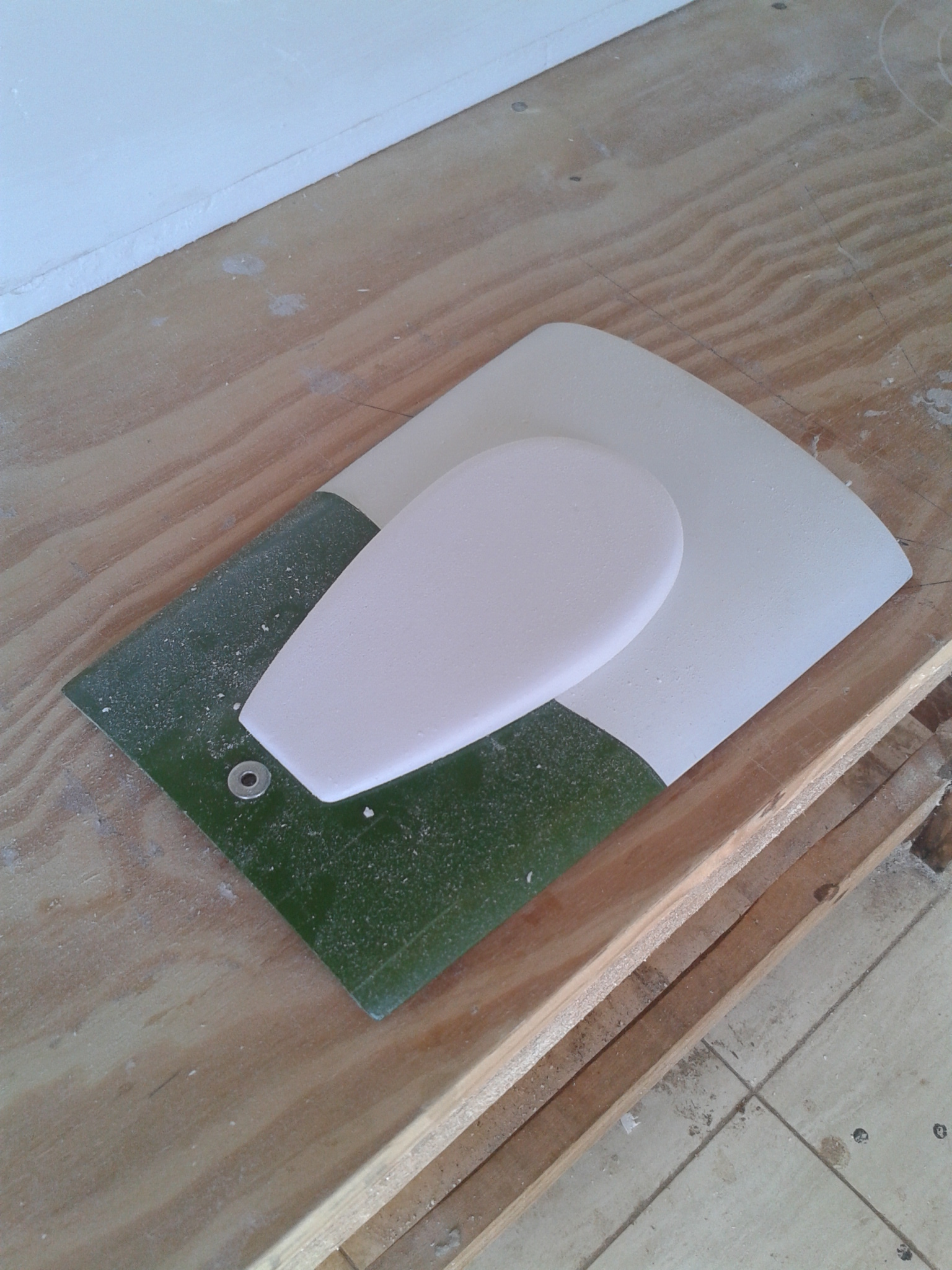

This is my foam lathe setup.. don´t do this at home if you want to keep married! Just two workbenches, a drill , a plywood square with four nails and a speed controller to keep the rpm about right to sand the foam. I started with a iron brush, then 80 and 150 grit sandpaper. Using a mask while doing this is a good idea. I worked in each half of the tanks and then I glued the two parts together.
The electronic pod also was shaped and sanded from foam.. haven´t seen it this shape but in the Argentinian jets.. All this will be fiberglassed and painted.

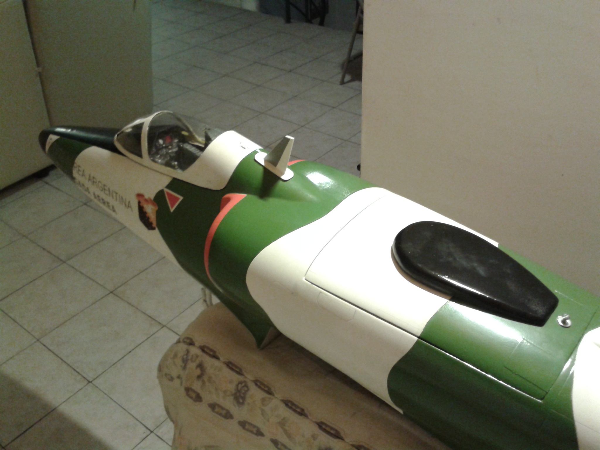

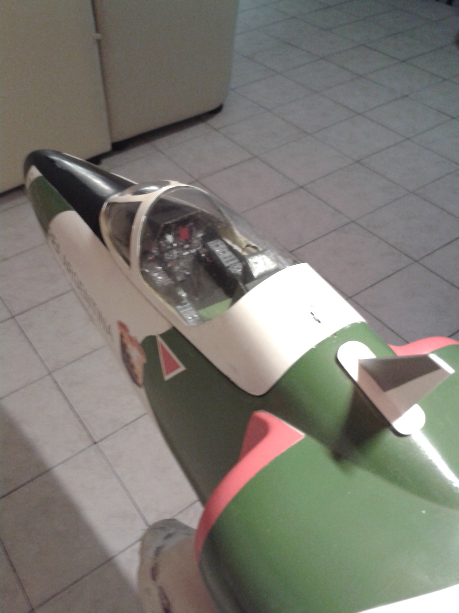

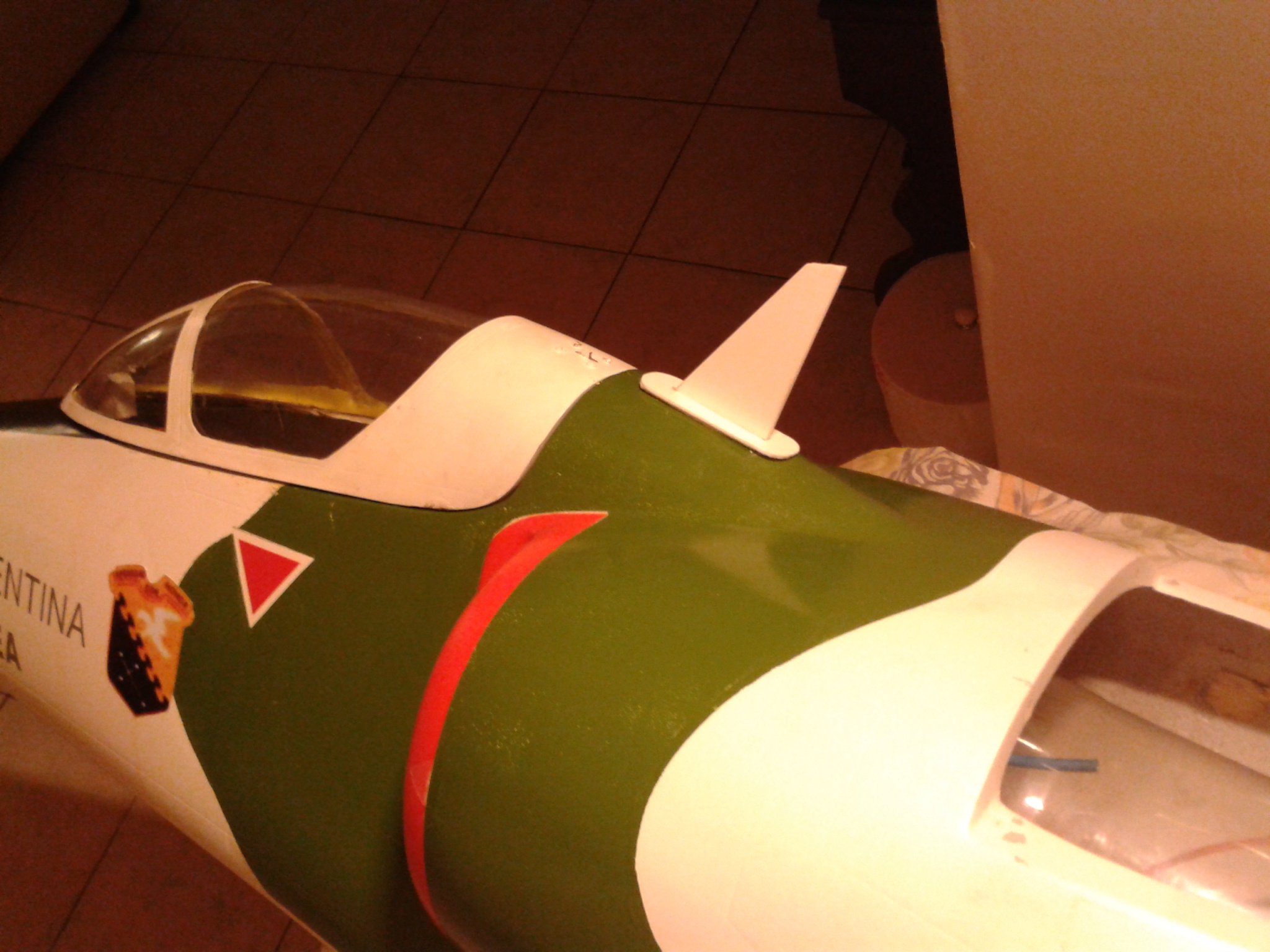

Just a very few hours of extra work this week... the ECM pod was glassed and painted but not with epoxy, but with water based poliurethane wood finish and CA glue.. seems that is easier and less messier than working with epoxy and the results seem good.
The tail hook was made of a tube of aluminum and some balsa.. and some more cockpit work: The panels and dashboard looked flat, until I glued some short pieces of a paperclip imitating switches with a small blob of white or red paint at the tip of them. My biggest accomplishment was using zip ties with shrink tube for the control stick, throttle and ejection seat handles.(!)
Lots of fun doing this at my mancave in a lazy, rainy saturday....

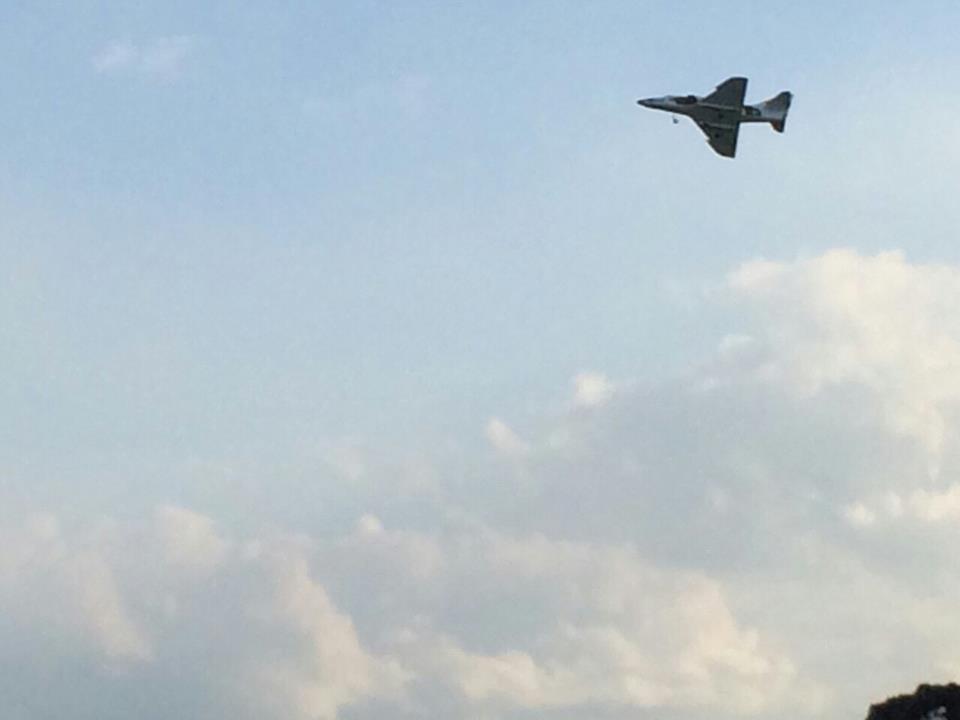

A miracle happened, A sunny saturday in Curitiba! Took the A4 for a flight and burned some kero, and a friend recorded a takeoff and took a pic of this plane.. it was a fun day.

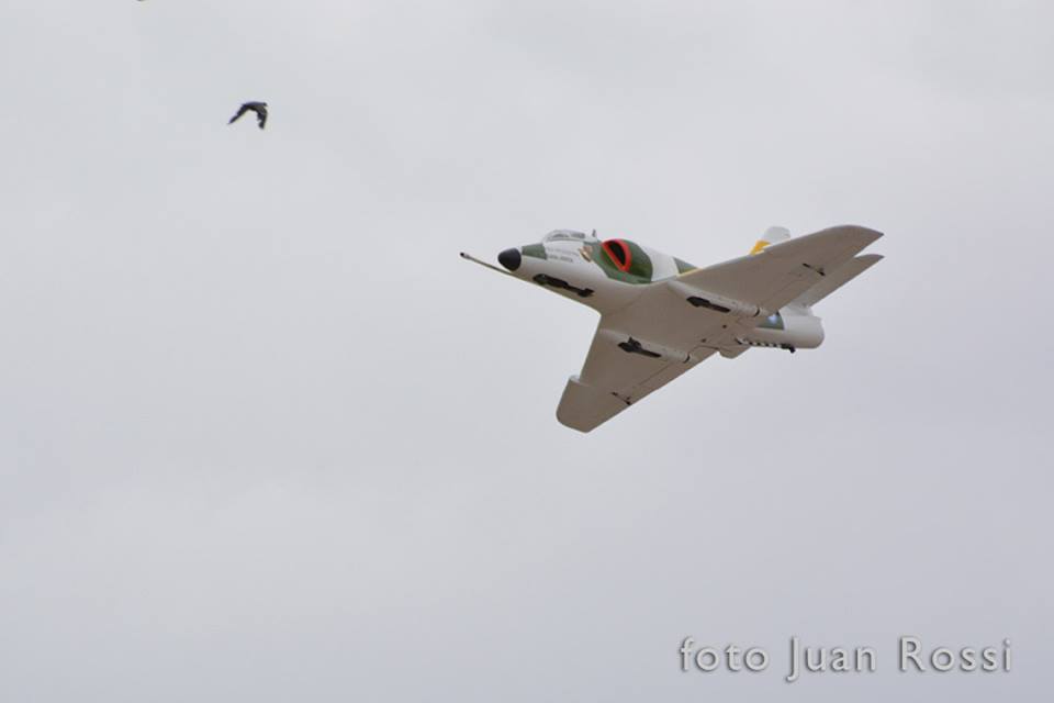

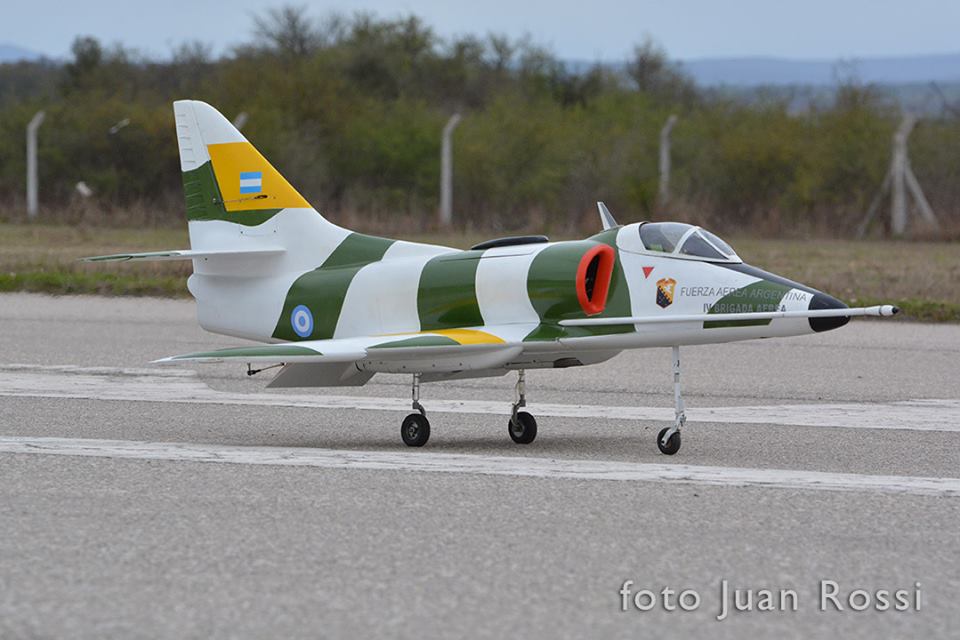

Flew the A4 in Argentina last weekend.. a 5.000 Km round trip from home but well worth it! The small guy flew very well and also a unexpected meet with war veterans who where very interested in the plane and in the sound of the turbine engine.. it was supposed to be a short stop a the museum after the jet event, but met this guys and the war stories where a must to hear.. it was a great evening of flights and talks.. guess that this long road trip is one of the best I made... now I am back in Brazil , a tired but happy man! :-)
