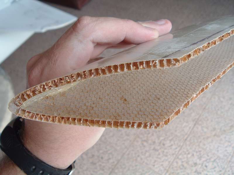

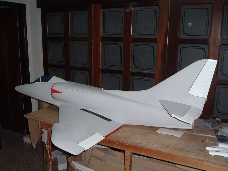

Well guys, this is a new experiment. This is a 7 years old A-4 Skyhawk molded in honeycomb...
done by a Brazilian guy living in Miami . The problem with this kit, as far as I know, is
that it has the nasty habit of snapping at take off. ( the 2 other kits built here in Curitiba where lost
in the first flight) , so the original owner lost interest on it...

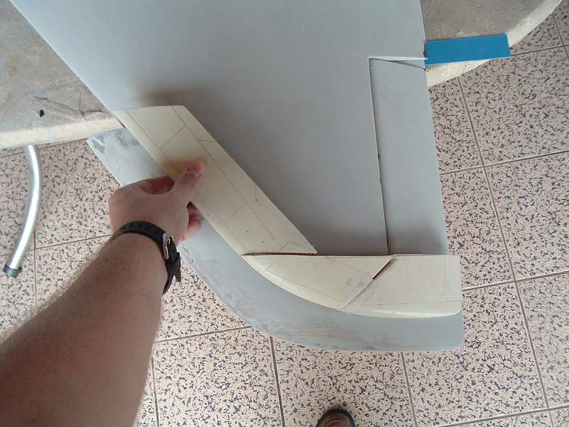

Having witnessed both crashes, I thought that it deserves a chance, as long some mods where built
on it. The problem is that I really like the A-4 ,and I want to stay as close as possible to the original ,
without changing too much its looks.
The full scale A-4 didn´t have this tip stall tendency at all written in the history books, I think that the
slats where part responsible for this, so I drawed a fixed slat / leading edge drop on the scale wing.
Mr.Patake worked so fast on it that I didn´t have pics of the early opened wing structure... also the
horizontal estabilizer where slightly enlarged too.
Let´s see what will happen with this scooter!

Great Idea, but it looks to me that you might have gone a little overboard in the size. It seems that it should have been about half of what you added. Being too large with the wingtip extensions will cause some other adverse affects, like stalls at the root of the wing and poor aileron response. I guess first flight will demo this to you

Tschuy, That's exactly what I want, the root of the wing stalling first! about the aleiron response i am not very concerned, 'cause the original A-4 has a outstanding
roll rate, and in my mind this mod didn't reduced at all the aleiron effectiveness.

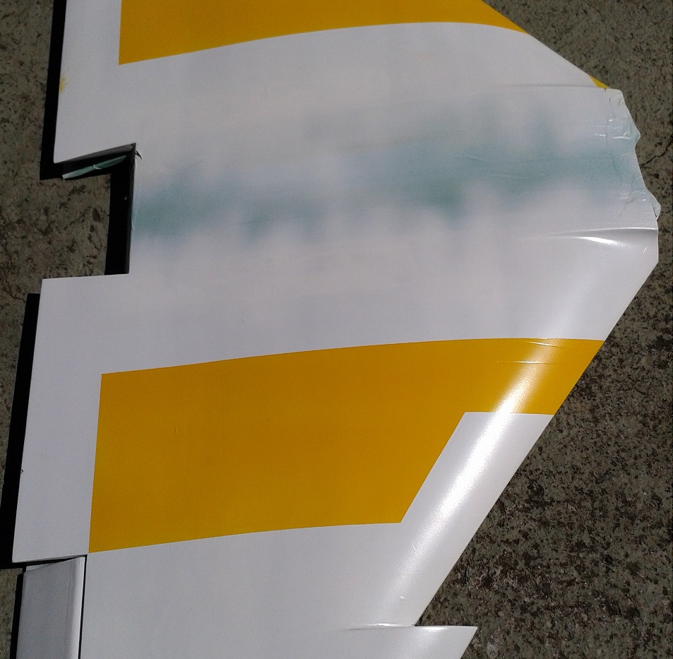

Painting done.... funny how after so much work and guessing about it's colors it looked not very different from the primer stage. don't know what I will do now with the decals, perhaps
plotter cut vinyl markings, painted with a stencil or perhaps promark ones... read some years ago
in a magazine about a computer printer material that makes water decals. did somebody
has any experience with it? any input will be appreciated. thx.

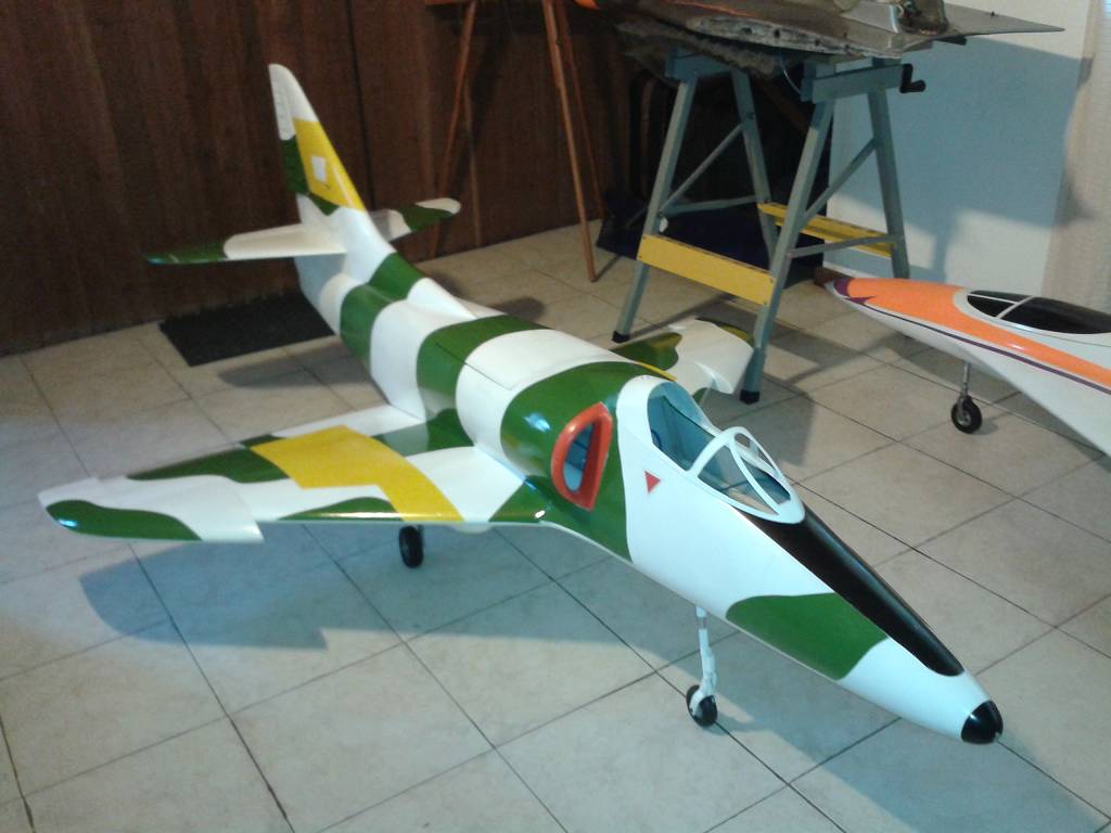

Painted this weekend the tactical bands.. this was used in the Falklands war as a way of avoiding friendly fire with Argentina´s flak. I am using them as visibility aid too! I feel somewhat proud for doing them without peeling out the white paint while removing the tape mask, lol.

Getting it together.. masking the camo and matching the color wasn´t easy, even if it is a sport scale job. The good thing of not having a lot of painting skills is that the airplane already looks realistic, with many battle scars!

On its feet for the first time and some rigging added.. I also departed from the "scale" offset landing gear to reduce the torsion loads in the main legs.
