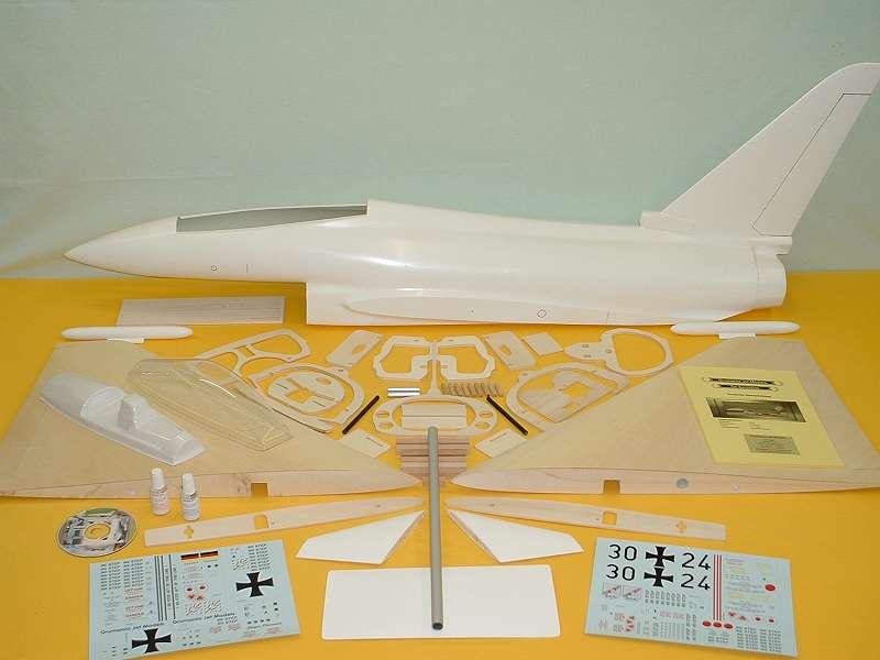

I will be interested to know if a 1,5 liter tank make sence with my "small" WREN 44 or if it is really too much ! ( I like long flight without the stress of the dry tank crash !).
-->So, are there some Eurofighter users who use more than 1Litter tanks ? what flying time do you gets ?

RE: Grumania Eurofighter.
i will let you into a little secret.
I flew my Eurofighter with Futaba 3001 Servos 1 per taileron and 1 on tha canard.
I never had any problem at all with it, and that was with a 54 MK3.
The model weighed around 6.8 kilo all up as i recall.
1Ltre tank is all you need.
Paul

#53
Join Date: Oct 2003
Location: PARIS, FRANCE, METROPOLITAN
Posts: 115
Thanks Paul for the secret !
6.8 kg ALL UP means WITH fuel or Dry weight ?
What flying time did you have with 1 litter (flying time means time before landing with still enough kerozene in the tank for security)

So, since everybody seems to say that 1 litter is enough and that I don't need 1,5 litter, does anyone can recommand a tank, that has the same round shape than a 1,5 litter coke (as as light if possible), but just less long. I
ndeed, the formers are made for a round coke bottle, but the coke bottle is a little too long and hit the front of the turbine (plus I feel that a slightely stronger plastic than the coke plastic will be safer).
thanks

Did you say you managed to fit a Two-Litre tank in yours.
My current Boomerang flies for about eight minutes on two litres with the same wren 54 mk 3 that you have.I would have liked a Two-Litre tank in the Eurofighter. (if I ever get started.)How did you manage it.
Regards. peterbrown.U.K.

No, i had a WREN 54 in mine and used a 1.5ltr coke bottle.
This was fine for about 5mins run.
I had no header just an Orbit type clunk avaialable from Dave at Motors and Rotors.
Paul
Paul

Very much inspired by Paul Gray's comments in this thread I have purchased my own Grumania Eurofighter.The whole kit is of the highest quality and this includes the accessories including the tailpipipe and the previous mentioned retracts which are indeed Jet-1A.The manufacturer Ilja Grum is a super guy and very helpful over the smallest detail.
My only problem was the packaging and handling by D.H.L. who completely ruined the fibreglass fuselage at the first attempt and after three months of negotiation a second fuselage arived with the fin broken.At this point I cut my losses and repaired the fin.I should be interested to see how you get on??
The kit is a builder's dream but not for the ARTF boys.It includes a CD of build photos which are very helpful. My progress is quite slow as I have decided to build in a working scale airbrake which has slowed down the build process.Also I have only one Engine a Wren 54 Mk-3 and so to complete the Eurofighter I will need to de-commission my trusty Bommerang Intro.
I have lots of build photos already but am not too sure how to attach them to this message. I will try.(N.B. Have tried but cannot achieve transfer)However will be happy to e-mail to you direct if you wish.
Regards. Peter.
