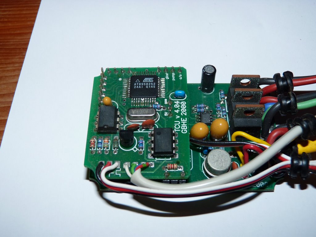

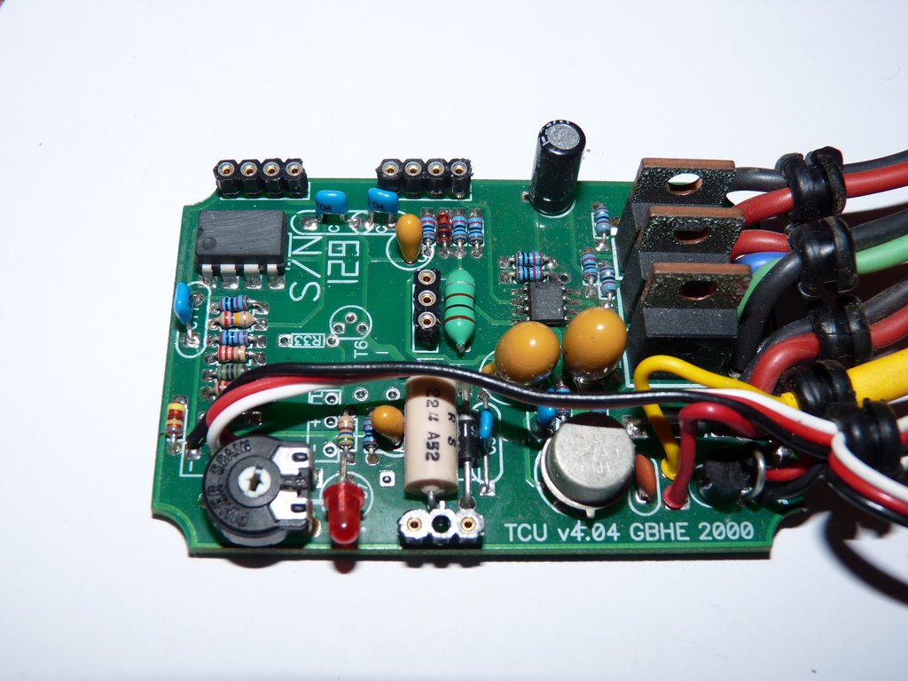

Hi Xairflyer and everyone else who has tried tried to help
yes the pump will run when power applied directly from battery,and also by the ecu when in prime mode
thanks for the info regarding the O ring, I think a stripdown and rebuild is probably in order to answer a few questions i have regarding the update state (if any of the components) at least the bearings feel good !!!
here are some pics of the ecu boards
many thanks Adam
many thanks Adam

RE: JetJoe OWNERS thread
Pictures are not getting bigger when you click on them.
If the pump will run when in prime mode then, the ecu itself is probably ok in regard to powering the pump.
Can you post your ecu settings.

Hi Xairflyer
the ECU settings
Ramping values,
Ramp switch low = 25
Ramp switch Hi = 80
Ramp up lo = 6
Ramp down lo = 6
Ramp up mid = 4
Ramp down mid = 4
Ramp up Hi = 4
Ramp down Hi = 4
Start allowed Revs = 7
Start allowed EGT =100
Adjust start ramp =35
Autostart = Disabled have also tried Enabled
Disengage RPM = 20
Adjust Gas off =27
Adjust Idle Rev =45
Adjust max Rev =130
Adjust shut Rev Lo = 25
Adjust shut Rev Hi =150
Adjust shut EGT Lo =250
Adjust high hold EGT = 650
Adjust shut EGT = 800
Physical values
Glo driver = 200
Pulses/Rev value = 1
Start Enable = Not Ready
Shut down data Rev = 20,000 Egt = 248 c

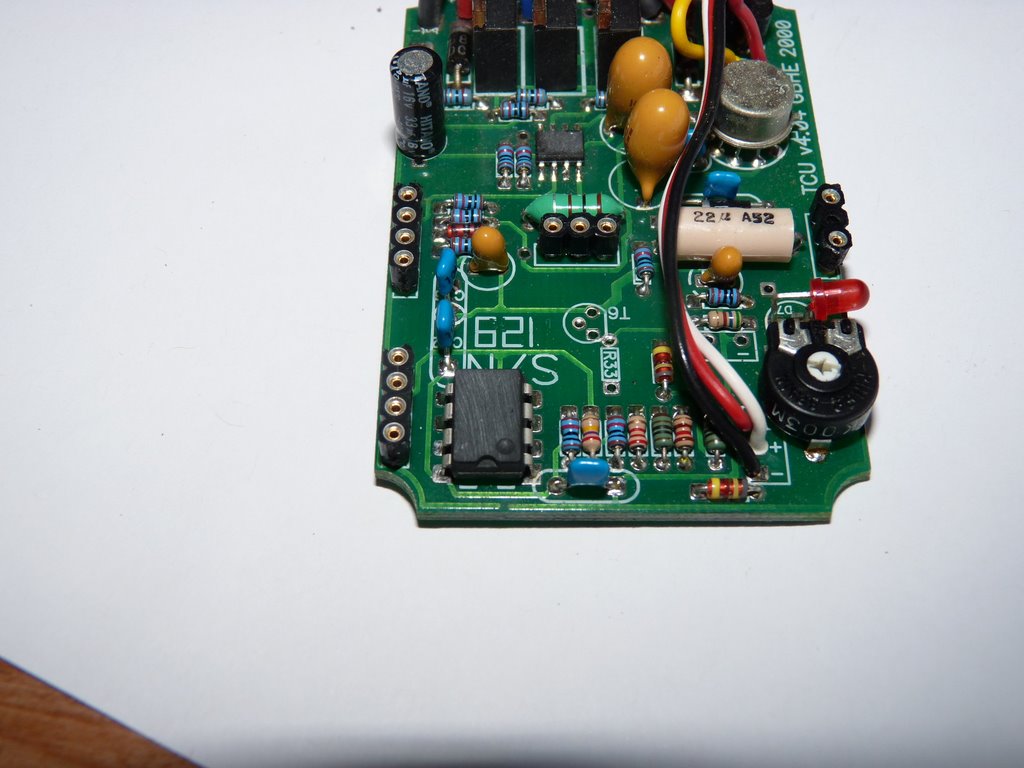

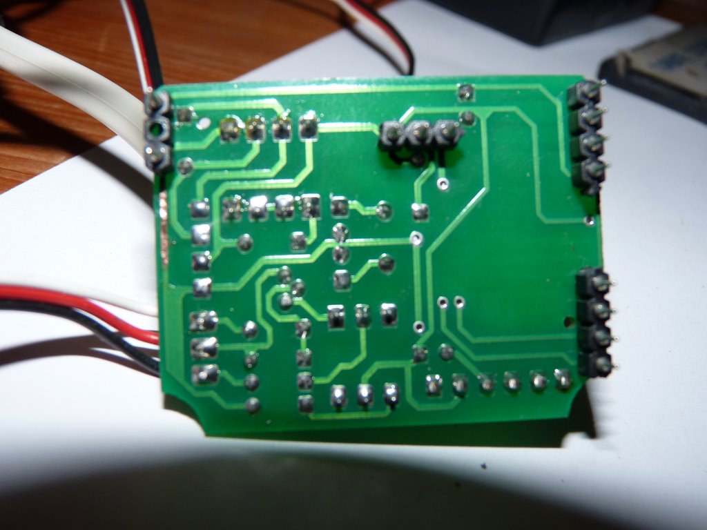

and hope fully here are larger ECU board pics
many thanks Adam
Difficult to know with those settings on that ECU, there must be someone else using that ECU try posting a question on the main jets forum about the GB hobbies ECU.
Nothing though looks that wrong, other than you want to keep it on auotstart, and what is start enable=not ready, can that be changed.
If it is not an ECU problem then going back to the burnt track is the suspicious one.
Might be an idea to pick yourself up a Gasper ECU
