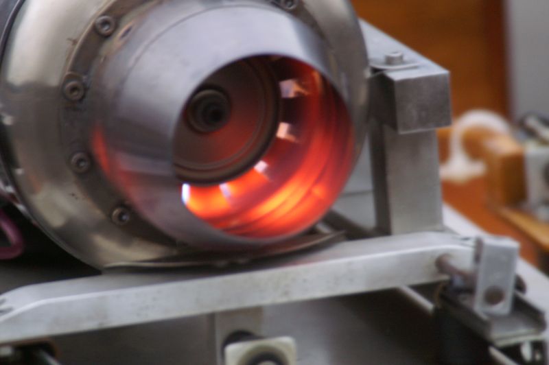

Hey All,
I've finally got off my fat arse and uploaded the video to Youtube of my JJ1800's first test run with afterburner, hope you enjoy, i'll hopefully have a more indepth video coming soon which explains all the "gubbins" attached to my setup etc... You'll notice I'm continually looking at and monitoring the EGT, maybe I'm just paranoid[X(]
From what I understand it may be the very first JetJoe engine which has been fitted with an afterburner, as usual, I stand corrected though
http://www.youtube.com/watch?v=0e_lJJCG5WM

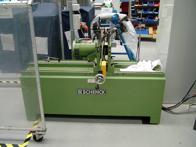

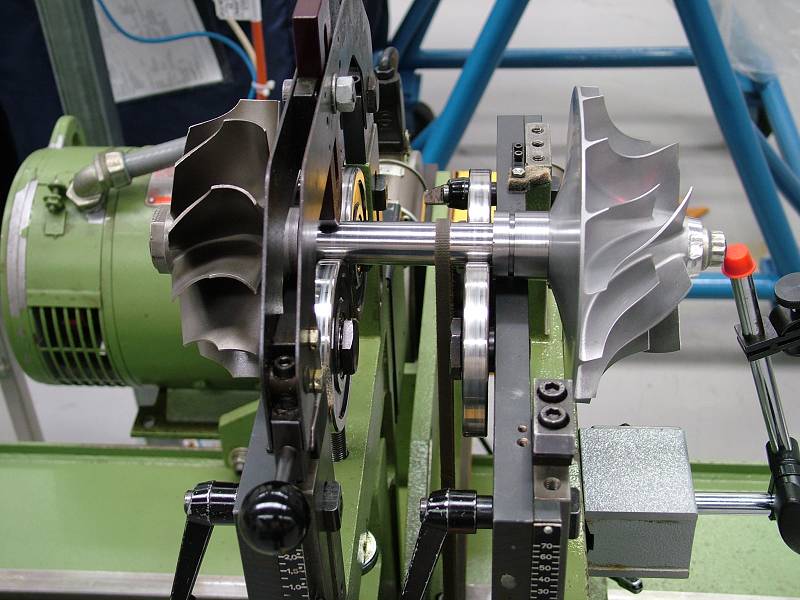

Hi Jose,
The JetJoe electronic balancer is fine for the home miniature turbine builder, however, for serious service work and commercial balancing I feel it's accuracy isn't up to the standard required.
Don't get me wrong, the JJ balancer works fine, I find I can get down to very small dual plane increments with the "Schenck" machine I have access to..... whereas the JetJoe balancer has only a single plane system. Here's a pic or two of my Schenck machine.
Hope this helps,

Hi Jose,
Yes, the JJ balancer will be fine for what you wish to use it for, and yes, I believe the rotor assembly should be balanced every time it is dis-assembled. Be sure to check it two or three times to get an average and for consistancy, sometimes even large changes in temperature can affect the balance readings depending on the machine used.
I find our balance machine shows minor variations when a heavy truck passes by the workshop...!! Crazy but true!

Nice video. Those short plumes are a little astonishing. What's causing them ? Residual fuel is burnt after "injection" ?
Do you think that sustained operation ( # 10 sec ) is feasible ?
I'm no AB expert but the flame shape at low RPMs makes me think injection is sub-optimal at this point. Compared to real size turbine engines, flame shape is radically different. HIgher RPMs produce a better looking flame shape. I think there's still some optimizing margin in that area.

ORIGINAL: Strykaas
Hey Strykaas,
What you say is exactly correct, I expect it is "residual fuel" in the lines and spray ring. There is still a lot of development work to do, this was one of the very first test runs so I expected some shortcomings. The low rpm stuff which is what you mostly see on the video shows a less than optimal combustion, Jet dragsters predominantly use this as a "fire show".... as higher rpms are approached the shape and burn of the fuel is much better, more of a shortish blue coloured flame rather than a messy orange one, it's rather hard to see the "good" flame in the bright sunlight though, however, the ignition of the fuel at higher rpms is also less than optimal and is still a bit erratic. I believe a burst of 10secs or so isn't out of the question, mind you the amount of fuel consumed is enormous, so you'd need to carry quite a good supply...that little 3 min run on the video consumed just under a liter of fuel through the A/B...[X(] plus what the engine itself used.
I still have to sort the fuel burn quantaties as well so more work is needed in that area, I expect in a month or two, some tinkering and fine tuning she should be making all the right noises, then i'll post a decent video of it running at it's best, I should do a night time run too, that'll be interesting to say the least!

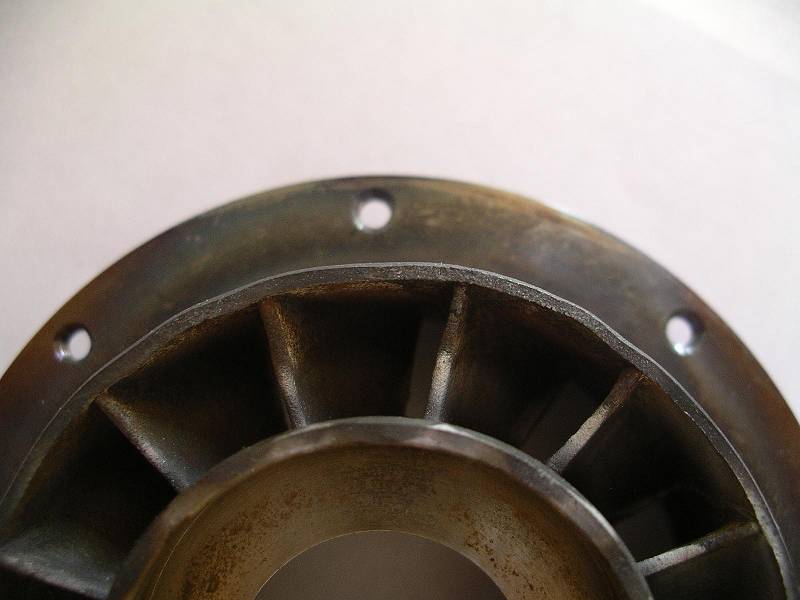

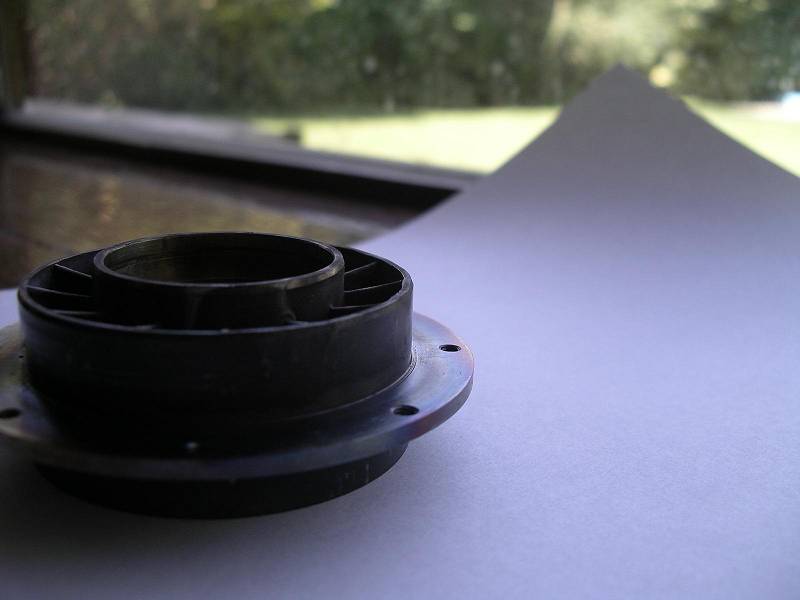

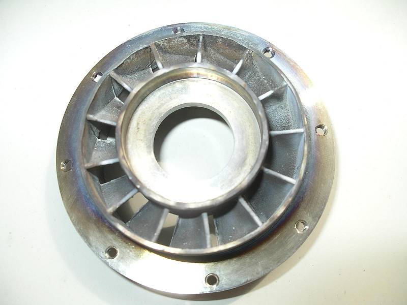

Hi to All...
Here I am again...with more problems :S
After a few flies yesterday I noticed one side of the cone (the one that has the thermocouple) warmer than the other parts of the cone....the turbine had problems to acelerate because it was very warmed and the pump didnt pump...I had to take the thermocouple practically out to get 680°C...so I decided to disassemble it...
I found that the NGV was over heated with some parts deformed as you can see in the pictures.
I revised the CC but I didnt find nothing extrange...the CC is new. I tested the ring with gas and all the injectors it seems to has the same caudal.
What do you think about that? Wich could be the problem?
Hope you can help me!!!

Default RE: JetJoe OWNERS thread
Looks like the ngv may have a crack in it your dealer should be able to fix it.
looks to me like you allowed fuel to accumulate in the CC and burn with the turbine not spinning or the result of a hot start (or post crash) that wasn't extinguished in a timely fashion.

Hi!
Thanks for your response!
KC36330..
The turbine runs everytime over heated in that side of the cone...this problem is not only in the start procedure
fw190pilot..
I thought that...I believe that it could be a factiry problem in the NGV
OTH...the NGV doesnt fit ok in the CC because the deformation...I think that if the NGV was wrong from the factory maybe it can be passing the hot gas/fuel between the CC and the NGV and this cause the problem
What do you think?

Hi M,
I think more the other way around, pressure outside chamber is higher than the inside so air will only enter the CC. Still if the CC backring doesn't fit correctly it will give a hotspot over there due to uneven air distribution. I had the same on one of my KJ's where the CC outer wrapper had become slightly distorted over time where the fit to the CC rear wall outer was bad. An air gap of 0.8mm on a 1/3 circumference on the bottom of the CC made the hotspot you see on the picture. When I simply "hammered" the plating to close the gap again the hotspot was totally gone, see picture withoud the red glow. This is a homebuilt engine so I can do what I like, for your engine I would however try to make the company fix it......
Rgds,

Hi Gerald!
I measured the CC and the NGV..there is a difference of 0.8 milimeters in the diameter in some parts...so if the CC is not centered correctly I can have the 0.8 mm in one side :S:S:S:S
I measured the two CC, both has the same difference..I think it is too much gap, what do you think??
Thanks!
