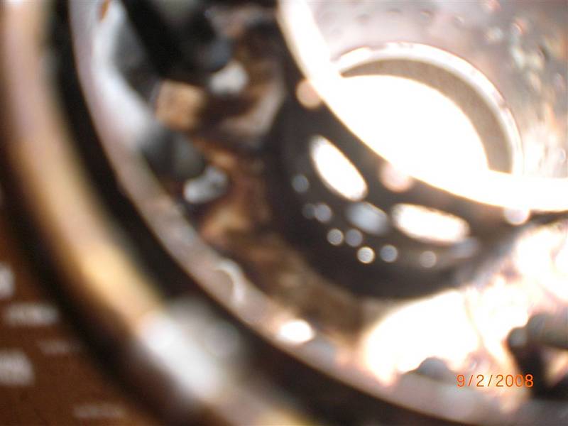

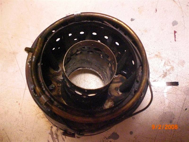

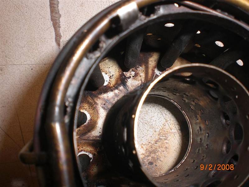

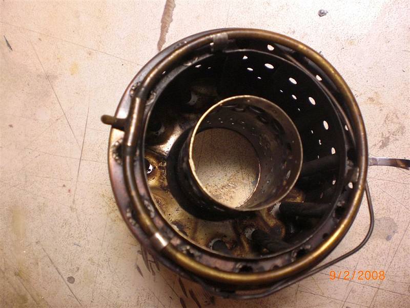

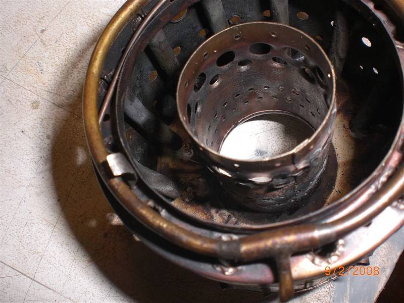

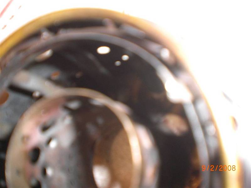

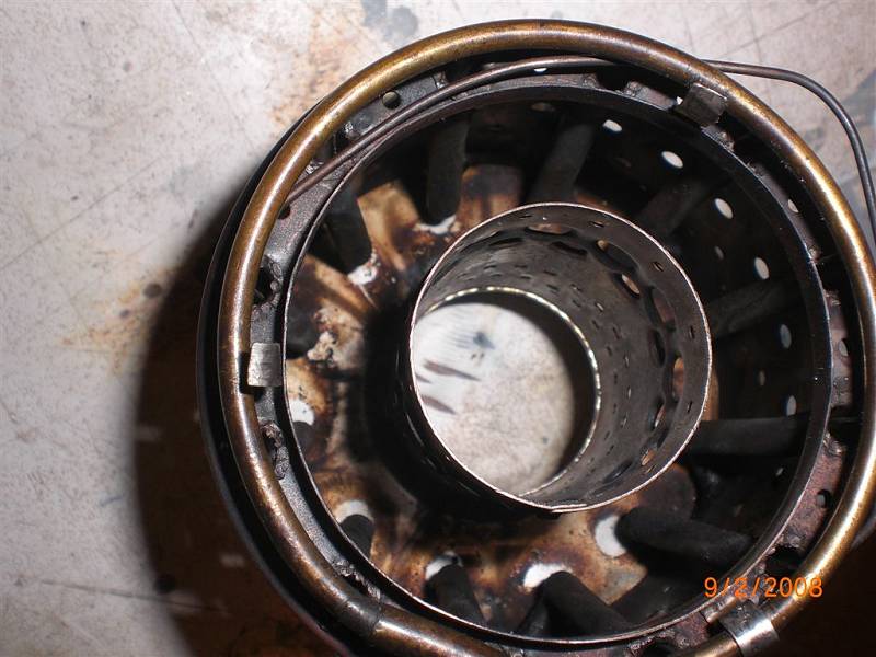

Hi everyone,
Attached you can see the photos of the combustion chamber of my JJ1400. I am experienceing high temp problem at high RPMs particularly after 130K. I have checked everything: 1. Balance is perfect 2. vaporizer tubes tested with propane not much difference 3. Startup perfect temp not over 450-500 C. 4. Bearing conditions are OK. 5. Compressor clearance is even perfected with sheets of hysol layers.
So I believe there is only one problem left: Poor vaporisation!... Am I correct?.. I see that the vaporiser tubes are way too short and away from the combustion front cover..I would appreciate some input. Can I find vaporiser tube circle similar to MW 54 ?. Does anyone have spares or any contact for supplying?.

I have a JJ1400 which is still under guaranty but i want to improve it (make it usable ) Photo's can be found here : http://sharepoint.ccme.nl/Fotos/Modelbouw/JetJoe%201400
What i did / am going to do:
- Fix the fuel ring. It does not burn that well. 2 needles burn very badly and 1 does not burn at all! (FIXED)
- Replace bearings. The rear GRW is ok but the front is imitation. Both will be replaced by high quality bearings (should be even better then grw) (ORDERED)
- Alter the sticks. Good sticks have "dents" in it to slow the fuel flow and vaporise better. (TODO)
The fuel ring wasn't that much of a problem. I heated the ring to melt the solder and than put a compressor on it to clear the path. Burns much better now. 1 stick burns a bit less but should be enough for now. Egt should drop a bit now.
The front bearing does not run that nice as the rear grw bearing. It had a bit more drag and better bearings should help to reduce the egt a bit.
Sticks with dents should help for better accelleration and better mixing of air and fuel. It also should bring the flame more to the front of the cc which helps to save the ngv.
Other valves are needed because the supplied valves sometimes hang. A small tick on them closes them correctly. For testing now it is ok. Start motor cluch is very very bad. No system to lock in place. It has also touched the compressor nut while running.

Hi,
I ordered a pair of these : http://jmprecision.co.uk/shopping/pg...&=SID#MOREINFO
Price is awsome and the say 172K should be ok. I will test them against the stock bearings.
I did a test run with the modified CC and left the cone off to get a better look inside the engine. I could not believe the egt. Only 440 at idle. very low during startup also. Engine behaved normal. I heard a little rubbing so i did not go above 70K. Egt rose to 480 max! Does the cone have so much to do with the egt or is it my modification that lowered the egt? Maybe the cone can be altered to lower the egt......
Tonight i run again with cone (and without rubbing i hope). I could not see any rubbing after the last run.....
