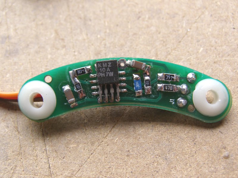

Hmmmm... major bummer. I think I have succumbed to the dreaded "JetJoe - your RPM sensor is knackered" syndrome. How easy are these things to swap out?
I have a brand new JJ-3000 Turbine (assumingly 'factory tested') and it just refuses to fire. All goes well on initial start-up - Starter kicks in, Propane goes *pop*...then she winds back down again. Stick and Trim are calibrated as per the instructions.
But I've noticed that the RPM on the 'Monitor' was always ZERO. Having read other threads, even if you spin the engine with a hair-dryer, you should see the RPM read at least something - but nada. I see all the other prompts on the read-out - it goes 'Ready'... 'Glowplug Test'... etc... whizzz.. *pop*....dies.
I've re-routed all my wiring, and twitched all high-current leads together, moved everything well away from the RPM sensor wires, and still nothing. No read-out whatsoever regarding RPM - I think I should be seeing it at least advance a couple of thousand RPM once the starter kicks in. But nup - jack she-ite. Maybe it's the FADEC - but then it wouldn't go through the start-up sequence, open the Propane, juice the plug and 'light off', would it? The Propane definitely ignites...I can hear it, and feel the heat afterwards. But no RPM readings anywhere along the line.
The 'Combo' I've got is running a 'genuine' JetJoe fuel pump (blue thing - 20mm diam by about 50mm tall), Regal FADEC, and JetJoe solenoids (brass fitting, yellow windings). Fuel pump/solenoid work coz I've managed to purge the kero lines no problems.
What is s a bit discrening however is that I noticed that the Propane solenoid doesn't always shut-off properly (dead 'Bad Start', close the gas valve, and when I turn the bottle valve back on, I can hear the gas injecting into the Turbine - no real worries for me, as I manually control the main gas valve anyways). I have that timing right, coz as soon as she tries to spin up, I open the the bottle valve and she lights. It worries me a little that the Propane solenoid can open (or stays open) before the FADEC calls for it. No big deal just yet, as the whole thing is on a test bench and being fired out in the open- I'd hate to think an airframe was filling with Propane before I initiate the start sequence - any aircraft with a belly full of Propane is gonna go ~POOM~ when the glowplug kicks in.
I've checked and double-checked my wiring etc. It's all 'by the book' so far...
Any ideas?

Thanks id3m - I've thought about doing that, but I wasn't sure if I'd end up 'busting' something - not so much the Turbine, but maybe the FADEC? Some things like Solenoids etc don't really care about which what the current comes in - if it's there, they actuate. If it's not, they don't.
But, from reading around the traps, there's a few "do's", and a lot of "DONT's" when it comes to the FADEC. Like short the glowplug lead on a JJ, and the FADEC becomes a fancy and light paper-weight pretty quickly. Not knocking those that make FADECS, but surely there's a few electronic 'tricks' around these days that could bullet-proof a shorted lead. It ain't exactly rocket science.
Back to the RPM Sensor - it's basically a magnet that spins on the rotor shaft across a 'Hall Effect transistor', right? Regardless of what it is inside the beastie, there must be something I can do with an 'Industrial Grade' multi-meter that can at least hint to me whether that thing is working or not. Granted, I know I'm not getting a read-out on my monitor, but that doesn't necessarily mean that the Sensor is stuffed. Maybe there's some resistances I could check....?
BJ

Very easy to take front cover off and check rpm sensor, normally if it reads zero then it is plugged in the wrong way.

RPM sensor (banana style) is very sensitve and ANY dirt can make it stop working. I had the same problem. Take it out, take off the shrink wrap and clean it. Mine worked fine then. Also theck with another magnet. When not absolutely positioned it can misread or not read at all.
When you short the leads (glow / starter) on the fadec you can repair it yourself The fadec has a thin wire strip on the surface which acts like a fuse. When you shortout the leads (done that myself) the fuses burns and protects the circuits. Just open the fadec and theck for any burned traces (fuse trace is on the side). I have another fadec with damaged to the fuse trace also due to a bad starter motor.....

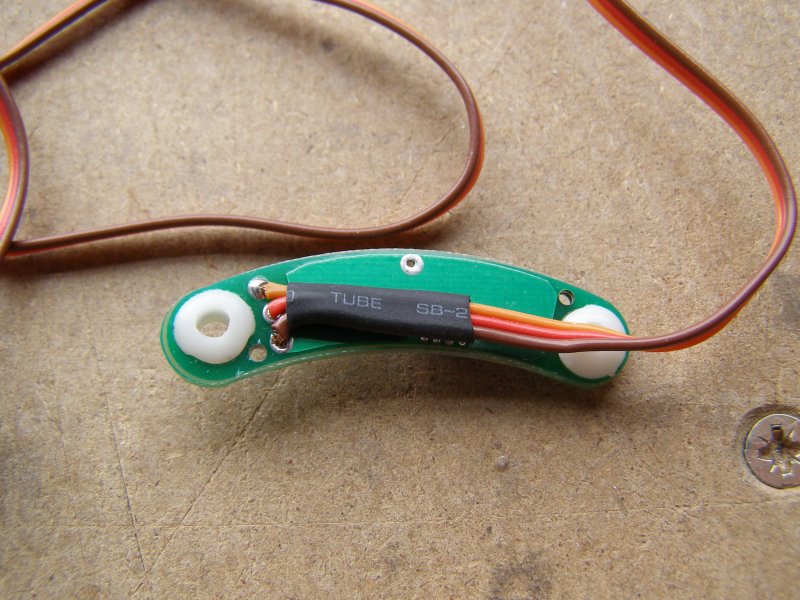

I have the gasper ECU and the rpm sensor can be plugged in the both ways, the label shows the colors ok but it still can be done.
Another thing I thought about is, it is very easy on the gasper ECU to mix up the EGT and RPM positions on the ECU as one is above the other and depends on which way you look at the label. Same goes for the fuel and gas valve as I had these the wrong way around myself in the early days. Maybe the regal ecu is more clear.

I took the heatshrink off my spare RPM sensor and took some pics so you can check the wiring etc.
You would probably be quicker to get a replacement if needed from [link=http://www.xicoy.com/catalog/product_info.php?cPath=22_25&products_id=73]Xicoy-Gasper[/link] only about 20 euro

The Regal FADEC is pretty straight forward where things have to be plugged in. I've checked and double-checked everything, and it all looks like it's in the right place.
I simply don't get any RPM readout on the Monitor - I get the 'Lo Stick!', 'Glowplug Test', 'Start' messages, the starter kicks in, the Propane lights, and then it dies in the @rse. I kept a close eye on the RPM readout during startup, and it never budged from all Zeros.
Not really sure what else to do, but I'm guessing the RPM sensor is cactus...

Hey guys - I think I've got it sussed out now
My original problem was that I had the RPM Sensor lead mixed in amongst the high-current leads to the Starter Motor and Fuel Pump. I couldn't get a decent start this way, and it was suggested to me that I was probably picking up stray RPM spikes from the high current wires.
I've now made sure all these wires were twitched together, then re-routed my RPM Sensor lead so that it was more or less out on it's own - well away from any other wiring. On my Turbine, all the leads are relatively short, so to get the RPM Sensor lead free of all the other wiring, I bought an 'extension' lead.
I've just been outside in the 'Dungeon', and rechecked everything again. The RPM Sensor extension lead that I bought has little tab on one side - just big enough to allow the RPM Sensor plug to go into the FADEC one pin too far to the left (there's *just* enough room in the FADEC socket to allow it to do this). So I flipped the connector over, and switched the other end as well so that the Brown wire on the RPM Sensor lead matched the White wire on the extension lead, and the White wire from that matched the Brown wire's pin in the FADEC.
Problem solved - I now have RPM readings again when I spun the Turbine up with the help of a little compressed air and I double-checked that I get an EGT reading from the Thermocouple as well.
Now all I have to do is wait for my balanced battery charger to arrive so that I can get some more juice into the LiPo and hopefully a NOISY start
Thank you all for your input - there's always something new we can learn.
BJ
