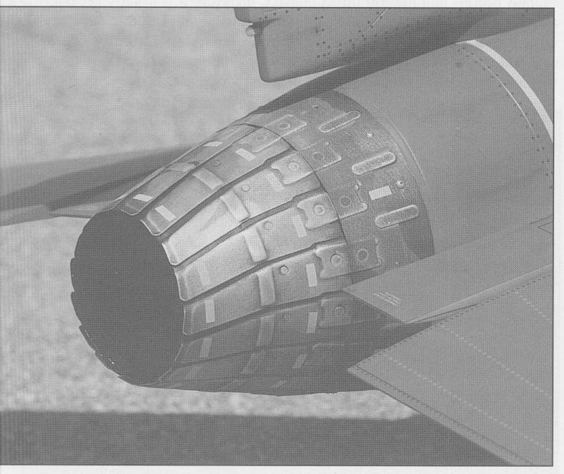

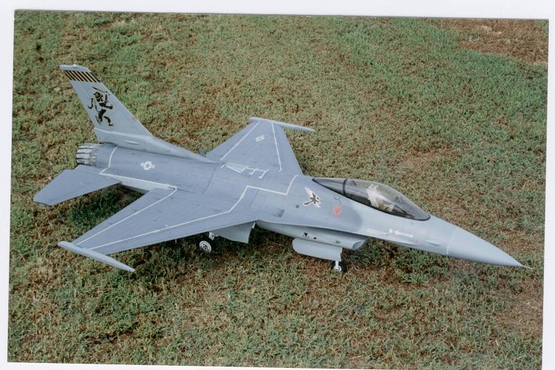

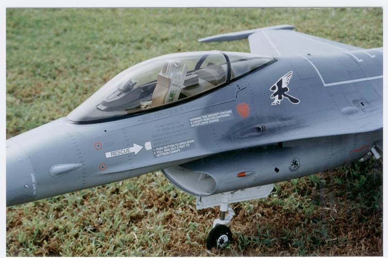

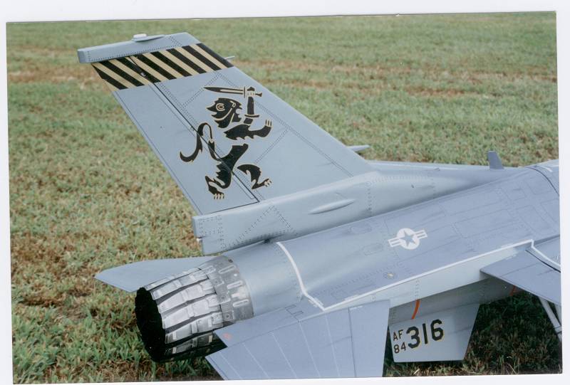

Here's a few a pics of my detailed Rozmus nozzle from Bob Fiorenze on my F-16.
The first pic is from Mike Cherry's Jet Book.
The second is a close up of the nozzle open.
The third is of the entire plane.
I could only tell a very minor difference on this D/F model with the nozzle opened or closed...
Kevin
