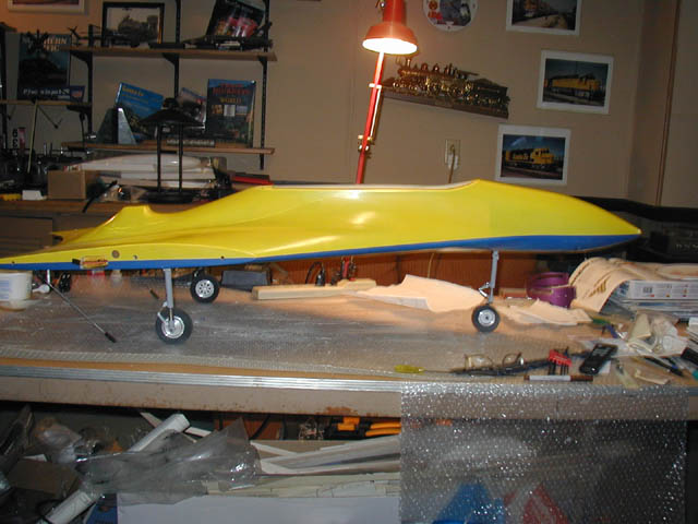

I have a Roo with the Robart retracts and Robostruts made for the Kangaroo.
It definitely sits "nose high". From the bottom of the fuse to the ground measures 7.875" (with a 2.625" Glennis nose wheel).
The Robart mains sit 6.5" from the fuse to the ground (with a 3" Glennis main wheels and brakes).
Here is a pic during construction that shows the geometry described above.
Hope that helps!

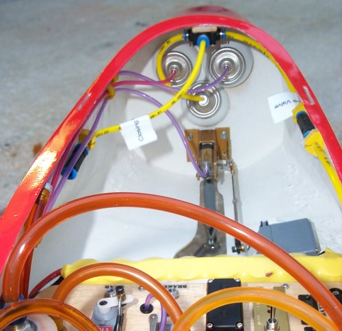

Great pic Nick, Thanks. Do you have a shot of the interior showing the nose gear mount? Either from above or below. Thanks

Evan,
Leave the springair for the nose gear! I did the same switch about 16 months ago and have been using Robart mains and springair nose for hundreds of flights....Springair is plenty strong enough for the nose and mounts easier... Also, eliminating most of that positive angle of attack on the roo will help you avoid the hops down the runway on landings...Not needed for rotation!
