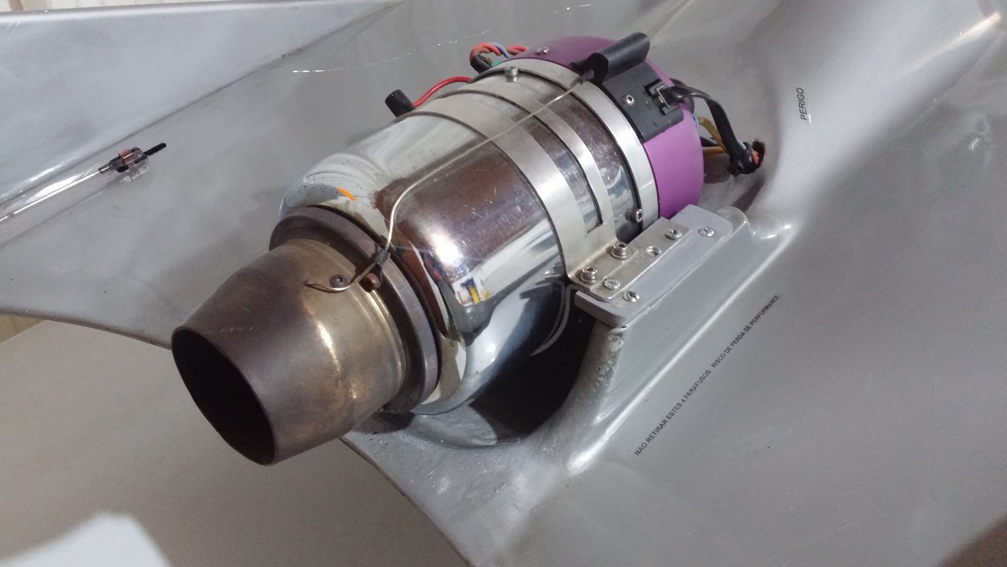

hiya buddy im stuck trying to remount my behotec j66 turbine ive lost the aluminium strap that was gripping the turbine .. so im thinking hmm maybe i should lower the thrust line and use my conventional turbine mount then that would be fine clampin onto 2x very simple blocks .. have you any pics to help me ,im not that good a builder but this might within my capabilities

when I built my kangaroo (19 years ago now holy crap) it was just a plywood curved base and the straps were nothing more than hardware store hose clamps. Never loosened up or caused any issues.

A good thing to do in the Kangaroo is lowering the turbine thrust line, opening the fuse top (like pictured above 16 years ago, yikes) and adding two blocks of reinforced balsa with plywood, using plenty of filler to do nice filets that will improve airflow and appearence. By doing this you can use a standard turbine mount on it not to mention that the plane will fly better too.
Dont worry about the extra weight doing this or even installing the turbine back a inch or two.

It has been a while, but I believe that I did it this way. I filled the bays between the ribs best I could with some light weight foam I had lying about, glued it in whilst integrating some hard wood rails for the engine mount. Then I sanded, carved, shaped to the look I wanted, a nice gentle swooping shape down under where the turbine would go. Then I glassed over it all with epoxy and filler, primed and painted. Came out great!

Pics from mine if they are of any help.. did the mod in 2004 (!)
