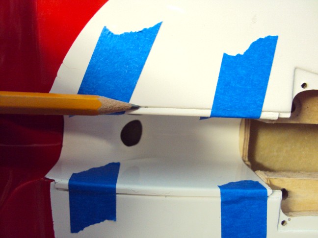

Default RE: Comp ARF Flash update
I had to grind away the rails to make it fit. Not a big deal but take your time. On one I removed too much which required a bit more work to make work. They are great gear though and a huge improvement over stock.
Old 05-26-2010, 03:12 PM
  #902
tucson
Join Date: Dec 2001
Location: tucson, AZ
Posts: 865
Thanks Cagmo,
Do you have a picture of what your install looks like?
Grinding out the mount dosn't look like that much of a problem. Forward of that area looks a little more challenging. Did you use the struct area inserts to fill the open area?
I am wondering if I don't use them air will get under the wing skin and could cause a problem.
Any opinions there?
Stan
Old 05-26-2010, 03:55 PM
  #903
cagmo
My Feedback: (118)
Join Date: Apr 2004
Location: Fort Collins, CO
Posts: 93
I did use the inserts (w/o the cover for the strut). It's tight but can be done. I ground the rails rearward (away from the strut opening) to make it fit...almost to the former in the nose if I recall. The wings...same thing...grind rearward towards rib. Sorry no pics...the Flash is cozy in the trailer. I can take some this weekend at the filed if you can wait.

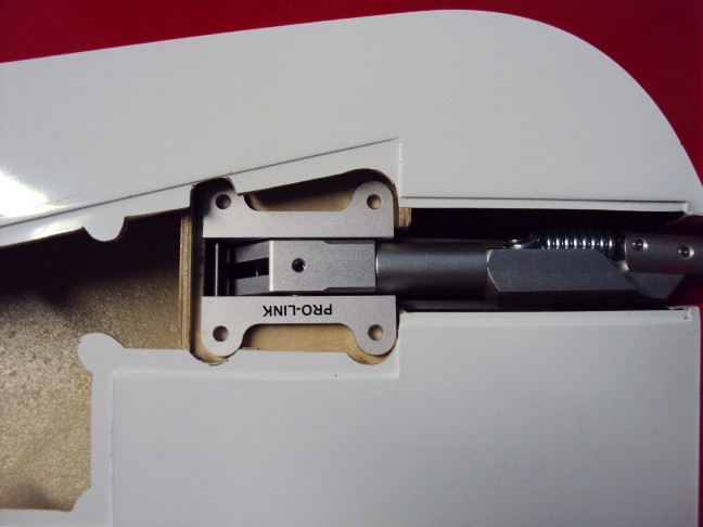

Old 05-26-2010, 04:58 PM
  #905
tucson
Join Date: Dec 2001
Posts: 865
Thanks Cagmo and Phjoker,
I don't think I will need your picture. Phjoker's picture shows using balsa wood to fill the gap, that looks like a good fix and easy to do.
It looks like my grinding as you suggested on the rails will be away from the wheel opening.
Were your structs straight, mine have a slight angle to them. this will not help.
Stan
Old 05-26-2010, 05:23 PM
  #906
Mavrik!
Join Date: Apr 2008
Location: Sydney, AUSTRALIA
Posts: 599
Stan,
I have the digitec struts and they also have a very slight bend. It is very fiddly and takes time, grinding and patience, but they will fit (tight) in the end! I used the covers.
Mav

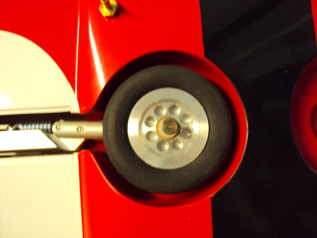

Old 05-27-2010, 08:19 AM
  #908
rcdoug
My Feedback: (8)
Join Date: Oct 2002
Location: Bakersfield, CA
Posts: 215
Stan, the stock inserts will fit. Photos below.
Doug

Old 05-27-2010, 11:20 AM
  #909
tucson
Join Date: Dec 2001
Posts: 865
Thanks Doug,
A picture is worth a thousand words. That's what I will do..
Stan
