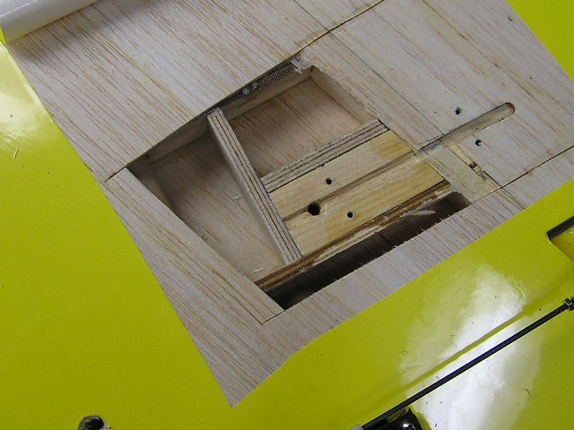

It'll be a while before I'm ready to fly mine. Although I have made some progress. I received my real Bobcat XL back from the painter and am doing the installation on that so it has slowed down the work on the mini bobcat. I did finish the canopy and the fuel tank from Jettech fits nicely.
Thanks to all of you who have done the preliminary work on the CG. That helps a lot.

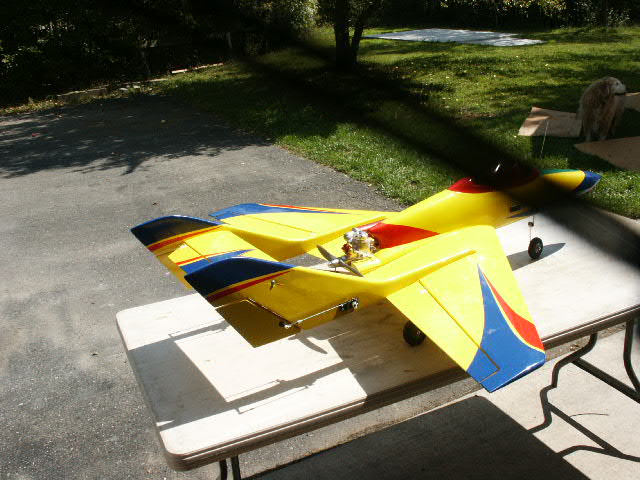

Well I maidened this little jet with a Tower .75 and an 11x7 APC. I was running 10% fuel with shimmed head. I had the engine laying around so I figured it was a good candidate. I had just rebuilt it so it still needs run in so I was running very rich setting. Unlike some members speculation about what to use and what's right for this plane, I recommend this proven combo. I had unlimited vertical and it was truckin. On take off I went straight up. I flew at half most of the time even with the rich setting. 5 clicks of trim and it was flying like a dart on rails. I didn't install retracts yet.
As far as CG I balanced it at the recommend 260MM with 2 battery packs in the nose compartment but that actually proved too nose heavy. I would also recommend scaling down aileron throws as it gets sensitive at speed but I was nosy heavy.
I lost my muffler in flight and dead sticked into a small bush and grass. Damaged the wing a bit but this is a tough jet. I did reinforce the mounting locations for the booms and blocked the wing and fuse and installed a carbon plate across the bottom of the fuse/wing to hold them together. This proved and effective and easy install for that. Just plywood blocking, carbon plate and 4 screws.
For the fuel system I added a 2oz hopper tank for extra fuel and good fuel delivery, both tanks mounted in reverse with reverse clunk, bubbless clunk in main tank.
I hope this information is a benefit to anyone building the jet or looking into it. I hope they keep the price the same. I would buy another for a spare.

Looks great. Sounds like a good engine, never run a Tower 75 myself.
Reverse clunk...well...been there, done that. The clunk must be going towards the rear of the plane, or you WILL dead stick, sooner or later. Best of luck with that.

Yes, you must install the tanks in reverse direction and reverse clunk. In other words, your tank is mounted front side back and your clunk has to also be reversed or looped around to front of the tank (which is now facing the rear of the plane). Sorry for the confusion on this, I can send you a diagram if you need one, it's quite simple.
and yes, with the new rebuild the engine, the Tower engine is great, plenty of power for the size plane/prop.

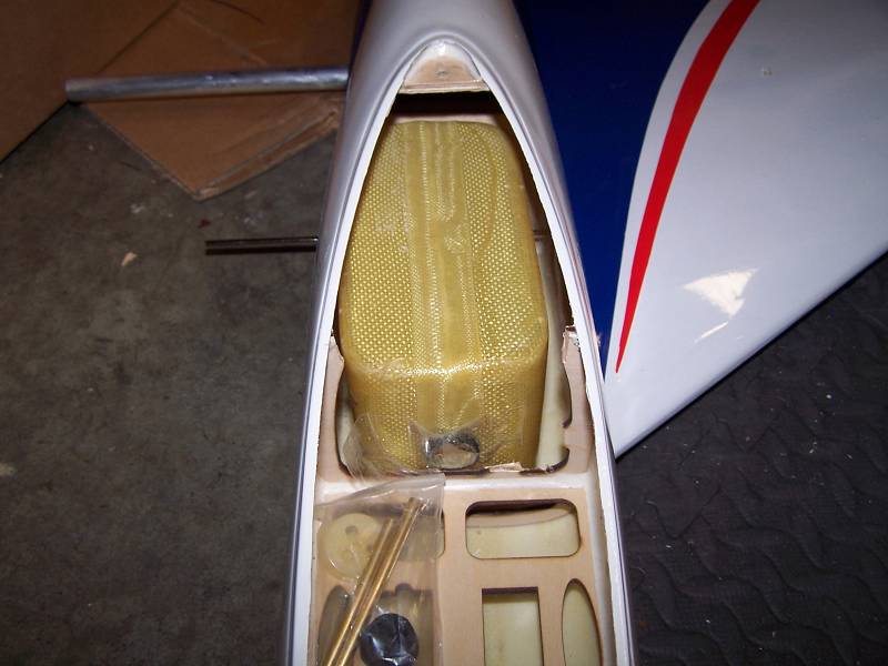

Today I broke in the Dub Jett BSE.50
It lit right up and has a great idle without adjustment.
Tomorrow the Bobkat goes out for its flight.
5 cell pack all the way forward and 2.0 in front of and .5 oz lead at F2 (nose gear mount) put the C.G. at 10.0-10.1"

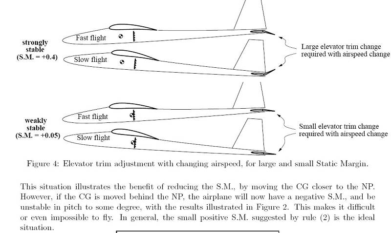

To clarify between the Point of balance or the Neutral point and the CG.
If your models point of balance is at 9 1/2" and it flies nose heavy, This tells you your NP is further forward. If the CG of your airframe is 10" and you are trying to balance at the CG then you are even more nose heavy than at 9 1/2" considering not moving any weight around. If you move weight further back from the nose from a balanced aircraft, your NP will be aft.
Here is a useful diagram to help.

If you're nose heavy at 9 1/2 you'll want to move the CG forward, not back to 10"!
[/quote]
Hmmm.... something doesn't sound correct here!

If your nose heavy move the CG aft not forward![/b]!!!!!

Balancing the model at the manufacture's recommend CG of 10.3" proved too nose heavy during my flight. The CG of the aircraft is determined by the design, however, the point of balance is changed depending on your style of flying and how you want the aircraft to handle, Refer to my posted diagram above.
..going to do some shots now.
